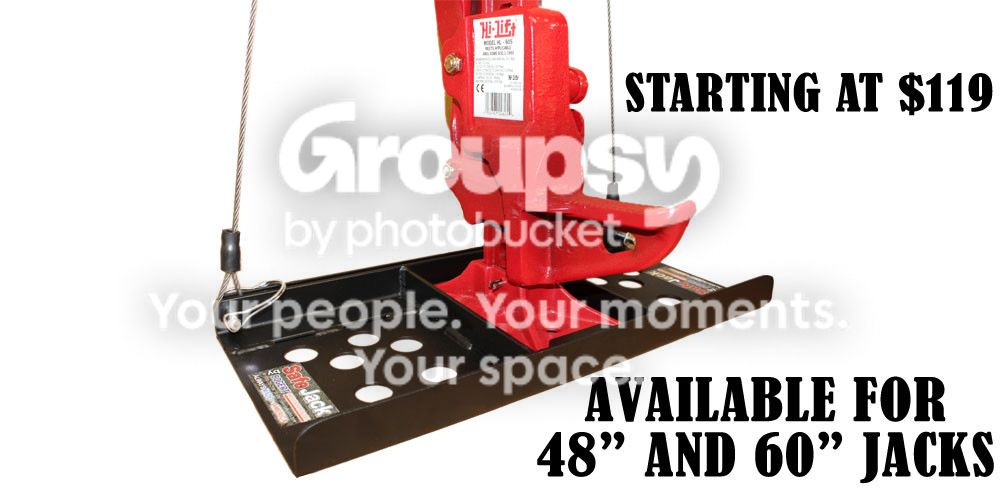

added safety for the jack
I don't have a lot of experience with a hi-lift, but I do follow instructions and like my face in-tact. That said, a little extra safety doesn't hurt.
I bought one of these:
From here:
Safe Jack - Off road, 4X4, 4WD accessories and products.
Here is the video. it also shows some of the dangers and limitations of using a hi-lift with no base on loose surfaces: https://www.youtube.com/watch?v=JdfKrBAMMAI
It's a little more weight in your recovery gear bag / box, but it seems to be much safer than any other base. Just another layer of security for a dangerous tool. I've only used it in practice in the driveway and yard, but so far so good.
