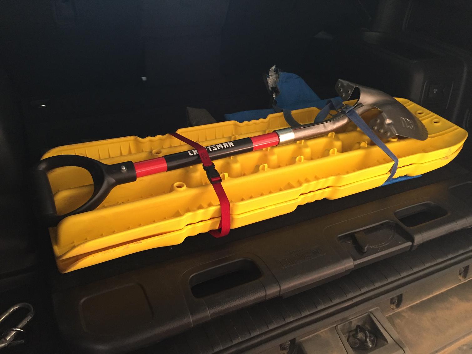

..echoing others, good judgment is probably the most valuable tool, know your limitations! Also, geography plays a big role in deciding what recovery devices are necessary. Here in the Mojave, I encounter a lot of sand, loose gravel and hard drainage ditches. This is part of my recovery kit that goes everywhere; has saved me once already.
