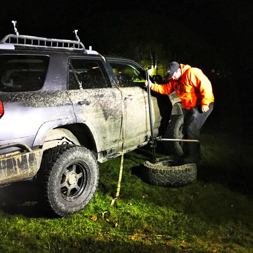

I'm glad I carry mine. I destroyed 2 tpms valve stems and had to replace them. We used my Hi-Lift to break the beads of the tires to replace the valves with rubber ones. You can see my friend here working on one of them. Put the base of the jack on the tire and the finger under the slider. Worked like a charm. My jack is the 60". I went with this one due to my front and rear long travel.

At OEX last spring we were all aired down and drove over a pretty nasty, rotten bridge. [MENTION=19164]Greydog[/MENTION] (iirc) went through and once we were done for the day he realized some of that rotten wood was lodged between the rim and the tire.
They broke the bead the same way to clean out the tire before reseating it.
