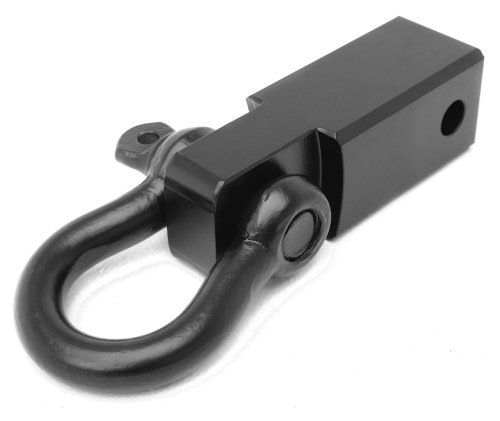

it would certainly be my GO TO extraction point. especially using one of these.
you could lock the hi-lift right into that shackle, it would lift it just fine.
