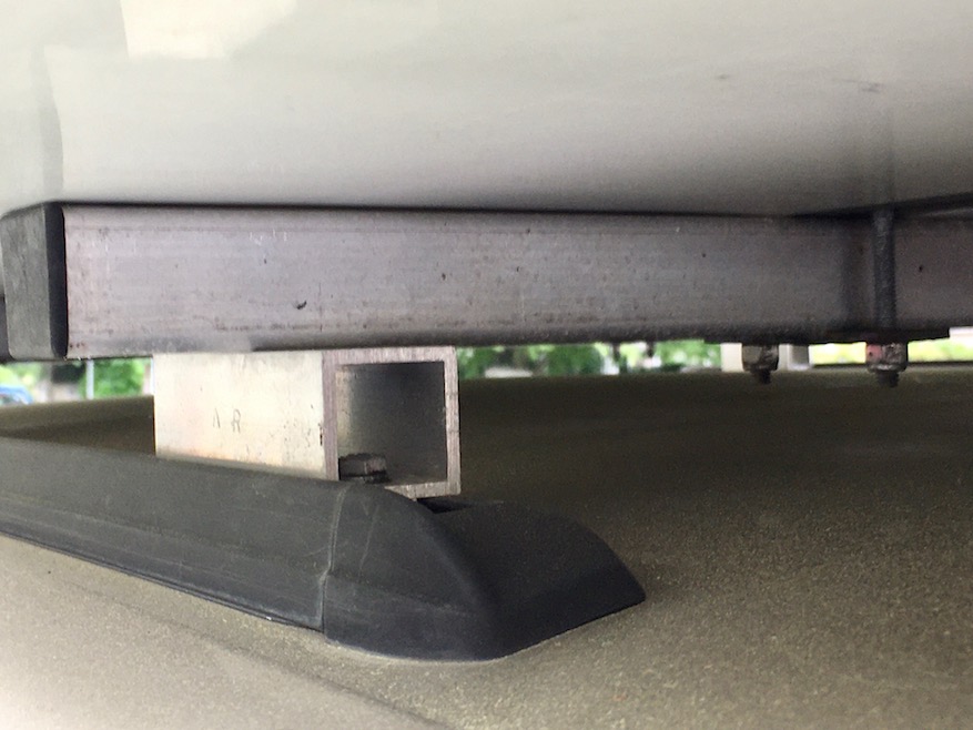

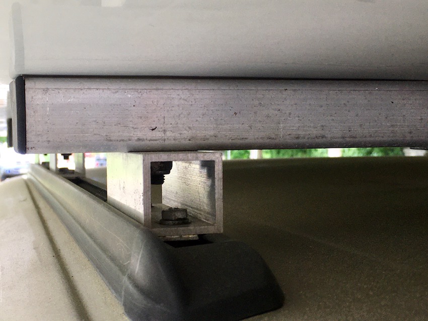

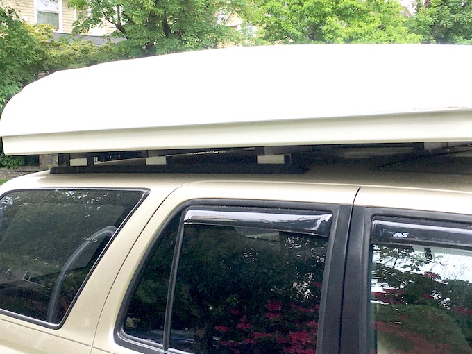

Given what was posted earlier about structural strength maybe I need to revisit my setup but I thought I would post some pics of what I did to mount my RTT.
I didn't want a basket style roof rack so I used square tubing for the small mounts on the roof rails as well as the cross bars. I wanted it as close to the roof top as possible to keep the center of gravity lower.
So far so good. I've been on bumpy forest service roads and highway speeds without any movement of the custom mounts, however, the front end of the RTT catches enough wind which flexes the actual 4Runner roof; this results in a bit of bounce from the front end of the RTT.
I'm in the process of extending the rails to install another mount further up front to spread the load.
To answer your question if you 'need' a roof rack, well, it depends on the mounting system of the RTT. My RTT mounting system requires enough clearance underneath it to get nuts on the bolts that hang down below the cross bars. If your RTT has a mounting system directly over the rails you may be able to skip a rack, basket or cross bars altogether.

Hmm...I wonder if adding a crossbar with a wind deflector to the front end of the roof would lessen wind from getting under your RTT?
Edwin562. Thanks!
[MENTION=117483]benjamin247[/MENTION]. I've considered adding a windscreen under the front of the RTT but if it didn't work and the RTT was still moving up and down a bit the windscreen could damage the 4Runner roof. I did also look up the Tepui Hybox but can't find an image of the underside so I can't give any perspective on mounting designs.
For me I feel that extending the roof rails is the solution (partially based on cost). Now if I can only find a cheap set!

You don't need an entire rack, but you will most likely need some cross bars that are stronger than OEM. You need some feet like the ones I have below, and they bolt to the factory channels in the roof. Then you can connect some 1x2 extruded aluminum to the feet to act as cross bars. Much like what I have in the second picture, but without the side rails.
You don't need an entire rack, but you will most likely need some cross bars that are strong than OEM. You need some feet like the ones I have below, and they bolt to the factor channels in the roof. Then you can connect some 1x2 extruded aluminum to the feet to act as cross bars. Much like what I have in the second picture, but without the side rails.

I made them for a roof rack that I designed. They can be for sale if people are interested. I'd even be willing to make cross bar kits. Was not my intention of the post though.
Somebody is clever. Those are nice. How do you get this stuff looking so professionally cut/bent/built?
