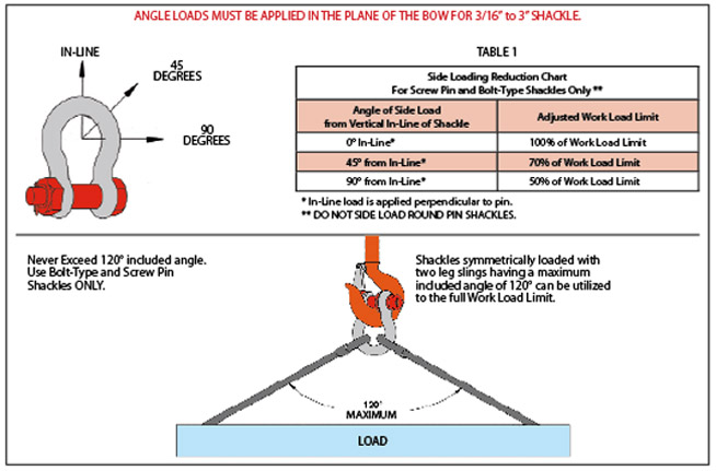

Totally not ideal, I know. I also know that you have done a ton of practical recoveries and totally trust your opinion. There are times when it is what it is and you have to do what you have to do. Even if you are pulling off ~45 degrees you won't suffer the 30% reduction in the WLL if it where in the vertical position, not that it matters that much on a 4.5 ton 3/4" shackle but it still is a ~1.5 ton wll reduction.

Working load limit is reduced by 30% at 45 degree pull. Well other than my arithmetic lol would be 1.35. Reducing the Working load limit of the shackle to 3.15 tons. Is something wrong in my thinking? It is how I understand it. You would be the one to let me know :)
If you want a true answer I will be glad to give it. It will take me awhile just like it did to make the post I quoted above. So if you want it I will do it. I hate seeing wrong information posted because someone will believe it and when recovering a vehicle you need all the information you can have or else it will be an expensive lesson.

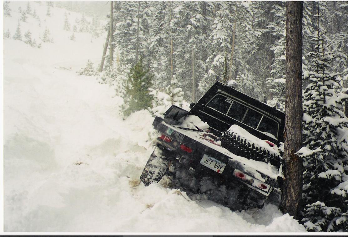

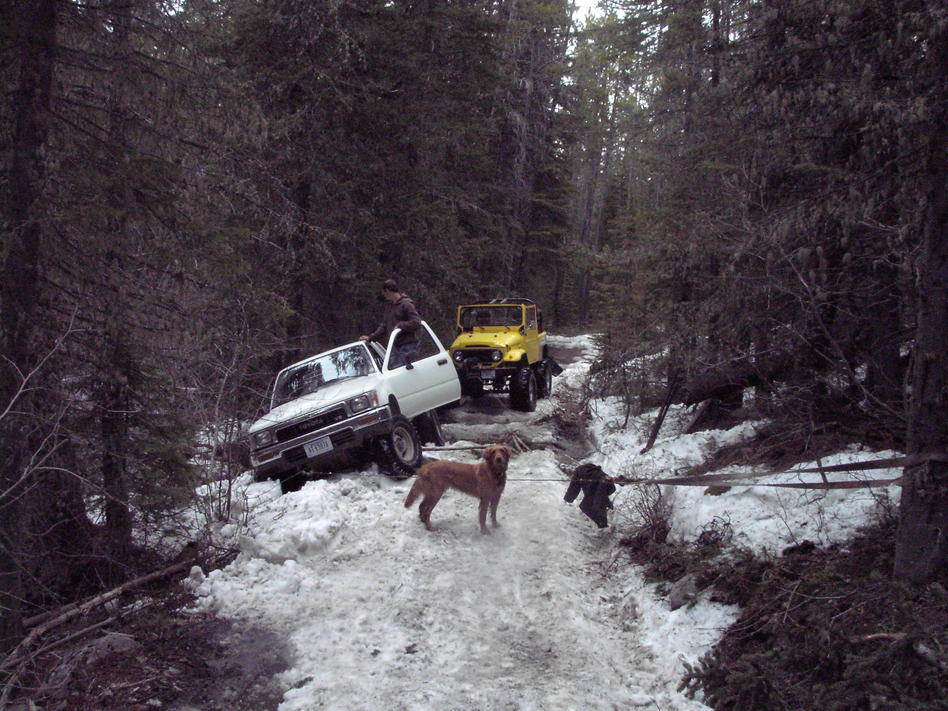

This is the type of situation I've regularly seen the need for a side pull. The yellow land cruiser is my trail rig. Obviously this is a front pull, but it could end up doing the same with a rear pull. Side front pulls tend to be hard on front axles. The last two front axle shafts I've snapped were done with the winch pulling almost straight sideways and a tire bound up. I the second pic the truck is one of my other trail rigs. Same kind of issue. On that same trail I've tipped that truck on it's side breaking trail in the snow. The higher mountain logging roads tend to build up at an angle and it can be very difficult to stay on the road.
In both situations a strap would have been very hard to use to extract the stuck vehicle. I don't foresee many situations where a strap will see a 90* side pull. But I have that situation pretty regularly with a winch pull.
yes, I have experienced side pulls like that MANY times. I have still yet to see the need to flip my shackle around.
Yes, I would appreciate you explaining it in more layman's terms. I am not making shit up. Maybe I just don't understand what is being said. Correct me and I will be more that happy to edit my other posts (I would edit/delete it anyway if you think that it is that confusing). A single leg (vertical) side load of 45 degrees reduces the WLL of the shackle to 70%. Is that not a 30% reduction in WLL for the shackle? Granted I am no engineer, I did do some rigging for a number of years in my 20's. I have gotten the information from reputable resources. From Crosby, see Table 1:

It's not the sling that is rotating... from my understanding (On the job experience as well as master rigger class) it's the forces on the sling (loading and unloading, shocking, again and again) as well as any side loading on the shackle itself would cause stresses in both the pin and shackle body. Those forces could cause the pin to be torqued down or bound up.
