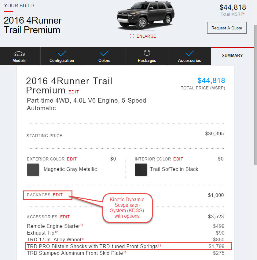

I've been going through the same process of many of you, trying to figure out which 4Runner I want and what type of suspension. What I finally settled on, is a 4Runner Trail Premium with KDSS and TRD Suspension. But after reading many posts, I was worried that this not a viable or smart option, since many described KDSS and TRD Suspension was not compatible.
I just went out to Toyota to build a new 4Runner Trail Premium. I selected the KDSS Package (additional $1000). When I went to Accessories, there was a new option that I have not seen in the past - TRD PRO Bilstein Shocks with TRD-tuned Front Springs (additional $1799).
Is my assumption correct, that this is the same suspension that is on the TRD? If so, I wonder how TRD accessory warranty on the Trail compares to the TRD model.
Is there anything else I should take into concern?

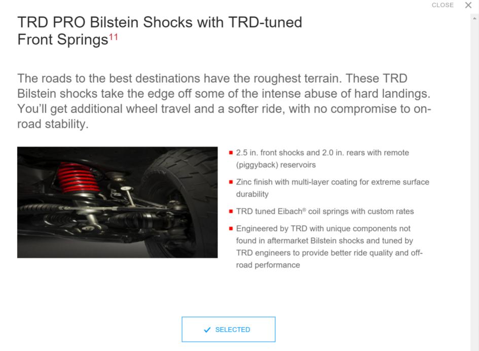

Here are the details for the accessory - TRD PRO Bilstein Shocks...
"The roads to the best destinations have the roughest terrain. These TRD Bilstein shocks take the edge off some of the intense abuse of hard landings. You’ll get additional wheel travel and a softer ride, with no compromise to on-road stability.
-2.5 in. front shocks and 2.0 in. rears with remote (piggyback) reservoirs
-Zinc finish with multi-layer coating for extreme surface durability
-TRD tuned Eibach® coil springs with custom rates
-Engineered by TRD with unique components not found in aftermarket Bilstein shocks and tuned by TRD engineers to provide better ride quality and off-road performance"

TRD Suspension & Skid Plate not Compatible with KDSS
