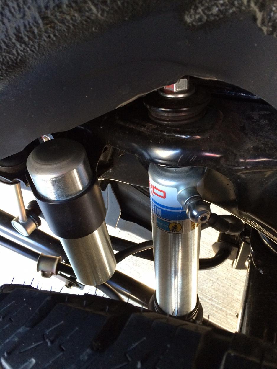

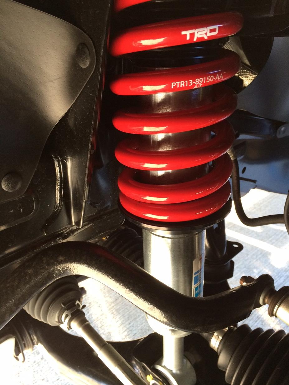

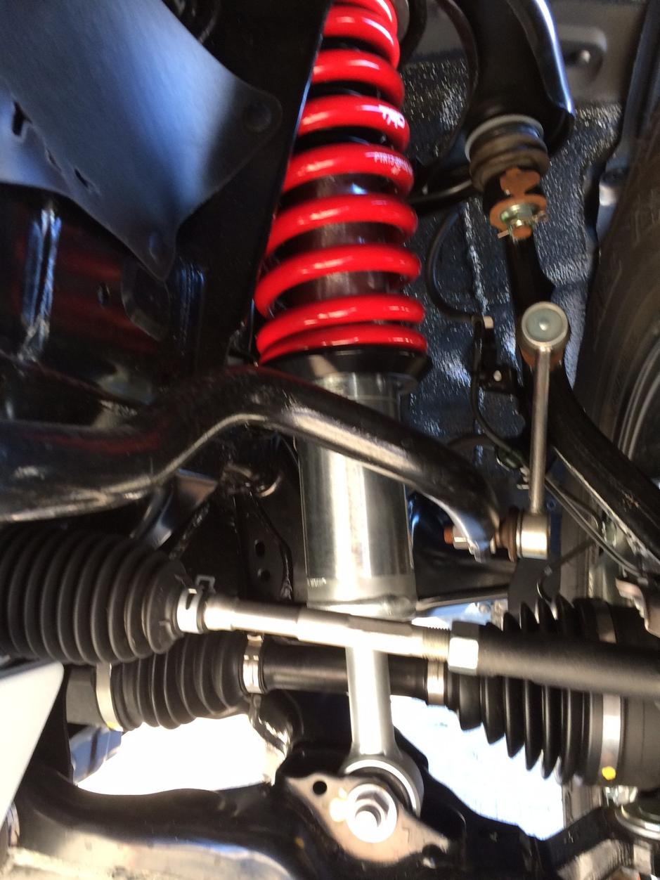

What you have posted is not the same coilover and rear shock as the TRD Pro Suspension.
The front is 2.5" in DIA (60mm) the rear is 2" DIA (46mm) with remote reservoirs.
Go to a dealership that has one on the lot and look for yourself.
I have.
The TRD Pro Suspension fronts have only 2 perch clip locations, unlike the 5100's that have more and is a smaller dia shock. It is 2" (46mm) you linked to
