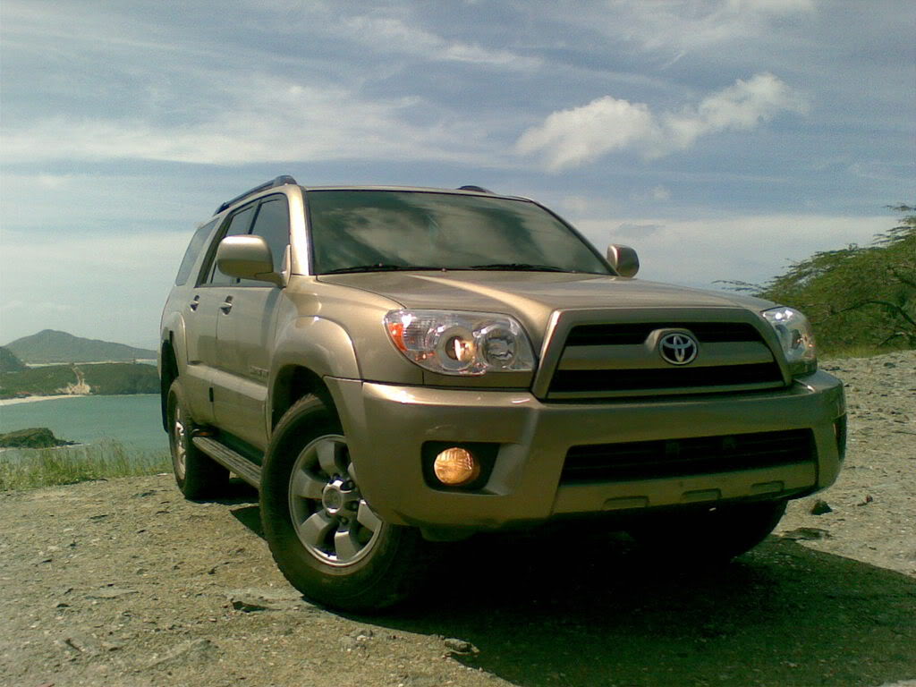

Is it possible to have the ’06 upgrades on a ’05?
kavalis
Didn’t they move the signal lights up in ’06? This guy might not know what he has. The badging on the door looks longer that SR5 4WD from the photo angle but hard to tell? I think it is a ’06 Limited... got a call in to him. Does anyone like the gold??? :snacker:

'06+ all the way. Grill, lights, round fog lights... I wouldn't mention it in negotiation though.. lol

I hear ya.... and if it is a limited I won’t mention that either. Might be someone selling it for someone else or a typo? Don’t know about the color though :confused:
Looks like an 06+ Limited--painted mirrors and front grille and you can see the light for the running boards. It's got 16" SR5 wheels though and no V8 badge.
I noticed no badge for the V8, whats going on... what the #$%^& is it? :shrug:
Those aren't SR5 wheels though. Make sure its not some ''rebuild''. Get the VIN and check all that needs checked. The VIN will tell you what it ''should'' be.

The roof rack is suspect also. 03-05 Limiteds had a silver roof rack didn't they?? or was that just the 04s?? Edit: All roof racks were black on 05 models except Sport Editions which were silver. Found that info here - http://www.top4runners.com/runhist/runhist42005.html Thanks again J.A.
You could do all those mods on an 05 SR5 if you wanted too. matching Mirrors, 06 & up headlights and lower light trim, limited badges, front bumper cover, matching grill, lighted running boards, all of those are a bolt on mod. Those are Standard 16" wheels availible on the SR5s only, most SR5s have the upgraded 17" wheels that were availible on the Limiteds. It was only a $100 option. The limiteds came standard with 17" 5 spoke wheels. The SEs had standard 17" 6 spoke wheel.
Another explaination is this person had a front end wreck and put the 06+ pieces on. Hense no V8 emblem???
I had a silver rack (and running boards) on my '03 limited too but I believe in '05 they switched to black.
The rear fenders look like the rounded '06 up flares so that would discount the bolt on thing. Also '06 front bumper won't line up with '03 front fenders.
Seems most likely to me that this is an '06 Limited but he put SR5 16" wheels (to save money on tires?)

I have to agree with you after looking at the rounded wheel wells. Maybe he has a second set of tires??? How much are you really going to save on tires??? Maybe $100 a set. You would pay more that that for the 16" rims I would think. Who knows!! people do strange things!!! :D
Mystery T4R! Thanks for the detective work guys... I left a message on his phone and also a text last night. Still no response. Its a North county San Diego number and it looks like he took the pics over looking Lake Hodges which would also put it in that area code. :jaw drop:
Ask the seller for the VIN. You can tell if it's a Limited or an SR5 by the 7th digit in the VIN, 4 for a SR5 (or Sport Edition) and 7 for a Limited.

looks funny, the front is 06+ but the back is 05- , dont u think its not a good match, wide front and skinny rear?
