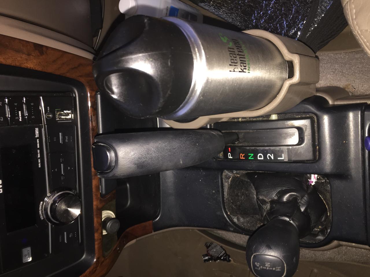

Installed
I finally got some time to install mine. I'm really happy that I have proper cup holders now!!! Thanks again for taking the time to R&D this!!
Like others the shifter was not centered in the opening. Mine was actually completely pressing against the right side. I didn't want a gap so I did as told and started with the front screw and pressed the console so it would be flush (somewhat centering shifter) but this also pressed up against the shifter and cause a squeaky noise. So, from there I didn't a little ghetto engineering. I cut the end off of a zip tie and wedged it between the shifter and console so the shifter wouldn't rub the cup holder. You can see it in the picture. It's white. If I had a black one you probably wouldn't have noticed.
One idea I had for your future designs is to take the taper out of the small holder. it will hold my water bottle but it won't go all they way down. My wife has the same kind so if she rides with me, we will use both holders. It's not a deal breaker by any means, but just an idea for an improvement.
