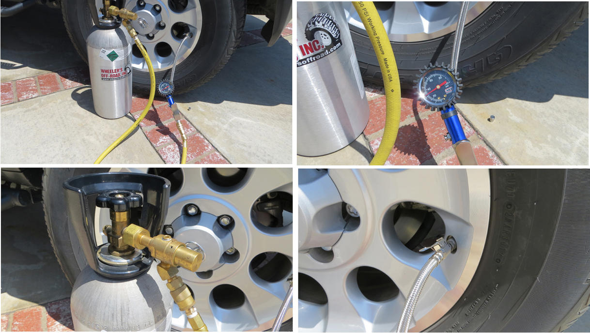

Co2
I have not been flamed for a while so here goes.
I know there are a lot of advantages to a compressor and I carry an MV50 as backup. The darn thing takes 4 minutes per tire. This is my main source to air up and it's only 30 seconds per tire and under $200. In 4 minutes I have it put away and I'm looking for something to drink.
I looked at a Power Tank, then put this together. Tank from Beverage Warehouse, regulator from Wheelers, hose and gauge from Amazon.
