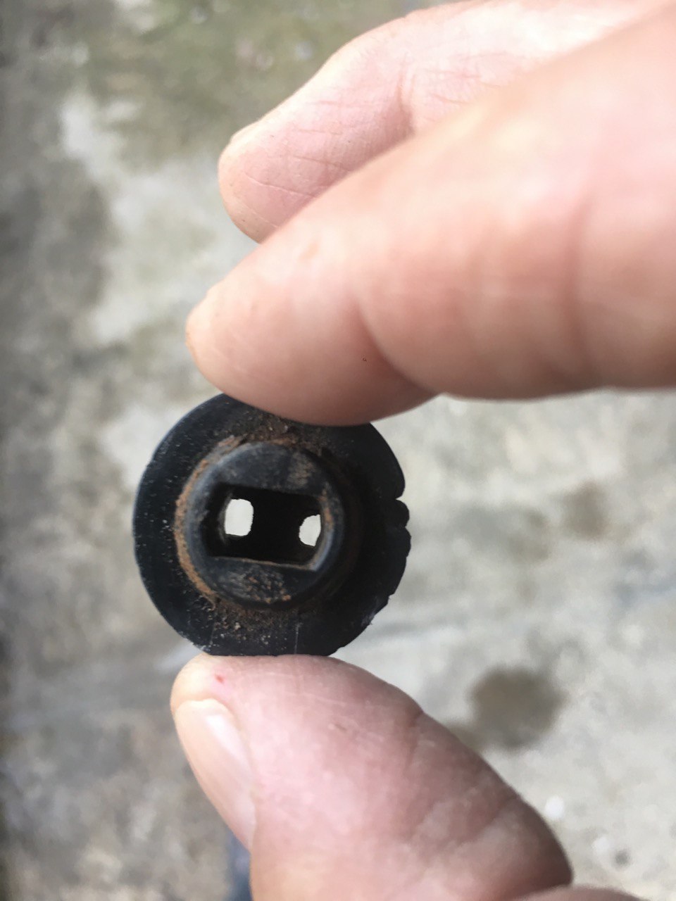

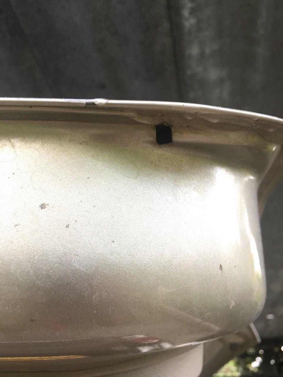

Pics from today
Yep mine aren't like this either. They are just straight solid plugs. I too wonder why some of us have solid and some with drains.
I would of thought all the "plug/drains" would be the same, but apparently not...BUT I see it as a easy fix with a small drill bit....drill two small holes in the "plugs" which would make them drains!!

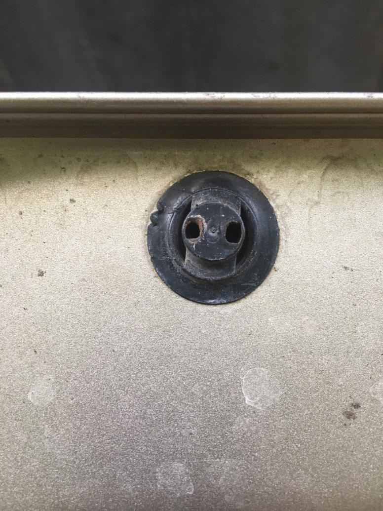

Thanks for the pics! Here's mine:
Which looks like it might drain around that center button area. But no.
Also, my plugs are toward the center of the door instead of near the sides as it looks like yours are. I think yours are in a better location for draining.
It also looks like your plugs fit in a square opening. Mine fit a round hole.
