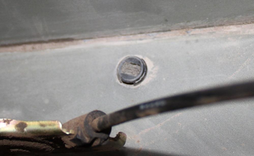

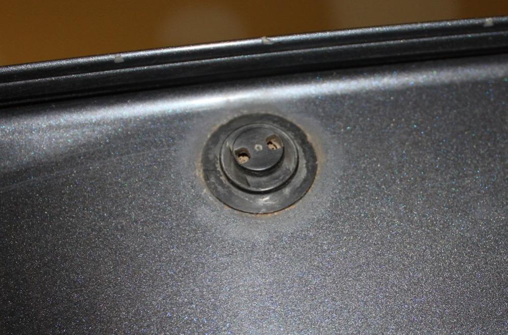

Harlock, isn't that a square drain on the far right of your door in the 2nd to last picture? Kinda in the crease there.
Center and one in each corner on mine for the square holes.
Have different drain plugs too, has a bit of sponge in the inside holes.

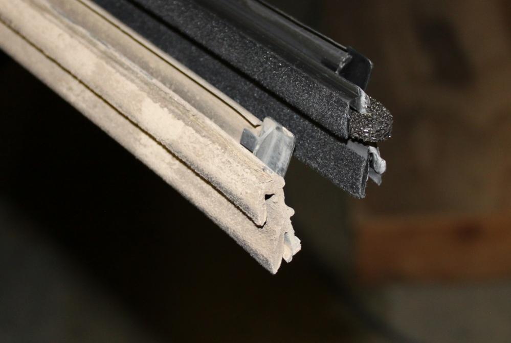

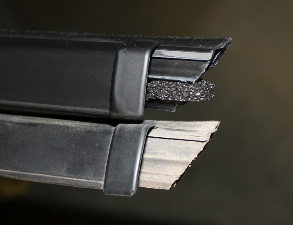

Noticed this new window seal has extra foam at the tips.
My old one was really nasty.
Was thinking a person might could put a piece of wax paper on the window/corner, then smear a bit of some kind of RTV/gasket goop to seal the corners better.

Thanks for the pics! Here's mine:
Which looks like it might drain around that center button area. But no.
Also, my plugs are toward the center of the door instead of near the sides as it looks like yours are. I think yours are in a better location for draining.
It also looks like your plugs fit in a square opening. Mine fit a round hole.
The square holes ( 2) at each corner are not for the plugs (those are rounds),are 2 extra drains w/out plugs like the ones (as posted bellow your pics) , are also on one of your pics
