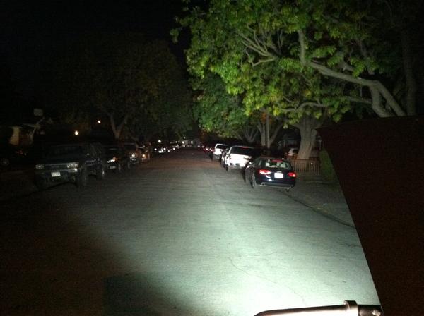

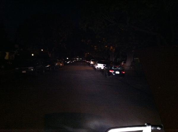

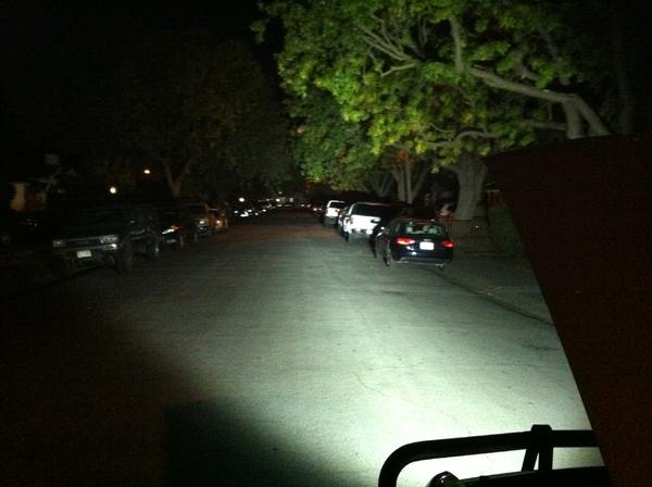

Well, here is the progression....
No lights/neighborhood street
Low beams only
Light bar only
Light bar and High beams
I won't be able to show some pics without light pollution till a little later in the month, but I'll get some! :hungry::cool:

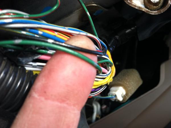

First, take of the lower dash cover and lower column cover (this one simply to double check the wire at the connector).
Locate the black/red and green/black in the wire bundle that comes down the column and across (the bundle should be running through a white plastic retainer, sorry, I didn't get a pick of that).
You can also see them going into the stalk connector.
drdolittlerwc-albums-light+bar-fog+switch+mod-picture21369-bottom-view-wires-entering-connector.jpg

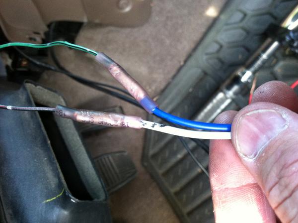

Once, you've located these wires in the bundle and connector, I tested for continuity, just to confirm. I spliced into the switch a little further down the line (from new switch white/+ to black/red on fog switch, and blue/relay to green/black, you can see the new switch pic below), I didn't want to cut to close to the connector and also have to route some new wires around the column.

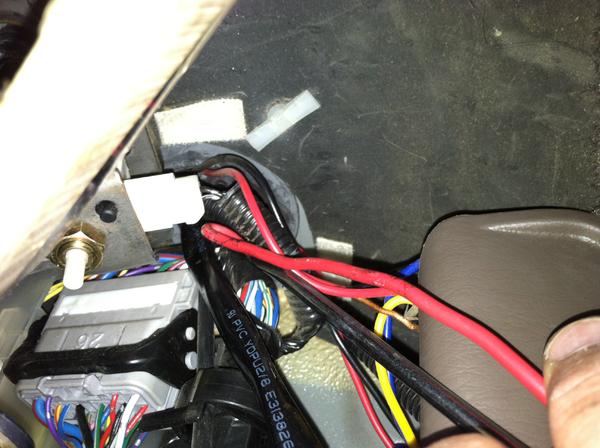

Getting the wire through the grommet was fun. I used a skinny flat head and hooked a #14 solid wire on the end and pushed through (being careful about other wires of course). Once through, I taped off the #14 to my new wire and backfed it in.
As Ozarks98Runner directed, making the breakthrough for me, I cut of the switch and spliced it into the fog switch wiring.
drdolittlerwc-albums-light+bar-fog+switch+mod-picture21371-switch-belonging-wire-harness-aftermarket-light-bar.jpg

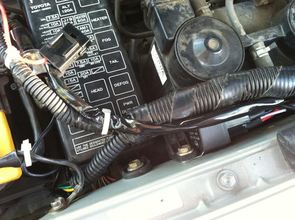

Mounted the relay here...
And Viola!! I now have a new circuit that is able to handle a larger load, and works off the stock left column stalk fog switch. And it is a Key Off switch, but if you need a reminder that it is on, perhaps you are a little too distracted!! :jk:

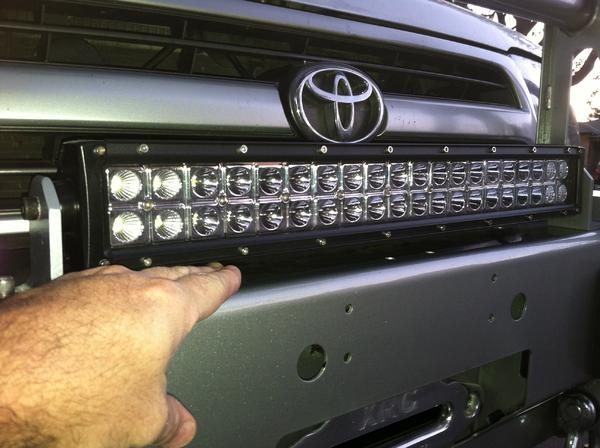

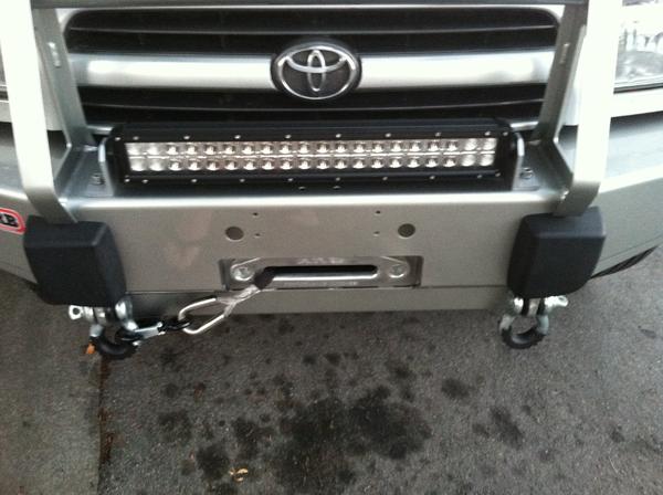

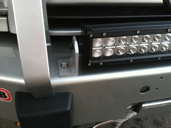

Finally got my fixture installed!
I upgraded the bracket...
So now it is also a little lower profile...

That looks good. Whose light bar is that? Let us know how it lights up the road. I've been thinking about getting one but the Rigid is $$$ and I'm afraid to try the cheaper Chinese units.

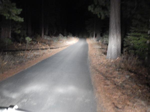

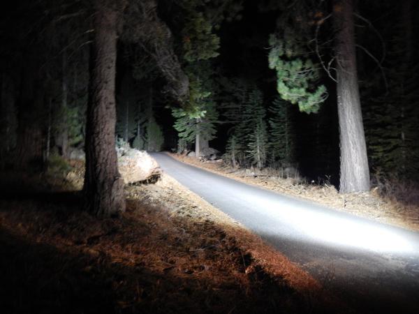

Ok, so I finally got out away from the city lights to absolutely NO LIGHT POLLUTION.
And here it is...
I also changed my headlights to Sylvania HID's, it's a nice white light, but the LED bar still floods out the headlights, even on high!!
The bar is 40 - 3w Cree LED's
Now the forest is polluted with my light!!!
:biggrin2::biggrin2::biggrin2:

I have, but I am not entirely impressed with the output of the LED bar.. It may just be that I am trying to take my output shots with too much range. I am not near any nice wooded areas any where close to town here yay midwest lol. When I make it to one of the access trails round here I will truly get to see how it is. I will say though it is not any where near as bright as the setup I had on my tacoma, but 6 55W HID Hella 500's is hard to compare against a 22in led light bar in both range and lumens lol.
Here are the crappy images I did get though:
The 35W HID fog lights that I have in the bumper are off in all the pics, cause i can't turn them on with the high beams on...... yet.... ;)
55W Retro Lows
Lows and LED bar
Highs and LED bar
From what I saw, it looked light the area was lit up pretty good! With an open area, you have to look more at the ground spread, and it was pretty wide. Given the... camera angle...:dizzy:
