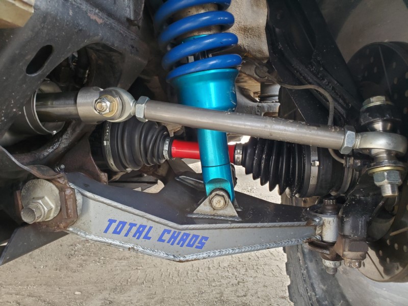

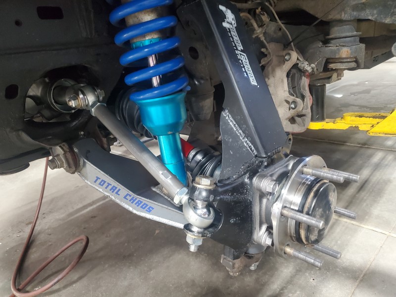

It was time to upgrade the steering rack for this 4Runner. Tired of breaking little stock tie-rods going over bowling ball sized rocks, so I upgraded! Needed more BEEF because i'm in NO MOOD to be breaking down on trails. It may not seem like much, but the stock steering systems on the 4Runner platform are not made to handle big tires, this is a huge upgrade!
Got a modified Tundra rack installed with new solid piece tie-rods!

Do you have the V6 or V8? Curious how that rack would fit with the V8. Steering is definitely a weak point in these trucks.
I have the V8. I do have after market motor mounts that help set the engine up a smidge. Fitting the rack was tight! I have about a quarter inch of clearance from the rack to the oil pan.
Did Basikbikers aluminum offset bushings bolt right up to your factory mounting holes? How much engine lift do you think would be necessary to make the Tundra rack fit? Sorry for all the questions lol
Oh one other question, have you noticed your turning radius is worse now? I believe I read somewhere that it is but just confirming.
The offset bushings did mount up to the factory mounting holes which was nice! I'm not sure how much of a life of the engine is needed or necessary. Probably helps that I have after market motor mounts and they don't make the engine sag lower than the stock ones. Happy to answer any questions!
I do have one other question, did you need to do anything custom to get the power steering lines to bolt up to the Tundra rack?
