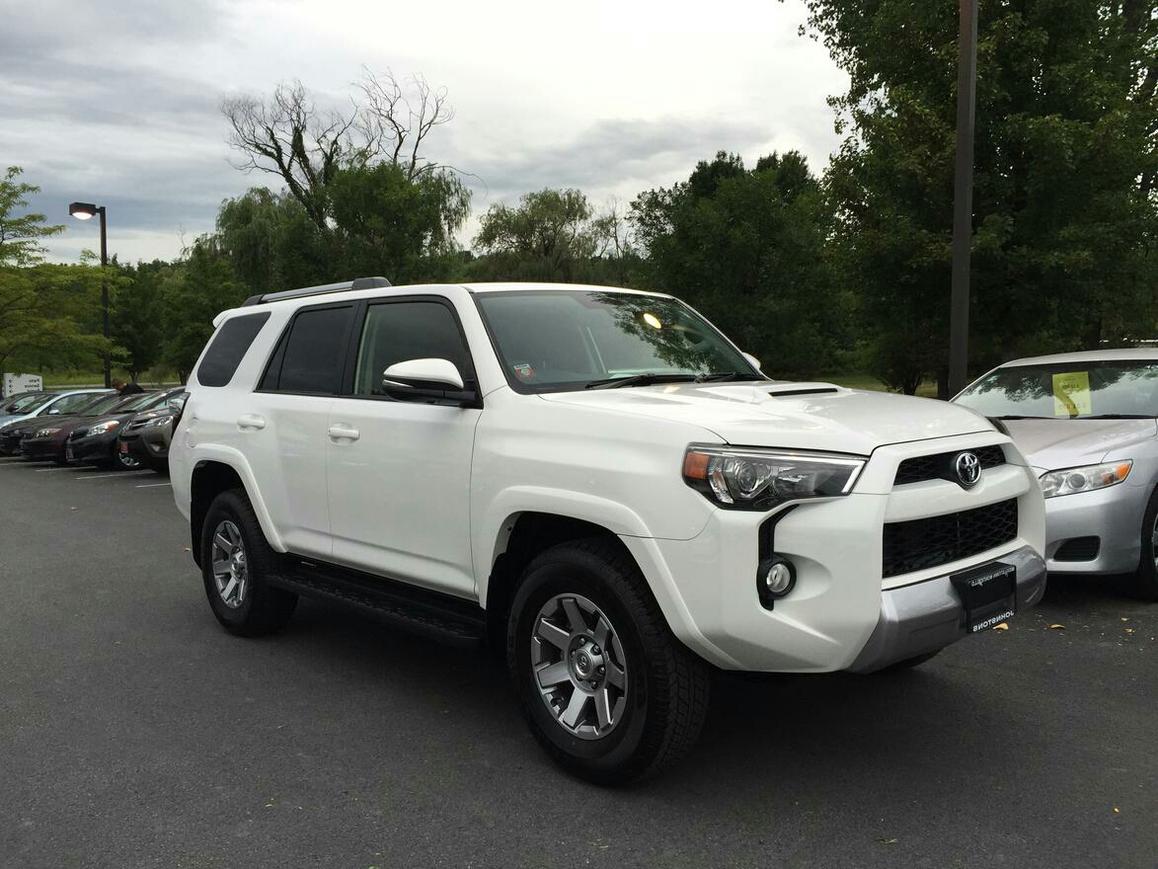

Last night I'm happy to say I picked up my 2015 Trail premium brand new from local dealer. Got what I wanted although no KDSS but im easy going. White with black interior is amazing. I LOVED my 3rd gen to death but just one drive home in this new one and I sadly love this one more. Long story short I am happy and its time for some opinions on my lift plans. Primary use for this will be short trips to work. Hoping some good road trips so I do want it as perfect as possible on highway. The hook is I can't leave anything alone, I like things being balanced and ready to go for any obstacle. I am hesitant on wheeling to much big stuff as it is brand new, however, I bought it to enjoy it and use it so won't be long until I do.
Lift option and wheel ideas as I see it
1. 5100's with all stock coils. 1.75" front. Cornfed 1" rear. Keep stock wheels or go to nicer aftermarket wheel with 275's. I am sure minor trim and pulling of fender needed. In long run I really would like to keep my factory splash guards after removing steps
2. 5100/toytec kit with diff drop. Add LR UCA's so I can get caster 4* to keep highway smooth and planted. But go for 285's as I know the truck will look best. KMC Enduro or ATX Mojave wheels. Trim and pull back whats needed for rubbing
3. Stage 1 Icon kit. I always loved Icon suspension having a few sets in my F250 over past years. BUt is it needed for price jump in long term reliability. I want to set and forget once its in and aligned. I know there product is a great thing. I also know it will be years until I get my runner into a spot calling for rear locker alone. Being I wheel years without one on my 3rd Gen.
Again with 285's and wheels.
I am all for doing it once and right, but don't need to break the bank after just buying if I know im going to hardly test its capabilities weekly. I would like 285's. Everything I ever do mild or mid way, I end up changing and doing what I wanted after so that is why I am tempted for going full lift and UCA's. However I am sure looks handling and BRAKE DIVE will be better with good tires on stock wheels and a mild lift. Keeping great for highway trips and camping.
Thanks for reading! Hope to get some more direct answers being I have searched this to death

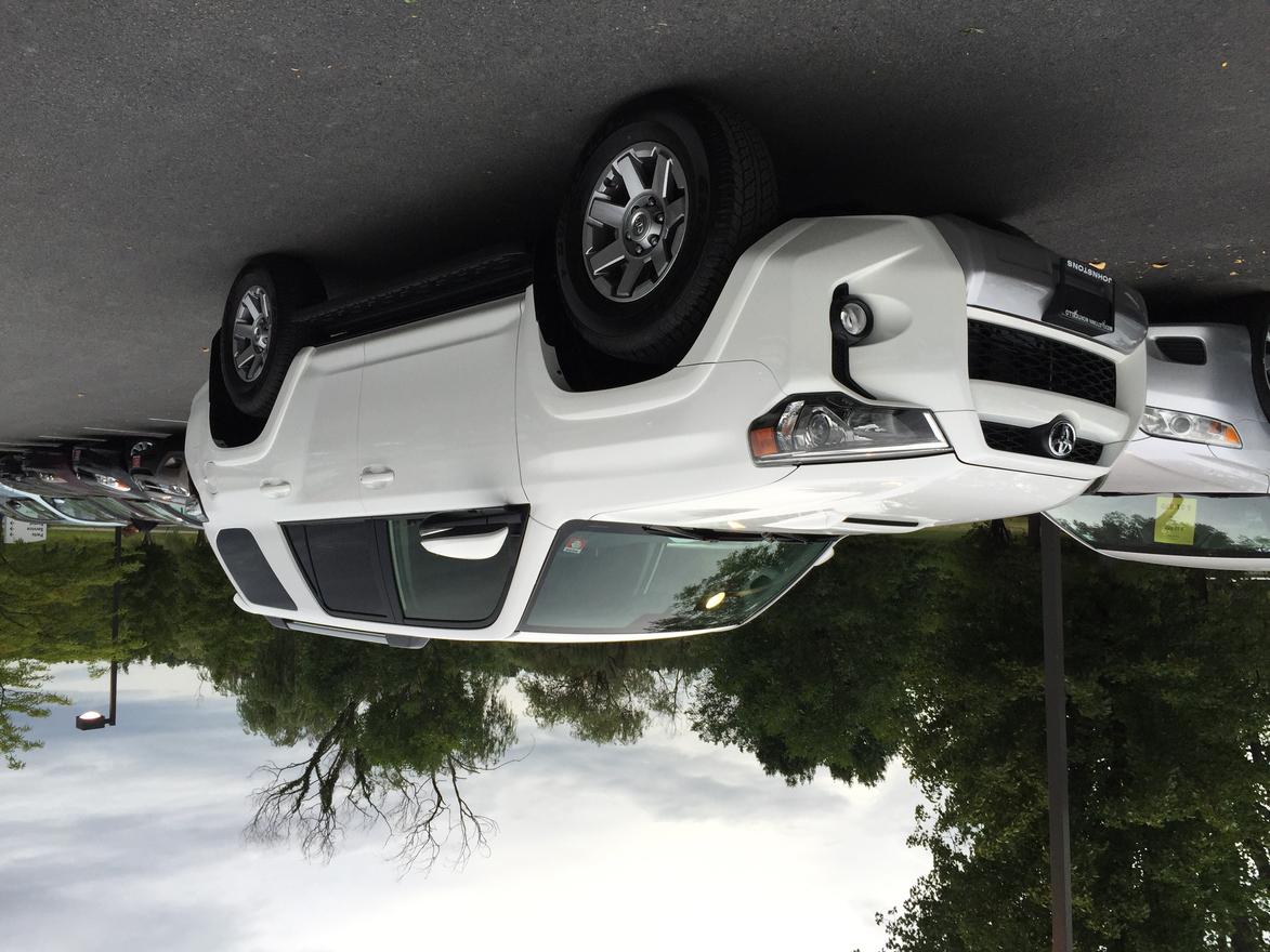

Sorry pic sucks. Took before I did paperwork and drove home. Yet to get anything yet. I need suspension done and figure out my wheel issues. Either stock or TRD pro with 275's.
As much as I love going big. Already I know my use mainly will be trips on highway and want to keep as smooth as I can. Also the wife has driven it more than I and I think I already lost it haha. Good thing our other vehicle is a 2015 TRD sport Tacoma. I did 5100's in when new. .85 setting for front to level. 265 BFG KO2's and TRD headlock wheels. Probably coolest truck we have had in a while and I have been through a LOT of rigs. So. Honestly Idc what I drive there both sick. Which is why that truck makes me love the feel of 5100's over stock. Keeping truck more stock looking yet just big enough a change to look mean yet drive as perfect as it can. Sadly although I love a big lift and all.
Might just go 1.75" front. 1" cornfed rear spacer (or 2 and 1 OME spacers to lift rear enough to not be low and lean fix). 275 BFG KO2 again I love the tire. Now wheel debate comes in. I'm all for TRD pro wheel. Or stock trails I do like. Not all blacked out for once is nice. But spacers scare the death out of me yet seem like best for looks as I'm wanting.
