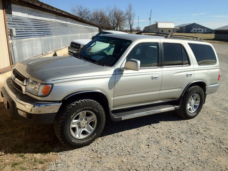

i recently purchased a 2001 t4r sr5 4x4 (after wrecking my 03).
when i purchased this 4runner i was told it was lifted 3". ive measured mine but yet to seen anything similar to measure and go off of. 265/75/16 Cooper Discovery. there arent any spacer shocks are stock toyota factory on the front and rear. possibly tacoma components maybe??
My question is whats stock ride height so i have something to go off of.
any info would help.
thanks phil

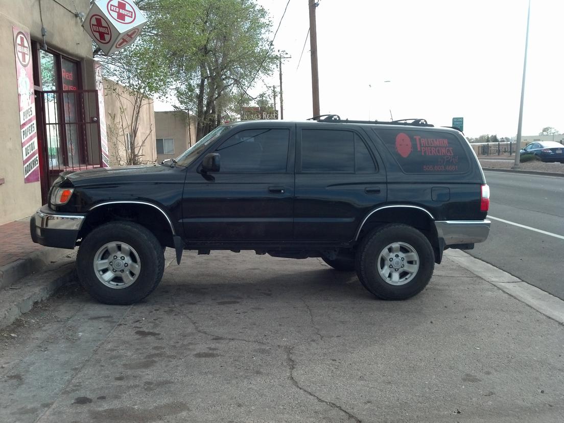

Post a side profile picture of your truck so we can see.

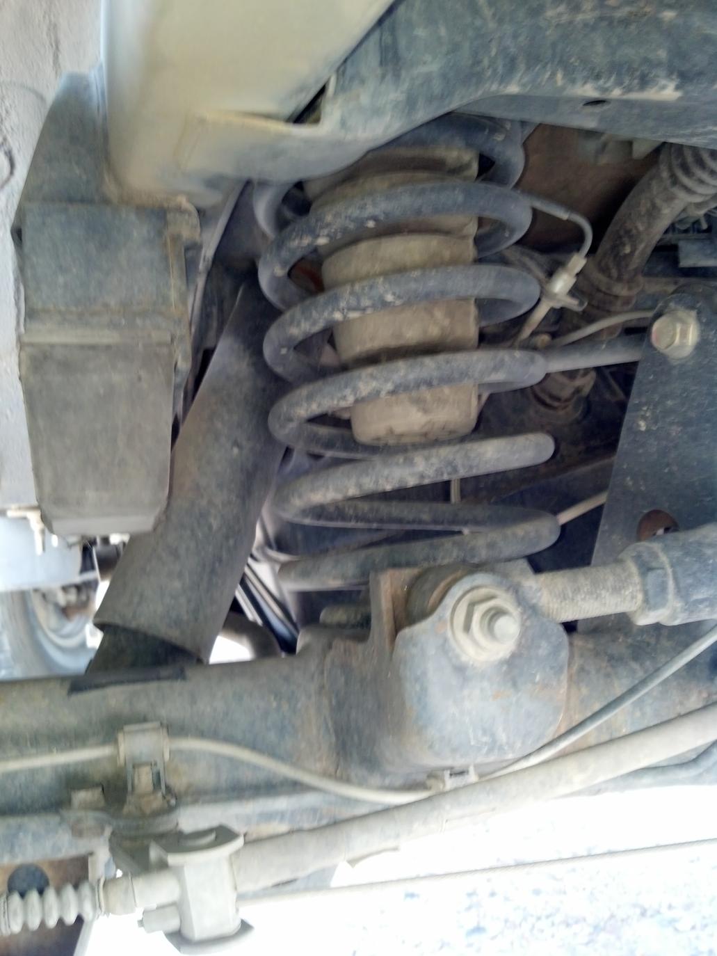

Ok so took some measurements front 22 1/2 rear 23 from center hub to fender lip.

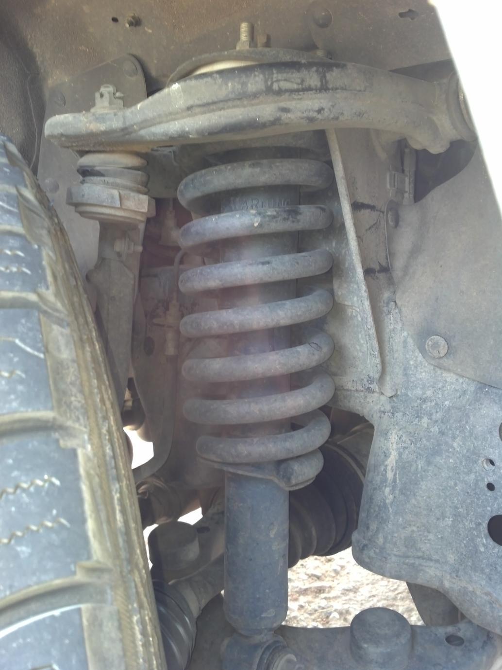

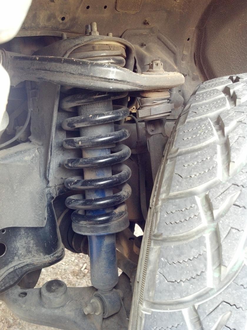

also here are pics if they help.

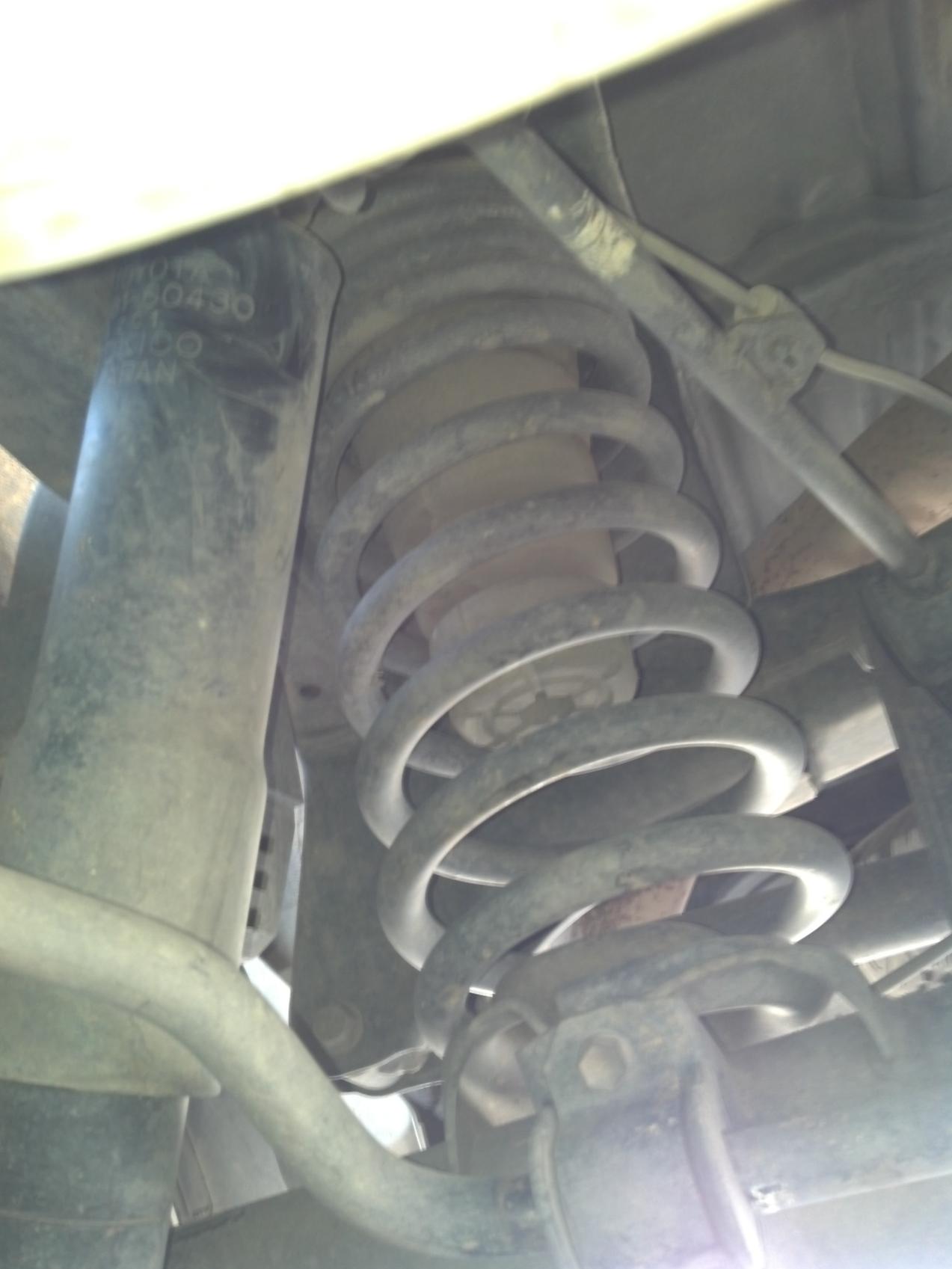

Driver front has some sort of spacer on the bottom perch, passenger front doesn't. I'd guess the springs are OME 882/883's. Rear coil has extra wraps at the top, which are probably OME 890's or something.
What's the part number on the rear tokico shocks? Could come up as the LC Tokico'd too, otherwise they're most likely overstretched stockers.
Not overstreched stock springs, I meant the shocks are either stock LC Tokicos, or they're overstretched stock 4Runner Tokico shocks. Rear coils are aftermarket I believe because none of the stock rear coils have the wraps close together at the top like the pic shows.
ok i got u loud n clear actually i went and looked i couldnt wait i want to see what it was and i found a thread you posted in i was still reading its this link. says........
TOYOTA
48531-60430
Z-C 1
TOKICO
JAPAN
THANKS SO MUCH FOR YOUR HELP!!!!!
so the front is posibally ome coils?

Now that I think about it more, the front coils could also be Tundra TRD's..
they would have paint marks wouldn't they?
That thought crossed my mind right after I posted it, actually..
OP, do your front coils have any color markings on them?

That's the LC shock. Good budget shock for 3"+ lift. You could add spacers, but higher than 23" fender to hub will not play nice with your UCA's or CV's, so keep that in mind.

struts are blue thats all i got. the right side has 351 PO73B on it the other has nothing
