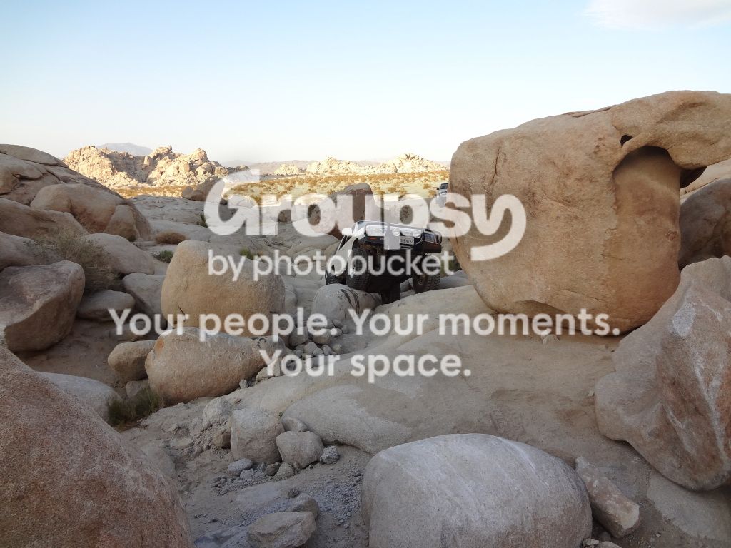

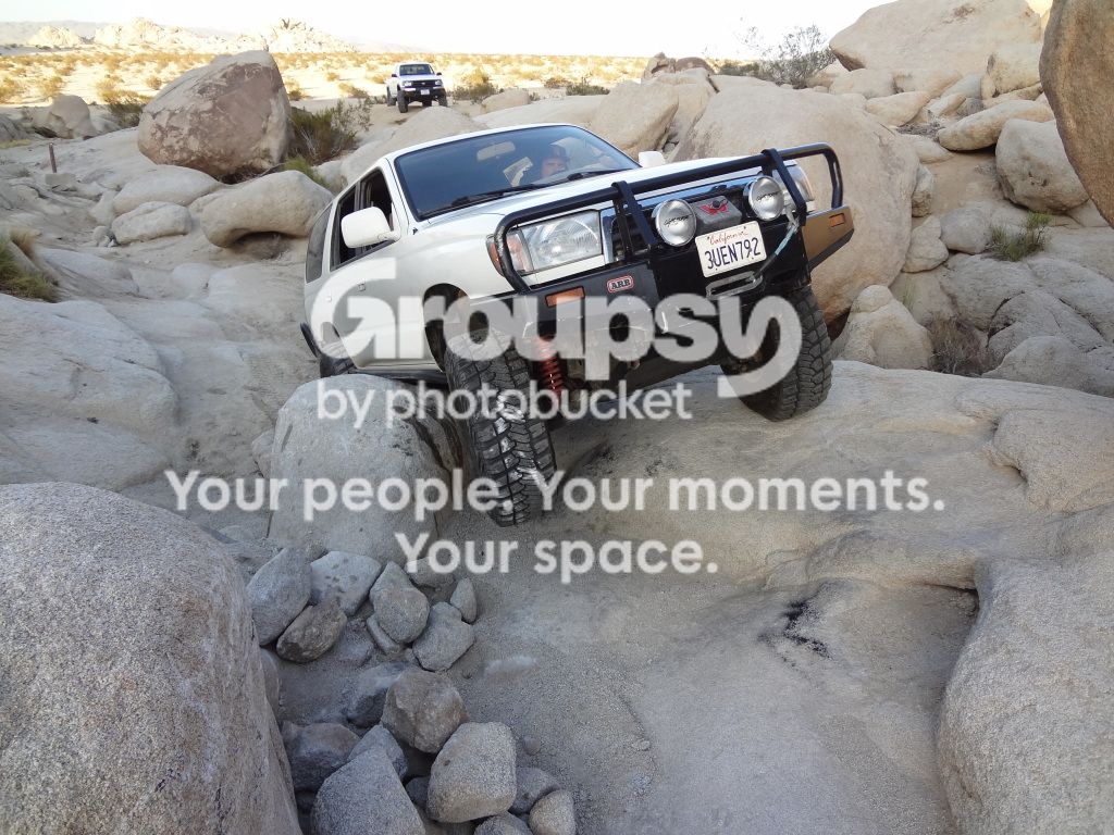

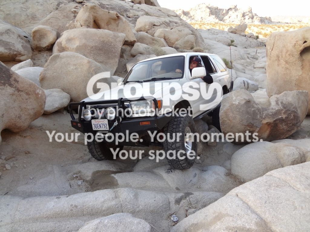

I Know a few of my friends have made it down, But no one i know has tried it up yet. Here are a few from the gatekeeper (hardest spot)
These are big rocks

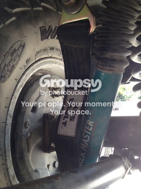

Limit Straps

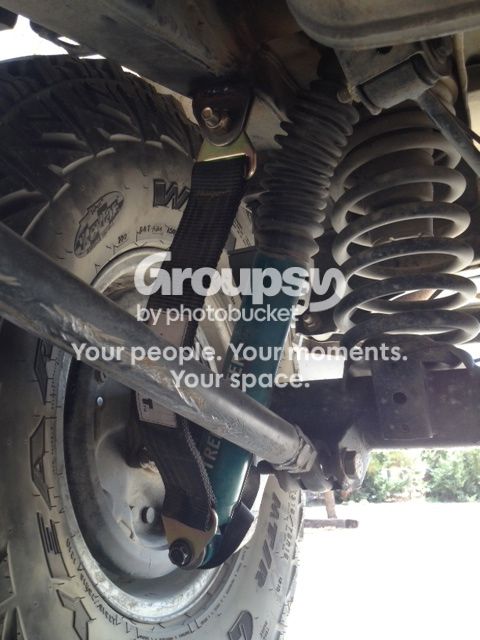

Finally got around to installing limit straps in the rear. The last inch of droop I was getting was causing more issues than its worth. Drive shaft/gas tank problems and Binding problems in the link system, Plus I have always worried about snapping the top off a shock then you are SCREWED. my coil springs will fall out with no shock.
So i bout a set of quad wrapped limit straps with the mounts from ruff stuff. These straps are real nice. I was worried about them being to short but trusted the info on the stretch of the straps and they are absolutely perfect. THey are 18" and stretch to 19" and that leaves me around 3/4" before the shocks maxed out. They are perfect. Now I just need some rubber bands ore something to hold them to the shock when compressing. Ill probably just use an inner tube.

Over all: I used the bottom shock mount. I used a bolt that was about 1" longer so it is way in the mount

Upper mount. Double shear setup with grade 8 hardware

nice, i think its way better than installing a bigger bump stop.
I have pretty big bump stops installed, but now I can shorten them up. and gain my lost inch in some compression.
THe work never stops. LOL
These really work good and they stretch to avoid shock in the system
might have to do that in the future, my gas tank skid... scratch that, my gas tank hits the lil weight on the drive shaft and peel out the skid like a banana, im already on my second skid :(, also my link pop when i flex it, but i still have 3/4" left on the shock, so i might just sacrifice half in of flex to save my links from bending. BTW BAMF is going to make some links for 4runners and FJs, they will be 2 inch USA DOM tubes with 3.0" FORGED Ultra Duty BALLISTIC joint on one end and Poly Bushing Joint on the other end, they are going to be beef!
good luck with the 3.0 joints fitting in the oem front mount. My links have held up good enough and were pretty cheap to make. They are a little bent :) its about to throw some new heims and bushings on em and call it good for another year. These straps took all the clunks and pops out of the articulation. Def look into it. I bought 18" straps
will do may have to look in to a smaller size, i love the ballistic joints, they have plastic bushing in them and totally rebuildable, for for 60 bucks a piece they are pretty $$$$, but its worth not having joint making noise driving down the road. i will deff get the limiting straps, its a no brainier really, pretty simple mod.
