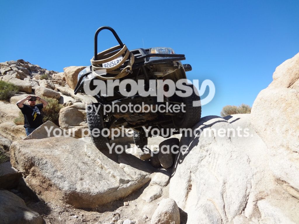

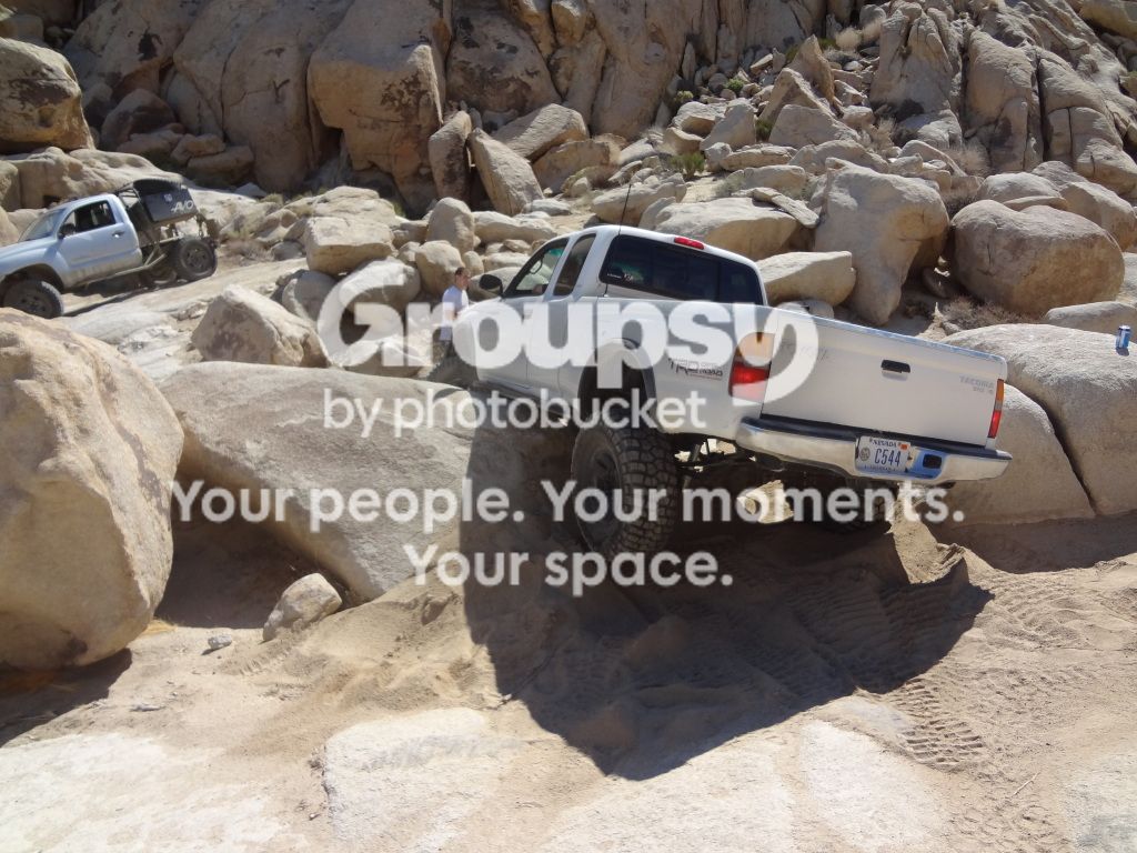

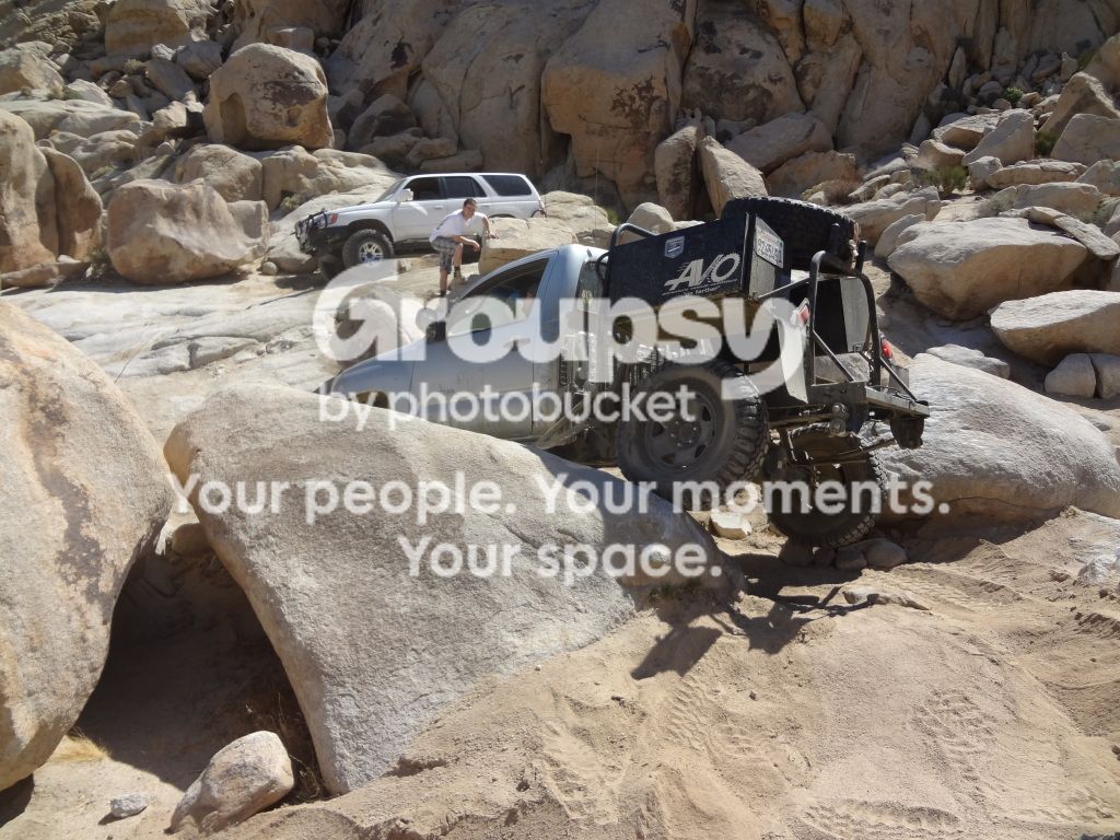

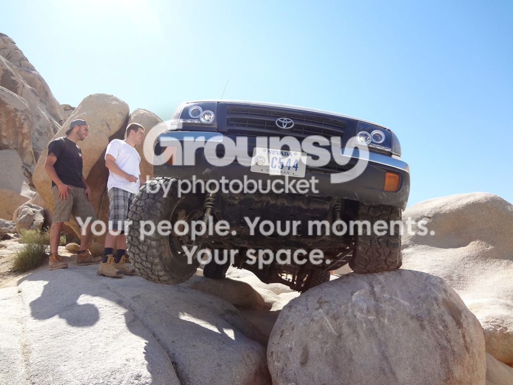

Few pics from the weekend. I went to cougar buttes for a party, It was a wild 21st b day :). I went out there without any plans of wheeling, but i couldnt resist at least testing the tires/ gears on some rocks. Anyways here are a few pics from my 30 minutes of wheeling

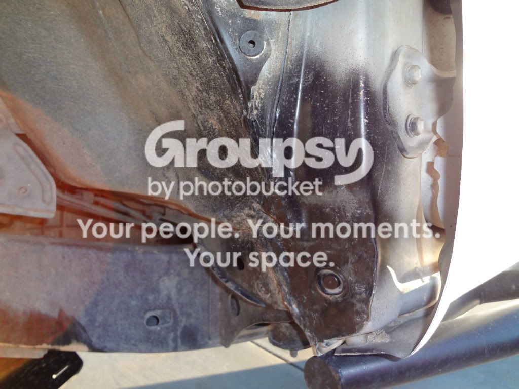

Here are a couple pics of how i had to clearance the front of the truck for the 315's
This shows the fire wall after i used a BFH and beat it back about an inch, Not too bad IMO. Tubbing may have to happen, Smashing it first was a good option IMO. The tubbing would have to go up quite a ways and i was tired of working in it
DSC00077.jpg~original

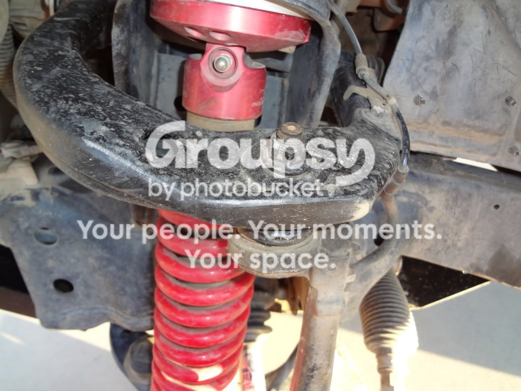

UCA trimming, I still think I have a little uca rubbing even with the 1/4" wheel spacers. I cut a piece off and welded plate in to cover the hole. This was not my favorite idea, but these really dont see the weight of the truck and i welded thicker material than what i cut out. If i have an issue its okay because i have a few spares
DSC00076.jpg~original

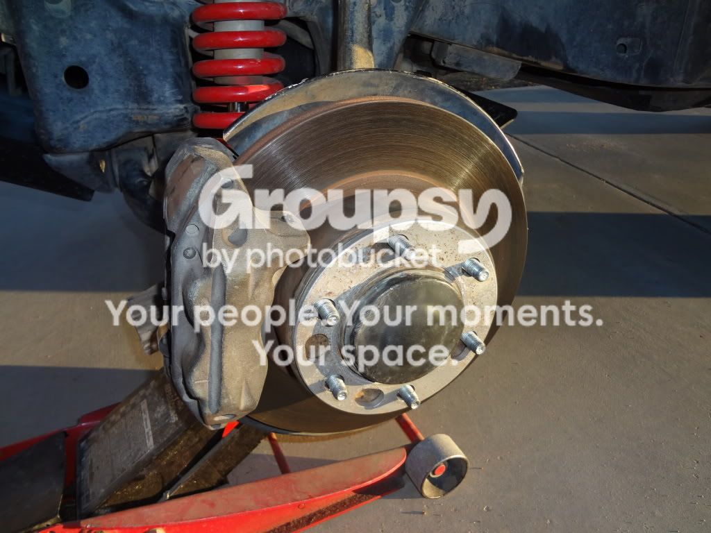

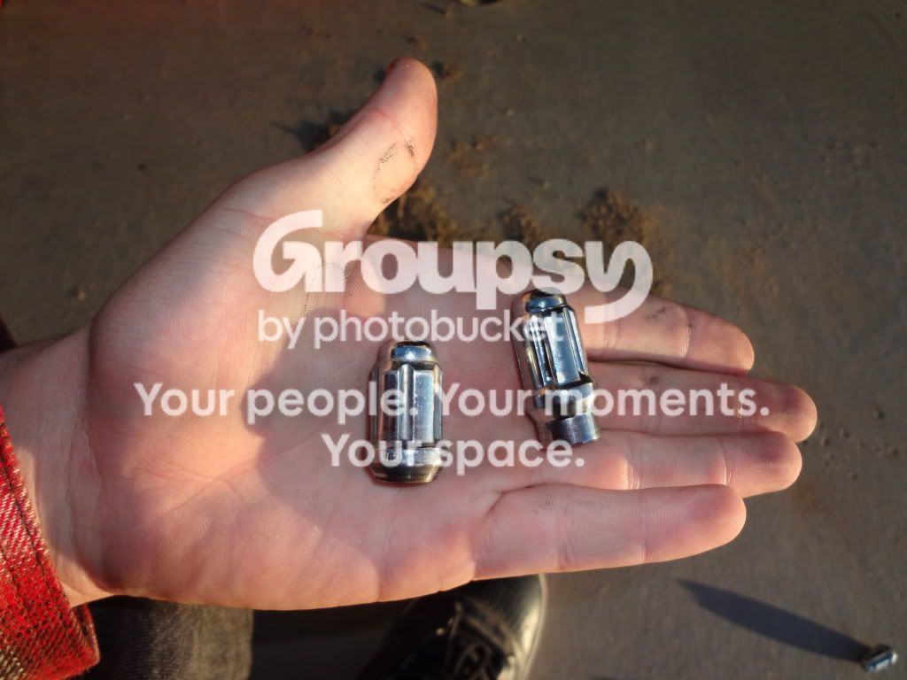

1/4" wheel spacers, and tacoma rear wheel studs installed. These studs are abou 1/4" longer than the fronts and i thought it would be enough to get some good thread contact with the spacers, however i was not happy with the thread contact. I would say it was only about 3 threads... Not safe. My wheels have a super thick mounting surface and the spacers made it worse.
DSC00075.jpg~original
So I found these Gorilla spline drive ET style lug nuts that match my current ones. My old ones are on the left and the new ET style on the right. I only got enough for the front since the rears work fine with the regular style ones.
They fit tight in the wheel but are perfect. I now have about 8 Threads of contact. Much better

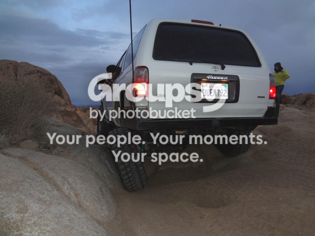

Im about to go wheeling tonight (hopefully) on a local rock garden by my house. Ill take my new camera and get some pics

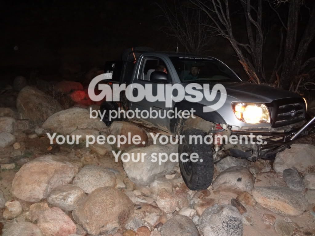

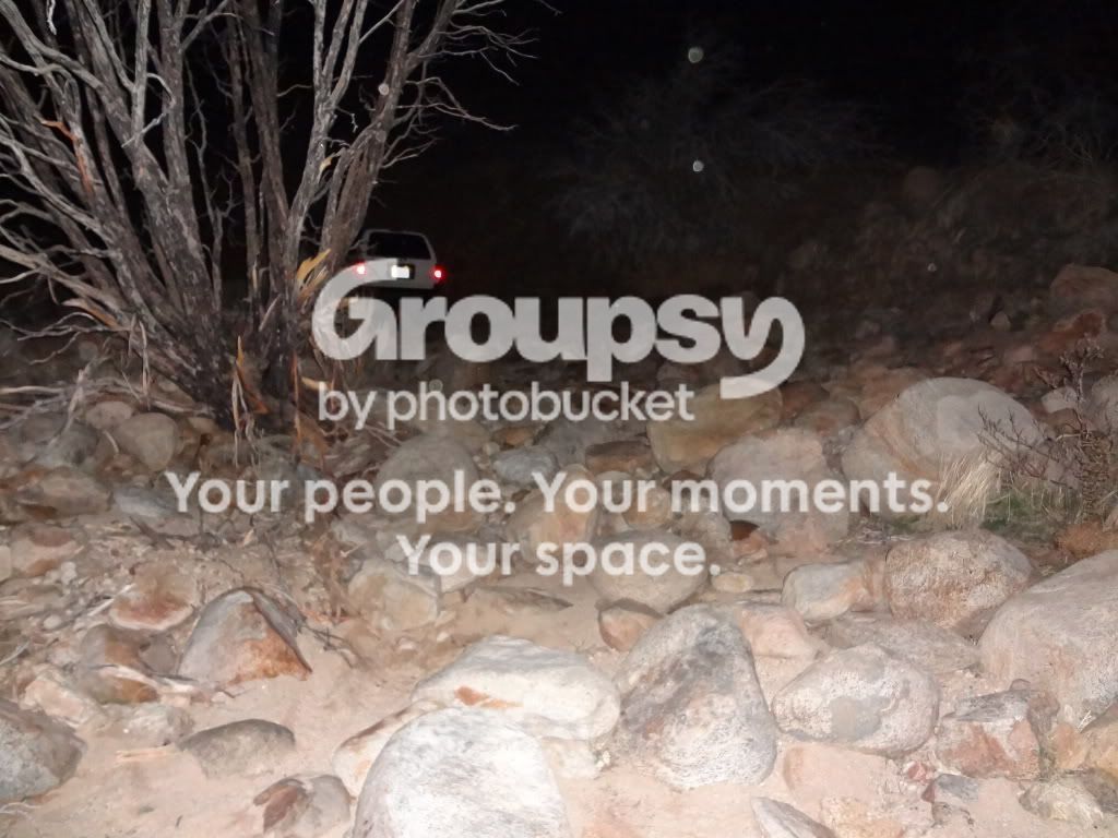

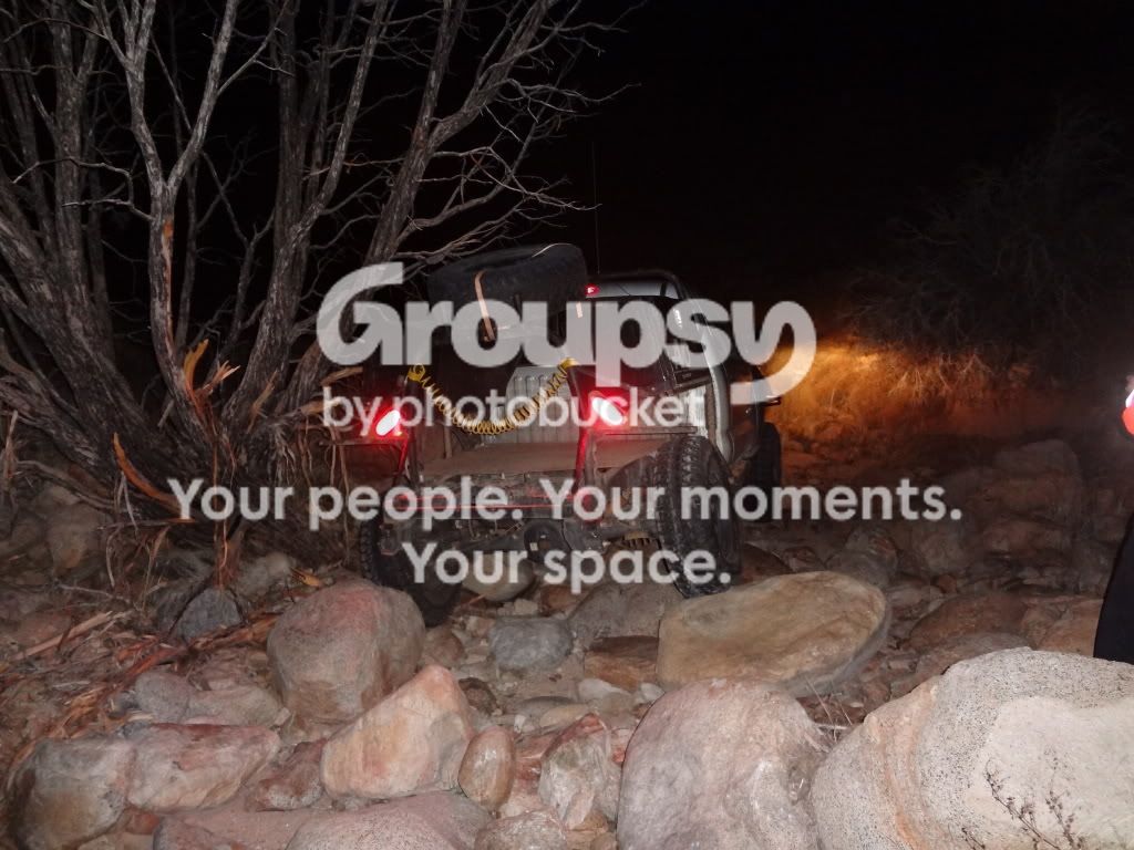

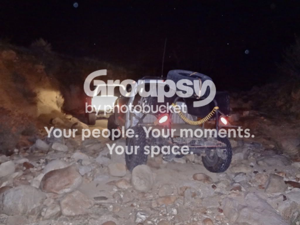

went and did a little night wheeling last night in hesperia. Had a good time, although we didnt finish the trail. Its a long canyon, and has about 2 maybe 3 miles of a consistent rock gardens. Everything is working great
Heading into the canyon
DSC00097.jpg~original
Loving the 35's
DSC00101.jpg~original
This is a normal section on this trail. Its weird because its just a bunch of boulders. There are a couple really good ledges up further, but we didnt make it

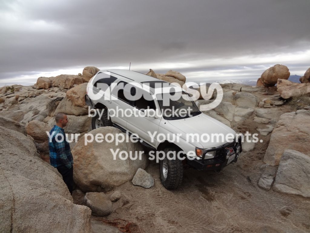

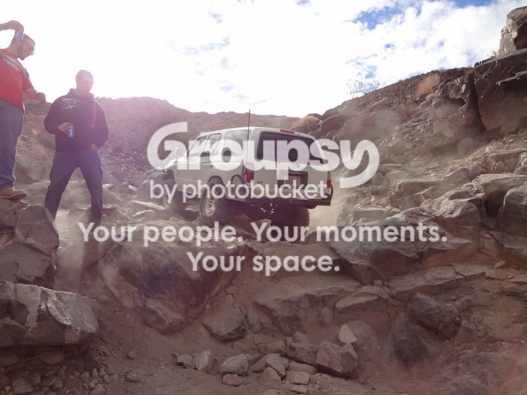

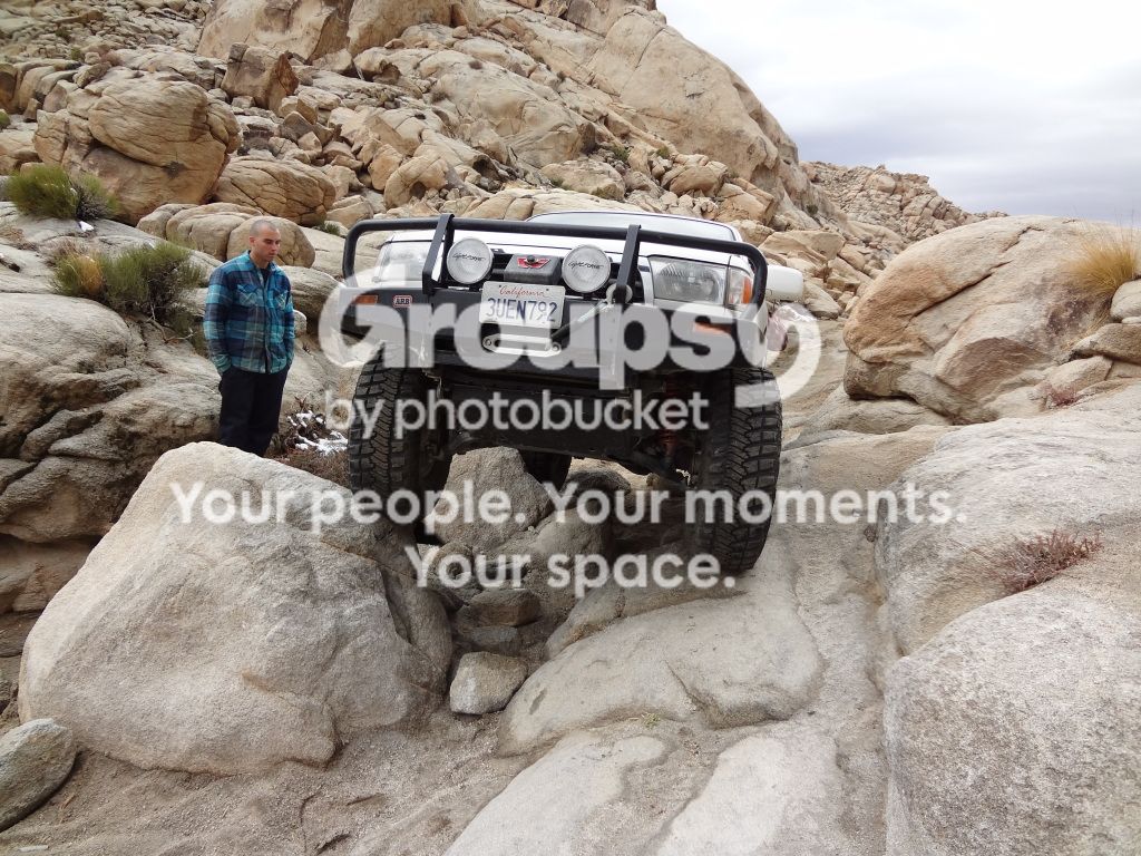

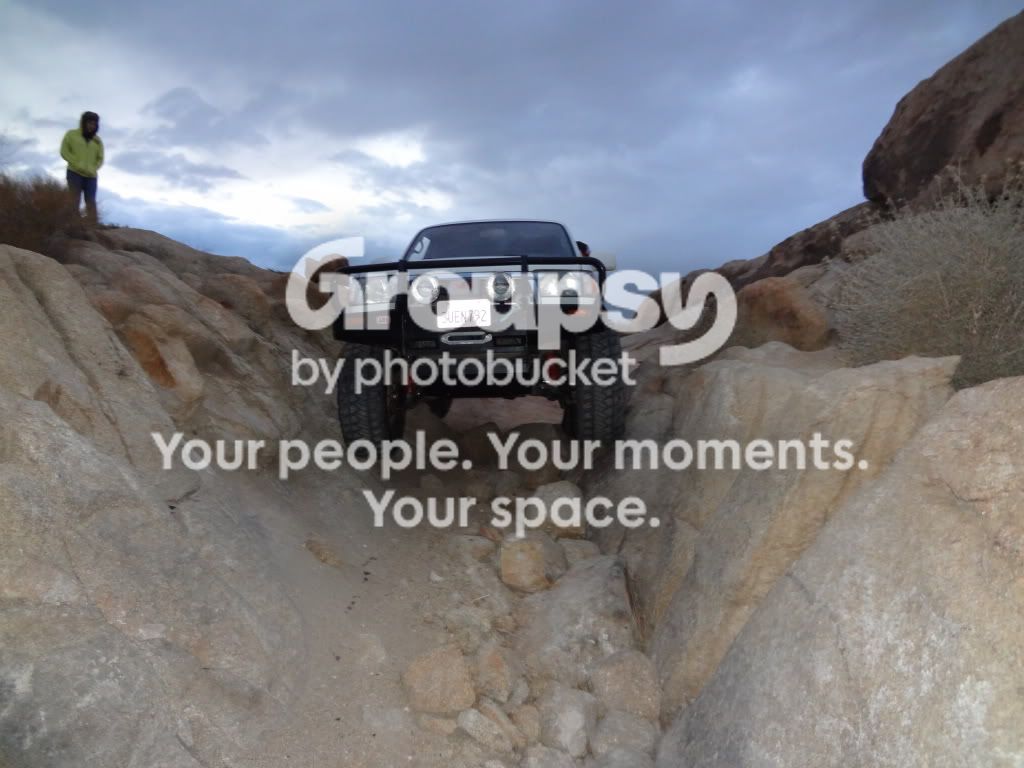

And here are some pics from yesterdays wheeling trip at Cougar Buttes. I rarely take pics but yesterday i was in the mood for it LOL
DSC00286.jpg~original
DSC00276.jpg~original
DSC00251.jpg~original
DSC00250.jpg~original
DSC00246-1.jpg~original

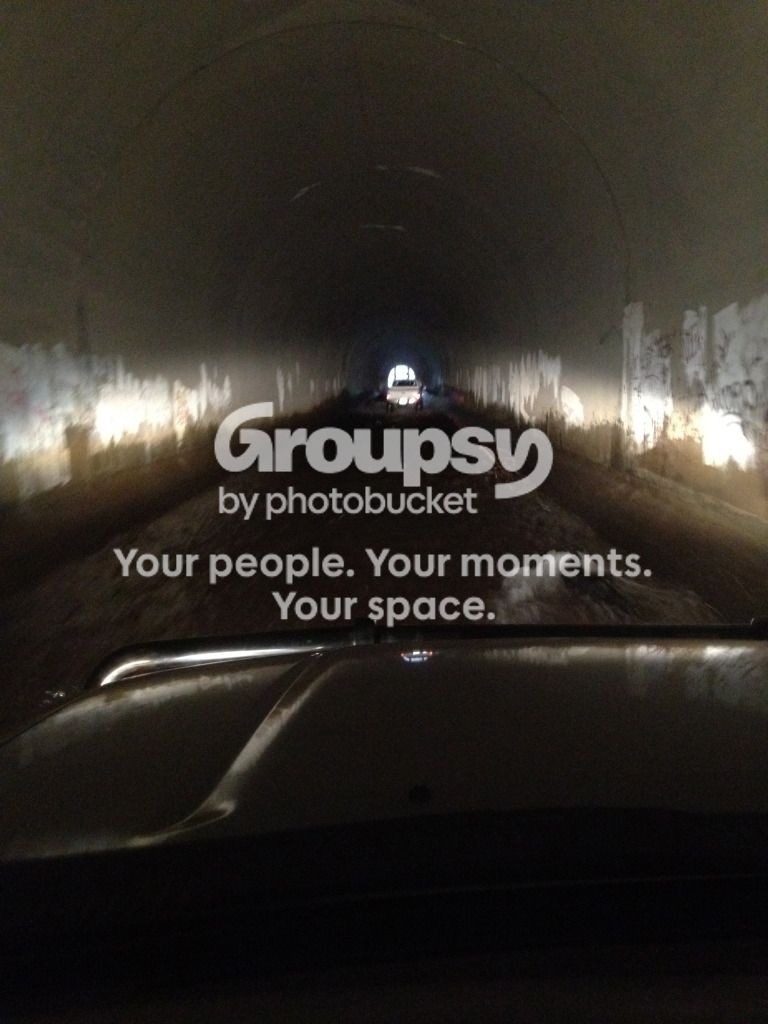

And a couple from deep creek. from last week

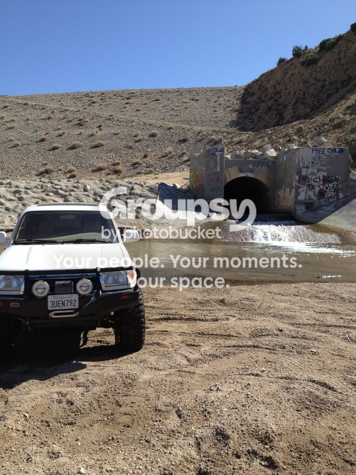

Such nice weather down here. You know you want to drive through that tunnel through the dam. Gotta watch it on the spillway. Its DEEP Its over your hood if you try and go in the middle
IMG_0102.jpg~original
:) so much fun. Great little local spot. The tunnel is about 500 ft long. maybe 24" deep of water in the beginning then it gets shallow
IMG_0103.jpg~original
