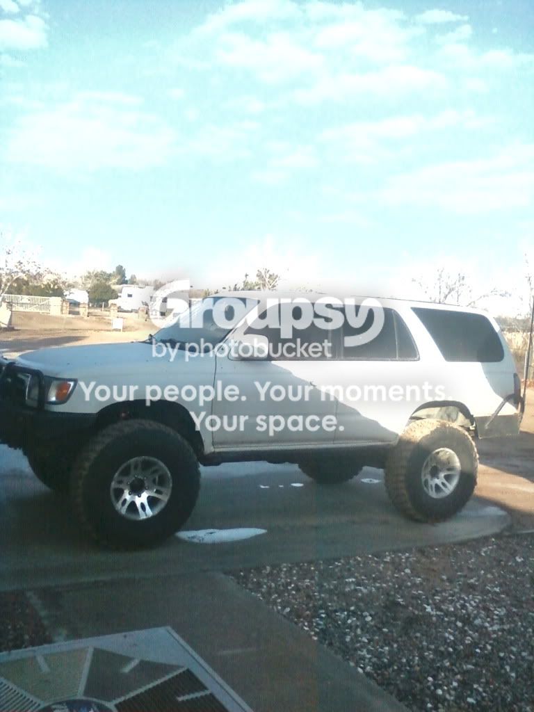

Got most of the work done!!!
315/75r16 good year Mtr's are on. 5.29s are in and its all good.

I have had to do so much work. I have more pics on my phone from all the work, The front diff came from ECGS with an open carrier. I pulled my diff, split the case took the locker out. put my locker in the front diff and put it in the truck on friday. Then on Saturday i set up the rear diff with 5.29's, all new bearings and a solid pinion spacer. That took pretty much all day. The set up looked great and works fine. I got the pinion depth on the first try. I have put about 120 miles on the gears and they are fine (the front gears move because of the locker). 5.29s and the 5spd are perfect for around town and the little i have had it in 4 low seems great. On the freeway they are a little low and i keep the speed around 65 to keep the rpms right about 2800. Anyways on sunday i put the rear third in. filled everything up with oil. got the tires mounted did a few other things. Monday i trimmed and cleaanced the front. WHAT A PITA> i decided against tubbing since i was irritated and exhausted so i used the BFH and made room. Had to trim a tad off off the uca... I have spares if this causes an issue but i welded some plate on em and they should be fine. Today i added longer wheel studs and 1/4" wheel spacers up front and eliminated any rubbing issues on the uca up front.

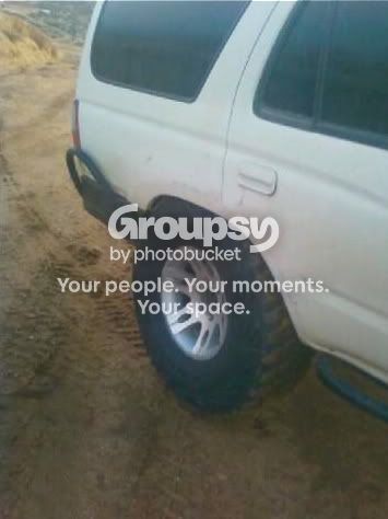

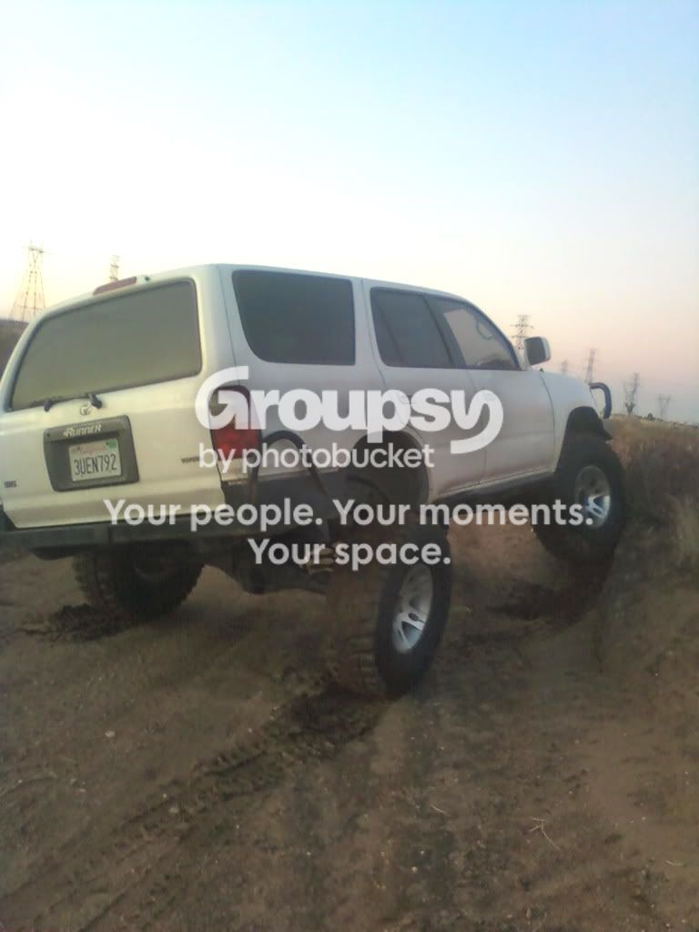

and here is a pic showing the rear fit while flexing
Stuffed, not fully on bumps. I only have to trim just a little bit off the rear bumper. Im so glad these tires fit in the wheel wells

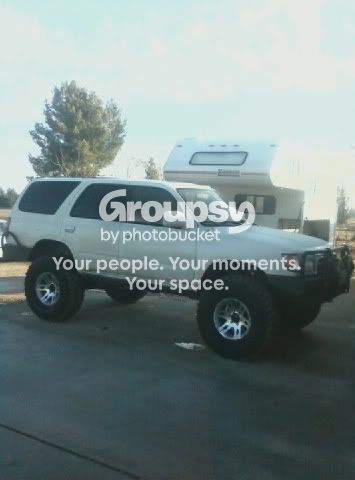

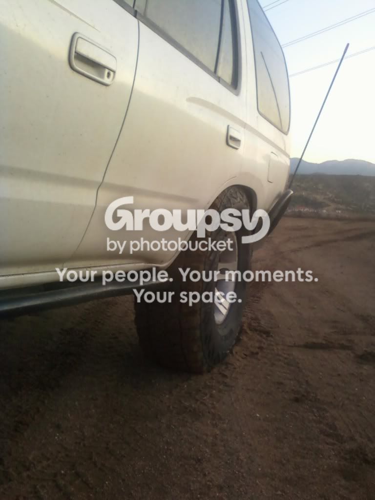

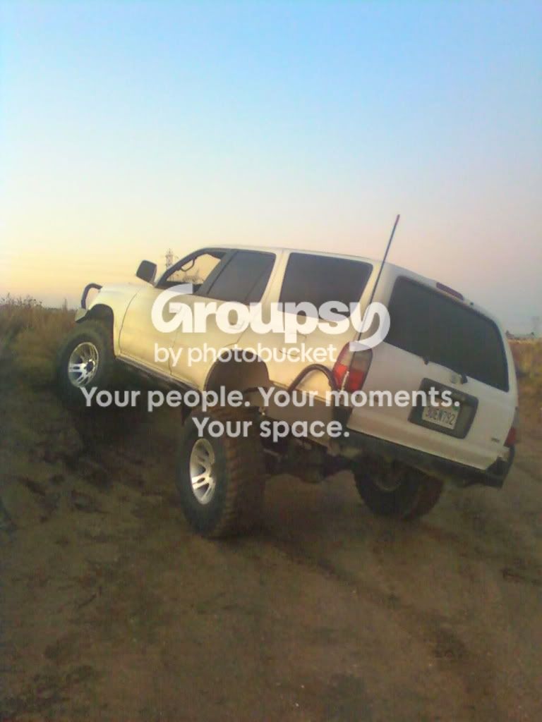

THESE MTRS ARE BIG. they are 35" with the weight of the truck on them and they are about 12.5" wide on my wheels. they are true to size and have cause some major headaches, but when i went out to flex the rear i went up some stuff i couldnt with 33's and did it idling. SO STOKED RIGHT NOW!!!
Couple more

You should post a side shot on level ground so we can see just how big those bad boys really are! Glad you're stoked on the 5.29s! I got your text that you drove up Cajon Pass in 5th, that's great! I have to turn my O/D off and climb it in 3rd with the auto.
That looks good. How high is the 4runner riding now?

And my truck rides about the same now. The wide tires seem to make It a little more stable.
