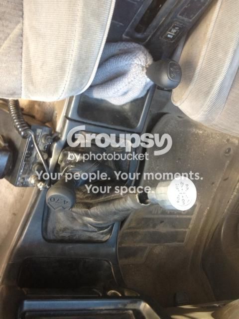

:). been working on this one, Its in. just a few minor things to finish up. Trail gear adapters and trail gear 23 spline 4.7's

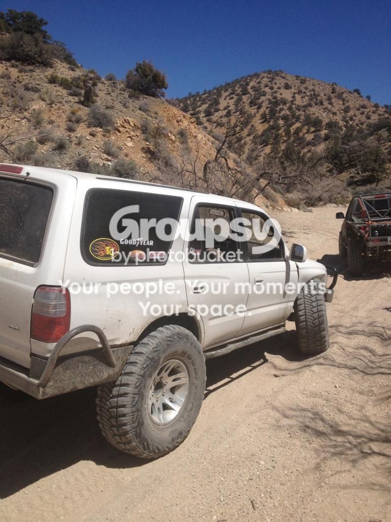

Some sweetness from this last weekend.
Broke the lower ball joint bolts. Actually appears 2 fell out and 2 broke off. I just torqued these 2 weeks ago because they were finger tight. put 50 miles on it and then this. I assume the loose bolts got fatigued. I was able to get one of the broke pieces out with some wire cutters. and slapped some random bolts in it and drove home. Good thing the seat bolts are the same thread :) as well as the trans mount and my crawl box mount.
Im lovin the new fender styling. I gotta get a pic of my sweet body work C-clamps, pry bar and a hammer is all you need. The only reason i even bent it back is because the fender was keeping the door from opening and it was laying slightly ontop of the hood. Now that this is bent let the destruction of this thing begin :)
