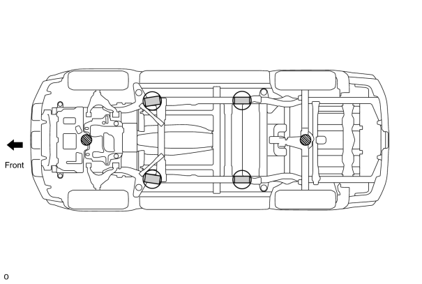

Here's the instructions out of the repair manual .
(a) Work on a level surface. Use wheel chocks at all times.
(b) Use safety stands with rubber attachments as shown in the illustration.
(c) Set the jack and safety stands exactly under the specified locations on the vehicle.
(d) Do not work on or leave the vehicle supported only by a jack. Be sure to support the vehicle with safety stands.
(e) When jacking up the vehicle, first release the parking brake and move the shift lever to N.
(f) When jacking up the entire vehicle:
(1) When jacking up the front wheels first, make sure wheel chocks are behind the rear wheels.
(2) When jacking up the rear wheels first, make sure wheel chocks are in front of the front wheels.
(g) When jacking up only the front or rear wheels of the vehicle:
(1) Before jacking up the front wheels, place wheel chocks on both sides of the rear wheels.
(2) Before jacking up the rear wheels, place wheel chocks on both sides of the front wheels.
Jacking(round,front and rear) and jack stand positions

Thanks Harper - I'll think I'll be putting all 4 tires under the frame in the process.
I don't understand releasing the parking brake & putting it in N - doesn't that maximize the chance of one end moving while the other is being lifted?
Good advice about the tires underneath.
I use 6 stands. 2 are for backup and move around to whichever end I'm working under.
My jack stands(safety stands) don't have rubber attachments.As stated I always put a couple of the wheels I take off and put them under the truck for extra safety.
Good post!!! Safety first.
The wheels under is a nice touch that many use on the trail, when things are not as readily available.

Rather use good wheel chocks to prevent the wheels from moving, using the parking brake and driveline can load up a little and cause more shift.
Also it is best to get all 4 wheels off the ground with the wheels still on the axles, till everything is stable. This way of something happens the truck will land on the wheels.
I will also be easier to lift and stabilize the front with IFS first before the rear axle.
