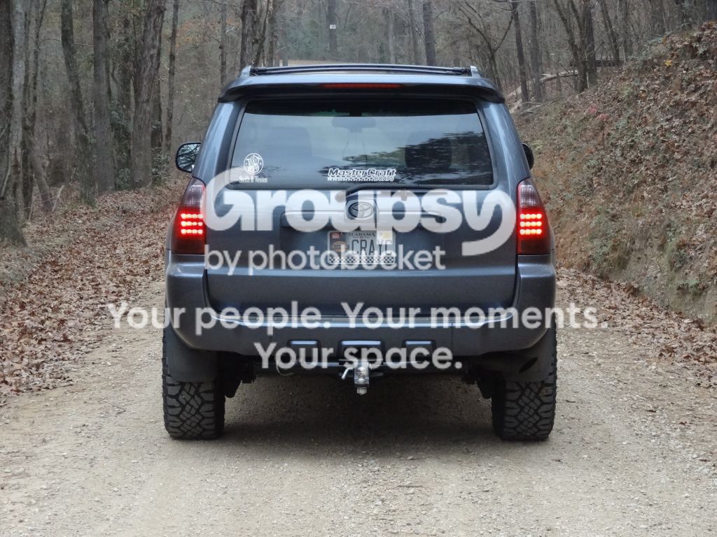

2006 Galactic Gray Limited 2WD V6​
Exterior
Blacked-out stock Limited rims
275/65/18 Goodyear Duratrac
BAMF Sliders
AVS BugShield
Blacked-out Toyota and Limited emblems
VHT coated (blacked-out) Taillights
Debadged rear
gotta few stickers (+12 horsepower on those babies):biggrin2:
Suspension
OME 885/Toytec Superflex
Bilstein 5100s
Extended Rear Sway-Bar Links : http://www.toyota-4runner.org/4th-gen-t4rs/141258-custom-ish-extended-rear-sway-bar-links-write-up.html
Lighting
30" Hanma LED Light Bar on a Defiant Short Tube
DDM Tuning 3000K HID Fogs
V-LED's Cool White License Plate Lights
Interior LED swap by Pfran.com

I finally gave in to my want to black it out, so started with the taillights! VHT Niteshade spray works great, just use some fine sand paper to WET sand the lights, and then apply however dark of layers you want until you get the right color for you!

The Lift came next, as my Firestone's had finally worn out after 58 thousand miles (great tire, highly recommend to anyone looking for a great road tire) so I was due for an upgrade!
One last shot before putting it up on the jacks!
2012-04-30152841.jpg~original
Installed Daystar and FJ Coils, didn't measure stock heights, but ended up at 39" front and 40" back, measured to middle of fender wells, AFTER tires. Slight change in ride, stiffened up a little, most likely due to FJ coils. Other than that she still rides like stock, minus a bit of pep due to tire rotational weight.
Install was a definite PIA due to multiple bottle jack failures trying to reinstall struts... Back literally took 20 minutes, half because we replaced the end link bushings, and that takes a little elbow grease because the bolts sit at an awkward angle.
Overall so happy with the stance, and now after moving fender liner forward, right tire only rubs the bumper at one tiny spot when it hits just the right awkward angle...
