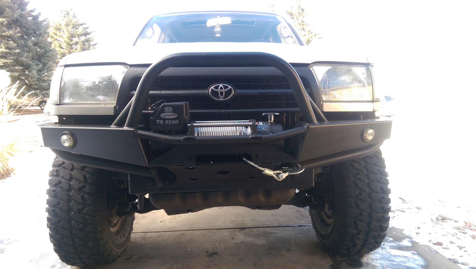

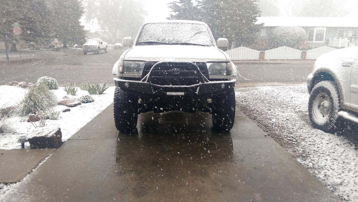

Got her mounted up yesterday. Was 70* yesterday when I installed the bumper. Today is , well you can see on the last pics. Ohh and driver side lean is worse now there is more weight on the front. Left is near half inch lower front and rear. Think I need to add a trim spacer in the rear driver side to maybe push the front driver down and stop some of the lean.

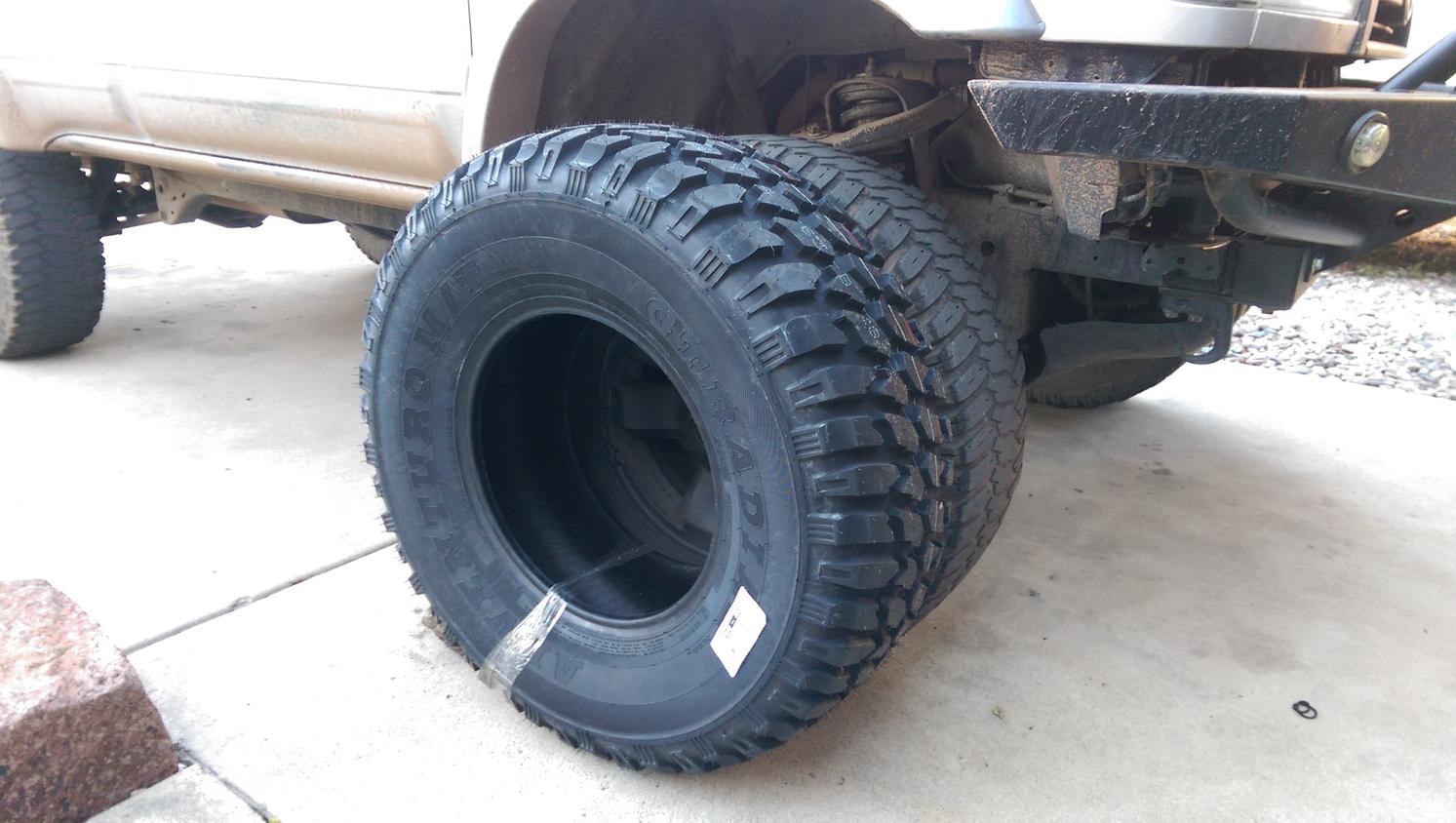

Some pics of my new GT Radial Adventuro M/T 305/70r16. Got them for $580 shipped from Discount Tire Direct on ebay. Cant beat the deal. I have known of Jeep guys running these and they work out pretty well.

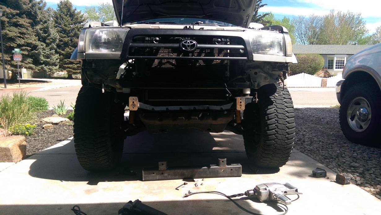

Finally filled that little hole in bumper like it should be. Still need to drill out holes for fairlead. My crappy drill was not cutting it. Also some pics of my new toys. Gas assisted 115v mig wire feed welder and an acetyene torch can't wait to play.

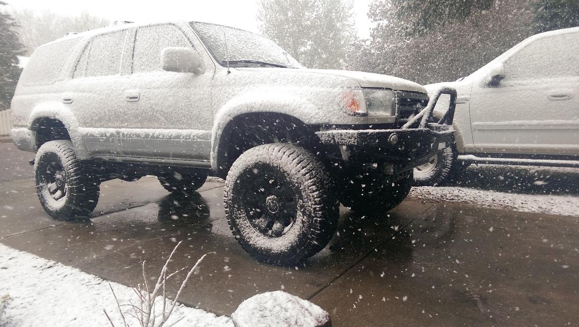

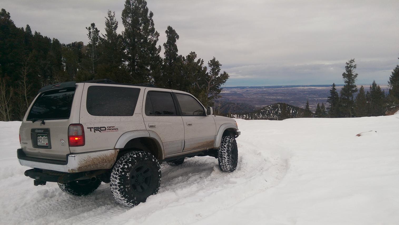

Tested the winch out today. Worked great. Actually went into the snow drift instead of avoiding them. Lol. Pulled fast. Did not lag or whine like it strained. Was real smooth. For price very impressed. Some pics of truck , my wife's dog Mr. Bean and Colorado Springs.

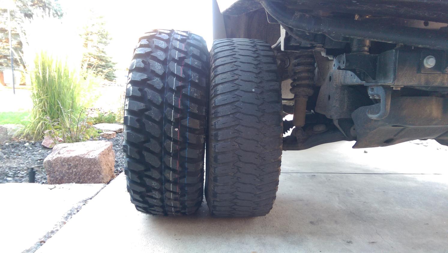

Definitely a solid start. It'll be looking even better with 285's and sliders. Nice work so far.
Thanks but I'm good with my 305's. Lol. Not sure why 285's would look better. Look at my pic on this thread showing my 285's vs 305's.

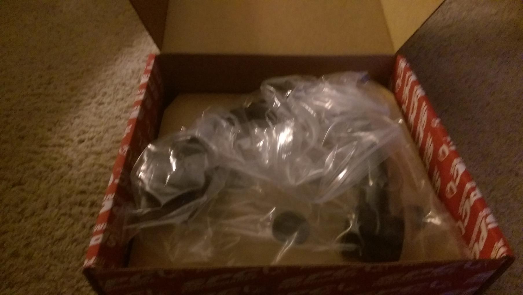

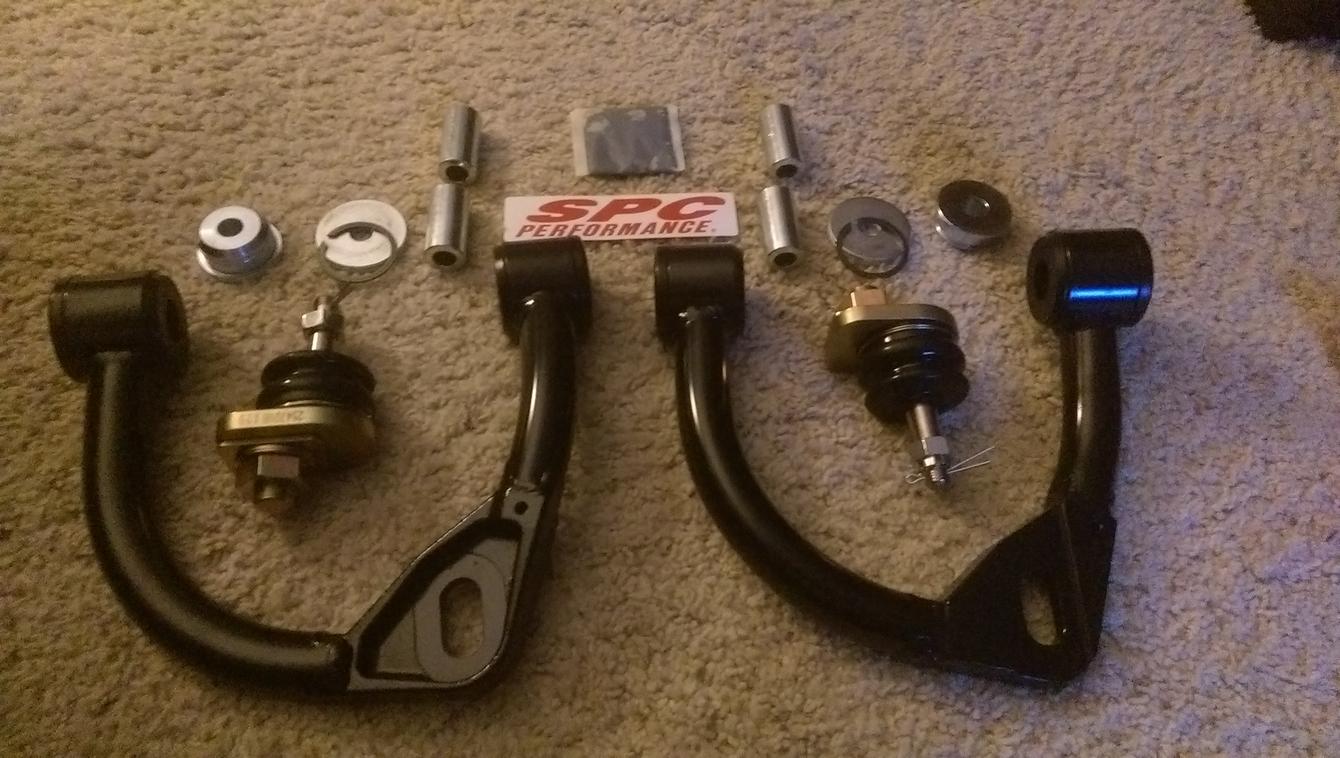

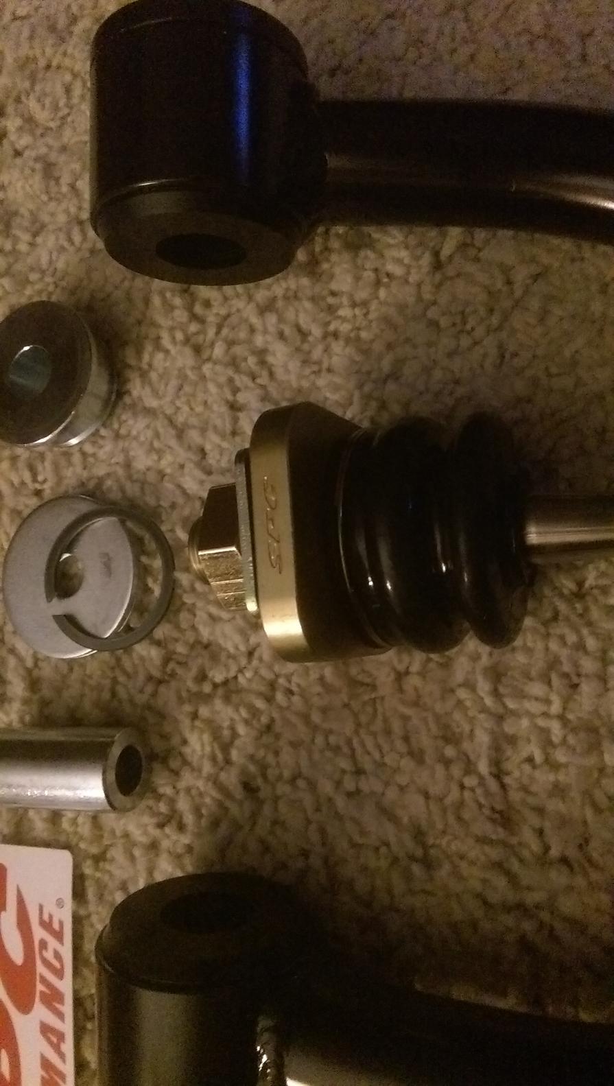

Well after having both my new OEM upper ball joints rip and shoot all its grease out in less than 10k miles and now my second upper right is loose after trying to get alignment. Must be my hard core offroading but decided to get a set of new UCA's so I can try and stop having issues with them.
Picked up a set of SPC(light racing) UPC's from a place out of Longmont, CO for $370 shipped. I really liked the price and the enclosed ball joint. I ordered them Friday and where at my house on Monday, had them before the payment cleared my bank.
I have purchased many different aftermarket performance suspension parts for a few different vehicles and these are very high quality compared to others ive seen. They are made very well, rubber seems solid and the paint is very nice. Here are some pics.

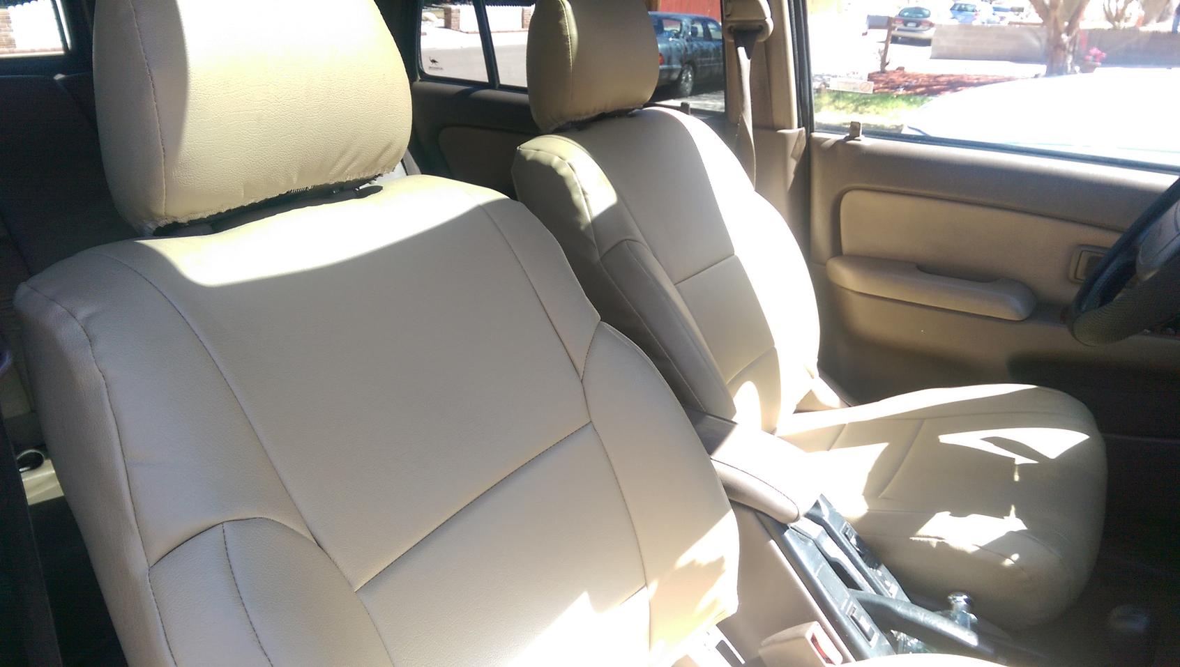

And some pics of my Iggee seat cover . $179 shipped. Love the . Can't tell they are even seat cover .

I just got my SPC arms installed as well. I agree with everything you've said, they are a quality component. I aligned my own truck too, so in terms of alignment, they were very easy to adjust. The nut is a 1-1/4". As most recommend, setting them to setting D is 2+ caster over whatever you had previously. I can attest to that number being very close.

I did setting D, and set the camber slide as close to center as possible. In my case, I would have done better to slide it more towards the outside. It depends on what your camber was before.

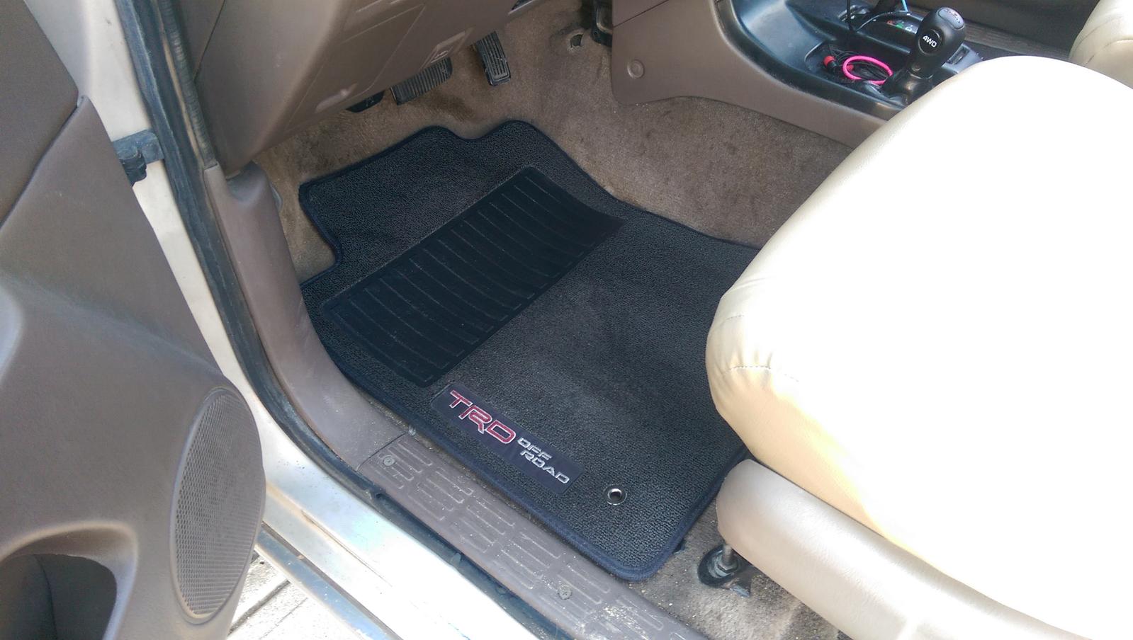

Added some TRD floor mats from double cab 2ndgen Tacoma. $50 shipped.

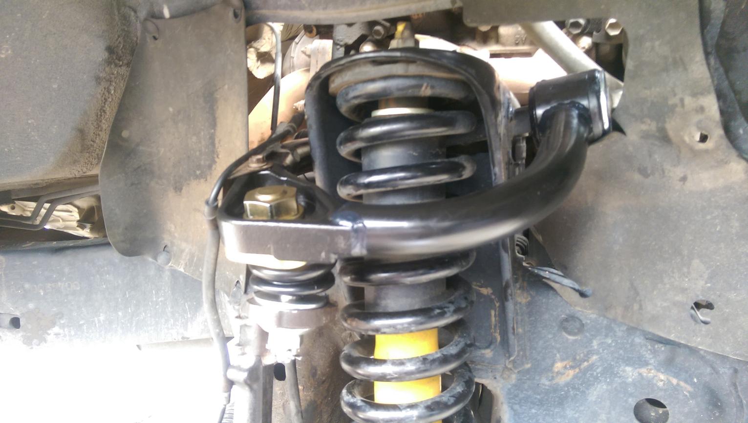

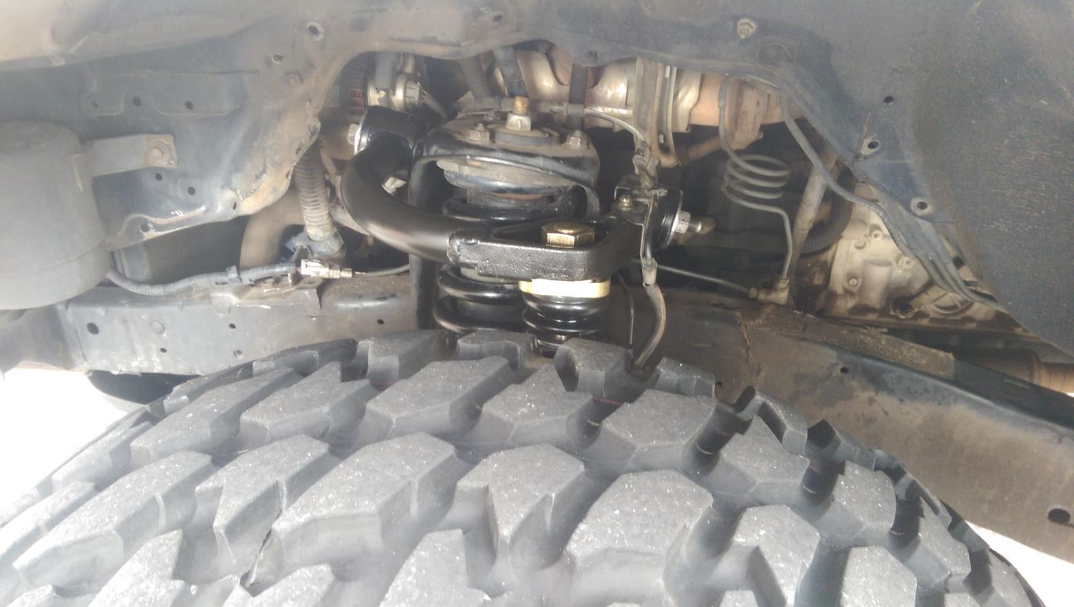

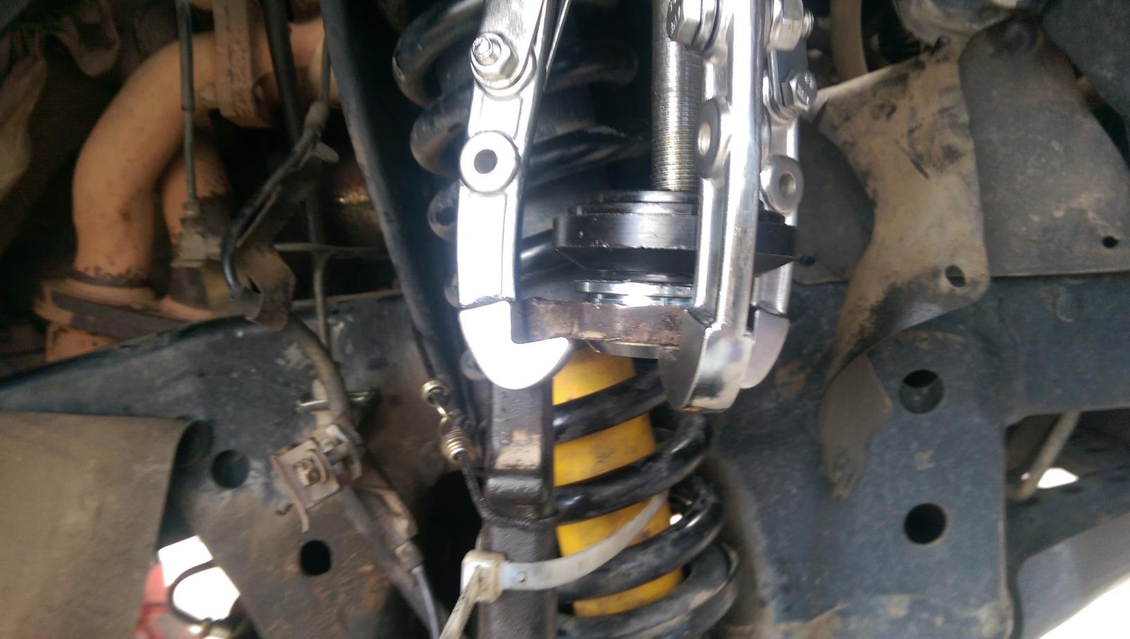

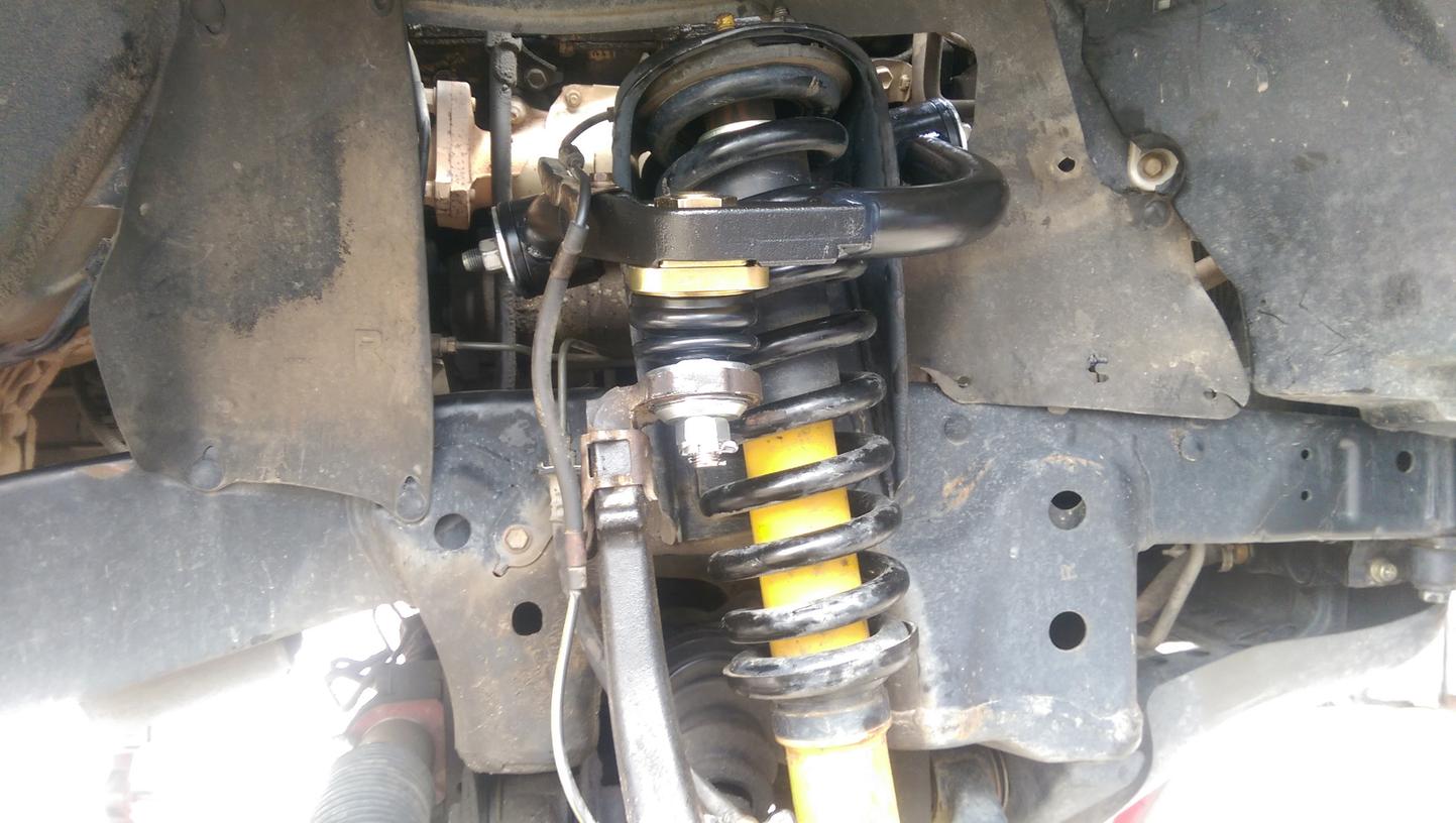

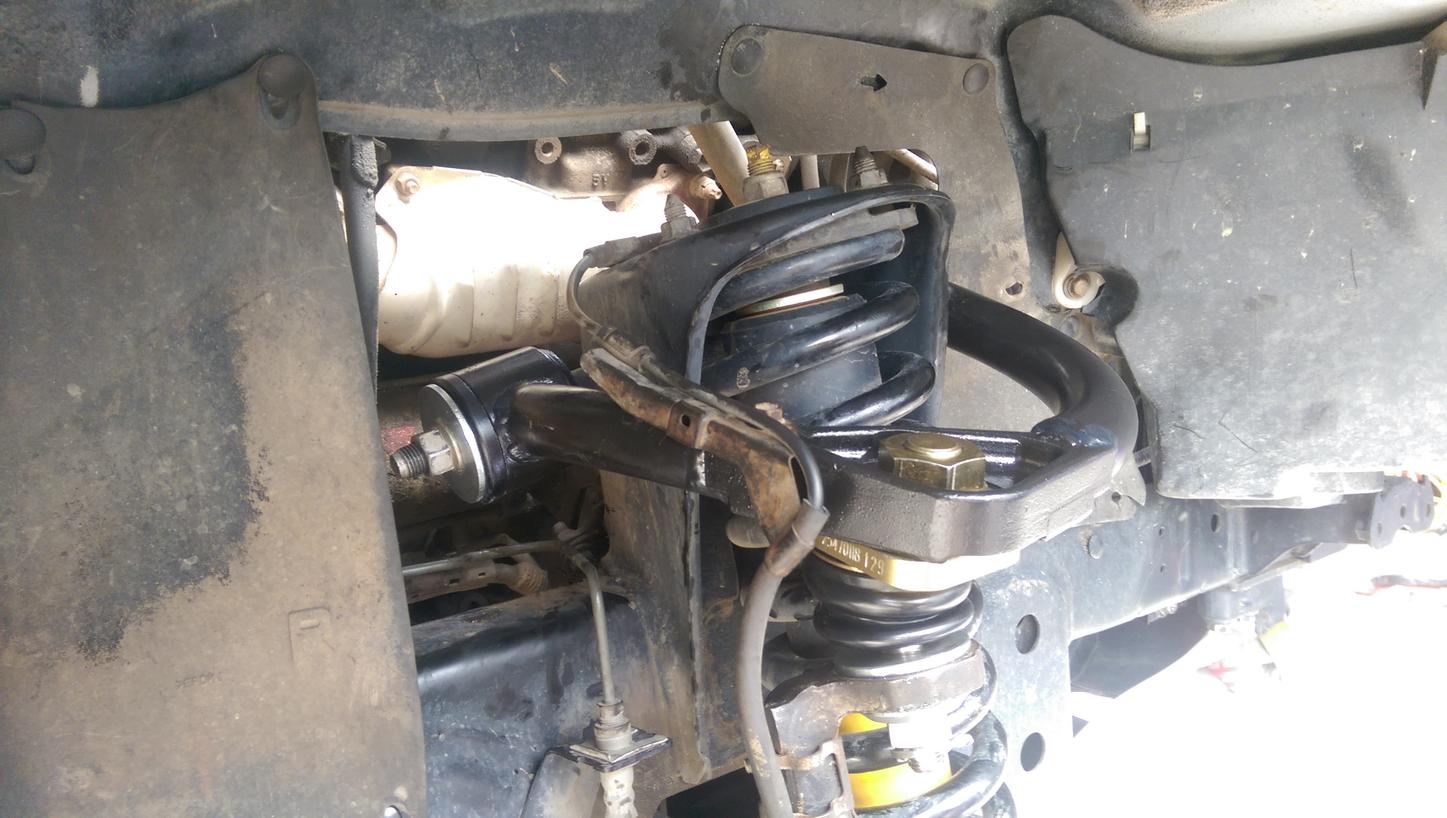

Installed my new SPC. Upper control arms. They where $370 shipped. Some install photos. Had me twin niece and nephew help.
