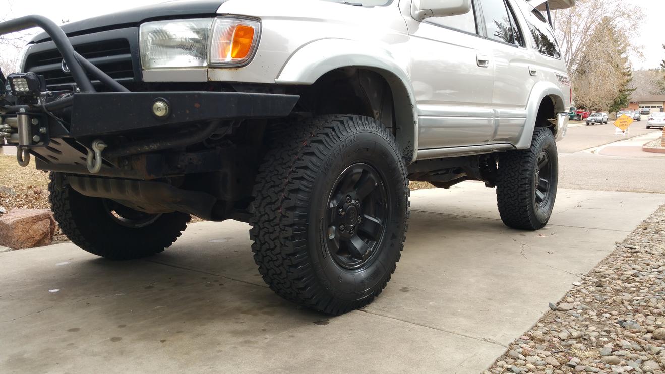

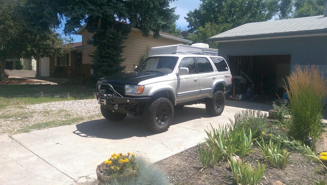

Installed a cericrap cheapo hood. Picked her up for $50 and is new. Not bad for a temp fix till I paint/vinyl wrap and or find a good OEM hood. Im not even huge on sport hoods. Never really liked them and still cant find a clean silver regular hood.

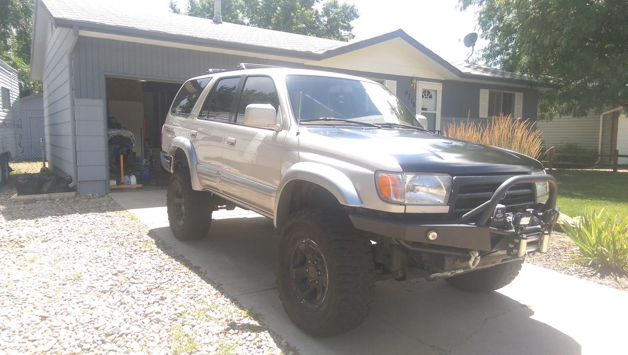

Nice build bro!! But doesnt the separation from your front bumper and the lights annoy you?
Well I got over it untill you said something again. Thanks a lot. No it dont bother me. I would rather run this bumper with the gap than run any other bumper. Thats how much I love it.
Once I get another DD and this goes SAS I will be removing the body lift and no more gap. But that will be some time.
I thought it was the bumber! But its the body lift isnt it?
Yes this bumper is not compensated for the body lift. That way if I remove body kit I dont have to worry about he bumper. You never want to build armor around the body kit, then you can never remove it.

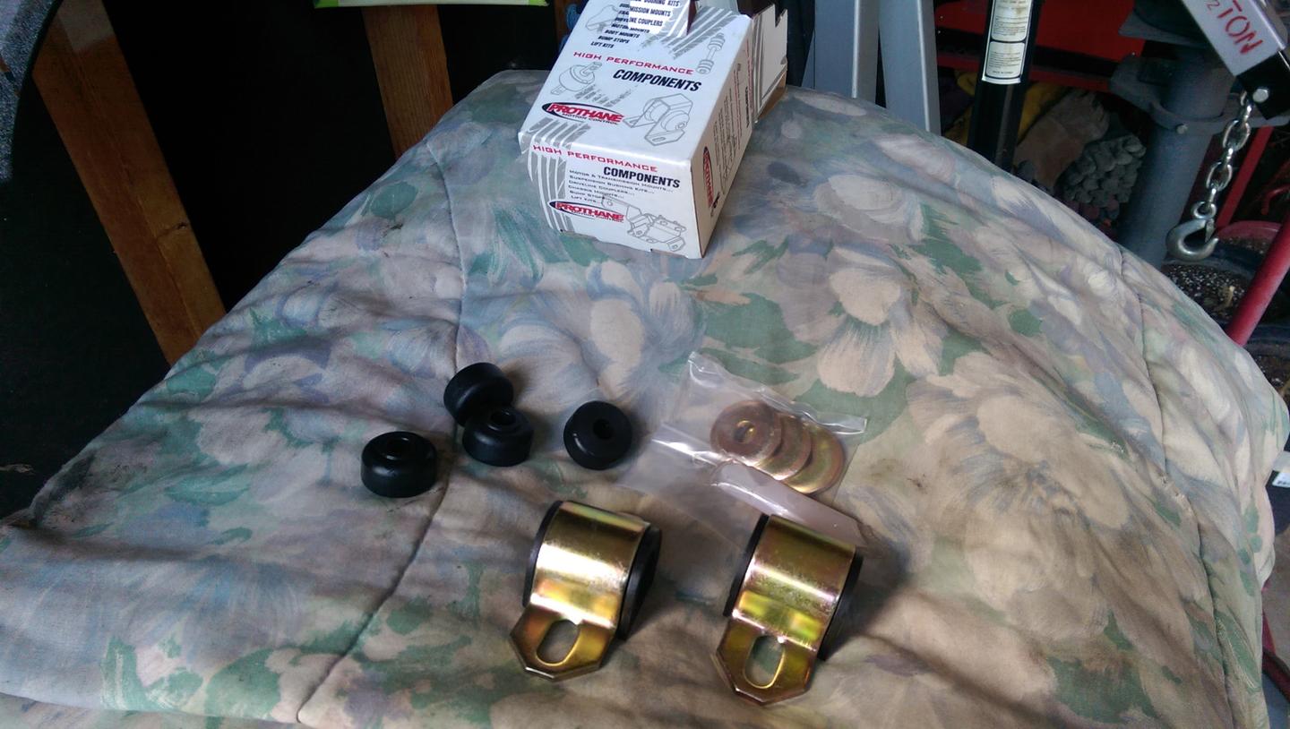

Energy suspension rear poly sway bar bushings installed. Fronts are on way but won't be here for my New Mexico trip. Oh well. She handles 1 million times better. I will never be advocate for removing any sway bar.

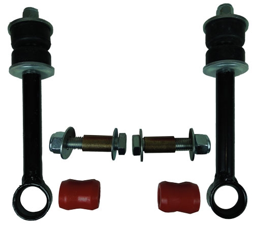

Going to get new oem rear links and LCEngineering tundra front links when I get back. Only $85 for fronts. Posted pic below.

How much longer are those tundra endlinks and what year/model are they for?
They are not much longer at all and are designed for the 1999-2006 tundra. You must enlarge the sway bar eye hole to fit the larger end link. I have not picked them up yet to try them out.
