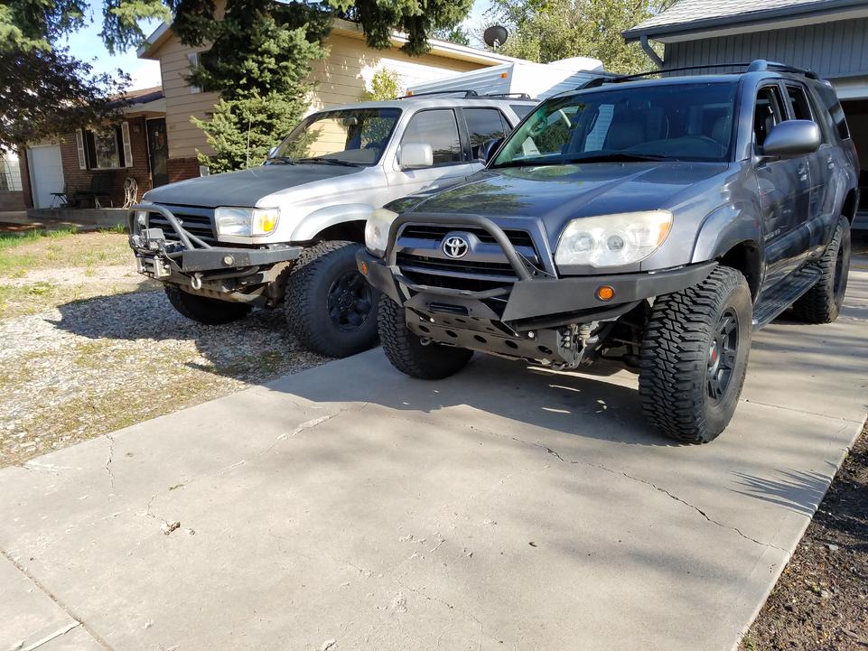

Definitely a solid start. It'll be looking even better with 285's and sliders. Nice work so far.
I was just reading through your thread. I have the same bumper nearly finished for install. Did you weld your mounting bracket to the frame? I'm anxious to get this thing on!
No. I want to beable to swap another bumper on if I needed to. I just drilled and mounted with the supplied bolts and hardware.

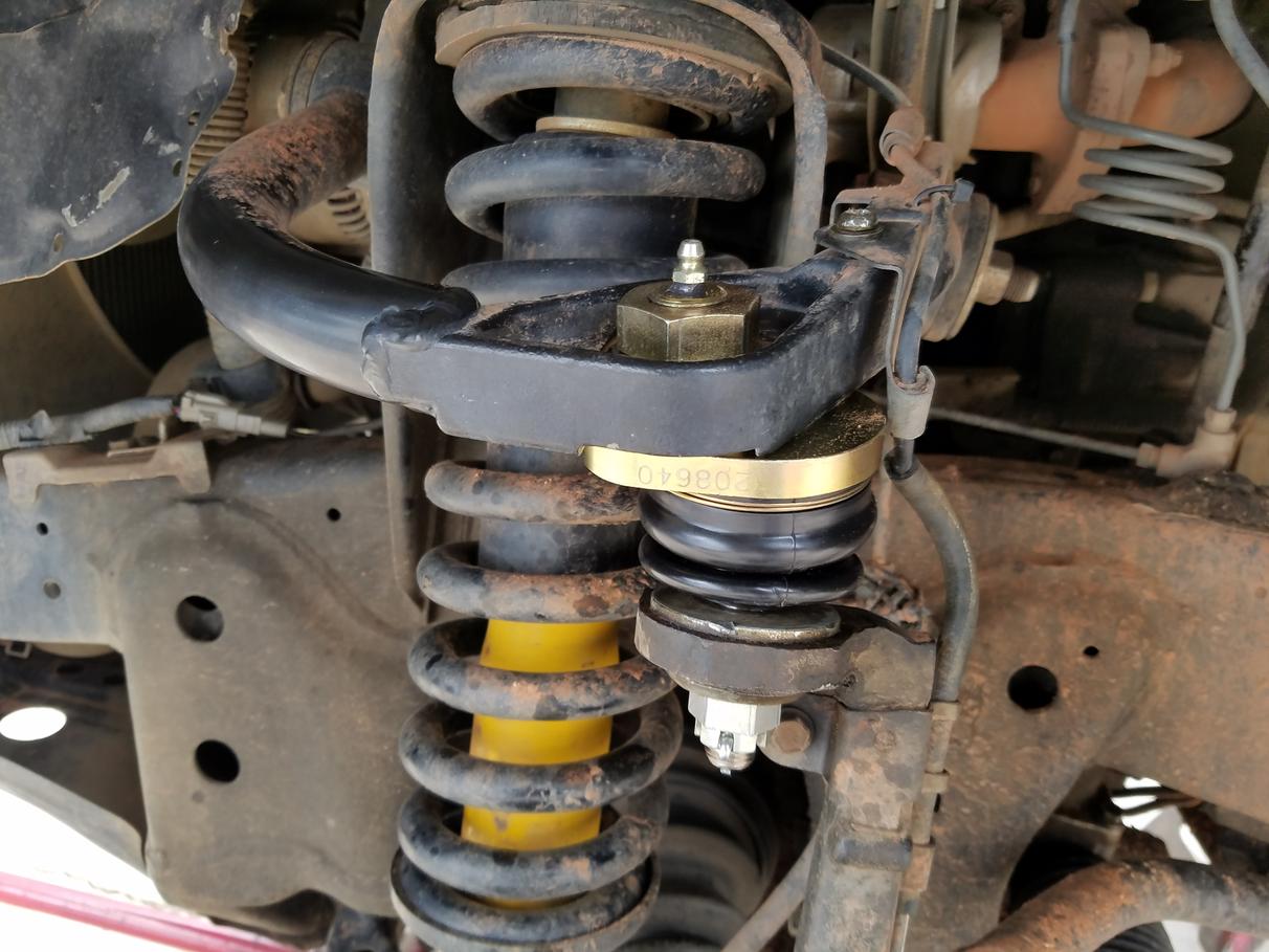

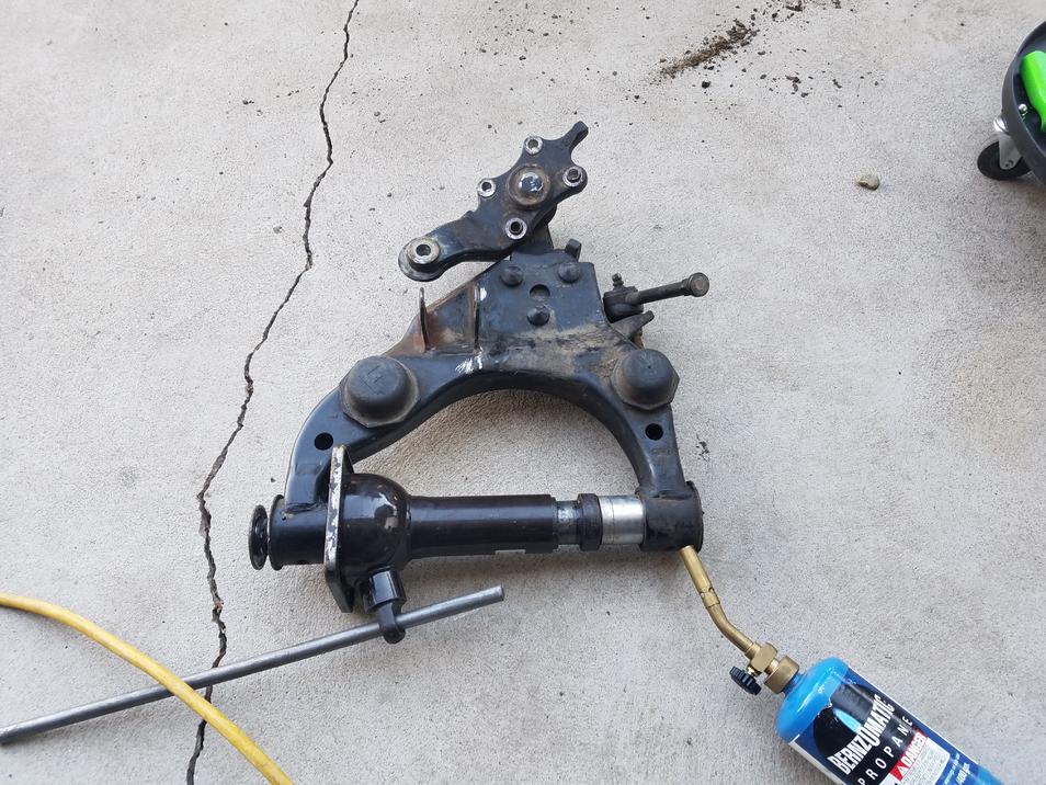

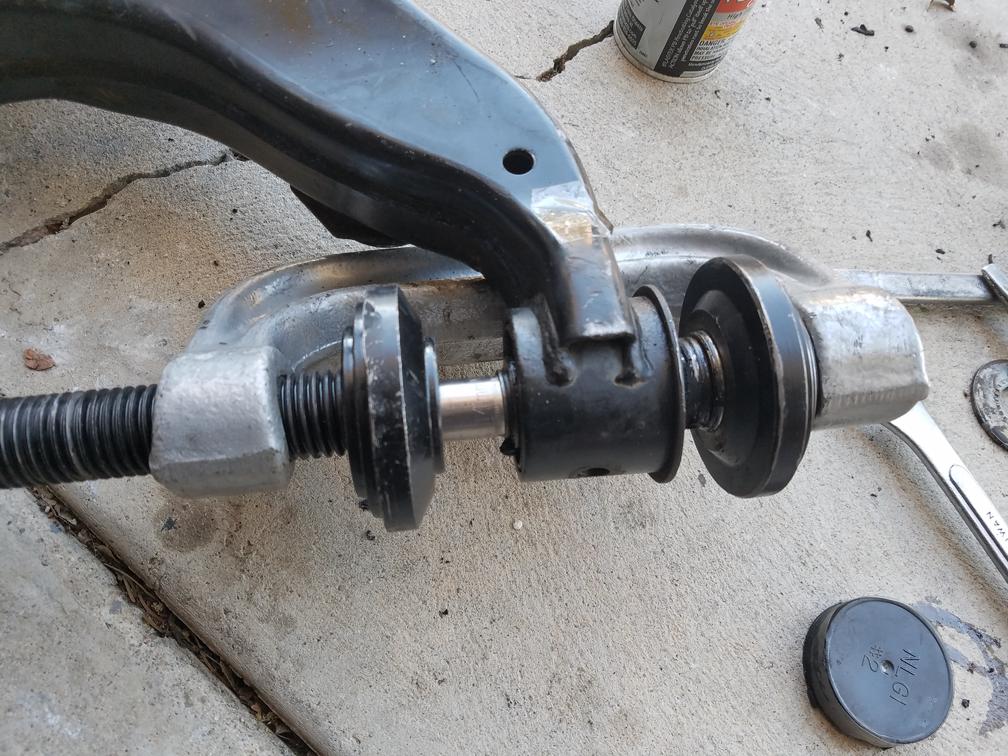

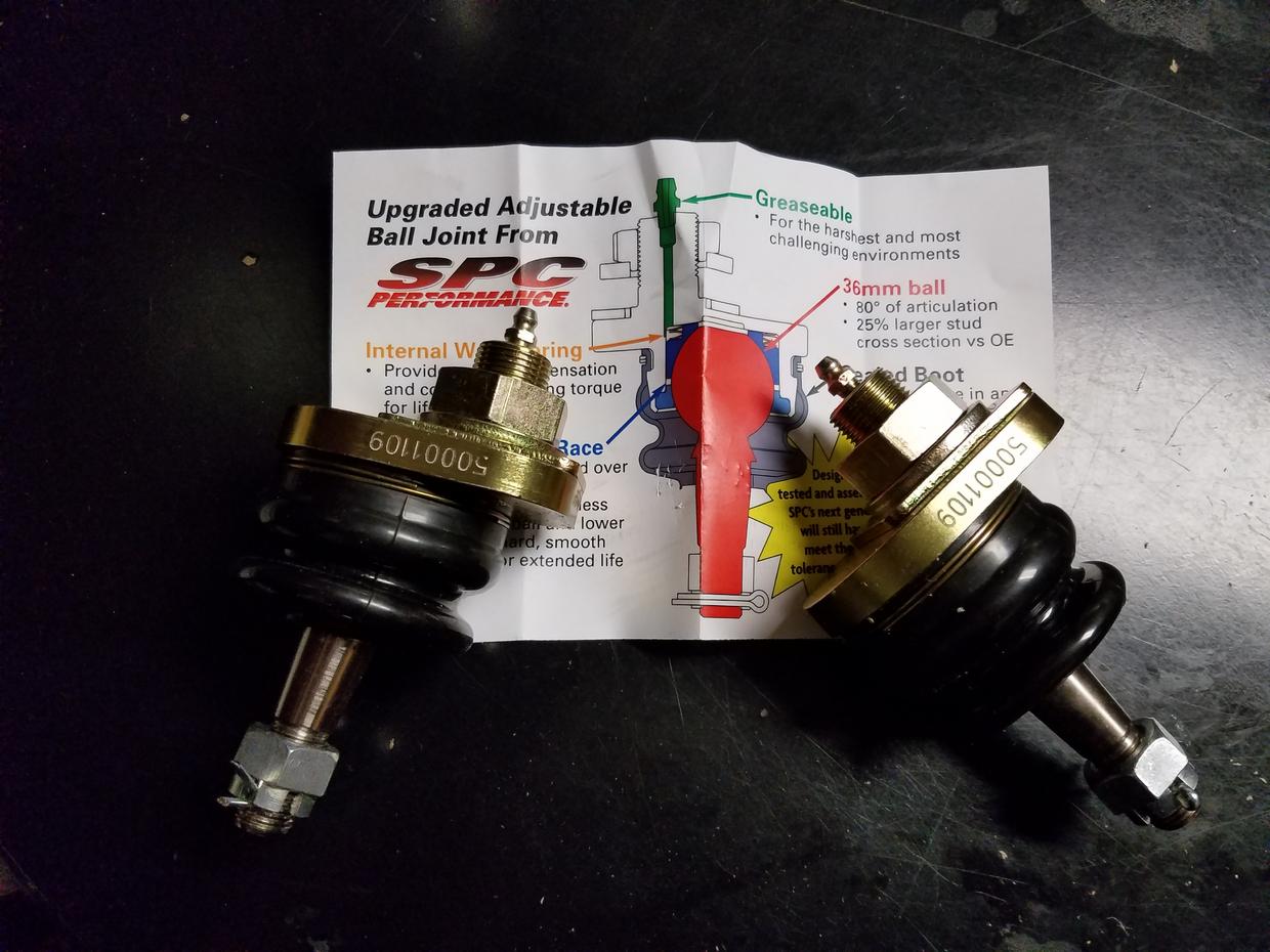

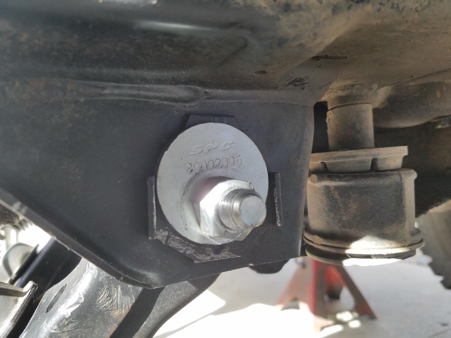

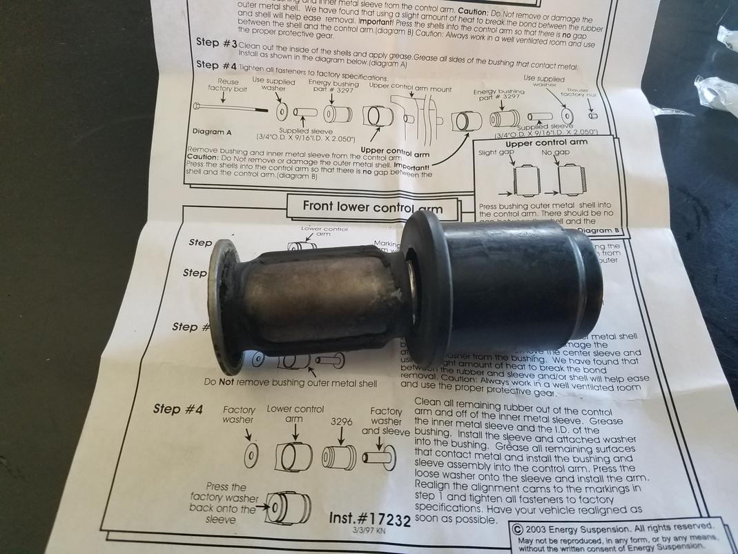

1. SPC revised UBJ w/zerk fittings
2. ES LCA bushings
3. SPC LCA cam bolts w/plastic sleeves
4. Front OME lower shock bushings

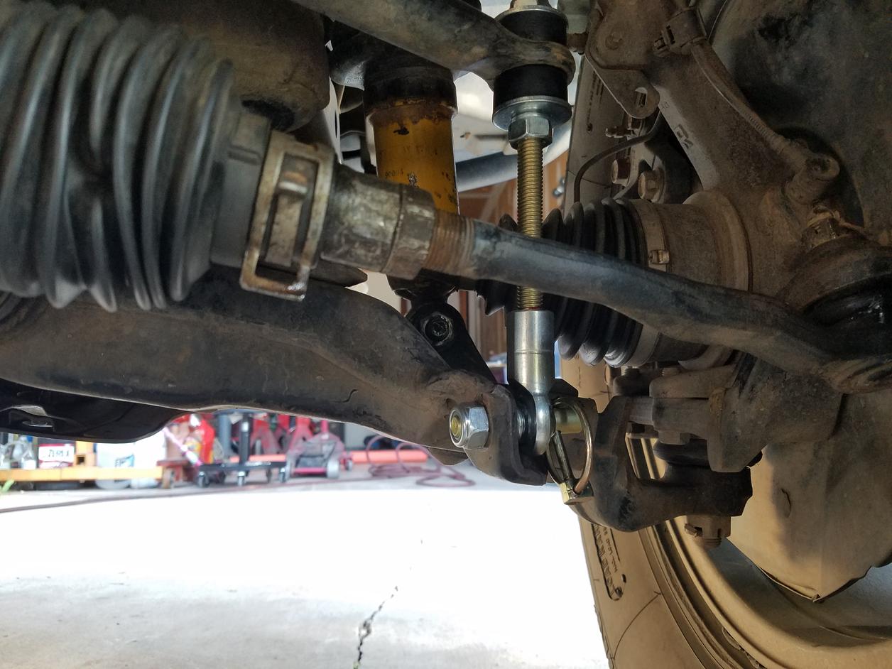

5. Wabfab front sway bar quick disconnect links

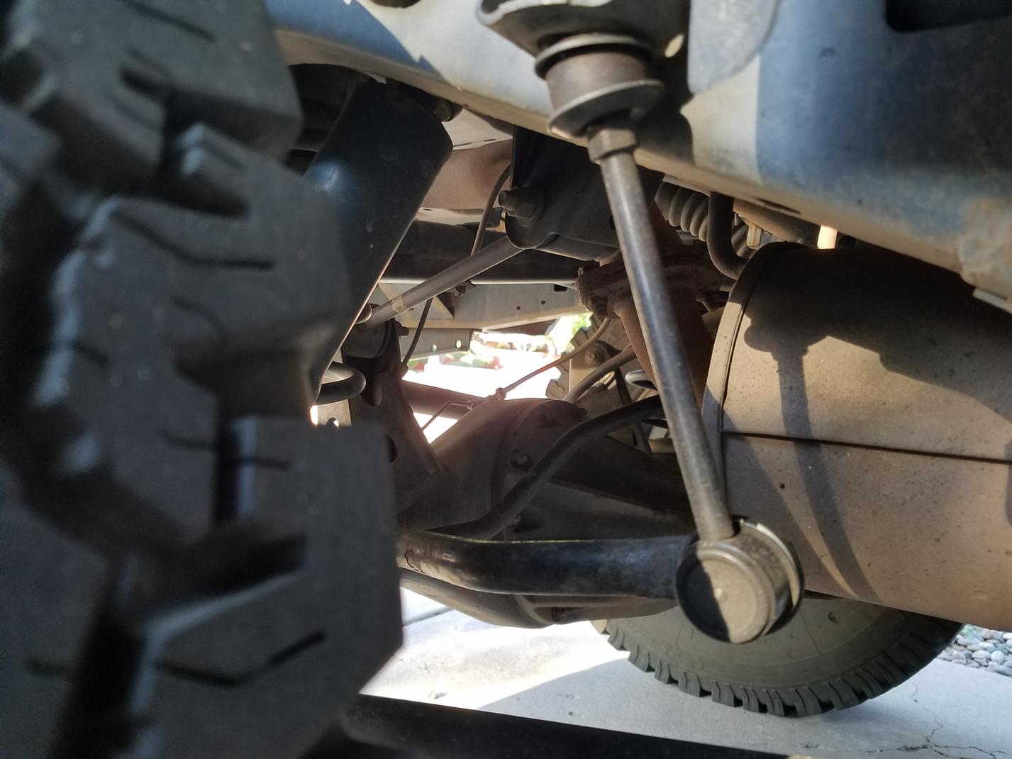

6. Moog 2nd Gen rear sway bar links
7. Re tapped broken rear sway bar lift bracket bolt

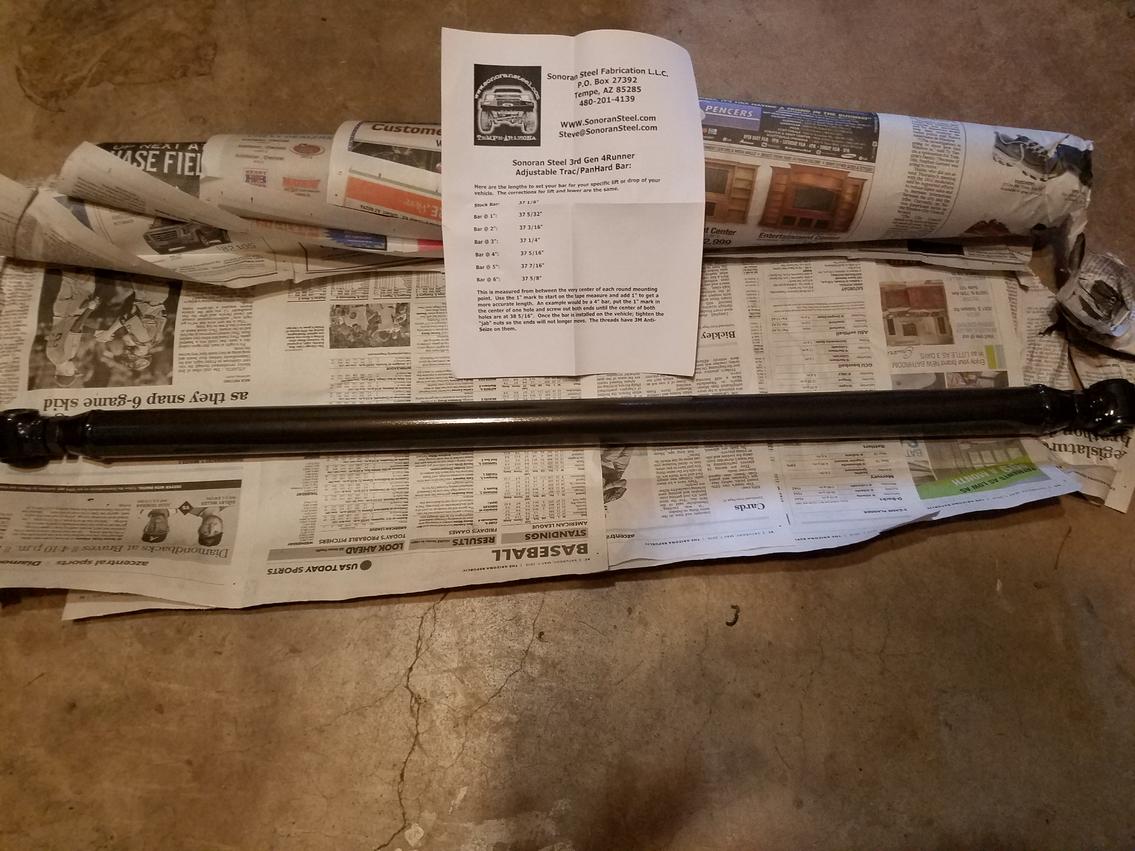

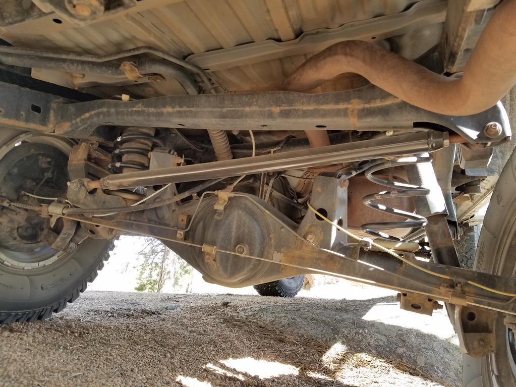

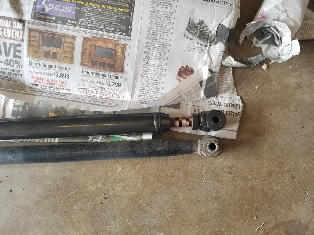

8. SS adjustable rear Trac/panhard bar w/poly bushings
9. Adjusted SPC UCA's setting G, maxed LCA cam bolts for maximum tire clearance at pinch weld

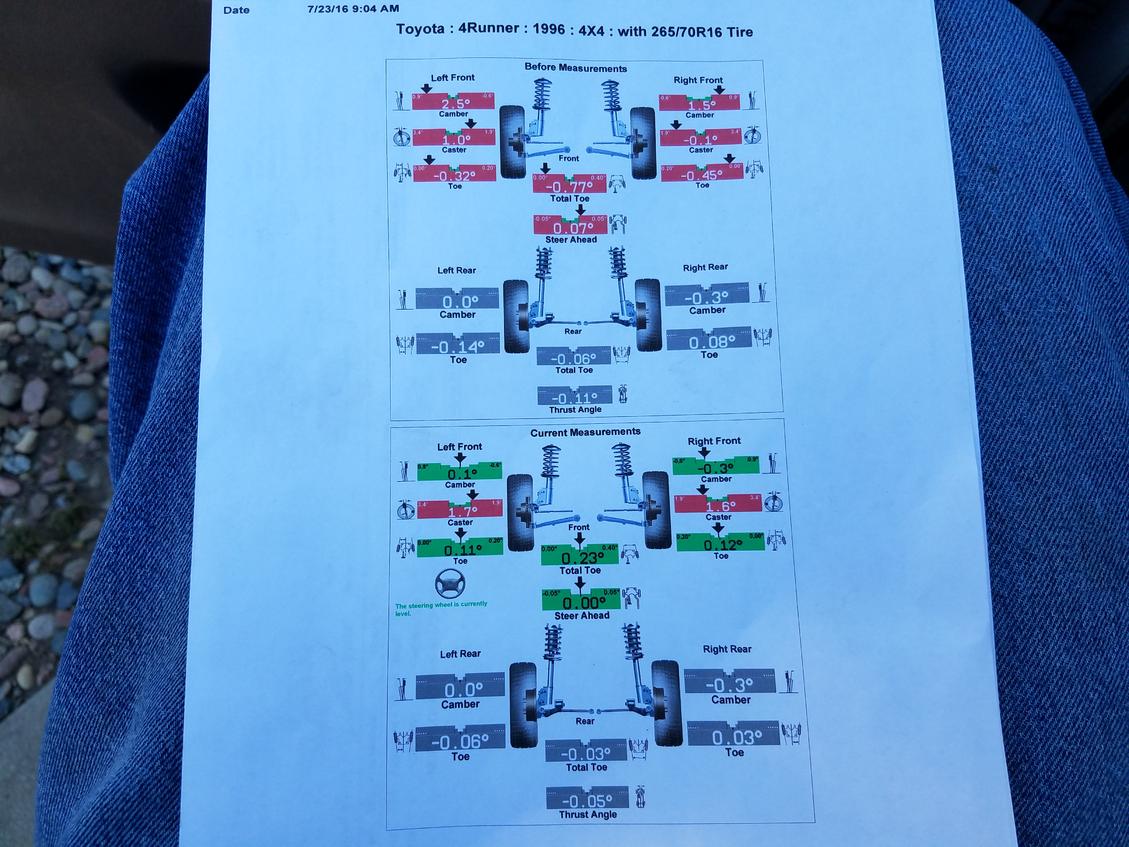

10. Alignment maximizing caster and aligned rear axle to front
After all this work. Trial and error with SPC settings and 3 alignment shops she finally drives better than ever. Does not rub in any street situation. Drives solid on highway. Does not jump around when hitting bumps on street. First time in long time wife said it doesn't feel dangerous. I will document my off-road/vacation to grand canyon.

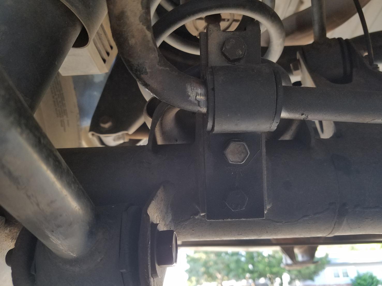

if you dont mind me asking what made you swap your factory panhard bar for the adjustable ss one?
I drove I would say for almost 3 years without the SS panhard bar and missing front sway bar. It road good enough for me. I would get a little sway back and forth on highway. But if I hit a bump it could toss the rear end a little at high speeds or when I was turning. I then broke my rear sway bar and it was pretty scary after that.
After talking with 3 different alignment shops they high recommended a rear trac bar since I was about .7" off from the front tires.
I also had some talks with Steve at SS in the past and he recommended it would fix some of these issues, allow the truck to track straight and explained why the panhard bar drop bracket would be a waste of money.
After I installed the panhard bar and had them align the rear end the hopping when hitting bumps pretty much went completely away. Once I got the front sway bar and rear bars back installed the truck drives like stock again. Completely stable in any situation in city or highway driving.
