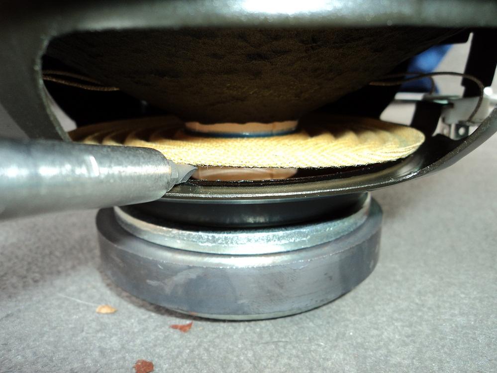

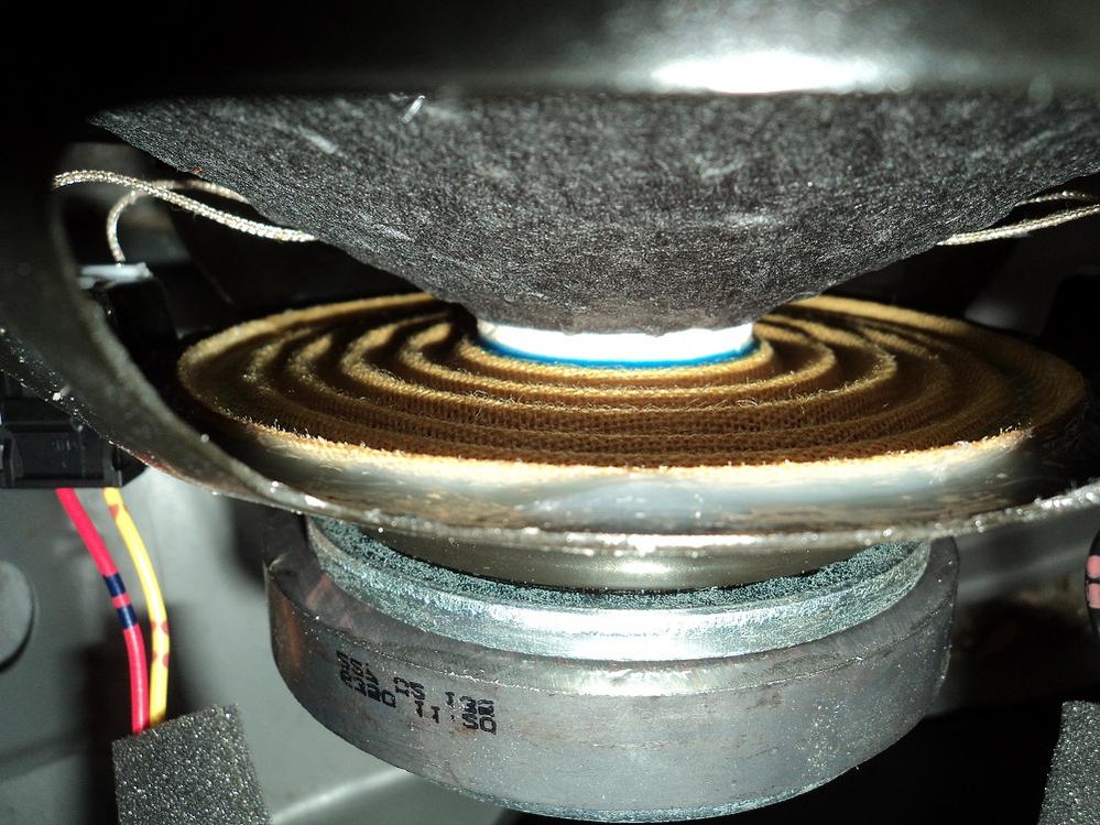

So I finally got around to removing my sub to track down this rattle. It turns that of course is was blown but upgrading the sound system isn't on my priority list, I thought I would take a stab a fixing it. It's not that I'm cheap I would just rather spend the money on an exhaust system or beefy tires. I'm not sure how long it will last but for now it works great, 100% rattle free!
The only thing required to fix it was time and silicone. Heres some pics
Not sure on correct terminology but you can see where it's seperated but shouldn't be.
Here's after I siliconed it

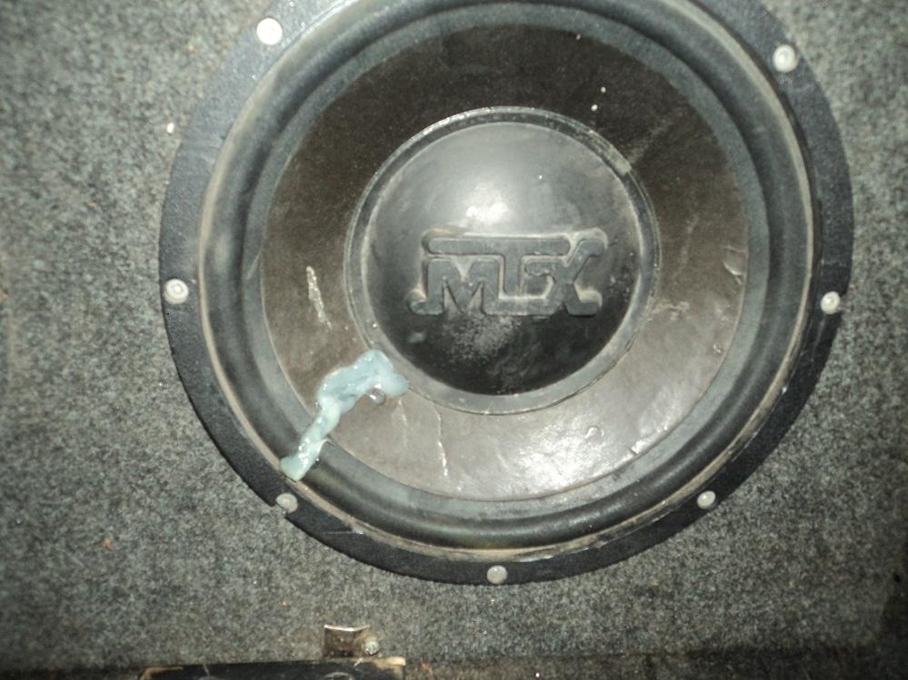

Here the old sub in my corolla which is where I got the idea for this one. I fix this one when I was a poor college student, it really suprised me how well it worked.

Thats a good fix. Next time, i would suggest a thin layer of some fast acting epoxy and then the silicon. Thats what I used to fix my old subwoofer.
Thanks for the tip, did it take lots of abuse? I only had my mtx siliconed for a couple months and then bought my 4runner so the only thing I can't really attest to is how long the silicone repair will last. My hopes are it goes a year or so until I upgraded the sound system.
The silicon will eventually wear and come apart. The epoxy acts as a harder base to hold everything together.

Just an update for anyone who wants to fix their stock sub. The silicone is still holding up after almost a year.
