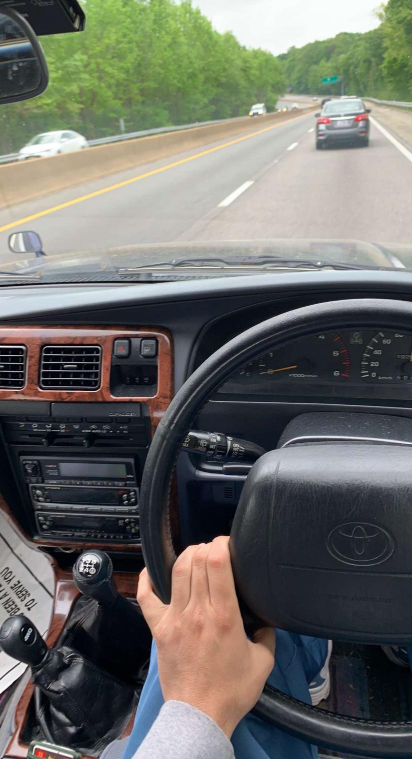

Yuuup, didn’t want anyone to beat me to it!
Couple teaser pics attached.
