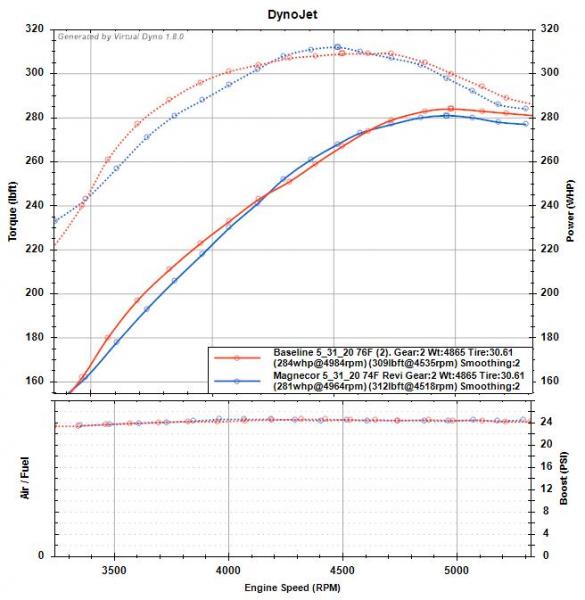

Next step in my build is to see if I can get a hotter and stronger spark to my engine in preparation for running the 2.0" pulley again and/or nitrous. I'm also going to start adding temperature data to my dyno runs to help adjust for when I run them in Winter vs Summer (difference of about 40 degrees daytime temps). I ordered a set of Magnecor KV85 Competition Spark Plug Wires from LCE Performance for $95 (Memorial Day sale 10% off): Pro Spark Plug Wire Set - 5VZ(96-04).

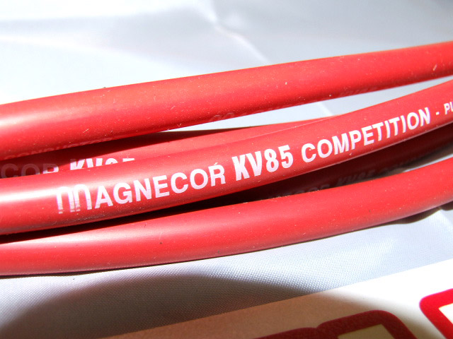

I want as much spark as possible going to the driver's side bank. I did 4 runs, 2 with the stock wire set I had on there and 2 with the Magnecor wires. The results were identical which is not surprising since I haven't actually increase the spark energy. Good to know my old wires were up to the task! You'll notice the blue line, the Magnecor run was a tad bit lower. This was after doing 4 runs so there was a bit of heat soak setting in.

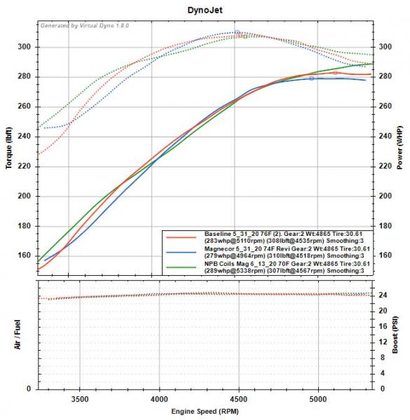

Got the hotter coils in from NPBoosted.com. They are yellow... not my favorite color but it's ok. UF156 C1041 90919-02212 Pack of 3 Ignition Coils for 95-04 Toyota 3.4L | NPBoosted
Took a couple of runs and it seemed to pull harder to redline with each successful pull. I ended up with the following results:
gamefreakgc-albums-engine-performance-mods-picture58295-npb-magnecor-vs-stock-wires.jpg
The mid-range is pretty much the same which makes sense, since the engine is only turning 3000-4500 RPM's so stock coils keep up just fine. But the top end? Look how it gains some power all the way to the 5500 redline, in fact peak HP is right at redline. My stock coils were not putting out a hot enough spark all the way to the top end. I'm pleased with this result, as it shows there was a need for a better spark. I'll call this a 5 HP gain. However as you see, it's not felt anywhere but the top end so pretty useless power gain, just a dyno queen number...

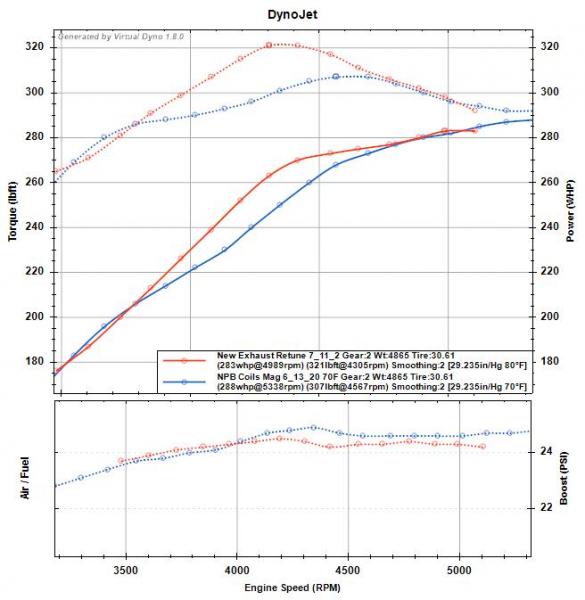

UPDATE: Here's the dyno graph! I had some heat soak after the re-tune so it might even be more than this on the first or second run! Max power gain is +16HP and +22TQ! Peak torque gain is 15TQ! Due to where it was added on the power band, peak HP is unchanged. Can really feel the difference in power from 2000 to 4500 RPMs!
gamefreakgc-albums-engine-performance-mods-picture58526-new-exhaust-vs-stock-exhaust.jpg
You can see the result of the heat soak as I made about 0.5 PSI less boost and power starts to nose dive quicker above 5000 RPMs.

Updated the exhaust post but putting a quick recap here. Max gain is +16HP and +22TQ (after temperature correction factor)! Peak gain is +16TQ, but 0HP due to it adding power on the low-mid range but not the high end. More importantly, it shifted the peak TQ to be 250 RPM's sooner!
