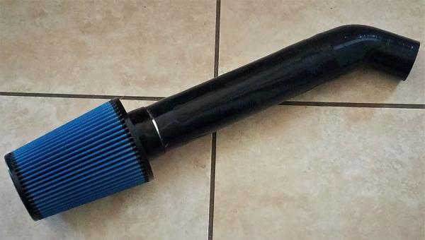

FINALLY getting around to making the 3" intake. I've got the intake tube pretty much done, just need to put one more barb on for the EVAP hose that goes to the air box. I can't tell if that's pulling clean air or expelling gas vapors so I'm putting it pre-MAF like it is on the stock intake just in case. Don't want unmetered air going in.
The other two components of this intake is an "air dam" as well as a new tune. The "air dam" is just simple steel sheeting that will be placed between the cone filter and the engine bay so it sucks in cold air from the fender hole and headlight, not hot air coming in from under the engine (which passes right by the exhaust headers). It's pretty cold here right now so I could probably get away with not having one in winter but when our temps push 100* or higher every day there's no way that will fly.
The tuning part is the most daunting. I'm starting to record MAF voltage values with my current setup. Because I'm increasing the size of the intake tube but not increasing velocity, the MAF voltages will be lower and could cause the engine to run poorly, or not at all. To correct this I'm having to increase the voltage signal using the AEM FIC 6 by roughly 14-20% by my calculations so far. I'm focusing on recording values at cold start, idle, hot start, freeway driving and city driving. WOT is easy, I have tons of logs to pull data from. It's the closed loop tuning that is the hardest and most critical. I can't have this thing dying on me. To be continued.

Here's a peek at what the intake looks like:
I'll spell out what parts used to build it in another post with more photos.

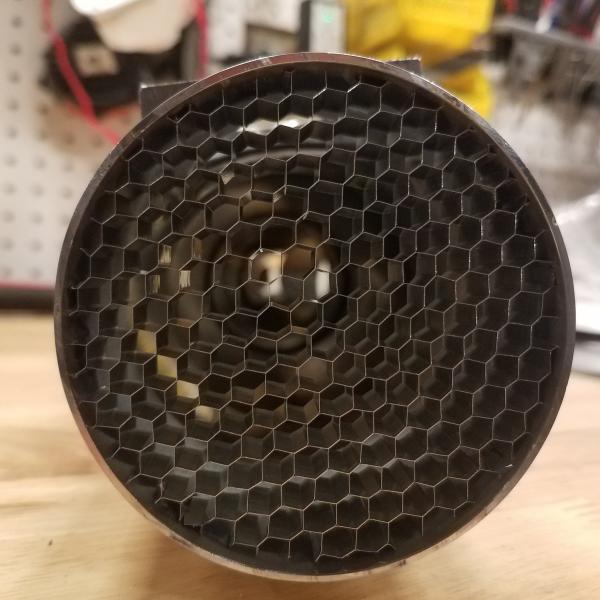

See how the MAF voltage is spiking up and down? That's a sign that I have turbulance at the MAF sensor. The stock airbox only has a single air straightener. I added a "honeycomb" or air straightener to the pipe before the MAF. This will eliminate any turbulence or swirling happening with the intake charge and hopefully smooth out that MAF signal, making it easier to tune and increase power.

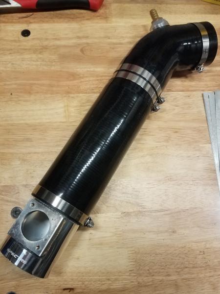

The intake is finally on! I wanted to wait until I took some time off from work so I had time to diagnose and tune it.
The basics of the intake is this from filter to throttle body:
aFe oiled 8" cone filter: Magnum FLOW Pro 5R Air Filter | aFe POWER
Spectre 3" aluminum MAF housing - comes with adapters to fit DENSO MAF Mass Flow Air Sensor Adapter Kit
3" aluminum air straightener "honeycomb" (see photo in above post) 3.0 OD x .5 Airflow Straightener Screen .187 honeycomb cell mass air flow | eBay
aFe air dam/shield. Essential for keeping hot air away from the filter element so it pulls in cold air from the fender and headlight.
3" diameter silicone tubing, 12" straight section from Intercooler Pipe Fabrication, cut to fit. I cut off around 4"
3" joiner pipe with worm clamps
Silicone port system with brass barb
3" to 2.5" 45 degree reducer
The old 99 intake had an inner diameter of 2.55". Actually a bit larger than I was expecting. The new intake had an inner diameter of 2.89". Some math from 9th grade comparing the surface area difference of the two tubes shows an increase in pipe size of 27.8%. I then create a new tune with a MAF map of 27.8% increase in all values. Reason being is with a larger pipe the capacity is increased but the velocity decreases, meaning the MAF will "see" less airflow than before, even though the engine is still ingesting the same volume of air.
I load up the map and take it for a spin. After 5 minutes it's apparent I'm running rich. After 10 minutes it starts to stumble at idle. After 15 minutes the AFR gauge is wildly swinging from 10 AFR to 18!! I ended up take out about 10% of MAF voltage increase just to get the darn thing to idle. I ended up changing the map to 18% across the board and that gets it to idle and cruise nicely. However it still is running very rich under slight vacuum and low boost. I have it taper off to 10% at the transition zone, or 14.6 PSIA (atmospheric pressure, when the supercharger begins to make boost) and my fuel trims are basically zero.
Tomorrow I hope to tune 3/4 throttle and then full throttle and see what kind of power it makes over my previous intake! I am hopeful that the much larger filter surface area of +80% over the stock aFe oil filter along with a larger, wider and straighter intake tune will make more power!
Shout out to [MENTION=271883]T4topher[/MENTION] who gave me the aFe air dam! It worked out perfectly after widening the opening and drilling a hole for the EVAP hose.

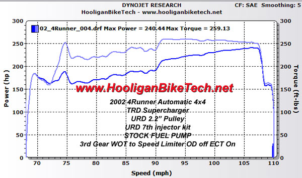

Massive Power Gain from 3" Intake
Wow, did this increase power! I'm actually quite surprised at how much it actually gained! Without further ado, the data:
That's a gain of +43RWHP and +35RWTQ!!! Those are some serious power gains. You'll notice that the power gain is minimal below 4500 RPM, the max I saw was about 10HP. But once the engine hits 4500 everything is up, TQ & HP. I'm very surprised on how much of a difference it made!
Pros: Massive power gain up top. Moderate gains in the power band of 3500-4500.
Cons: Sounds like there's a shop vac in my engine bay now. Also, I can't tell for sure but I think I lost some low-end torque. It's less responsive with throttle than before. Kind of makes sense though as the air is moving slower at lower throttle.
Overall impression: The power gains are much more than I expected. This thing is getting very fast. Now I'm going to try that 2.0" pulley again!
