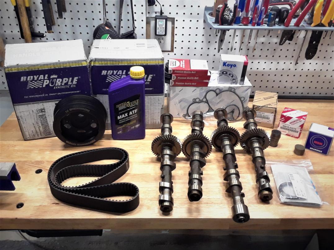

Getting ready for a timing belt job, and decided to put on a lightweight crankshaft pulley and performance cams just 'cause. Those are actually the cores, not the real deal. I'll try and do some comparison photos of the lobe positions when I swap them out for my stock ones.
Just got off the phone with Geoff over in Canada with Colt Cams. What a nice guy, he really spelled out the process and how the cams perform. Should work well even with emissions testing since they are not overly aggressive at low RPM's.
Cost is $600 plus shipping both ways, so about $700 total. Not bad for 4 camshafts really, considering they run about $250-$500 each new for other engines! Mine will be out in the mail tomorrow!
P.S. The grind profile I'm getting is the 262* cams, he also sells a 292* full-out race engine cam! Probably not what many on here are looking for but you never know!

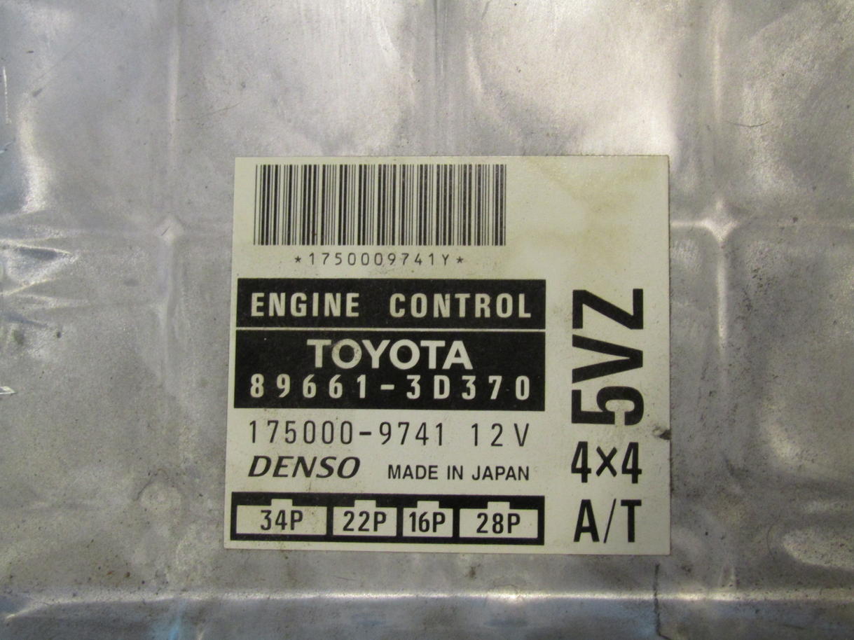

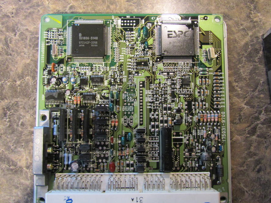

Putting this here for reference. I am looking into installing a rev unlimiter from Magnum Tuning but needed to confirm the ECU and how many quartz there are on the board. https://www.magnumtuning.com/en/detail/revolution-pro-speed-rev-limiter-cdi-box/toyota/4runner
If all goes well, I'll have the ability to raise the rev limit from 5500 as well as increase the governor.
EDIT: they said it would take two of their products, one controlling each crystal. I think I might research a direct crystal replacement then, for each one. Looking for a 10% faster crystal, should be about right.

What are the frequencies of the stock crystals? Do you have the tools to do the replacement? www.digikey.com and www.mouser.com will be the easiest sources to find the crystals. They are a standard HC49 package.
-Charlie
Thanks, I checked out digikey and they have what I need. It's a 16 Mhz and 8Mhz stock, so I could replace with a ~17.8ish and a 9 and be pretty close to 10%. I'm putting this on hold first though, since I need to wait for my camshaft order and put it on the dyno to even see if there's power to be made that high or not.
