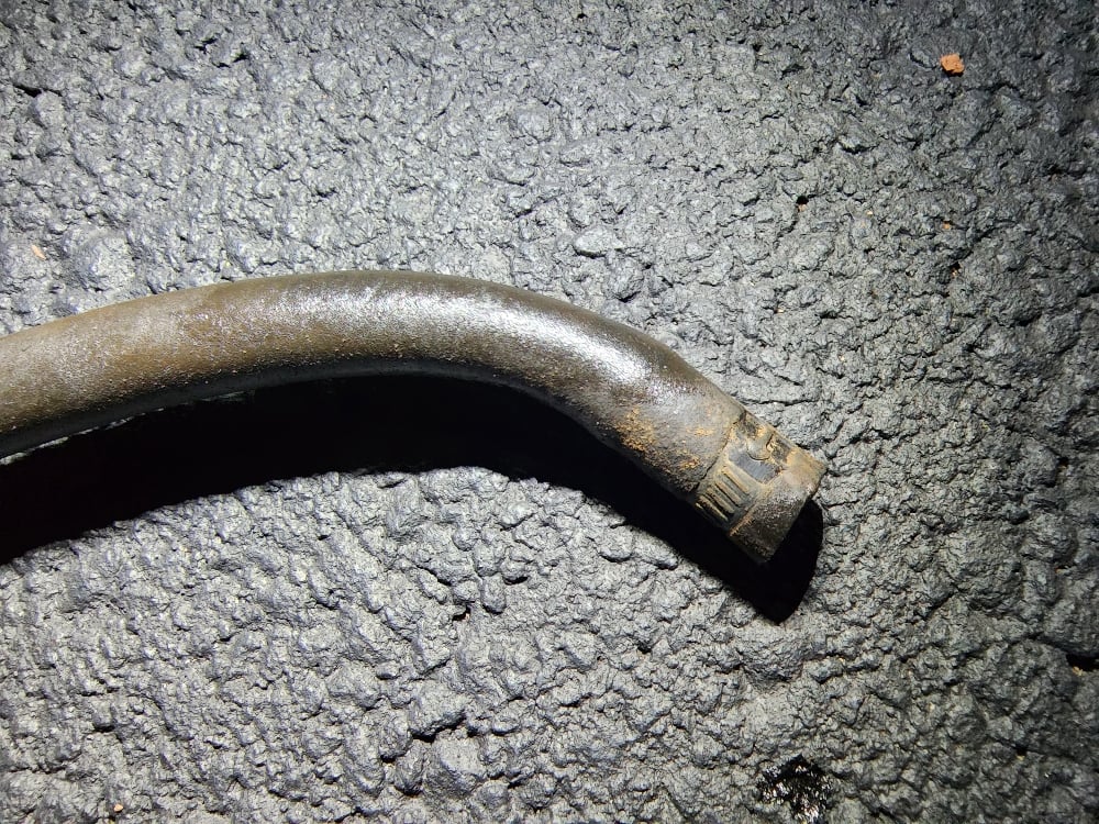

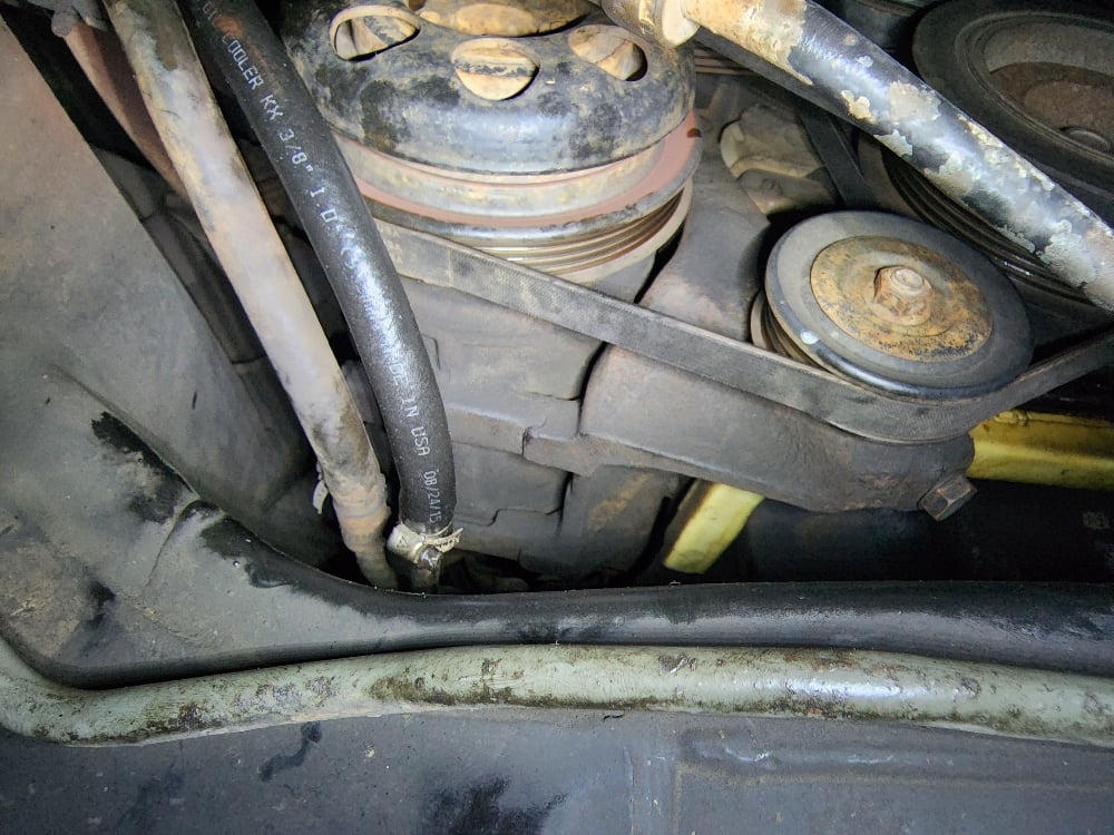

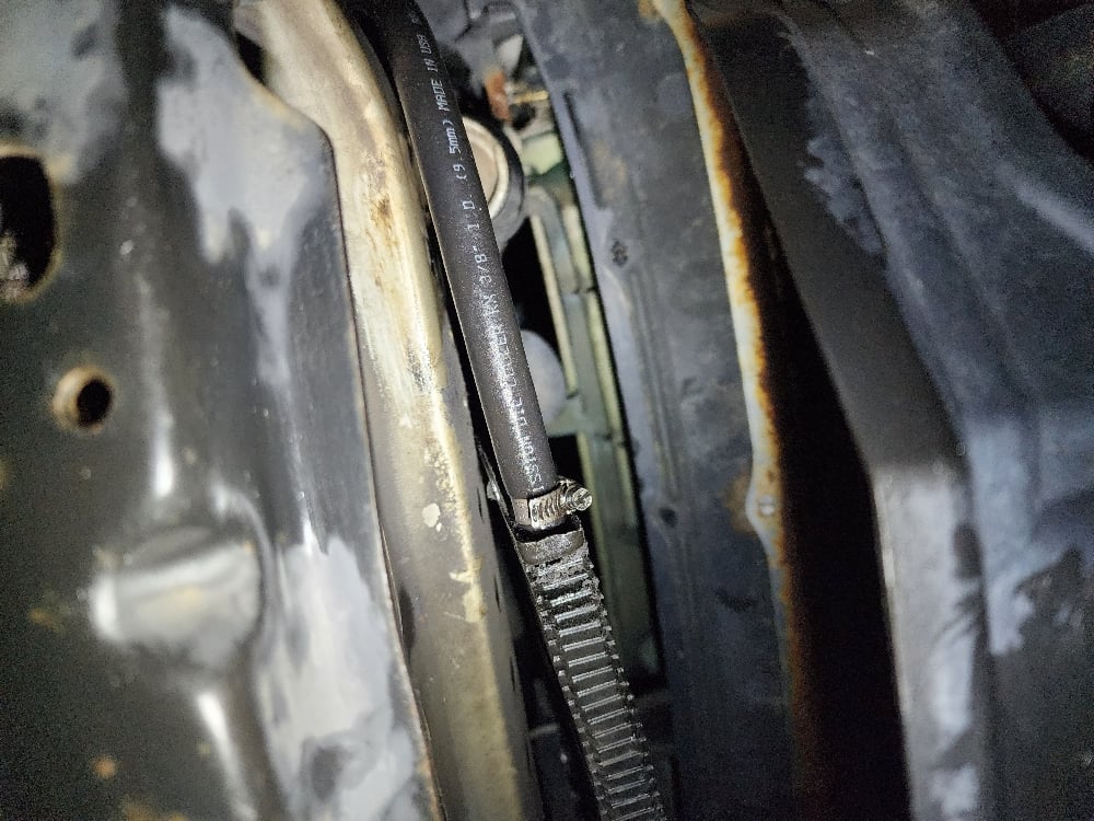

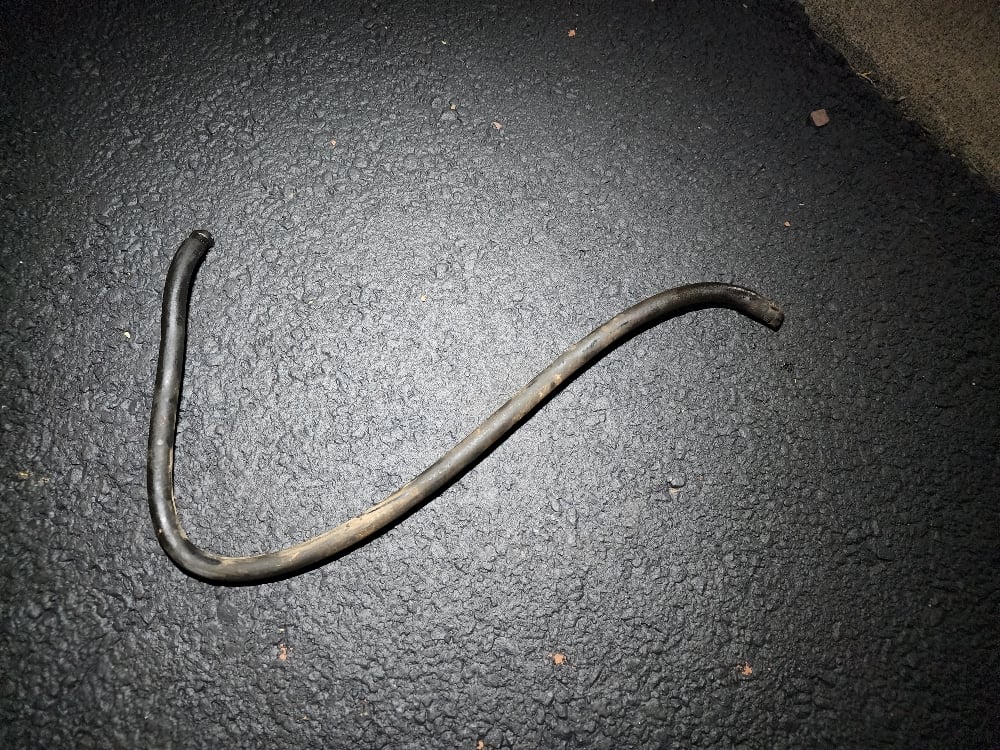

After fiddling with the fuel filter some more to no avail, I was still determined to get something done tonight. The weather was too nice to waste. So I went ahead and replaced the lower hose on my B&M trans cooler. The original hose was leaking at the connection and was covered in grime. It's like playing tetris trying to snake it through all the spots.

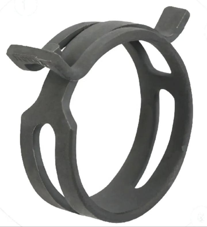

Those worm clamps suck for anything long term. Why not replace them with factory style 360° clamps?
Sent from my Pixel 4 XL using Tapatalk
Constant tension, like Toyota factory
Oh I never thought of that! Maybe I'll invest in some of those. And those things are easier to put on/take off. Good idea. Thank you man.

If those factory 360 clamps are not working and the clamps are not rusted away.. Replace the hoses that are leaking. I had that happen after a timing belt change my rad hoses wouldn't seal. I put rad crew clamps on temp. Ordered replacement hoses put those on. No leak.. The leaking is because the hoses are just warn out.. This goes for all rubber style hoses. Well this is what I have observed over the years anyhow.. :-) Hope this helps.. :D

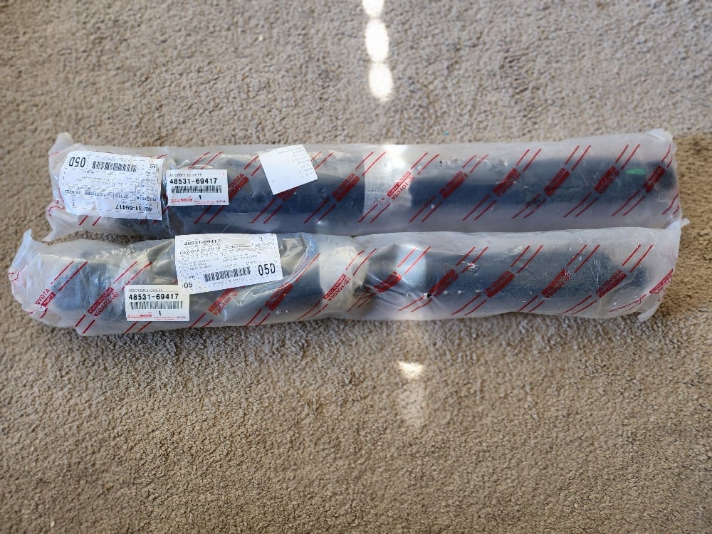

These arrived this morning. Super excited about them. New Tokico shocks for the rear end and they came with all the needed hardware and bushings. Let's see how long it will be before I get them installed, lol.
Sent from my SM-S908U using Tapatalk
What additional parts did you end up having to order?
Absolutely nothing. I haven't opened them yet because I don't wanna lose parts, but I can see the bushings were included. They just aren't pressed into the shock.
But man, these things are B E E F Y. Like seriously. I can't wait to do a side by side comparison with the 5100's. Not sure when I'll get them installed but my hope is before the weather gets too cold.
EDIT: I forgot to mention that these are LC80 Tokicos.
