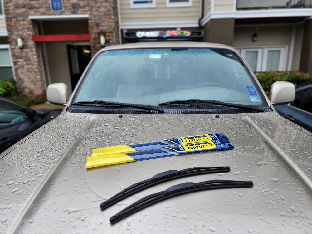

New wipers, some cheap and low profile Rain-X brand ones to replace the old Denso ones (on the hood)

New wipers on a rainy day? What a perfect way to test them out! Some good wipers make all the difference.
For sure! And a 3.5 hour road trip, too. Lol. They did great. The Denso blades lasted 11 months, which I guess is good. I do believe Bosch icons are the best that money can buy. I've had them in the past and ran the same pair for at LEAST 3 years without any smearing. But money is tight so I figured these will have to do.

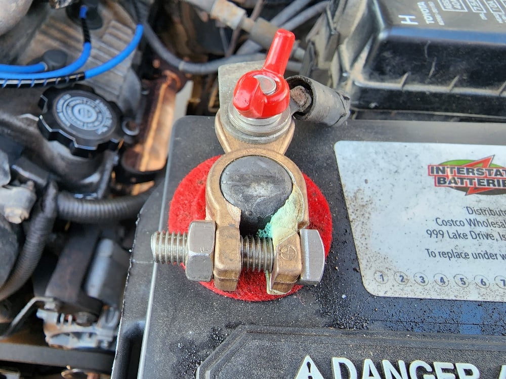

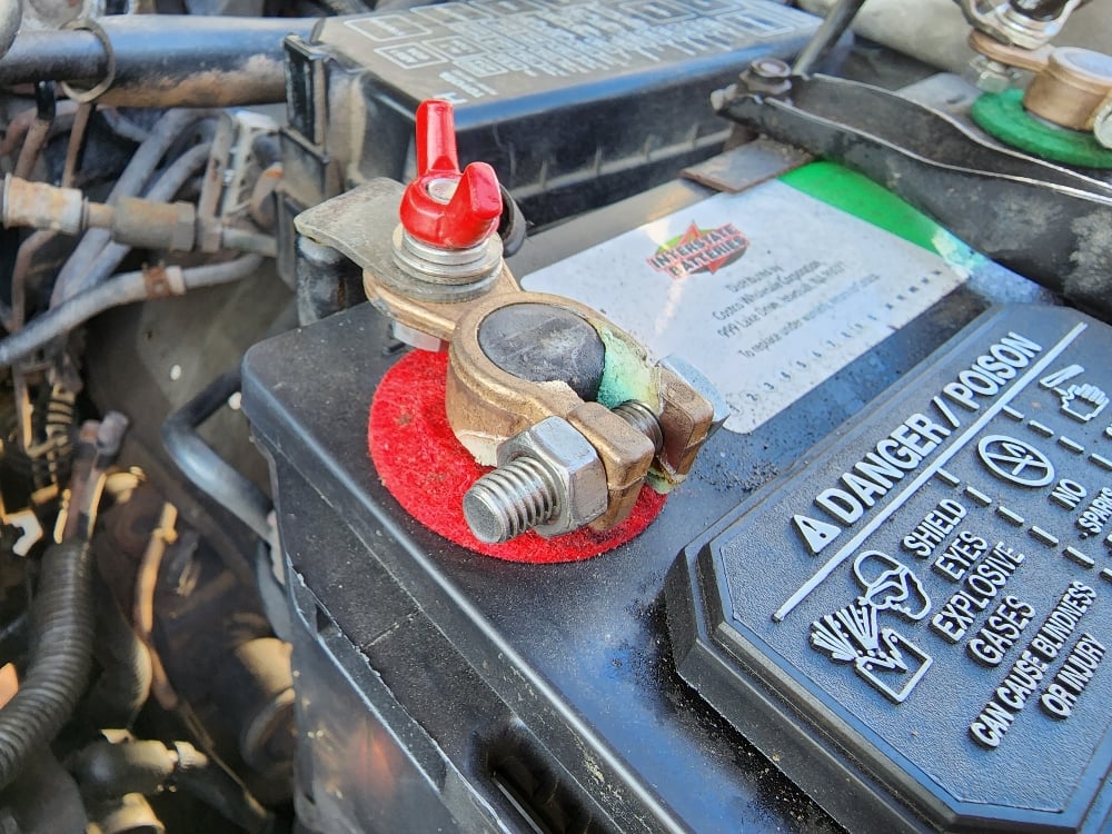

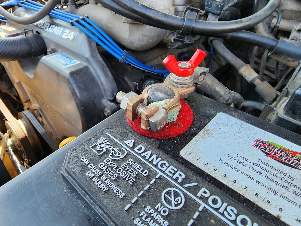

Any ideas as to what is causing this corrosion to develop on my positive battery terminal? I've encountered this before with my old battery and I concluded that it was due to my alternator going out. Since then, I've replaced the alternator and battery, and even installed those felt-like material battery terminal protectors. Does anyone have any input?

Probably the terminal. They mostly will oxidize unless you use a conductive grease. I perfer the copper band terminals versus a lead terminal.. they will oxidize as well unless coated with conductive grease.

Interesting. They're definitely grease-less, as you can see from the photos. So my plan of action will be to clean the terminals and posts and then apply a grease to them. The negative terminal has absolutely zero corrosion, and also no grease, so that's confuses me a bit.

2 potential causes
1. A leak
2. Resistance
Wet batteries will leak electrolyte or electrolyte vapor when wheeling, it's inevitable. This is likely the cause.
Excessive resistance can also promote corrosion.
Try smearing Vaseline on the battery terminals after cleaning off all the corrosion.
Sent from my Pixel 4 XL using Tapatalk
I just use conductive grease.. Not dielectric grease. Since petroleum jelly has good conductive properties.. it will work.. :-)
Those pads should neutralize any acids that leak out at the terminal, but they aren't perfect. I have started hitting all my battery terminals with a quick spray of Fluid Film for corrosion resistance...
-Charlie
I will take a photo of what I use that is for lead acid battery terminals if I remember...:)
I never used fluid film for battery post. Interesting.. :)
Sent from my SM-A505U using Tapatalk
I don't wanna overhype something that isn't a huge deal, but I would like to come up with a solution for it in order to prevent it from reoccurring. I upgraded my battery terminals to brass ones thinking that would solve the problem and it did for about a year. Now I just want to maintain it and keep them in good shape.
I'm gonna take a brush to it and clean it off the best I can. Then maybe apply some dielectric grease or Vaseline to it and go from there. Thanks everyone for the input and suggestions.

An AGM battery will cure it
