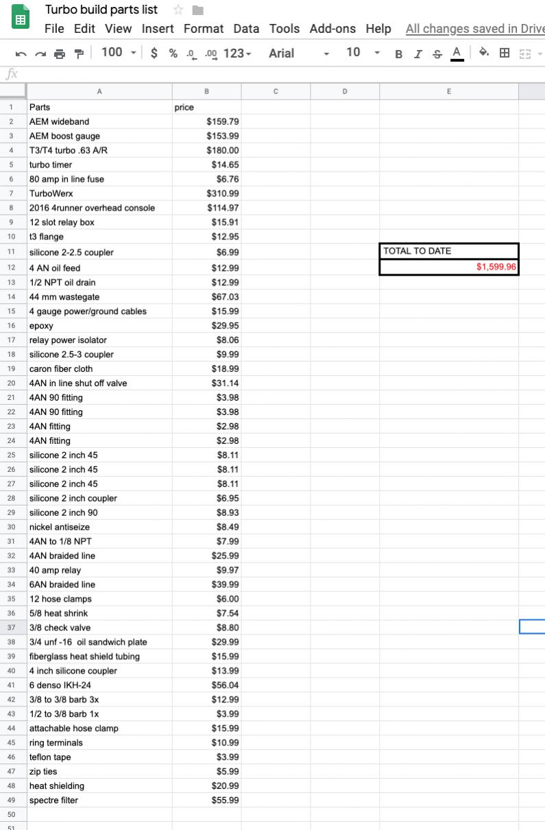

well as the title suggests here are basically all the parts I've ordered to date haha. Within this list you will probably see a few extra items which I've done for a safety factor. In case I'm driving and experience a pump failure this will give me the option to cut the oil feed via a valve or in the case of a oil line failure the ability to cut both oil feed and power to the pump. granted this would require unbolting of the turbo but roughly 10 bolts and 10 minutes and a small price to pay in case of a pump/oil line failure in my opinion. I will also be tapping and threading connections on the frame for the pump and braided line for peace of mind.

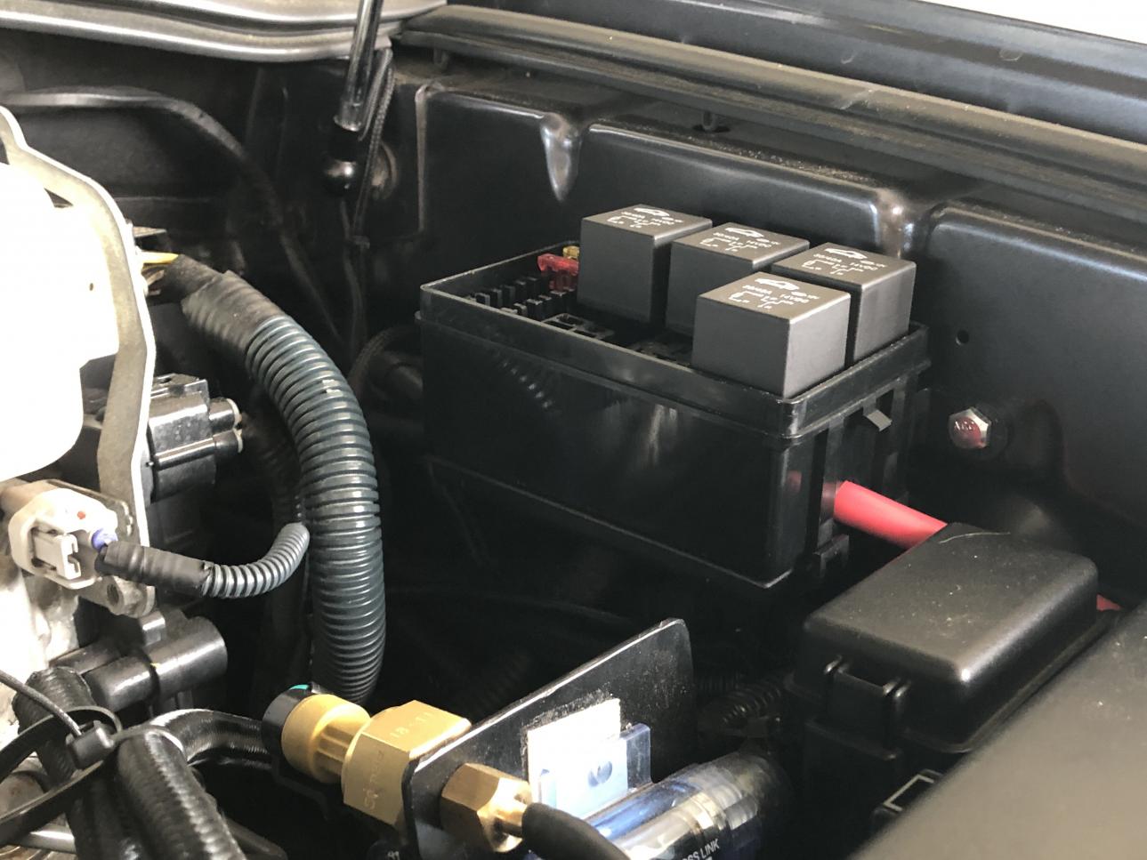

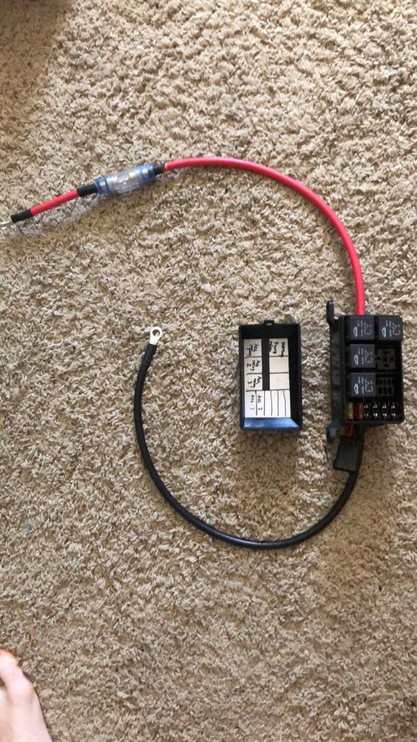

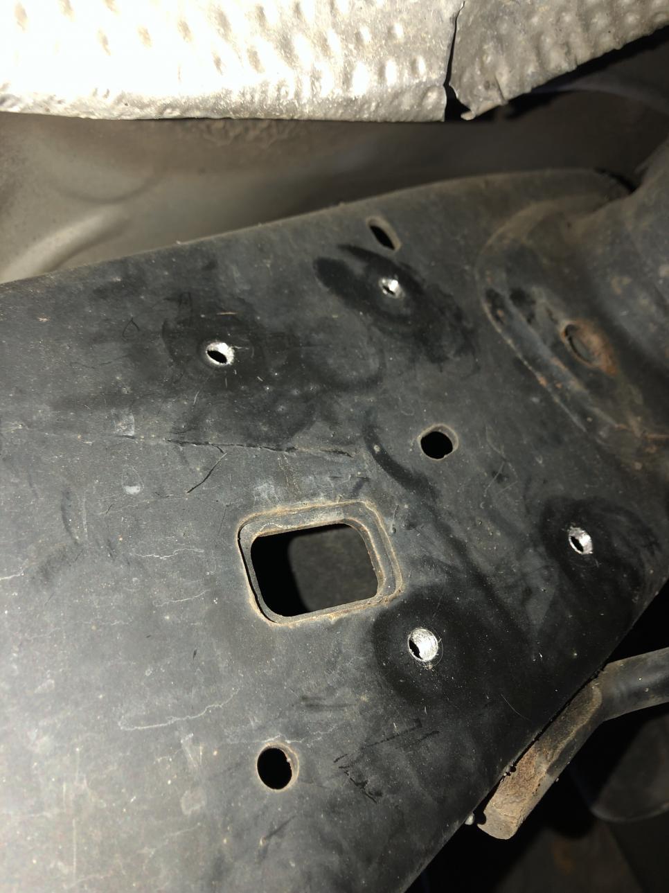

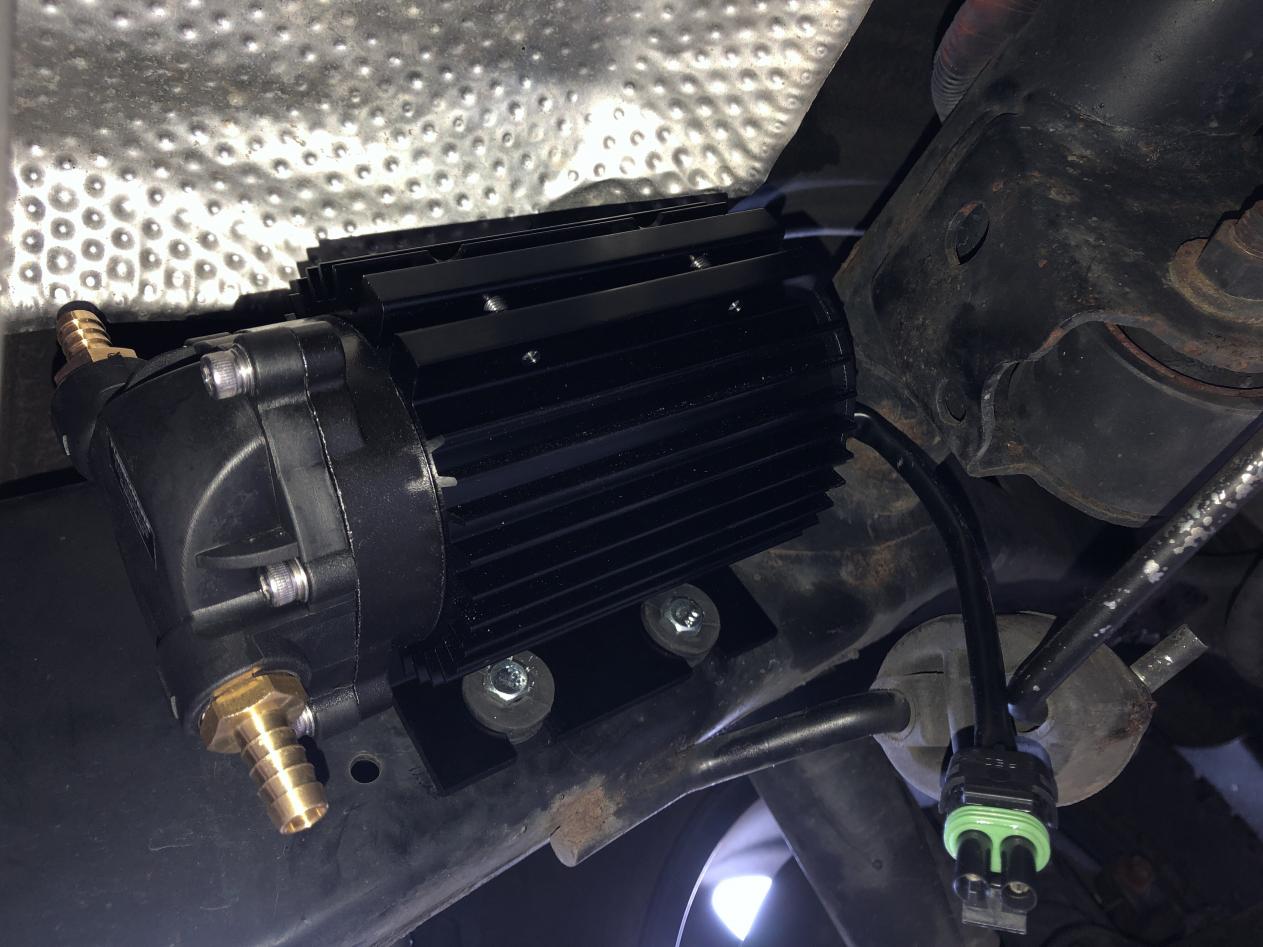

So for me I wanted to make everything bolt on connections so I bought a drill tap and made mounts for the scavenge pump and hose routing. I also built this relay/fuse box to keep everything organized and safe. This will allow me to have the pump on its own relay and the other three relays are for the fuses on the side. (1 relay per two fuses) This will also allow me to run the turbo timer on the pump circuit as well as power the gauges from here.

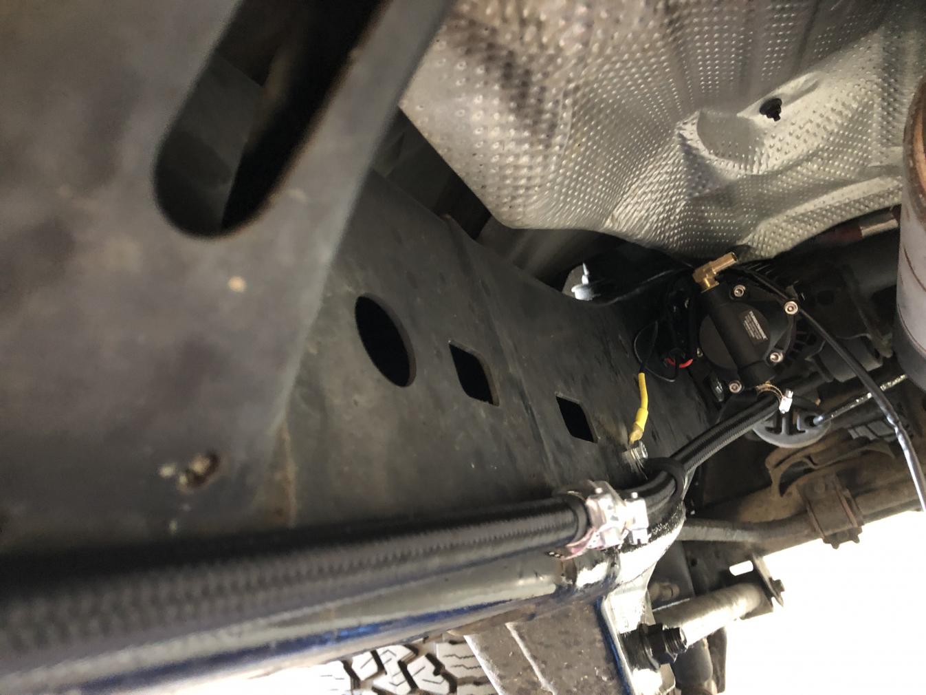

more work complete

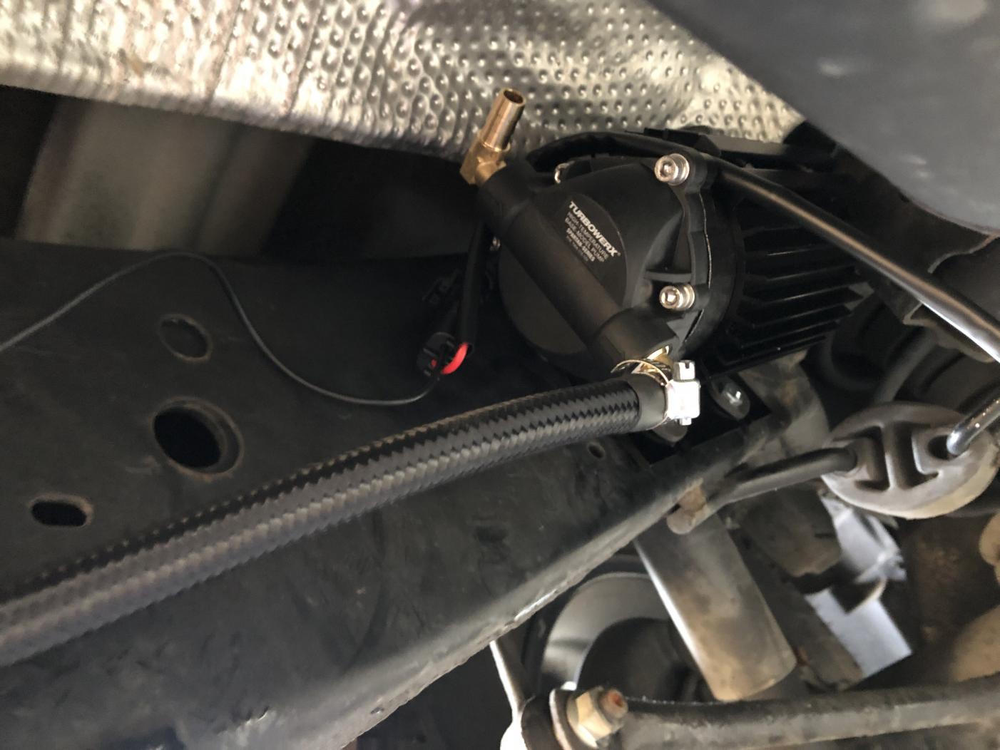

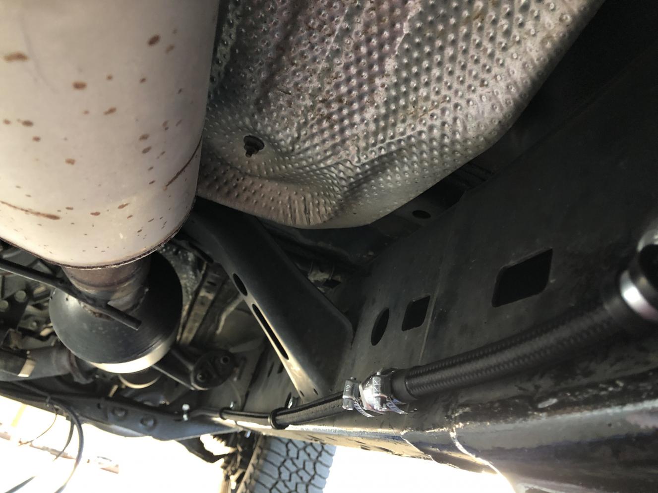

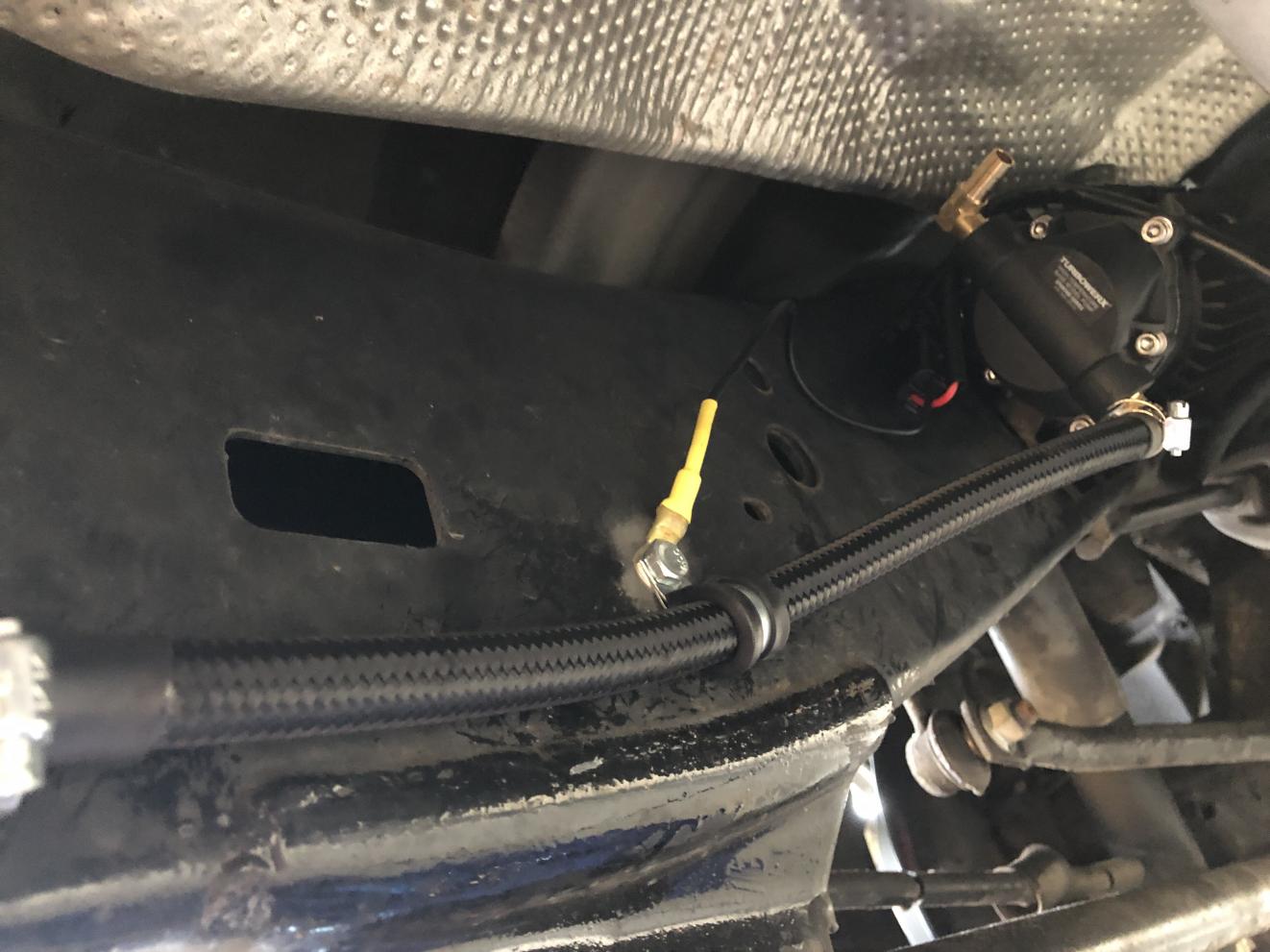

I got the new 90 barb fittings installed today on the scavenge pump and also ran the power and ground line for it. The ground is on a waterproof ring terminal grounded to the frame with a bolt and the power is covered with wire loom. (this power line will be run to my junction box I built once I build the plug)

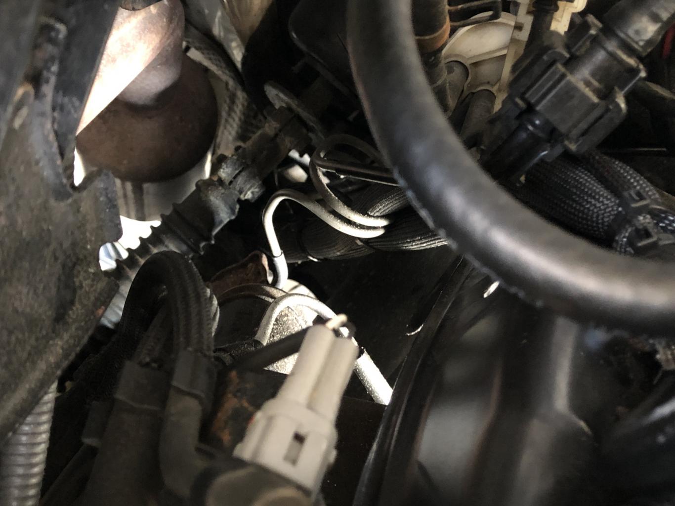

Along with this I added more bolt taps and got all of the main oil feed and return lines run.

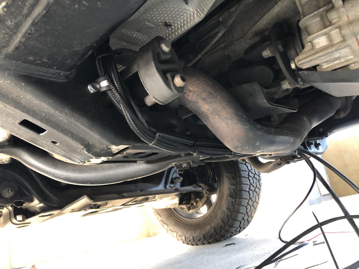

The feed is 4AN braided line which will have a safety shut off near the engine bay and utilize 4AN bolt on fittings since it will see a decent amount of pressure.
The return is 6AN braided line which will dump back into the oil filler neck via a barb fitting. It is bolted to the frame to keep everything secure. It also has a 3/8 check valve installed so that if it is on a hill oil won't drain back towards the pump.

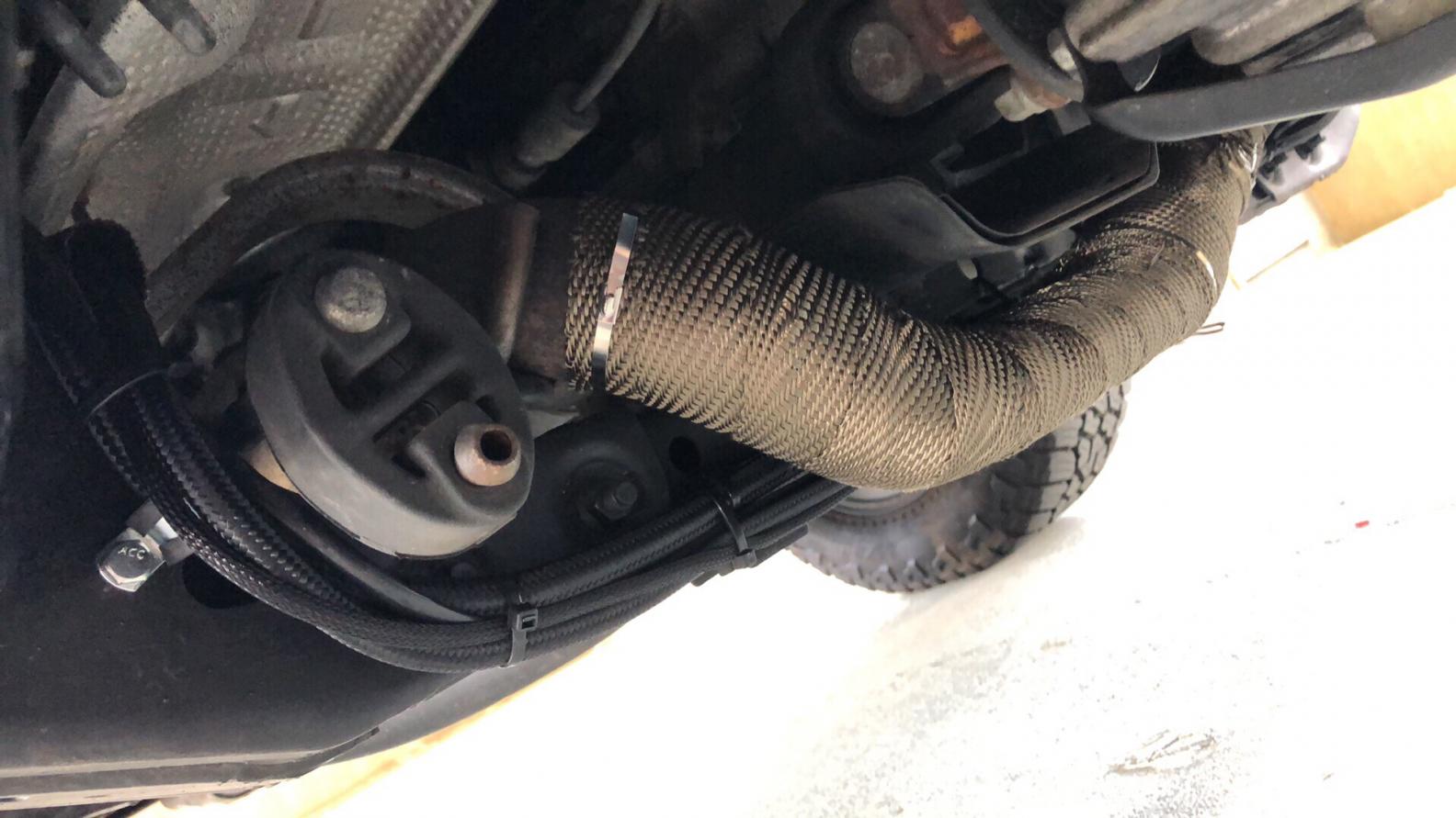

Up where the cats and exhaust is I used fiberglass heat shielding tube for both oil lines as I wanted to protect them and keep temps down.
I also drilled and tapped for the junction box which is placed level on the drivers side next to the brake system. The 4 gauge ground is run to chassis with a bolt and the power has an in line 80 amp fuse which once all wiring is complete will be run to the positive on the battery.

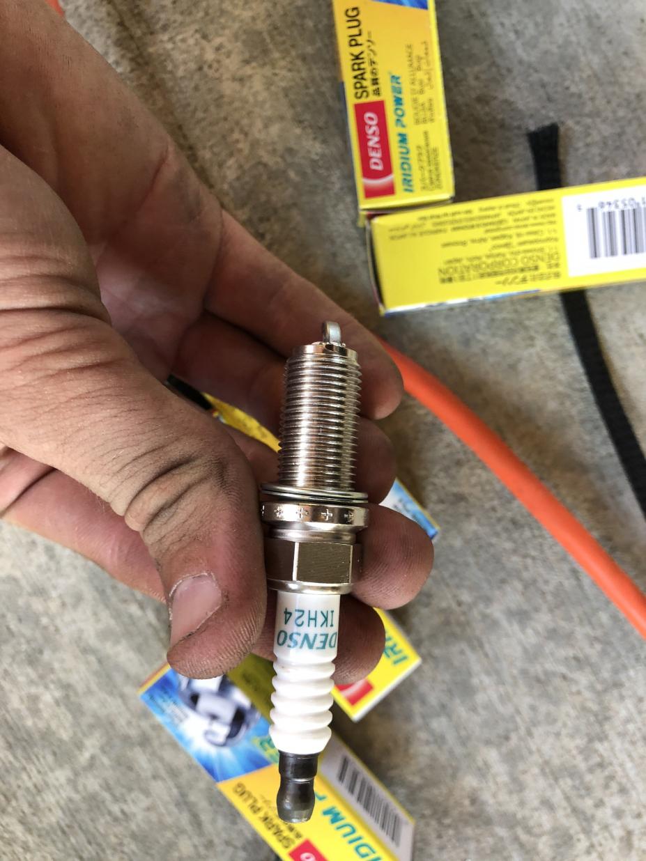

I also replaced all the spark plugs with IKH24's which is a colder plug to help with knock resistance. The old plugs looked great so no worries there.

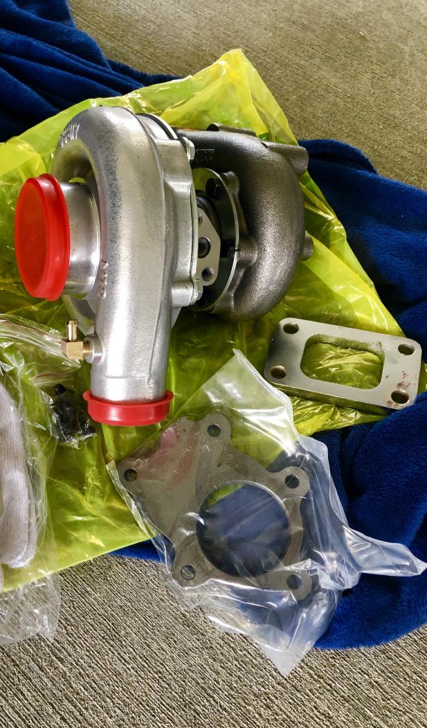

Parts and progress

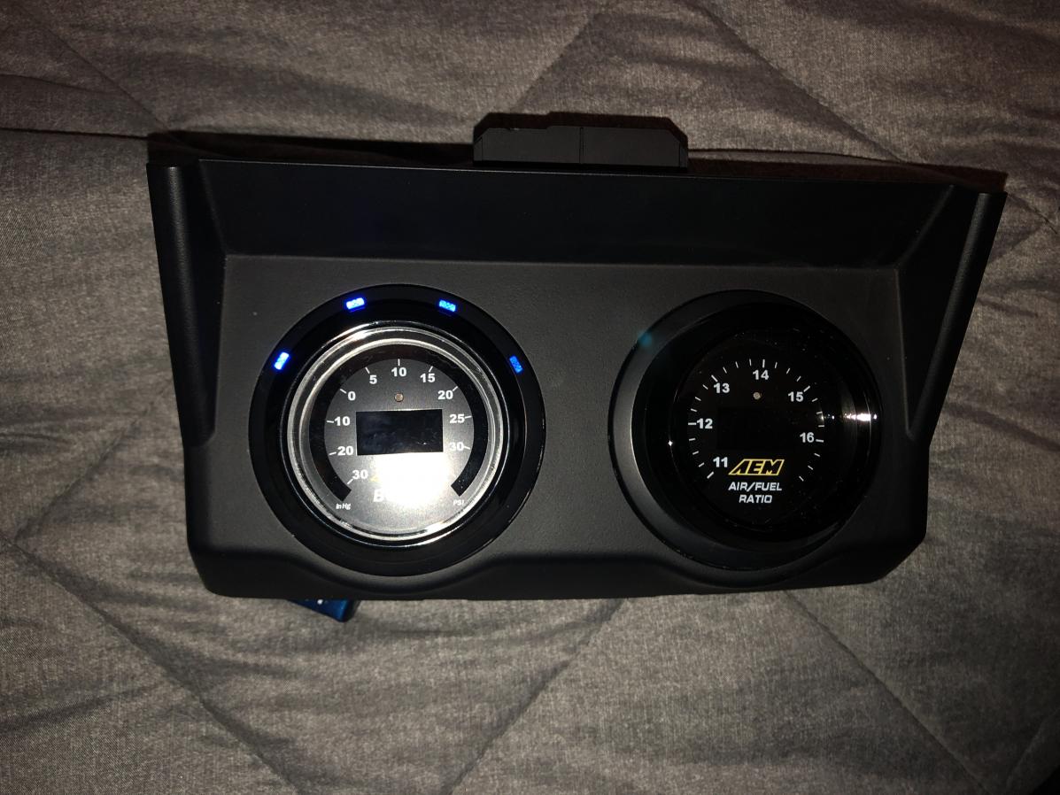

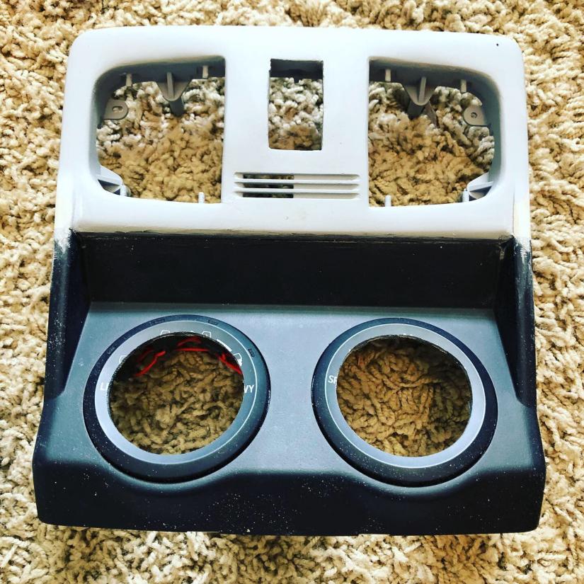

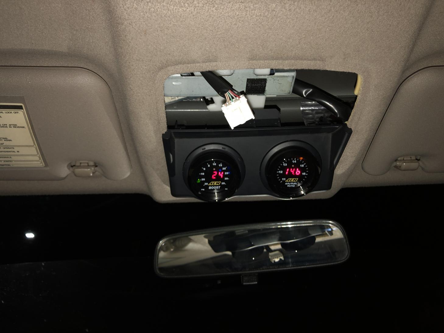

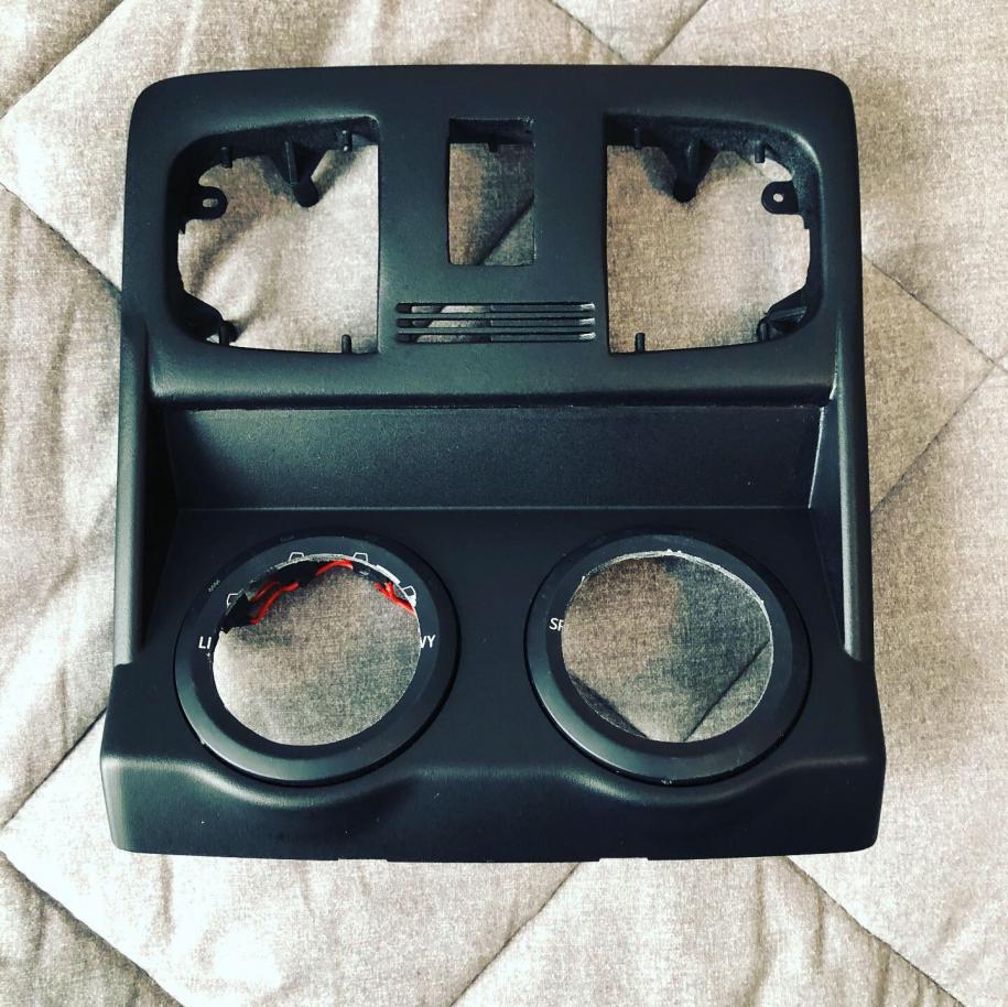

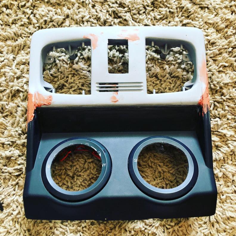

One of the most important parts of the build just arrived Also I installed more heat shielding to protect the oil lines and got the oil feed plumbed in with a shutoff valve. I also started building my custom overhead console. Here is the beginning of what will be the gauge pod portion.

Coming along nicely! Is that gauge pod going to replace the existing console, or somehow attach to it? Curious..., what made you go that route instead of adding the pods to the pillar post, or something like that?
Thanks! And my original overhead console is in pieces lol. I’ll be fabricating this onto where the sunglasses holder was. I guess the reasoning for it was I wanted it to look like it was meant to be there and not added in as an afterthought. If it gives you any idea the look I’m going for I’m building an addition manual to go with the Toyota one about maintinence and diognosing problems haha
Nice! That makes sense. So, if I’m understanding correctly, you’re still retaining the gray frame with the map lights, but replacing the swing down door with the gauge pod, correct? Can’t wait to see this turbo project completed and running!
That was originally the plan but I had to cut that whole front half off and do a lot of fabrication work haha. Its almost done though.
Getting closer every day

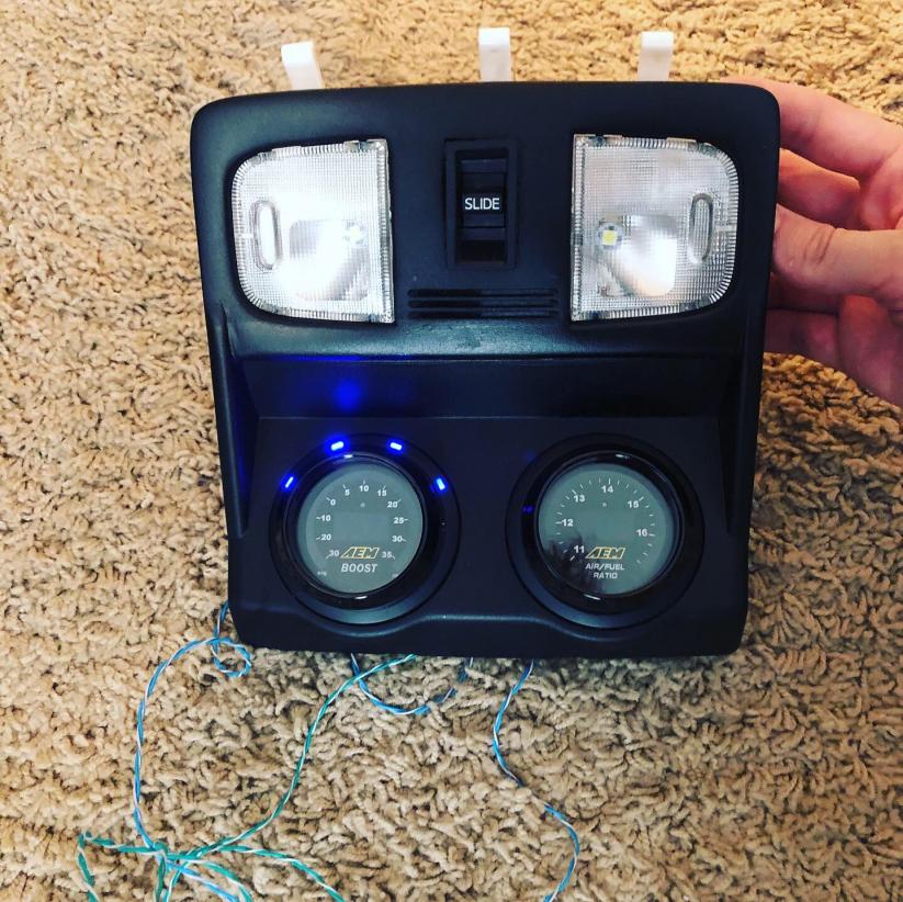

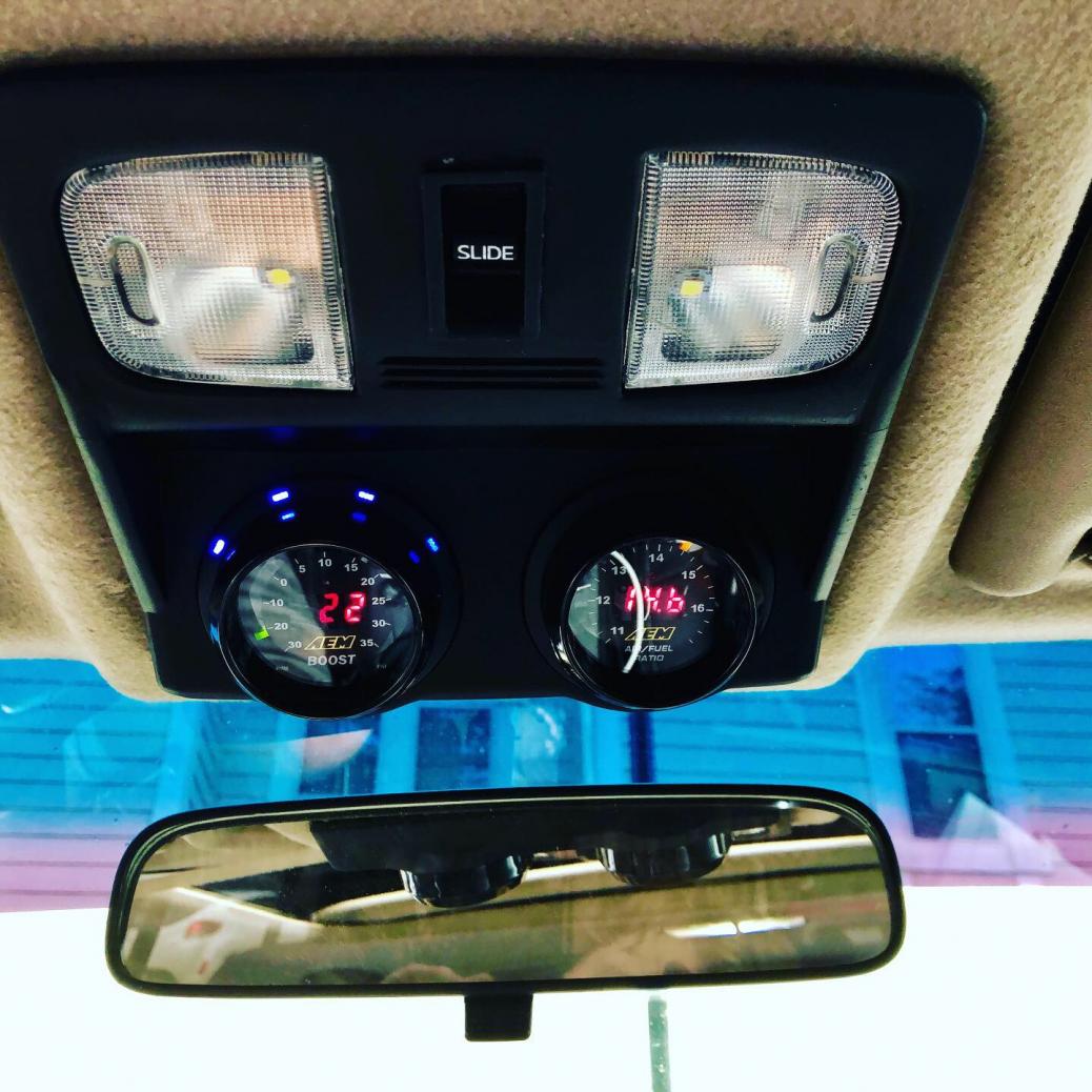

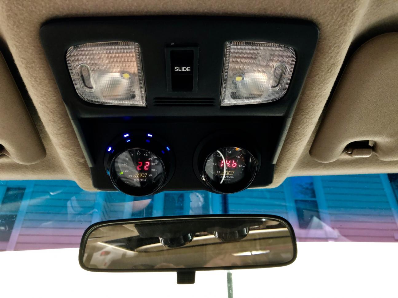

Just finished my custom overhead console. It incorporates a 4th gen one and a 5th gen trd pro console to make what I have. It houses my boost and wideband gauges and also has some modifications made. For one I have blue illumination around the boost gauge when the headlights turn on, for 2 I fabricated the 5th gen mic grill in place to house my kenwood radio mic and used the 5th gen sunroof switch. Making progress!
That turned out super clean!
Im not following the scavenge pump idea, why not just allow the oil to drain through the pan? You will have better reliability by not having the pump at all.
It's a remote-mount turbo setup, not located in the engine bay where gravity drains the oil.
You can't rely on just the pressure from the feed side of the turbo's oiling setup to drain the oil quickly enough when the turbo is mounted at or below the oil pan level.
