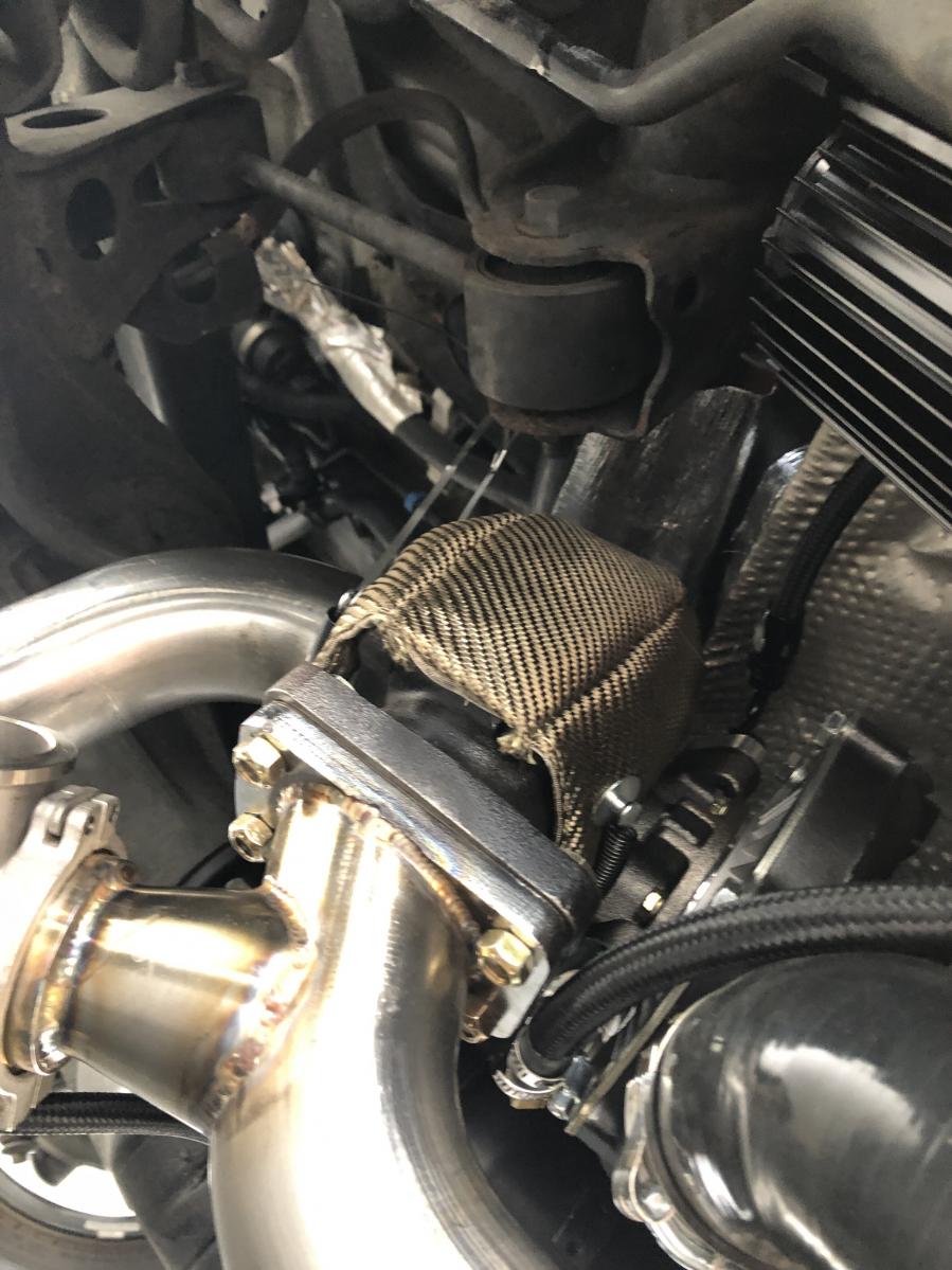

made more progress over the last few days. Installed the turbo blanket, heat shielding, charge piping for the most part, exhaust gaskets and redid some oil lines. I also installed new badges to give some subtle cosmetic changes.
Things I know still need to be done is to install another exhaust hanger as things are several inches too low right now because of the weight. I also need to move the wideband up by the y-pipe as I'm not getting an accurate reading.

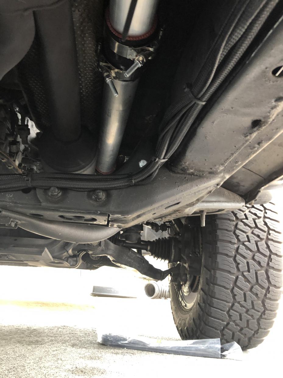

A few updates. I’ve run the majority of the charge piping in the route I wanted up to the engine bay.

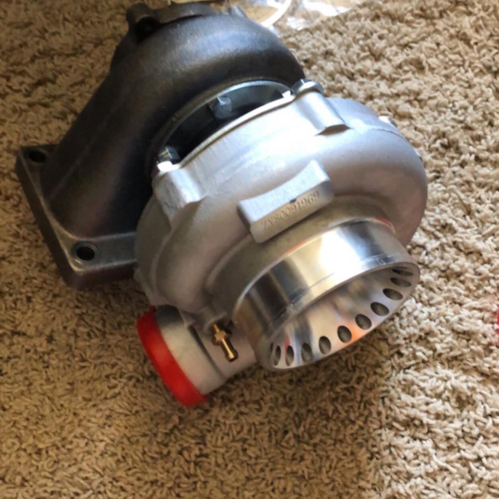

I did find out that the t3/t4 turbo was too small and was spooling too soon. I have since then replaced it with a gt35 which is much better for this application.

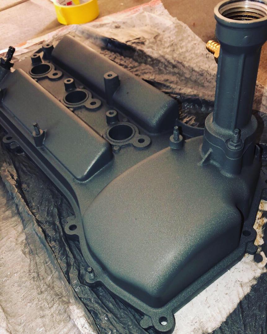

Other than that I’m waiting on a few parts but plan to get the rest of the welding done this coming week. I also painted my valve covers too haha

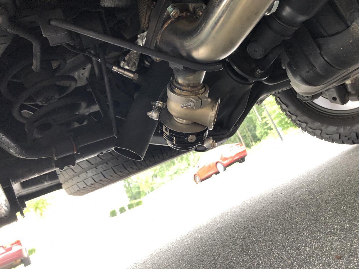

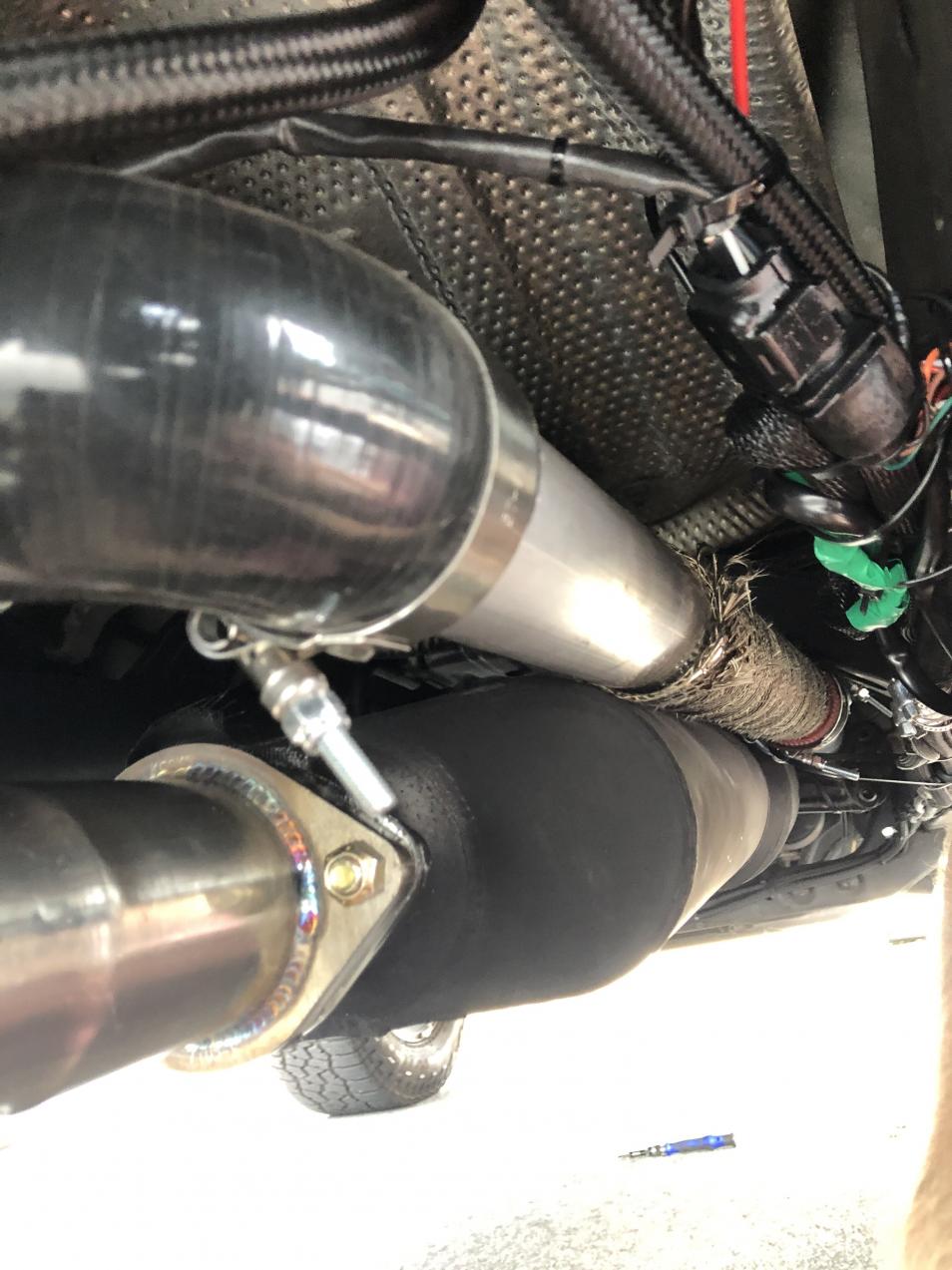

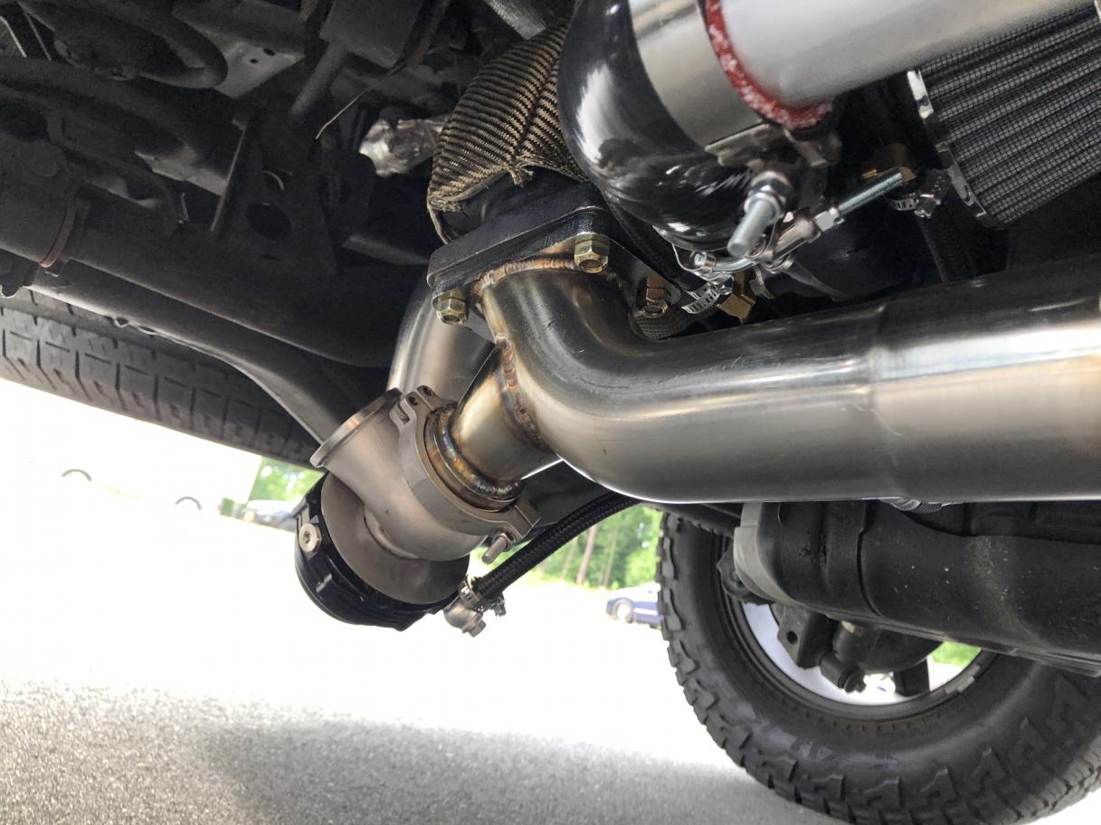

Made more progress! A lot of this project is waiting for the parts lol.

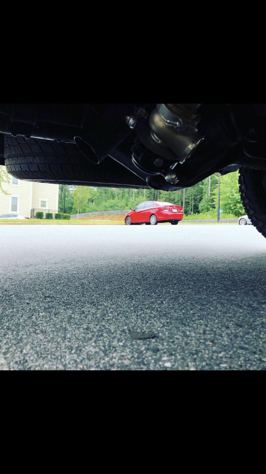

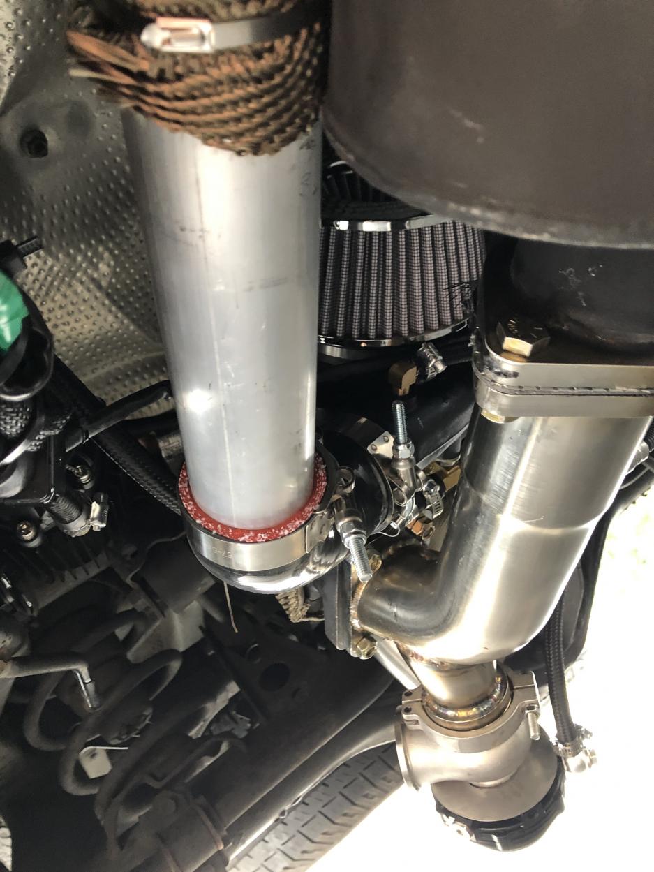

I got my exhaust hangers installed in the rear and the down pipe from the turbo installed. I also had the wideband bung installed about 4 inches post turbo.
I also installed a check valve which solved my oil in the compressor issue. I now do not need the scavenge pump to run after the vehicle shuts off.

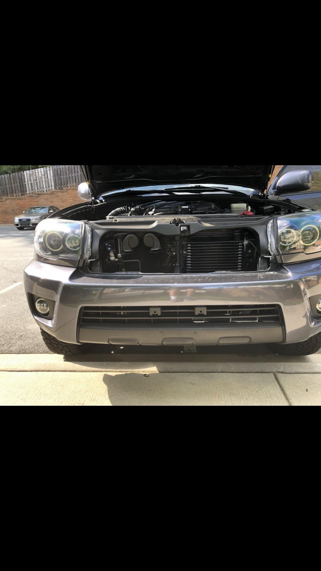

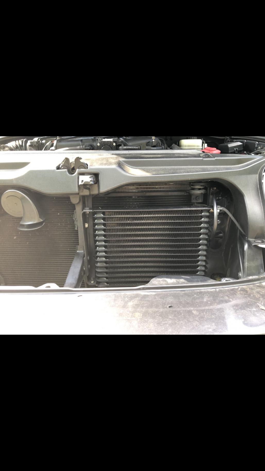

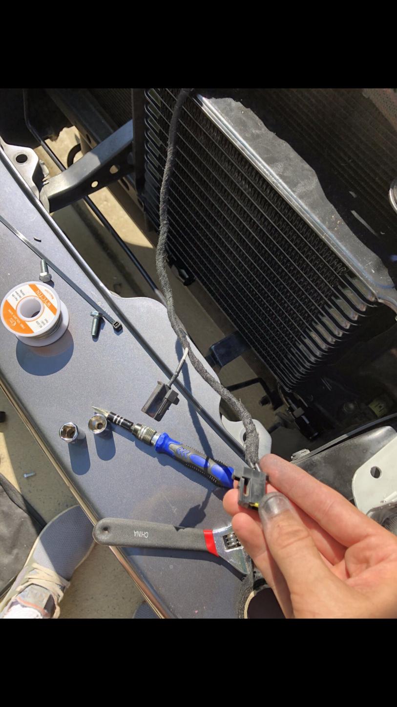

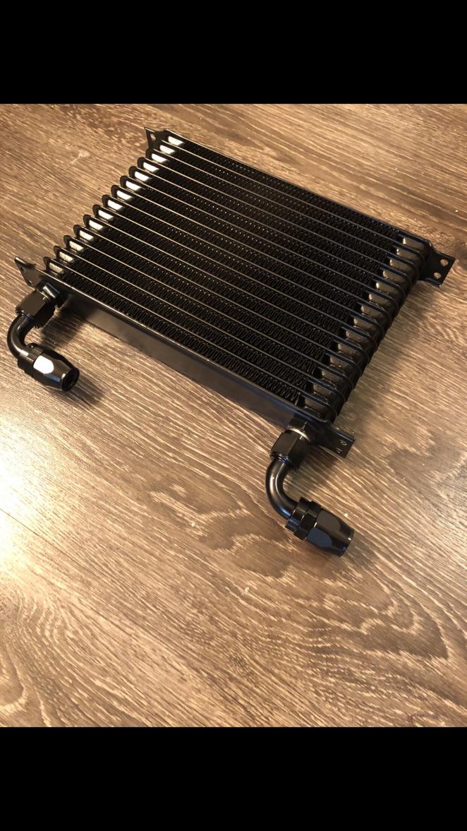

Today I began the oil cooler install. The one I went with was universal so I used aluminum bar from Home Depot and bent it to the proper angles to hang it. All attachment points are drilled and tapped and it is solid. I’m currently waiting on the hose and sandwich adapter. In the process I also moved my horn to the opposite side and extended the wire harness. I also ran the power and ground for the fan for the oil cooler. Still waiting on that as well.
I also have ordered the Hayden trans cooler. Although neither this nor the oil cooler are necessary I still wanted to keep temps down as much as possible for reliability and longevity

Thanks! The project is starting to wind down. Just doings fingers crossed some of the finishing touches haha
Actually the engine oil cooler is quite necessary. When i added a turbo to my VW GTI back in the day, the summer time cruising oil temps went from 214° to 232°. I added an oil cooler also and it brought it down to around 218°

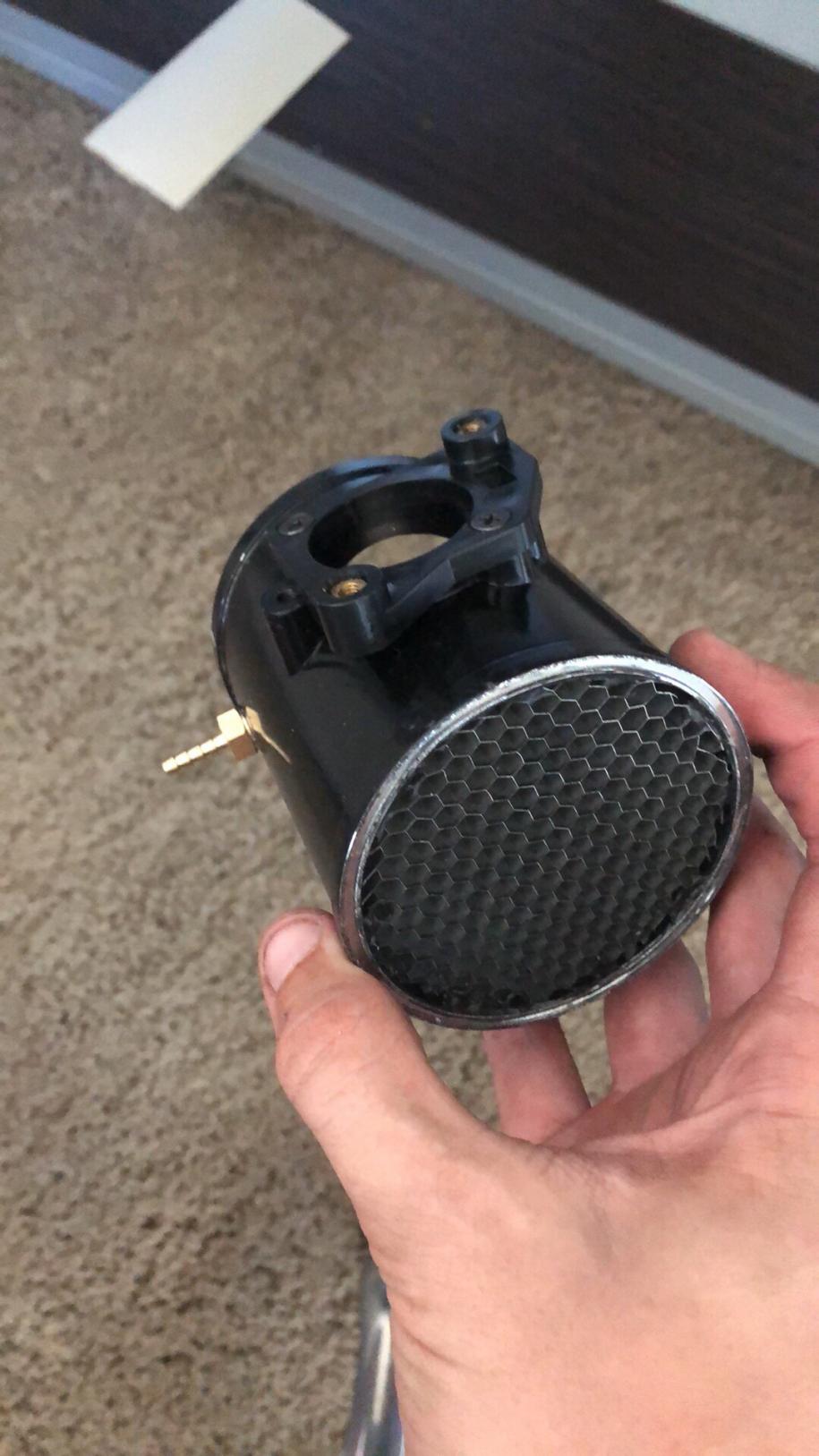

Also, is this going to be a blow-through or pull-through setup? I see the filter going directly to the turbo so i assume blow-through... Im wondering how the MAF will handle being pressurized and if it has limits as to how much air it can read.
Good to hear it will help! and if I'm following yes it will be blow through. My maf is still near the stock location but I built an intake with mesh inside to even out the airflow. On my test pull last week it didnt give me any issues whatsoever. Today I finally got my wideband working properly and its insane to me how rich these toyotas run. At idle I was seeing 14.3-14.6 pretty normal but under wide open throttle the number steadily dropped to a whopping 10 afr naturally aspirated lol. Talk about pig rich

I have been pondering this. Definitely something I'm considering. As far as ho my setup is, I have a sandwich adapter for my feed all with braided line and an fittings. I would be less worried about a failure on the feed side as apposed to the return since those are just barb connections. My scavenge pump is about a foot and a half after my turbo and it feeds back to the filler neck on the driver side. I have not had any issues with my oil light so far. I found the extra oil line run accounts for a little over a third of a quart so I just added that amount.
