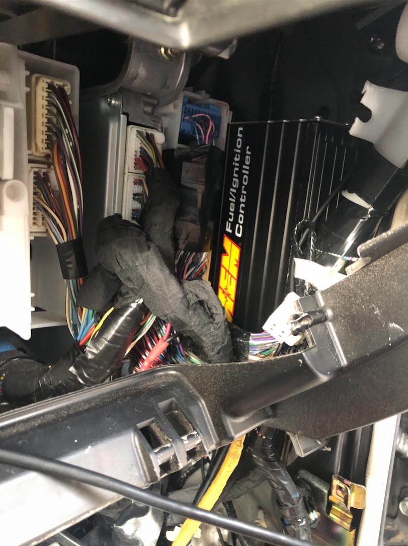

piggyback ecu installed
Hey everybody!

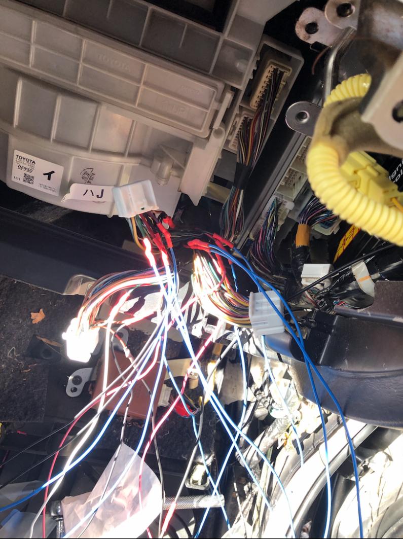

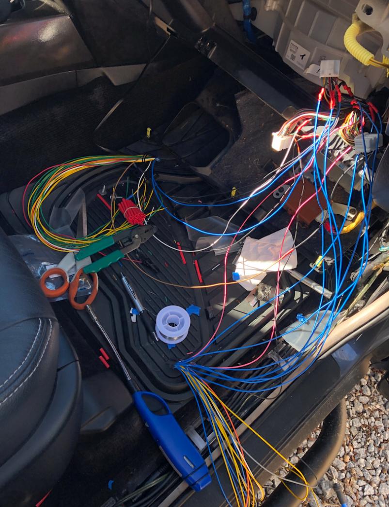

Been a little while since an update. I've been working really hard to get a few things finished up on this. I ended up completely rerouting my charge piping and once its welded I'll have pictures of that. I also just wired in my piggyback ecu which is an aem FIC-6 and it works flawlessly and will allow a wide range of tuning. I will make a full thread on how to install it if others are interested

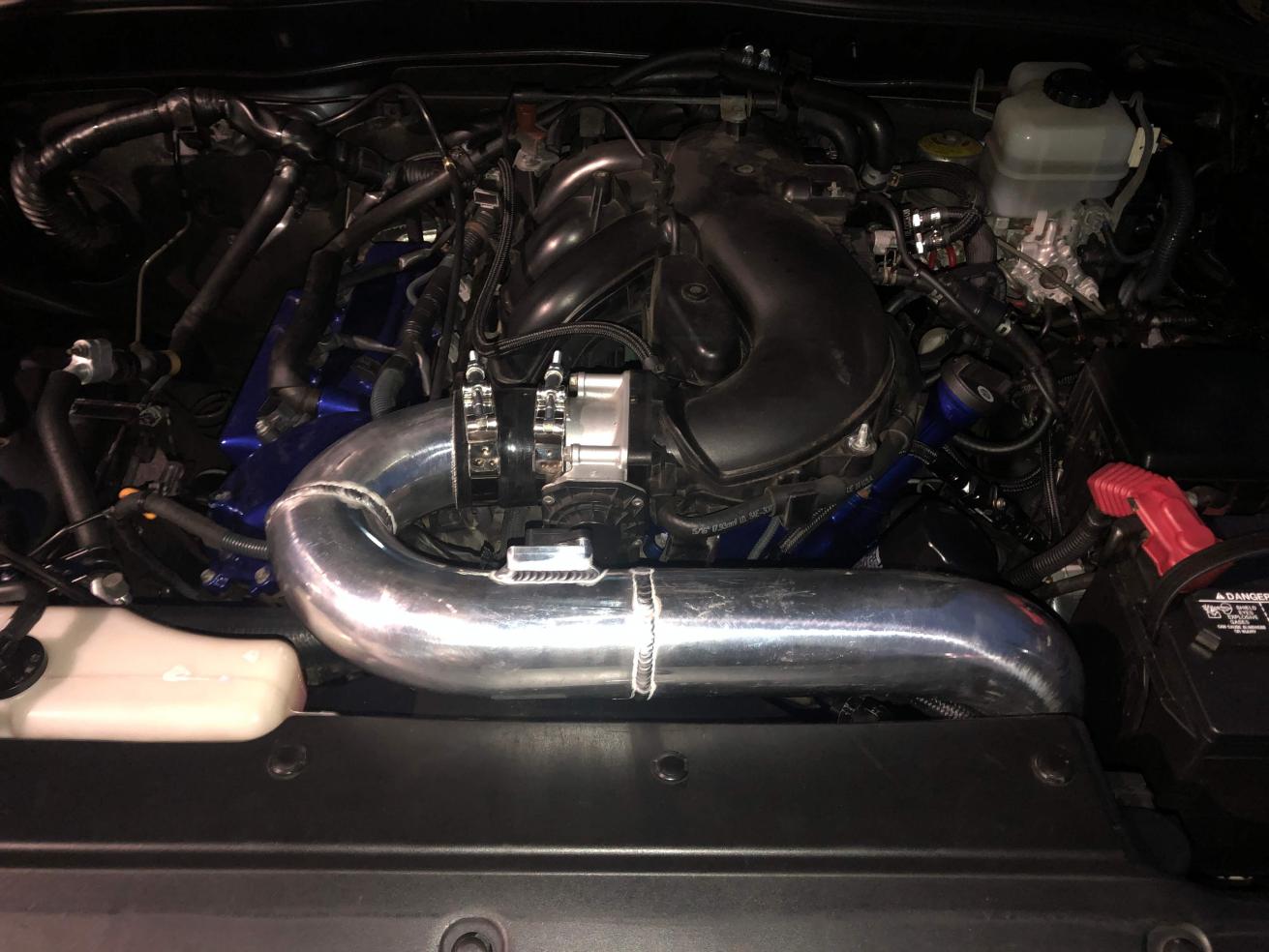

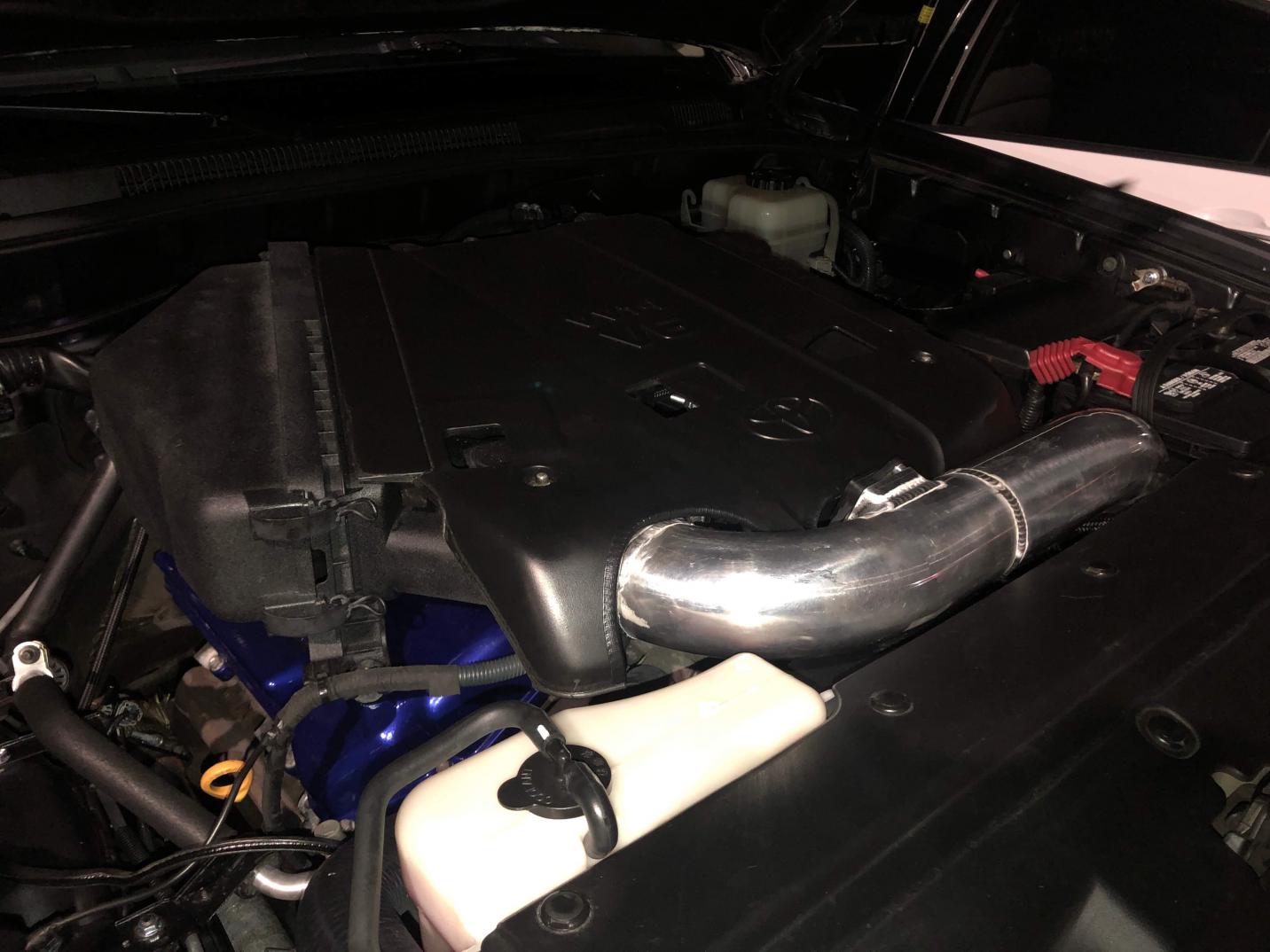

final touches

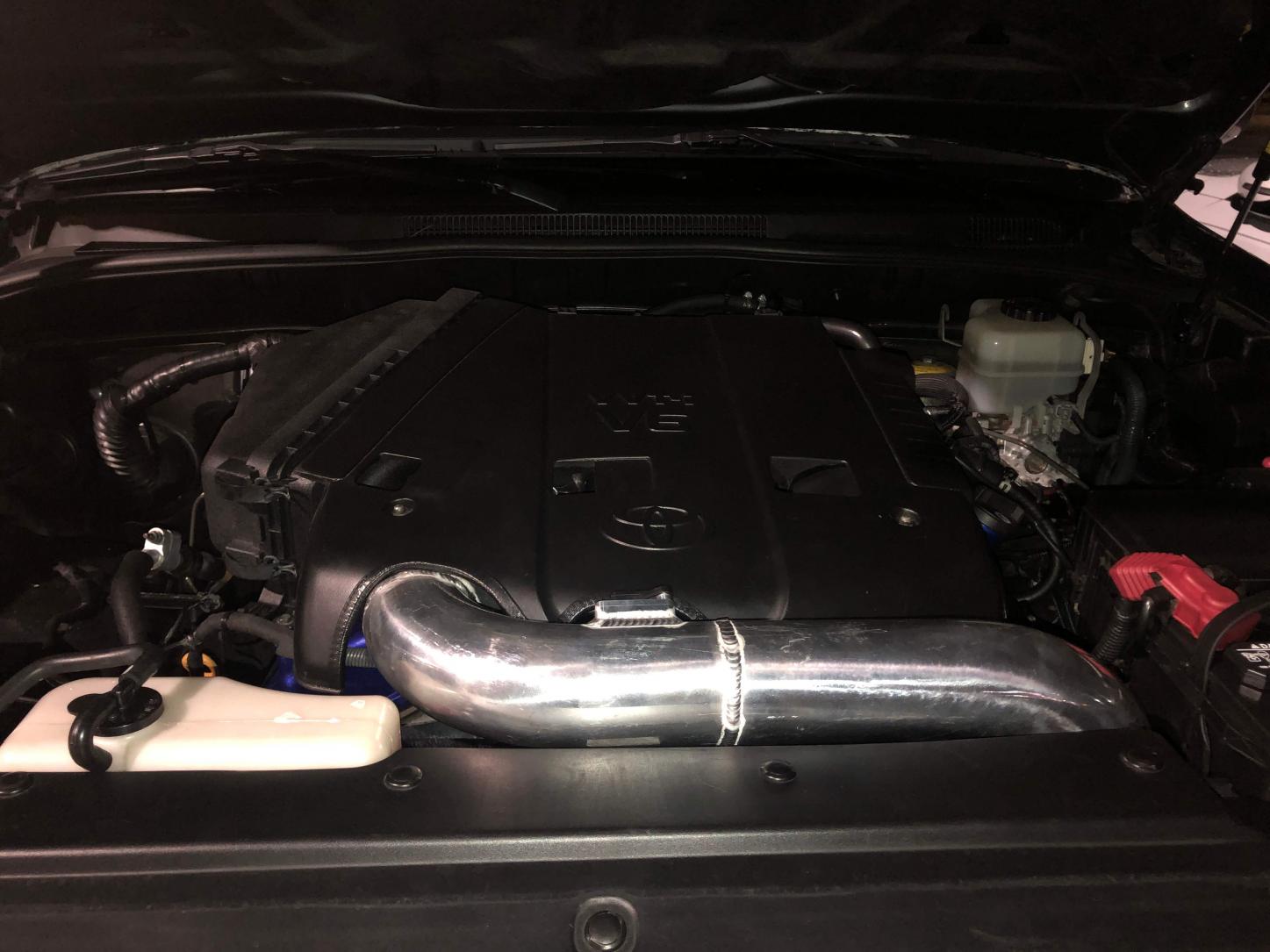

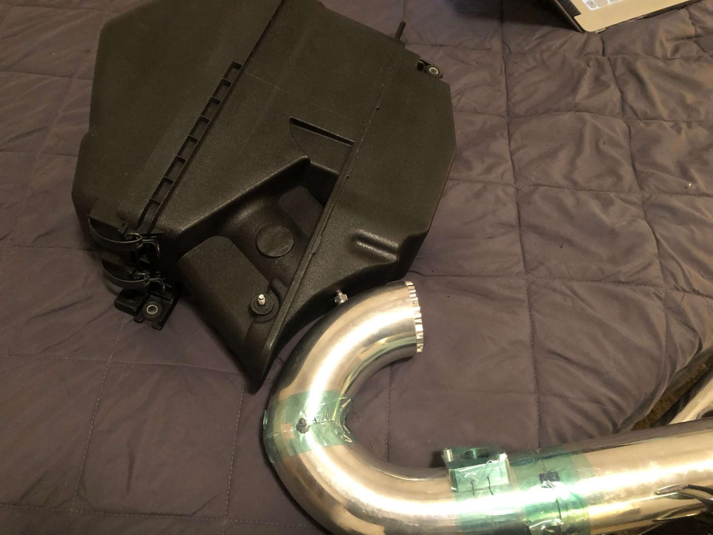

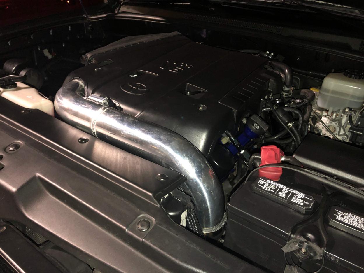

Pretty crazy that its now been about 9 months since I started drafting up plans for this project and now the final touches are being done. This project I started with zero literature to go off off for this generation 4runner which made it a big guessing game when it came to certain things.
That being said I have learned a lot of valuable info along the way and appreciate the input I have received from you all. Below you can see the final touches of my project. I still have to touch up paint on the airbox (which is now a storage box) and powder coat the charge pipe.

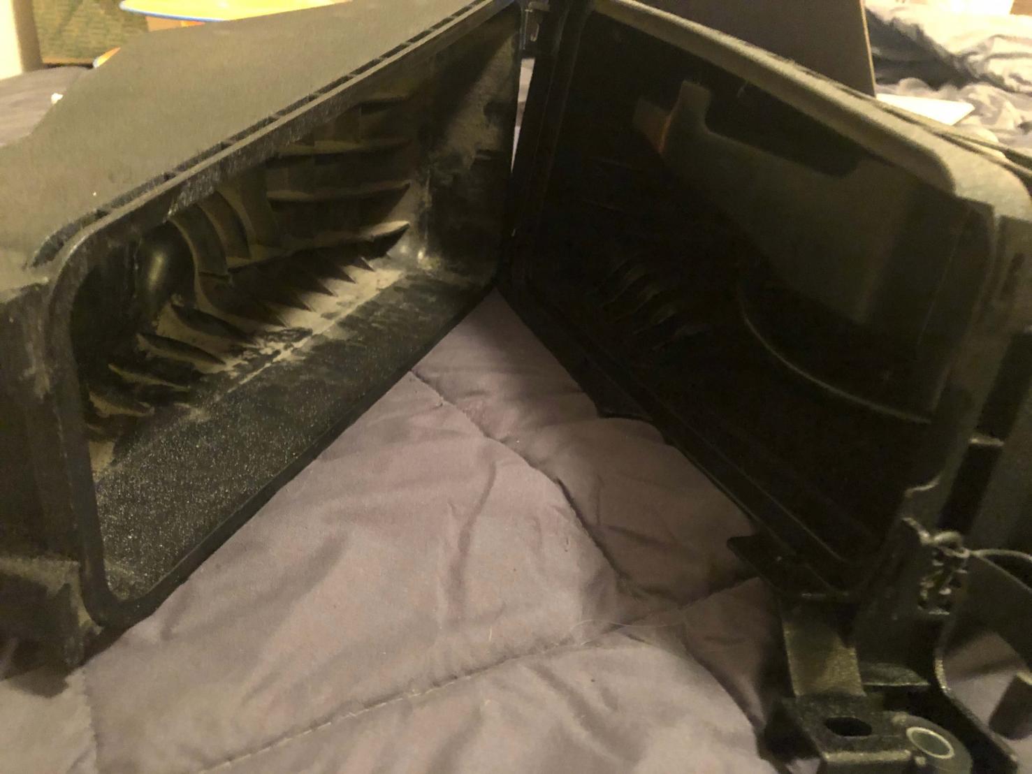

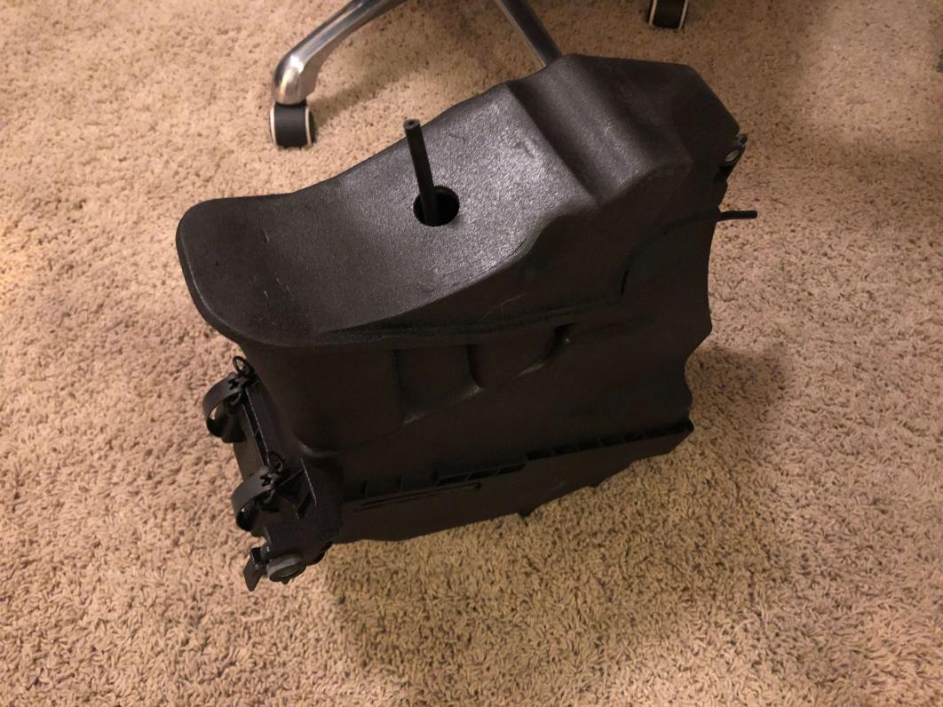

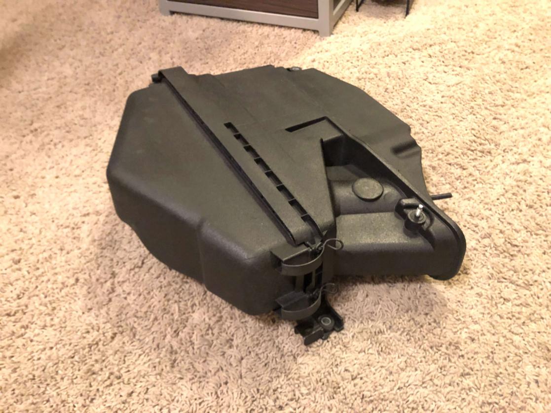

Yes the stock airbox is now a storage box lol. It's big enough for some small tools and oil if I want to bring some along.
if you actually did the write up, it would be very informative.Does the fic-6 work with 8 cyl engines, and can you turn it off so that it does not interfere with OBD 2 for smog purposes?

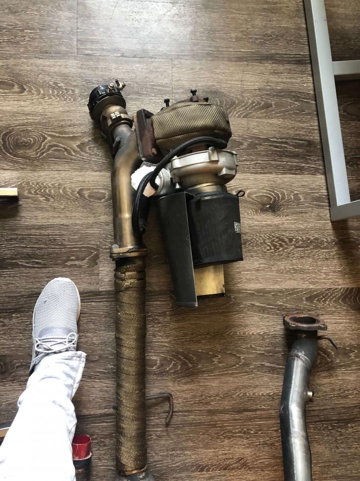

please dont tell me you really bought a 180 dollar turbo....
Already did it! and this unit is only for 6 cylinder engines. they do make an fic-8 which i believe is very similar to this unit but is for 8 cylinder engines. And yes It has a bypass harness that can be plugged in

I did but many people have run them with no issues. that being said I am saving up for a name brand one. Injectors are also on the list just not in the build budget at this moment

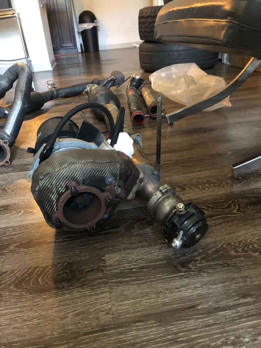

selling the set up

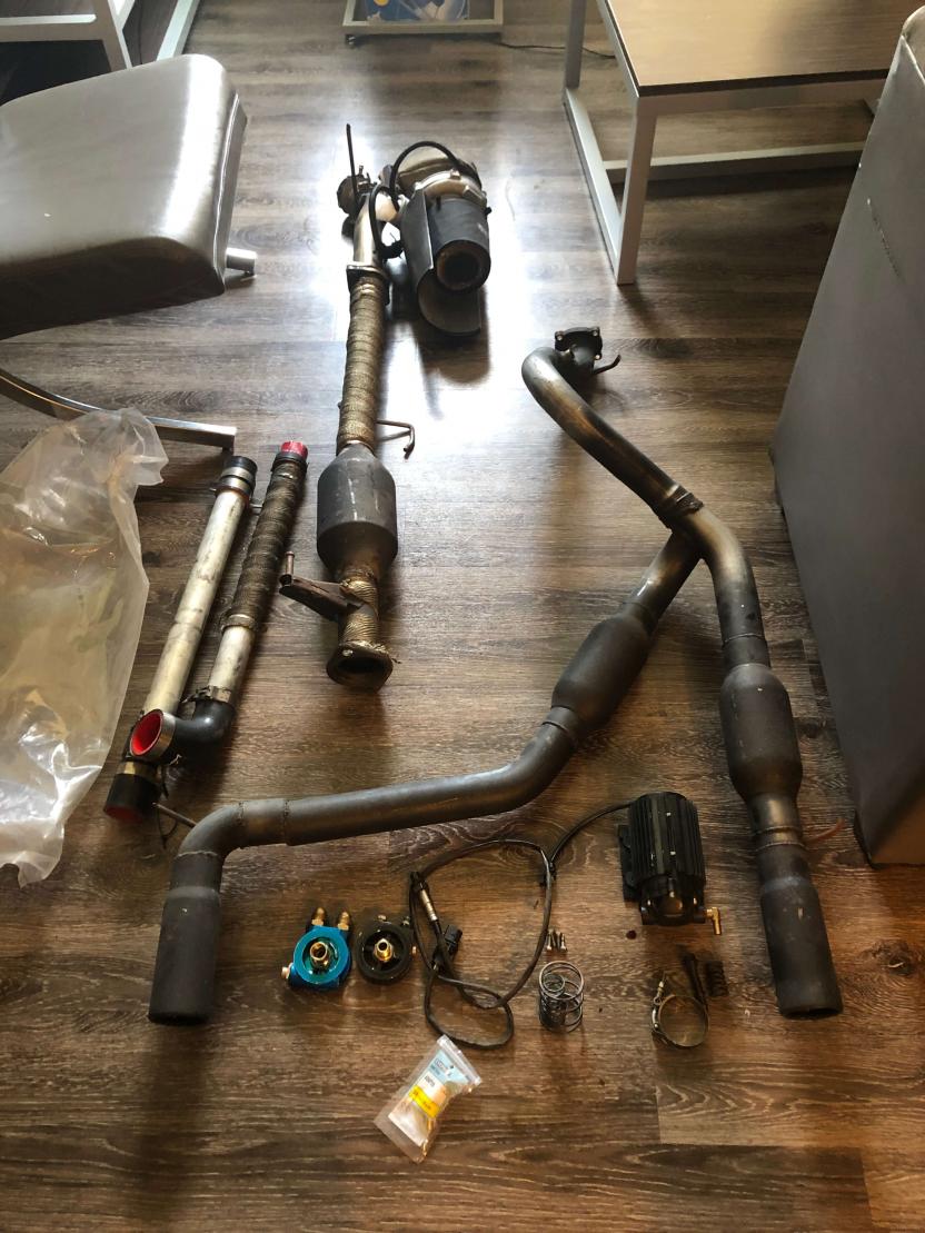

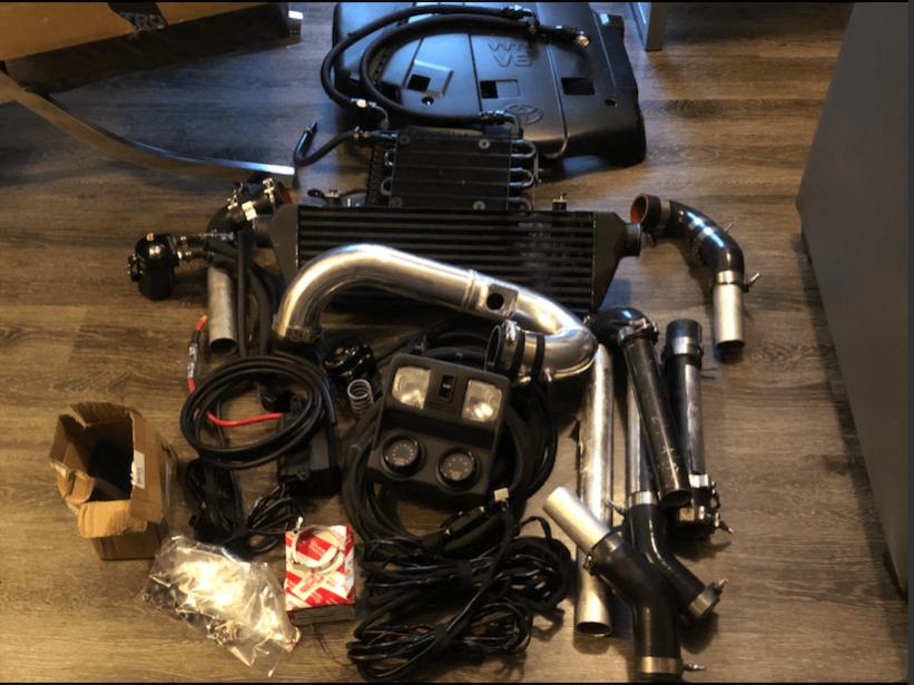

set up works but I'm at a point where I do not have the funds to complete this project and I need to do something different. This project has consumed a lot of aspects of my life for the last 9 months and although its almost done I just do not have the money to finish it. If you want the turbo system let me know. with the exception of the fuse panel, and the piggyback ecu everything else would be included. please understand you would need exhaust hangers to hang the turbo section, you would also need it welded to your exhaust up near the y-pipe. the rest with exception of a few things is just labor involved with installing stuff. As much as I don't want to do this I don't really have a choice.
For sale
as was posted before the whole setup is for sale. aside from a few exhaust hangers and an exhaust gasket the whole system is there and ready to make boost. Send me an offer worst I can say is no. Located in Charlotte NC
