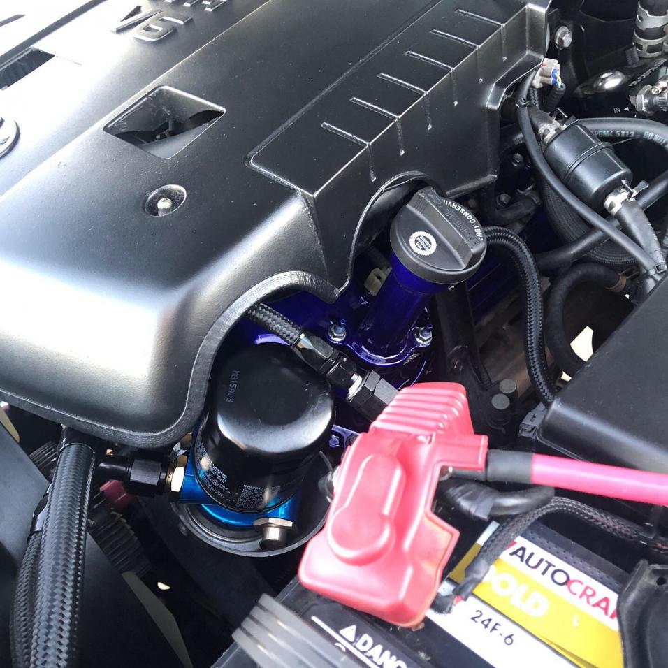

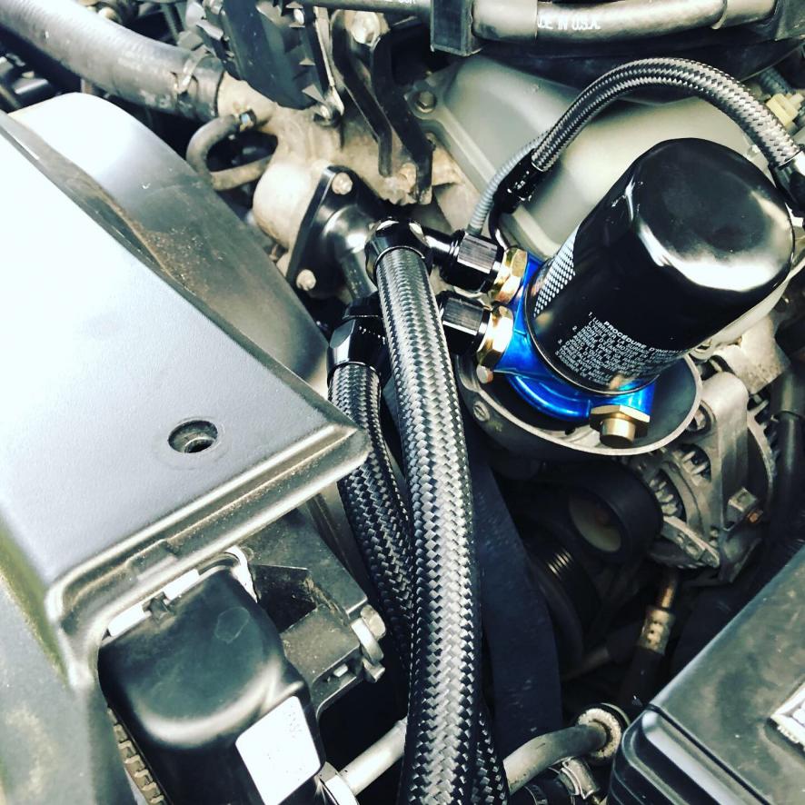

a sandwich under the oil filter i understand.
a stock extra pressure sender (depending on psi level its diaphragm /signal operates at) could assist with the potential failure modes of pressure drop, line rupture, blockages, air lock. considering the additional un monitored length of external pipework. personally i would check the spec of the turbo for minimum /maximum oil pressure req , does it have one ? consider what the block / head normally runs at? and find a switch to compliment that.
you have an interesting project!, its more of a learning exercise for all of us i apologize for being suggestive i cant help being interested.
I do not think it does. Its an ebay turbo so I doubt they thought of that lol. As far as how much oil it gets, its plenty. Theres no reducer on the feed other than the check valve but i get a solid stream of oil coming back from the scavenge pump. My plan was probably going to be to find the oil psi ratings for various driving styles and then get a pressure switch that lets say goes off at 20 psi just to have a number figure. I could wire it to set an alarm. Luckily the way I plumbed everything if worse came to worse and I had an oil line failure or pump failure I could unbolt the turbo, shut off the feed and pull the relay for my scavenge pump all within 15 minutes. Along with this my feed and return have check valves so any oil left in the lines would in theory stay there. I built it this way for in case of an oh shit moment.

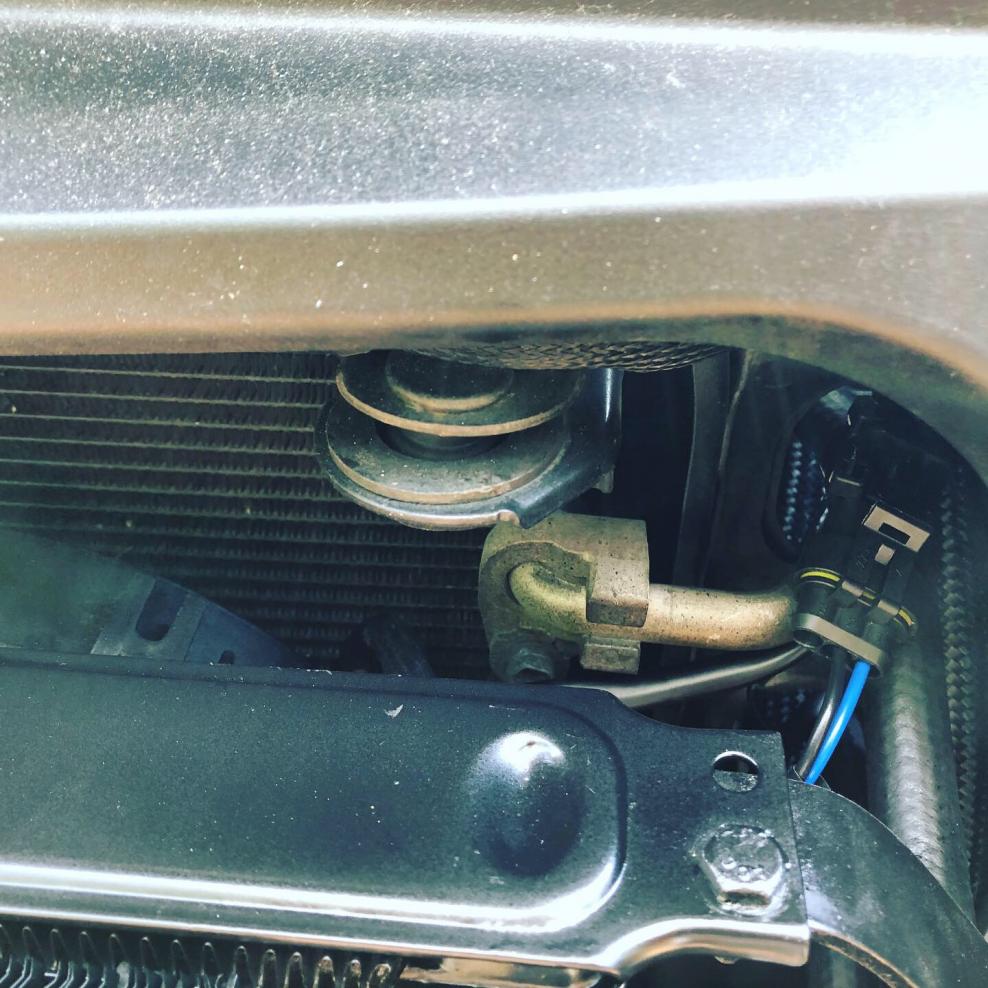

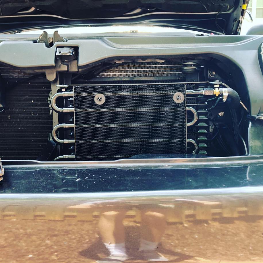

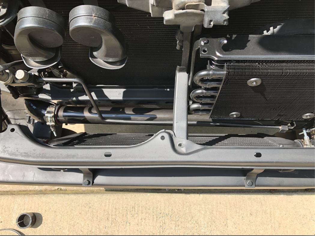

cooling systems upgrade
Part of the build process is not only adding the turbo but also beefing up other systems that are pre-existing to make things as reliable as possible.

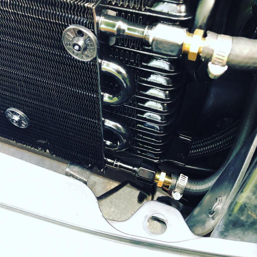

To do this I added a Hayden transmission cooler in hopes of for one keeping the trans a little cooler, but also to keep the radiator cooler.
Along with this I installed an engine oil cooler for a few reasons. Although due to the long run of the oil return line it did help cool the oil, I still knew it was adding heat to the system which not only breaks the oil down quicker but also puts added strain on the engine systems. An added bonus of this cooler cooler is that it adds approximately 1.25 quarts of capacity to the system
To install these I created aluminum brackets that are bolted in place. These brackets connect to the oil cooler. Behind the oil cooler is a puller fan to assist in keeping temps down and in front is the trans cooler. The trans cooler lines just run to the factory lines. The engine oil cooler runs to a thermostat sandwich adapter that opens at operating temp. These are connected with 10 an line and 4 10 an 90 fittings. The fan is run off a 15 amp fuse within the fuse box I built earlier in the build.

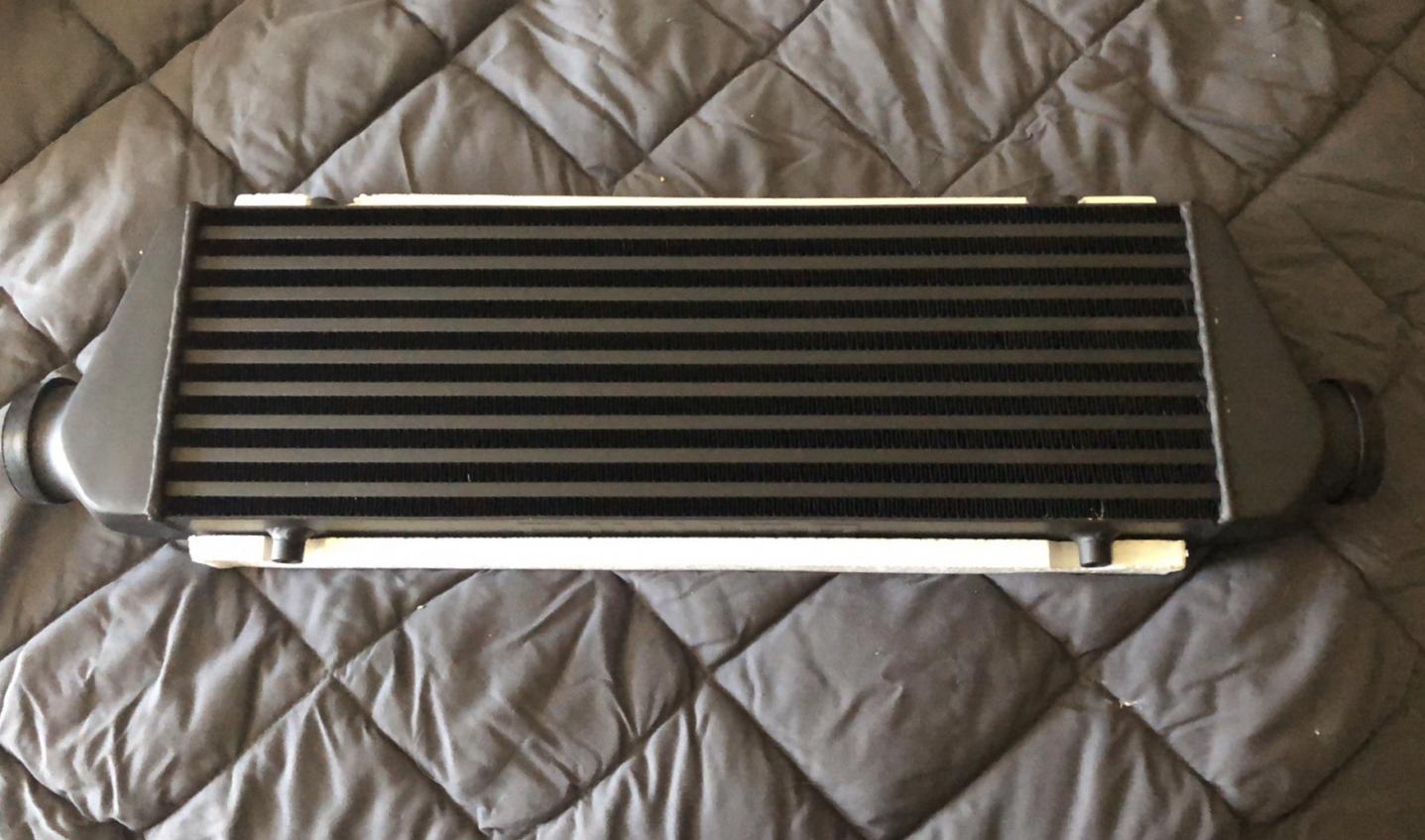

Also my intercooler came in today so within the next week I hope to have it fully installed

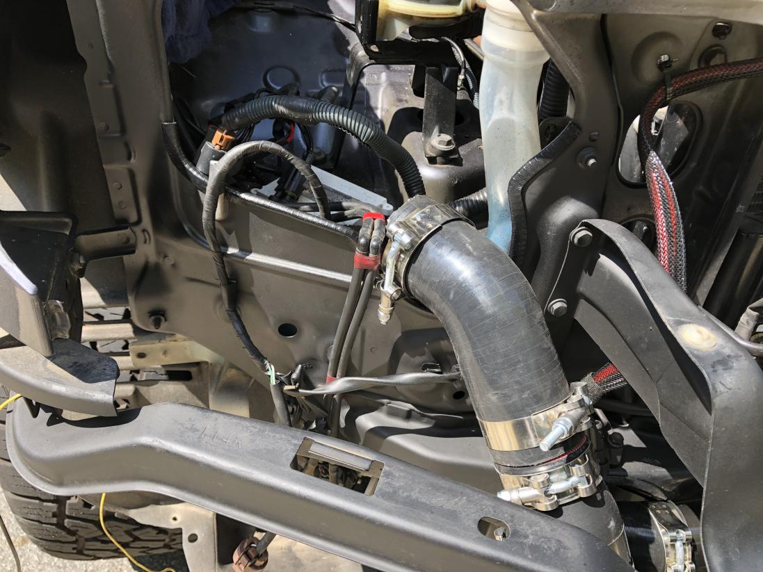

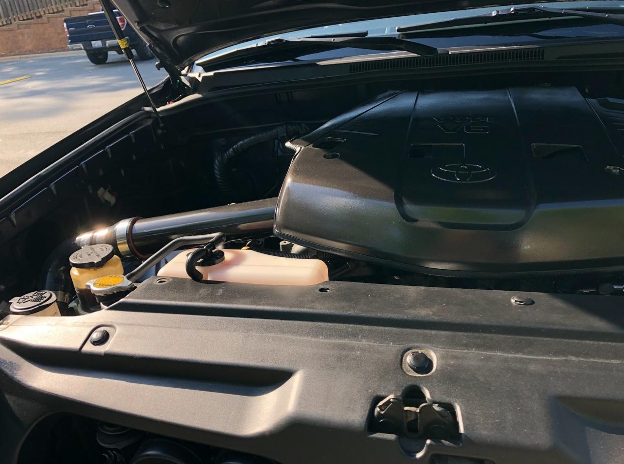

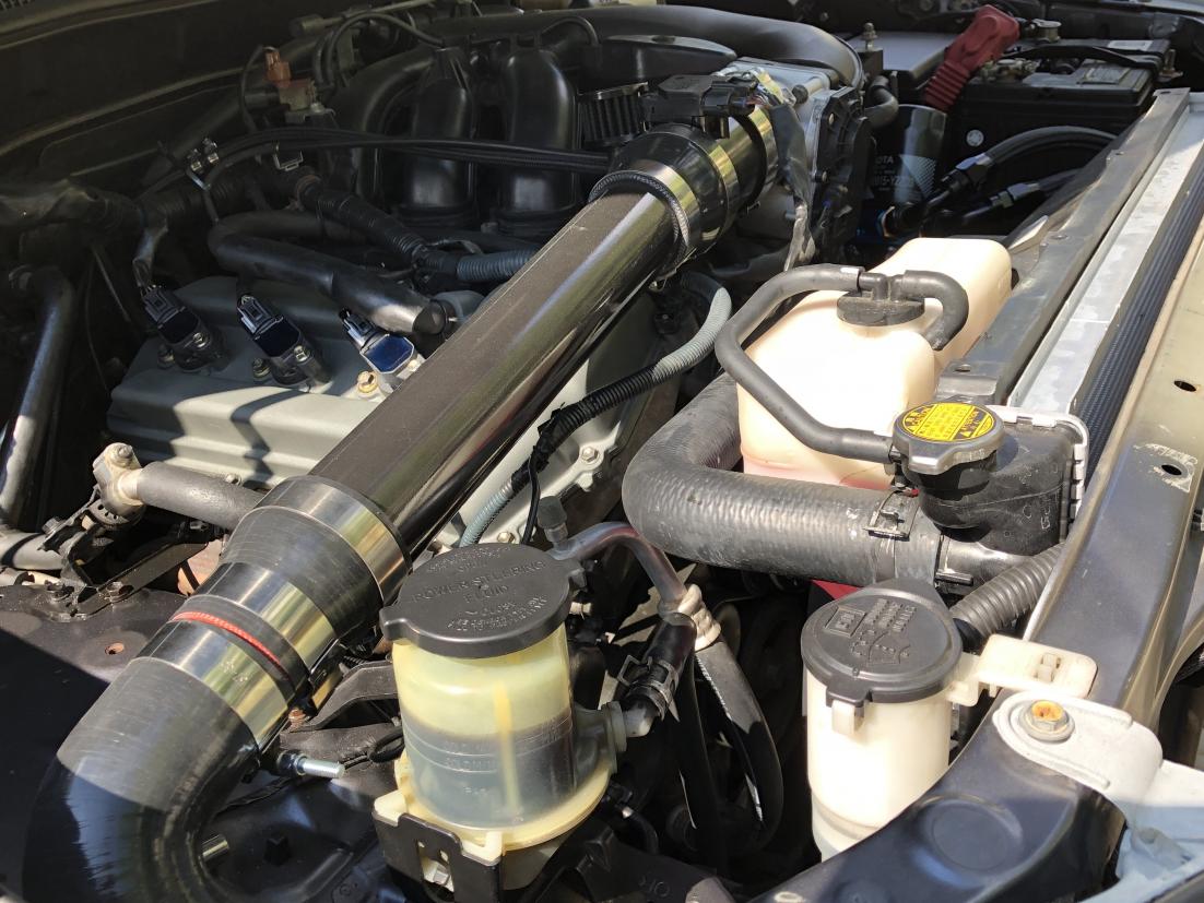

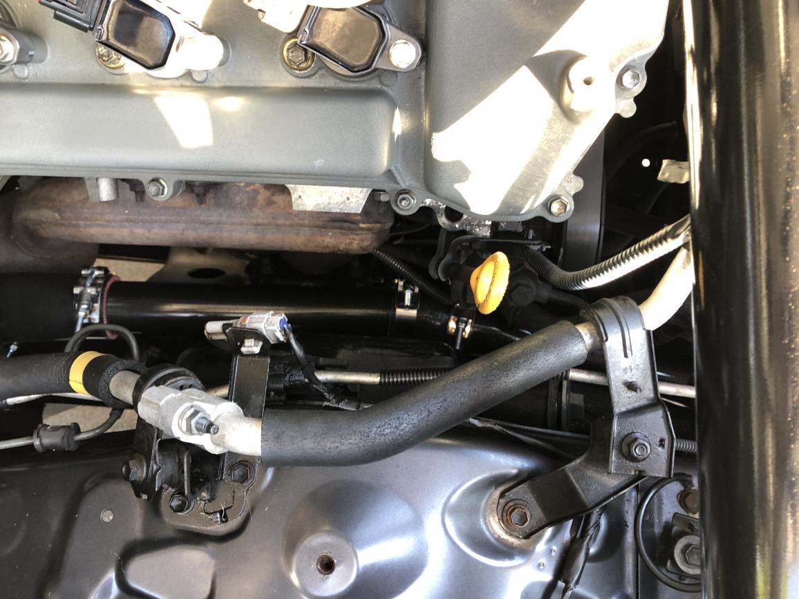

charge piping!
All charge piping is installed! All of it is beaded on the ends and painted carbon mist metallic. Any parts of the metal body I had to trim have been covered with trim guard. The intercooler is solid mounted below the bumper for a stealthy look. Intake temps never go any higher than 15 above ambient but when driving are typically 7-10 above ambient. Big step finished! I also moved my boost reference to right at the maf

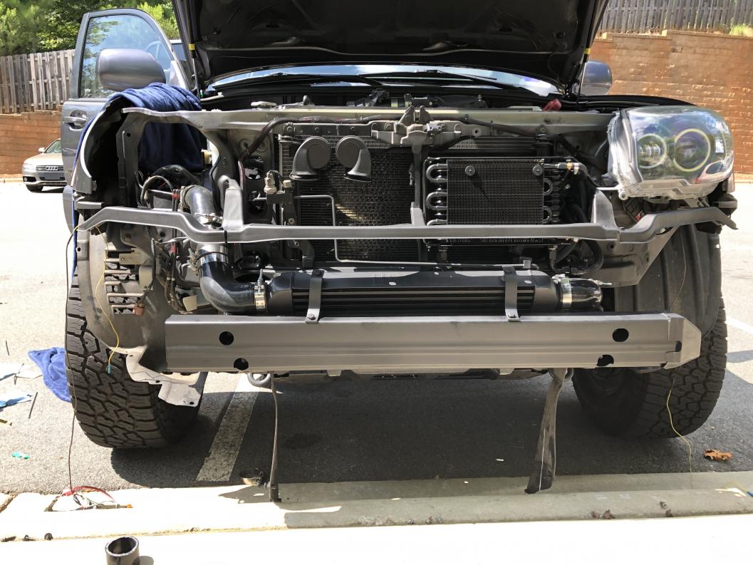

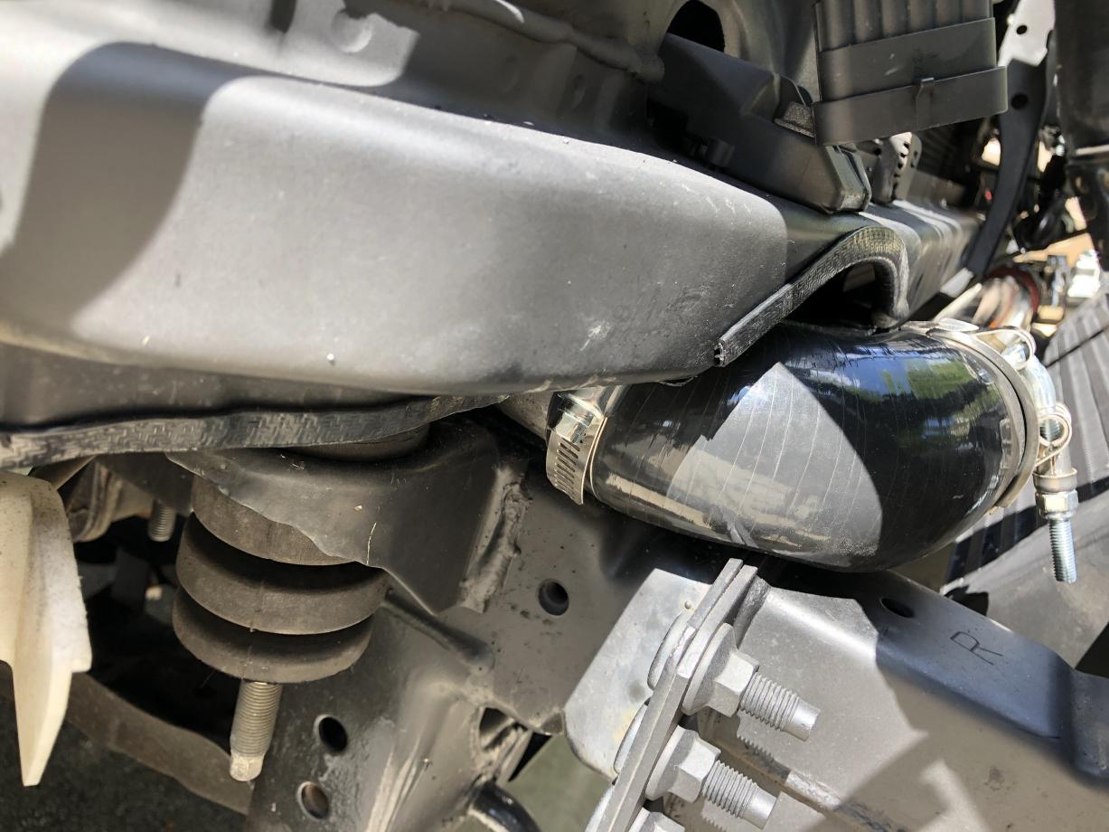

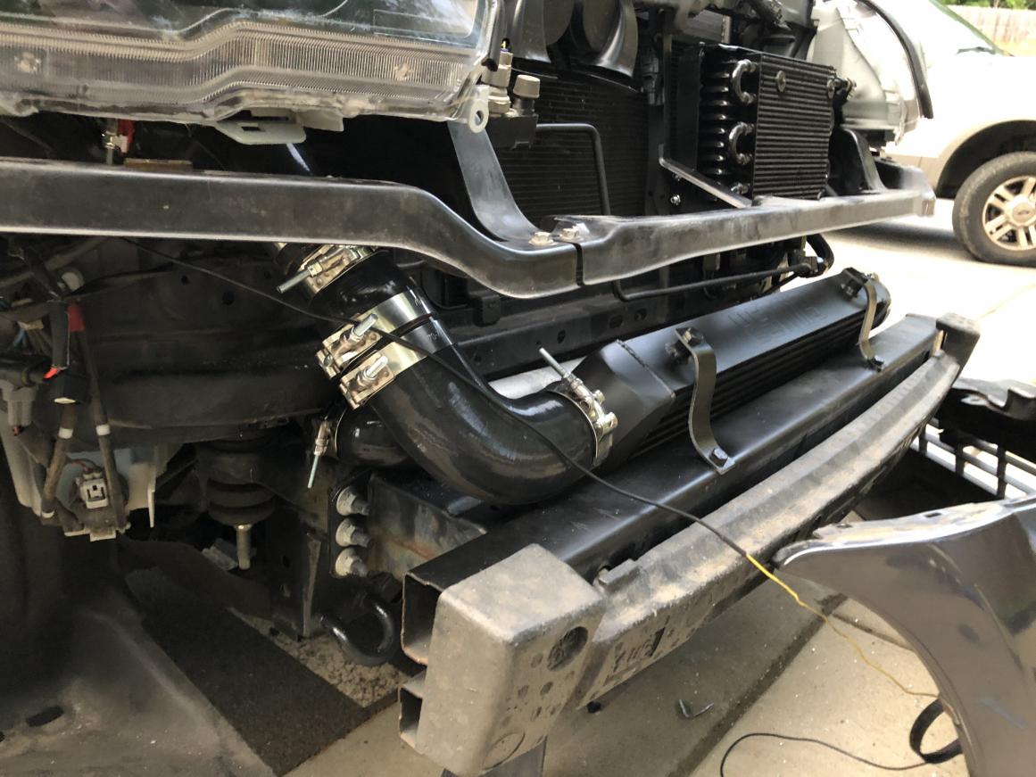

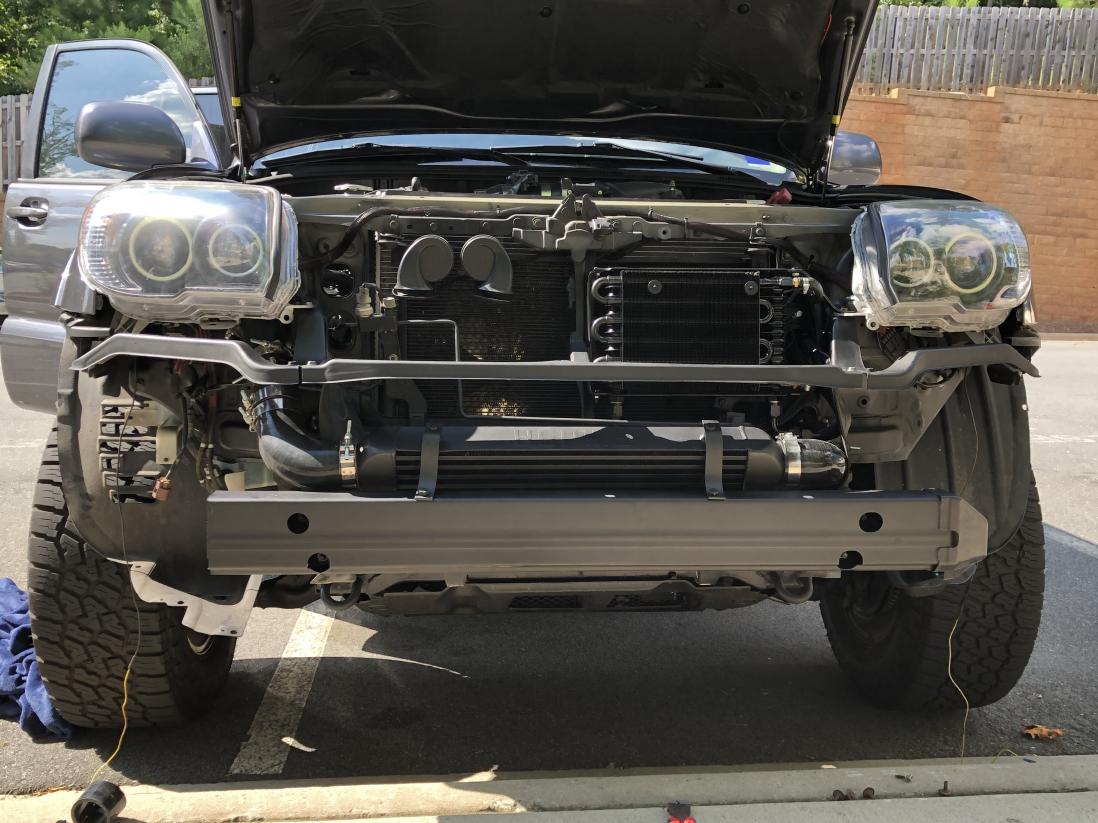

Seems like the IC placement behind the bumper support might not get enough flow? It looks to be mounted on an angle which certainly should help, do you have any more pics of the fitment between the bumper support and intercooler?
This is the only other picture I have at the moment. This is before I added the lower support so it now sits at more of an angle. It seems to be getting enough airflow but if worse comes to worse I could always add a plate to direct more airflow

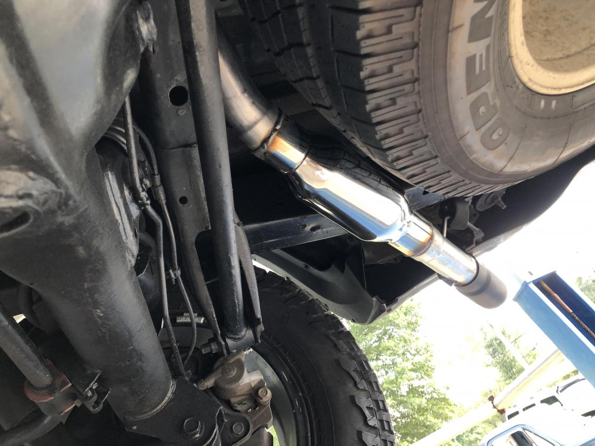

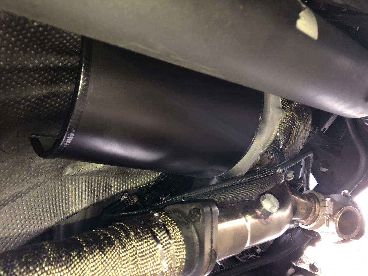

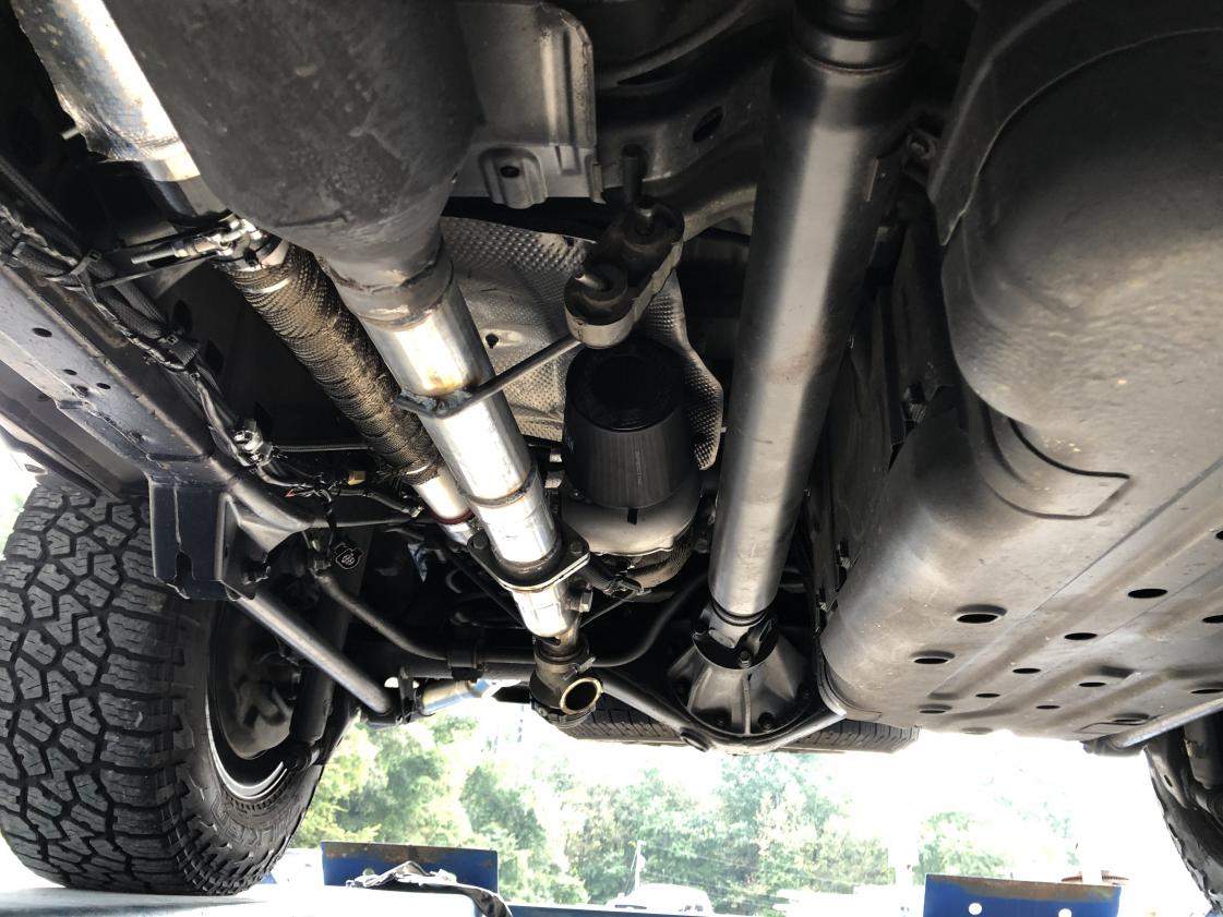

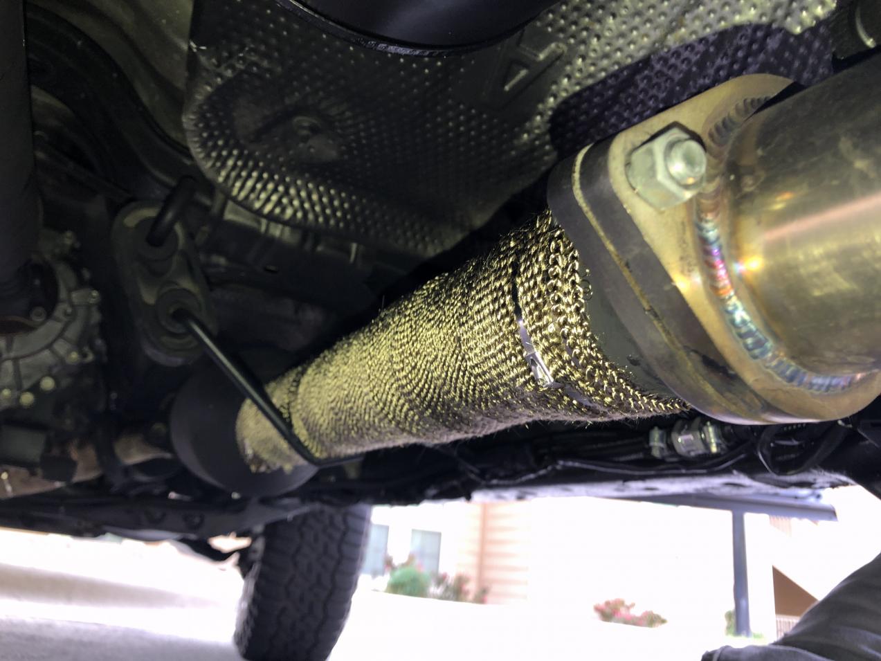

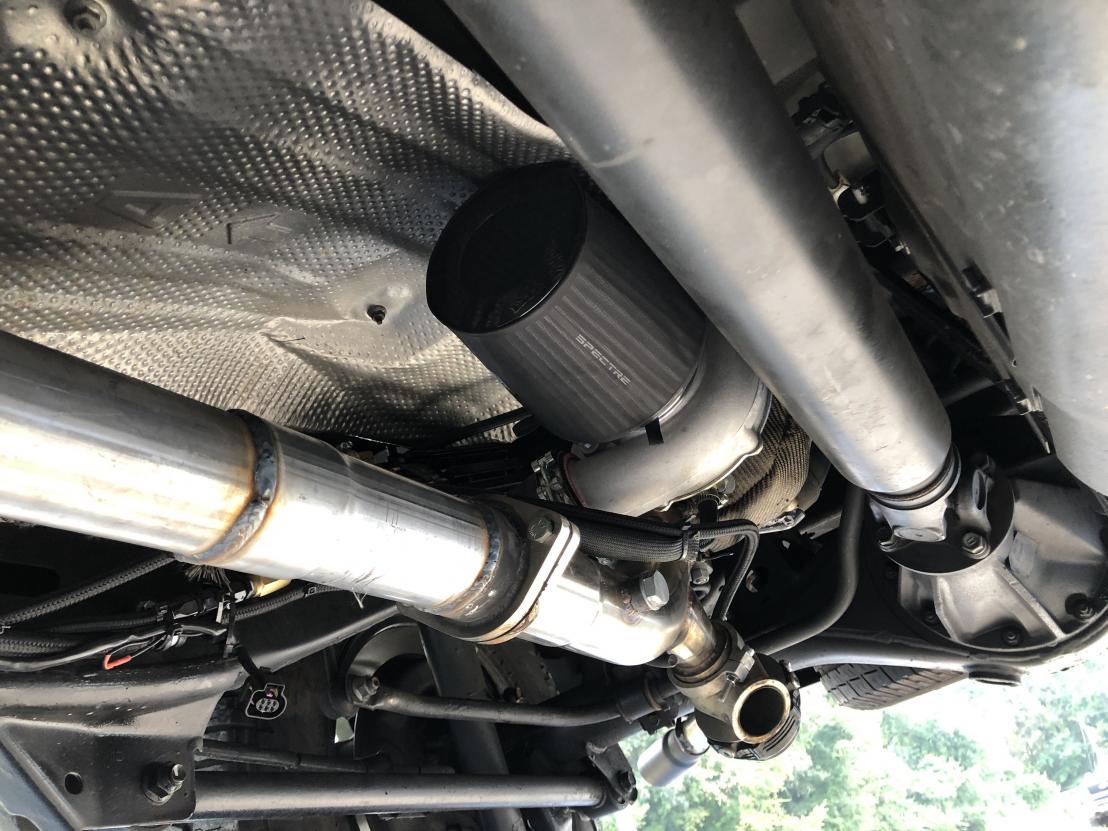

exhaust is done! I had the muffler removed and a vibrant resonator installed next to the tailpipe. I knew this needed to be done to get better exhaust flow to the turbo but was worried about noise level. I didnt want it to be obnoxious and I think I captured the sound I wanted. It still has a nice gurgle at idle but there is absolutely zero drone and the note is nice and deep. This seemed to help a lot with slower spool and turbo lag. I later painted all of the exhaust and did header wrap to keep it warmer.
I also installed a filter sock and shield to keep water out.
Along with this I did a 3/1.5 lift to give the exhaust more clearance of the rear axle in the back. Due to turbo placement there wasn't much space.

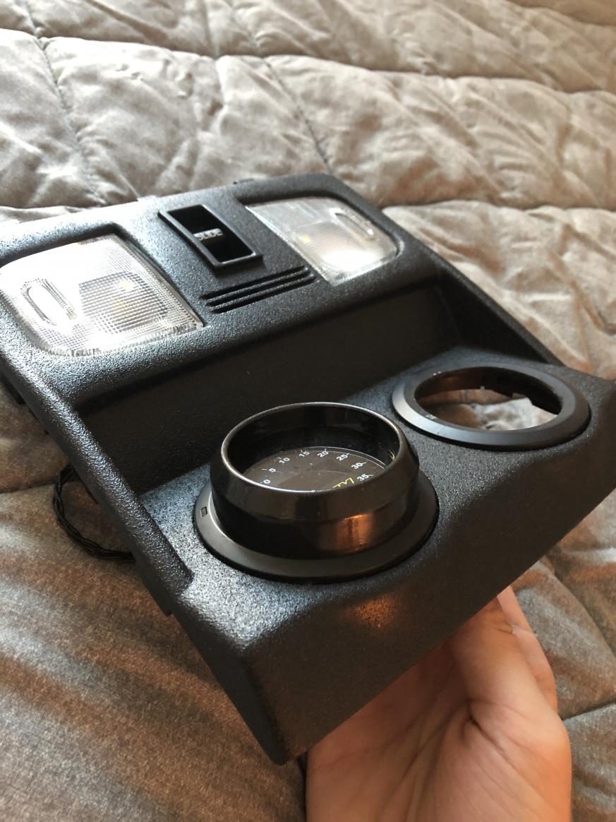

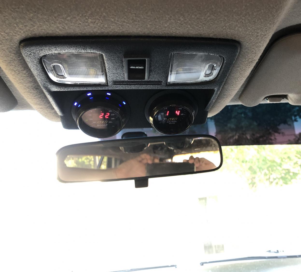

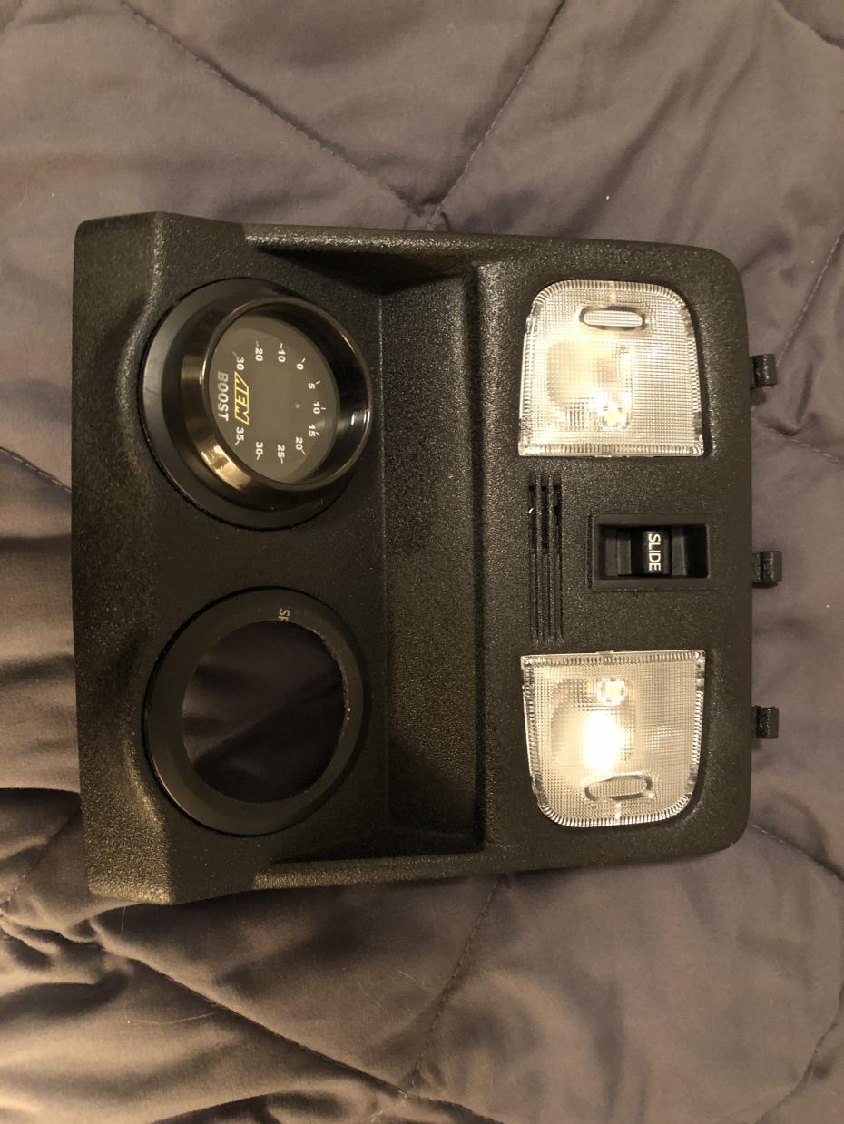

I also recently had to replace my wideband gauge as the old one crapped out. While i had it out I redid my overhead console to where it wouldnt flex and crack anymore.
At this point it runs great on the stock tune and I get similar mpg around town as I use to as well as on the highway. You only really drop your mpg when you get on it in boost which hits around 2100-2200 rpm. I still plan to do a piggyback ecu as well as bigger tires as the stock size looks like it skipped leg day lol.
I also made custom needles for my instrument cluster. each needle has a blue led built it.

Exhaust is now completely done other than possibly another resonator. It is set up as a single 2.5 into the turbo and then a dual 2.5 out of the turbo. This significantly reduced back pressure after the turbo which greatly helped in getting into boost sooner.

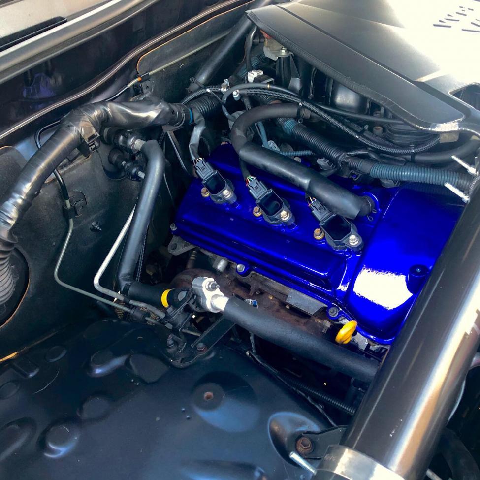

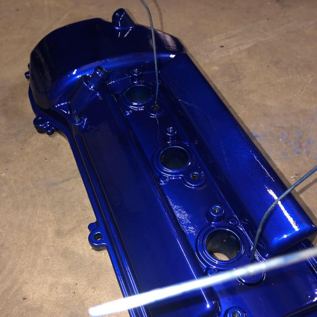

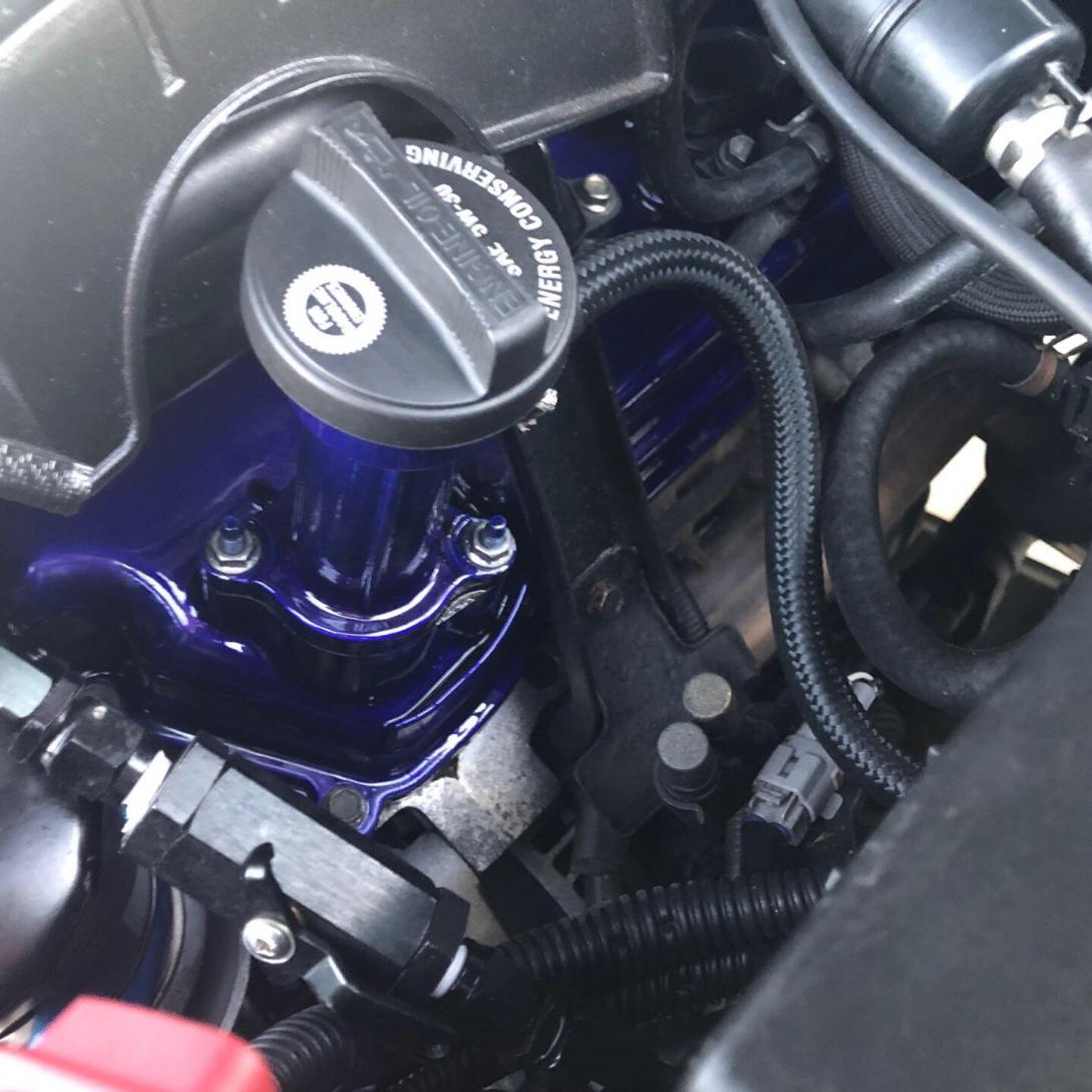

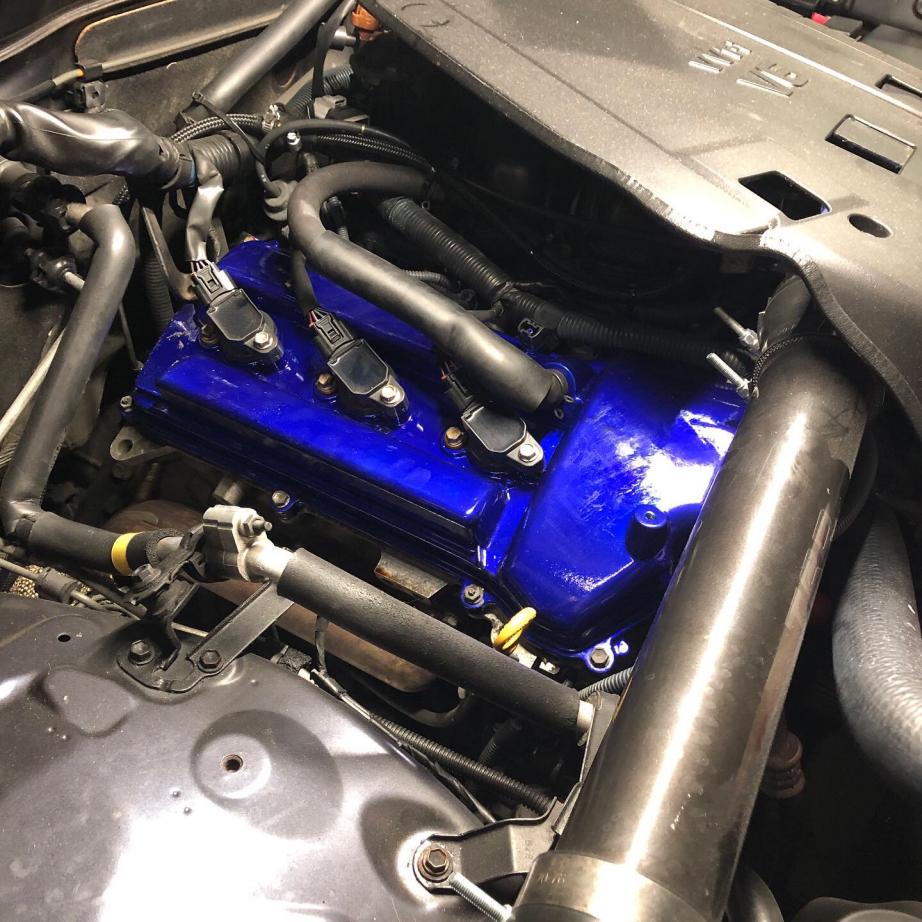

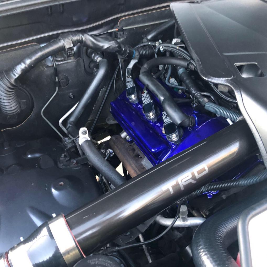

I also was able to powder coat for the first time. probably spent like 4 hours prepping my valve covers. It is not perfect but it looks amazing. Learned a lot and plan to powder coat the new charge piping that I plan to do.
