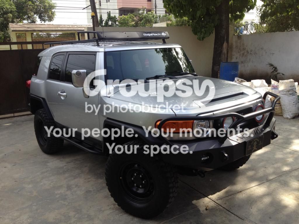

So a little back story, I owned a 07 MT FJ , took it with me to the Dominican Republic when I went down there for Dental school. When I finished school brought it with me back to the States.

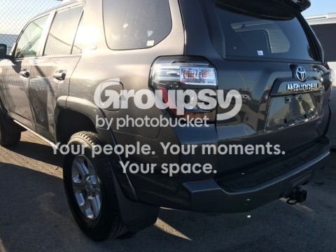

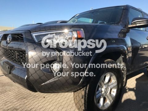

Flash forward to to Feb 16th and I was finally able to get back into a 4x4 Toyota and picked up a 2015 SR5 4x4 (clean Carfax, no rust, 44k miles).
I believe I got really good deal, paid $25,400 OTD w/ tax and tags included. I could have purchased a new TE, but with the added cost would have had to stay stock for a year or two, I took a look at the vehicles history and maintenance records, did an inspection and decided to buy used & use the extra money for mods :guitar2:

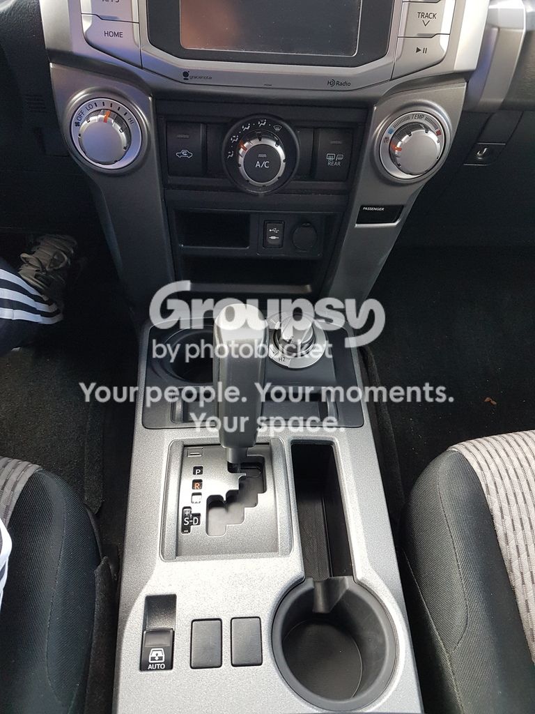

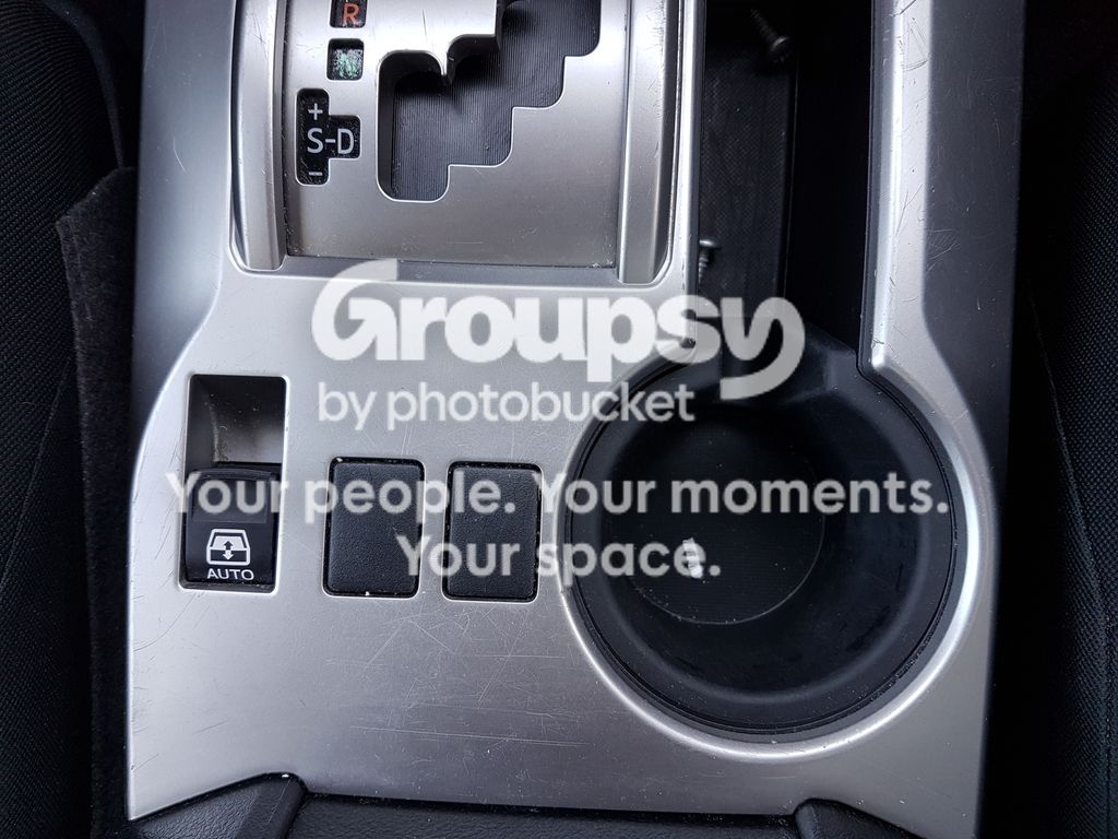

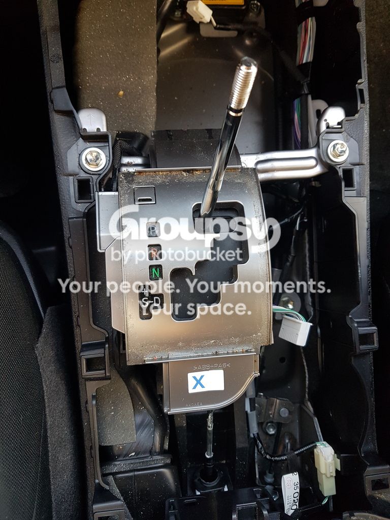

The first thing I did was remove the center console and sand/paint the scratches, while I was at it decided to also remove/paint the hvacs columns and sifter.
20170224_115323.jpg~original
20170226_171910.jpg~original
Really happy with the end result

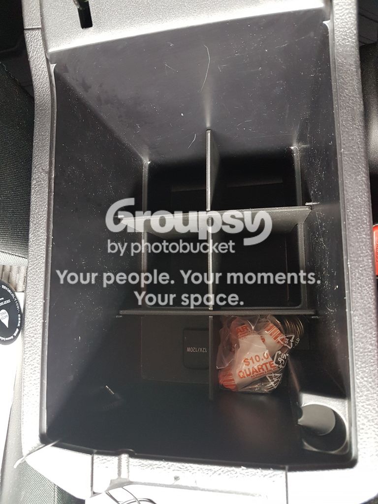

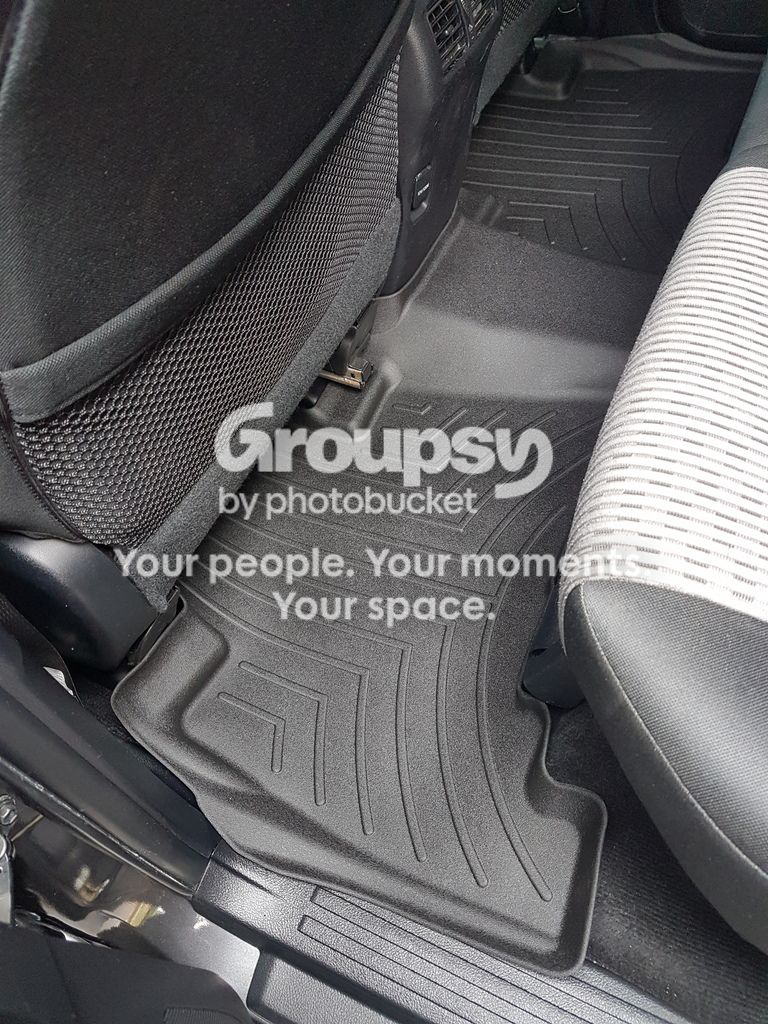

Next thing I did was pick up a set of Weathertech mats to protect the carpeting and a center console organizer.
20170307_140331.jpg~original
20170307_140548.jpg~original

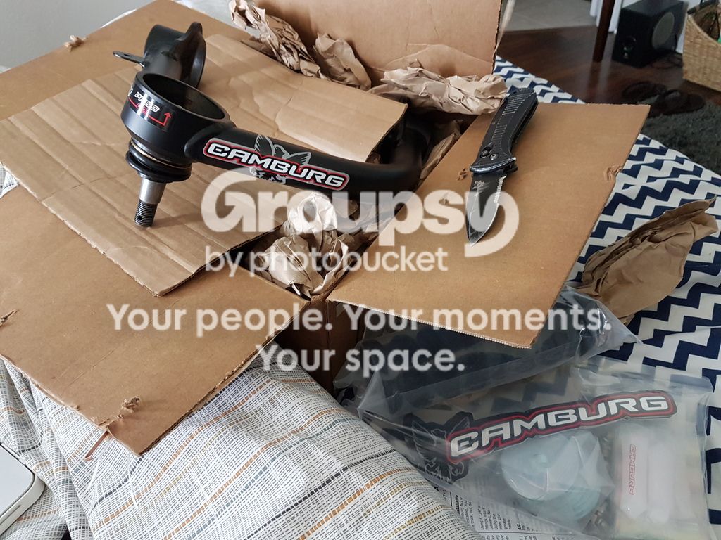

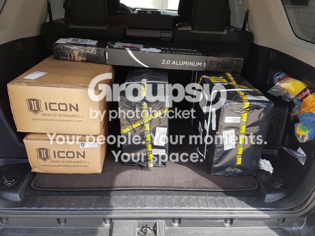

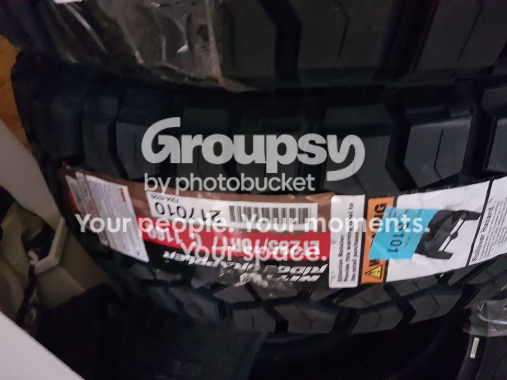

Then some of the real goodies started to come in, over the span of 3 days received my;
- Icon stage 2
- 285/70/17 Nitto Ridge
- TJM Winch and Large recovery gear bag
- Factor 55 1.5" fairlead & Flatlink E
- front marker lights.

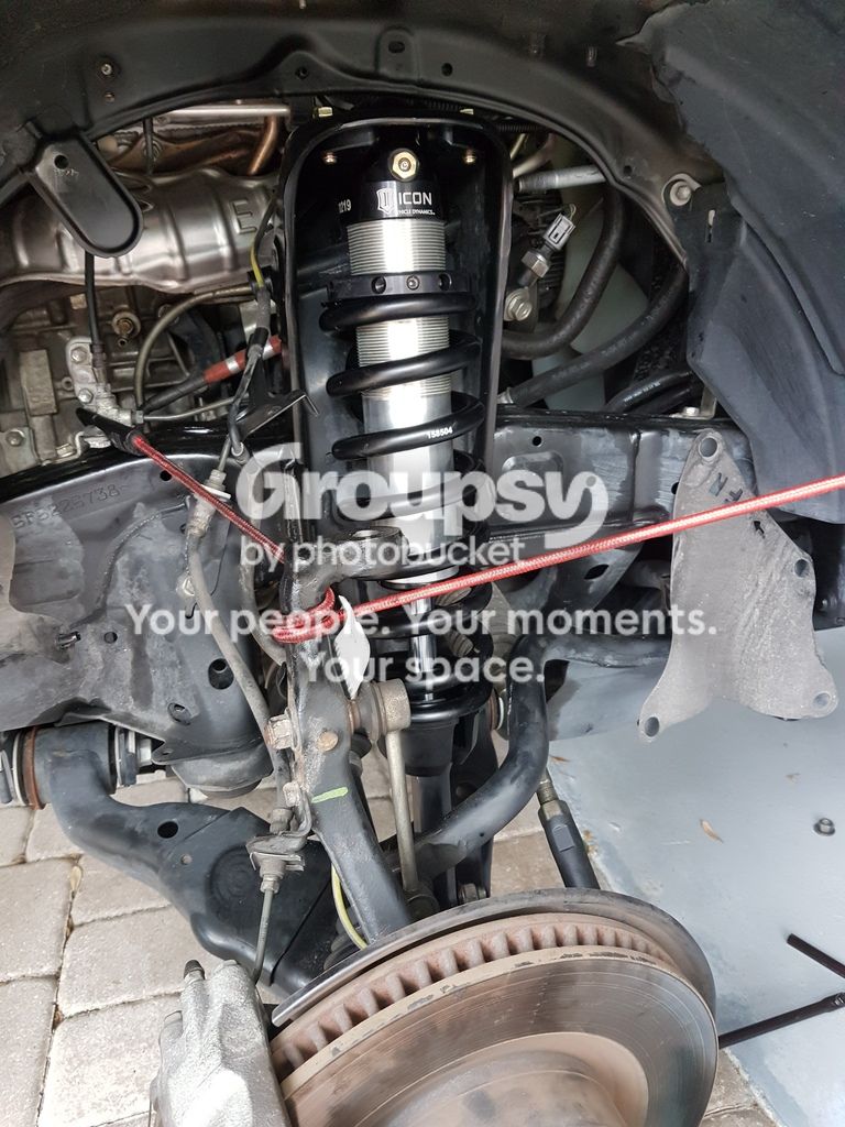

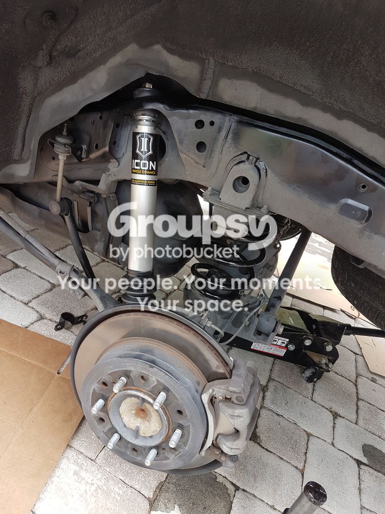

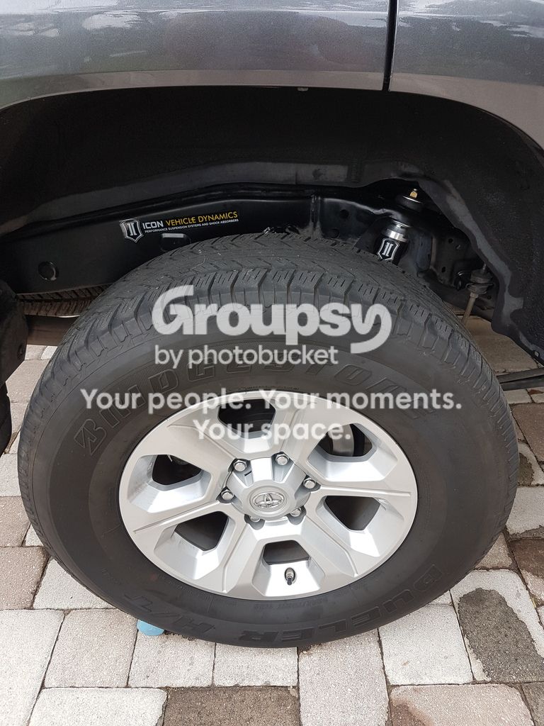

Last Sunday spent most of the day installing the lift and they came out great!
20170312_152707.jpg~original
20170312_174830.jpg~original
20170312_161246.jpg~original
20170313_125946.jpg~original

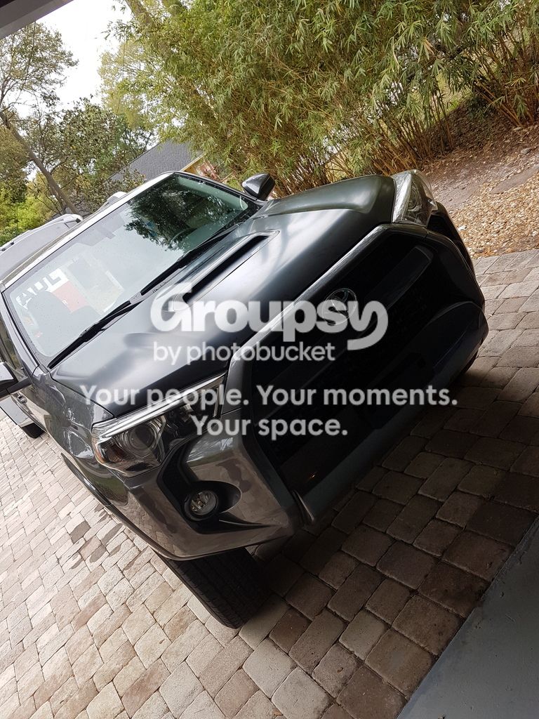

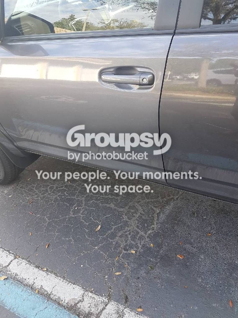

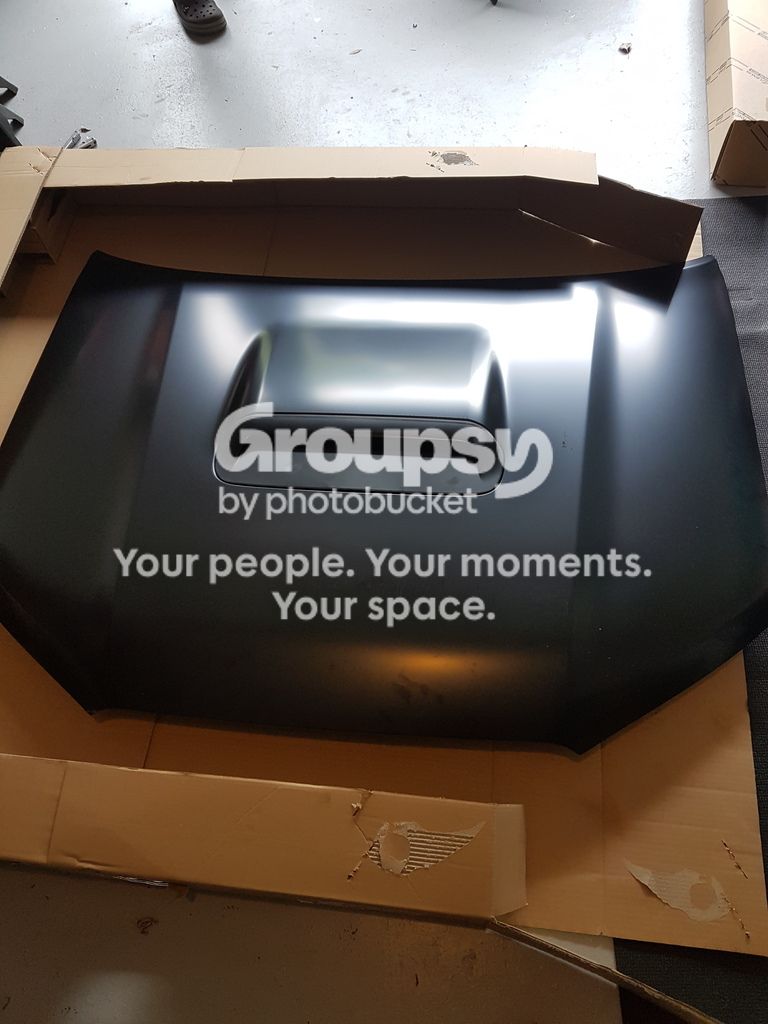

Remember that botched paint repair job I mentioned earlier? It's been driving me nuts every time I walk up to the truck, it's extremely noticeable when the sun hits it. I would have preferred a nice pinstripe of honor to this makeup of shame. Decided I needed to have the door painted, but while I was at it, why not pick up a scooped hood to add those 50+ horse power I keep reading about :car:.
Resized_20170227_092549.jpeg~original
20170313_162231.jpg~original
20170313_163212.jpg~original
So that's where I'm at, waiting on her to get released from the ER and hopefully it'll look great.

I love your bungee cord UCA it just screams USMC make-shit-work, who makes that brand? :D Really adjustable?
Good work so far! keep it up, loving the build and great work on the painting.
Semper Gumbi!, and yes they are, +20 Caster :rofl:

Where did you get the Trail hood w/ scoop?
https://toyotaparts.suntoyota.com/index.php?p=cart
I looked online for the best price I could find in FL, then took the quote to the local dealer and got a price match.
Got the hood for $354 and the scoop for $77.
Correct me if I'm wrong but aren't there a few more parts required than just the hood and scoop to properly do the conversion?
Yup, Below is the complete list w/part numbers and cost, The ones mentioned above are just the most $$, the rest a a couple of dollars each.
53301-35210 Hood $354
76181-35902 Scoop $77.54
76182-35080 Scoop Guide $15.35
76183-35030 Scoop protector $1.14
76183-35040 Scoop protector $1.14
76185-35030 Scoop protector $2.02
75395-35070 Wheel Opening Molding Clip $2.32
75396-35020 Air Inlet Grille Retainer Clip $0.79
90430-04260 Rocker Molding Gasket $1.20
90080-17189 Combo Lamp Assembly Nut x4
