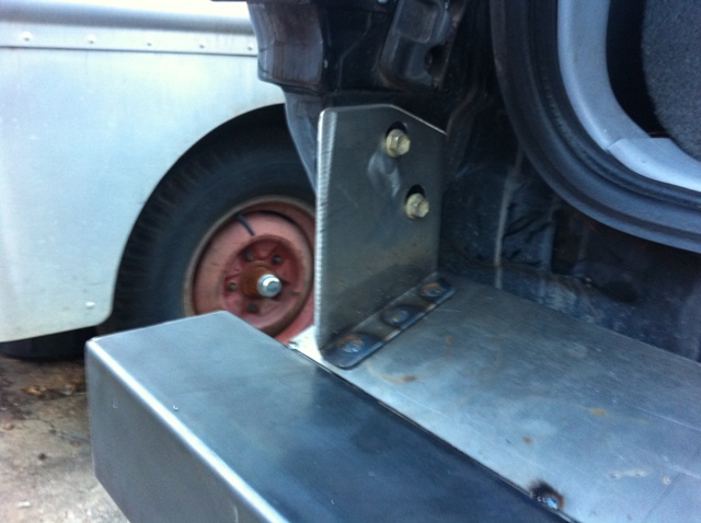

I am confused by this picture:
Are you bolting your bumper to the truck's body with these bolts? Or are these just temporary, to hold things in place while fabricating?
I ask because I don't think you want to bolt the bumper to both the body and the frame.
They are temporary, but I probably will keep the bolts in there since there is a hole now. They are not bearing any load really, but they do help keep things lined up while fabricating, so I dont see the harm in leaving them bolted in when its all done.
the body and the frame will flex differently jsmarine-I'm no expert so get other opinions of course.
I would not recommend leaving those bolts attached to the body like that. It would lead to more trouble eventually. Those bolts could strip or back out which would mess with the rear hatch.
Thats a good point, I can leave them out. thanks for pointing that out.
