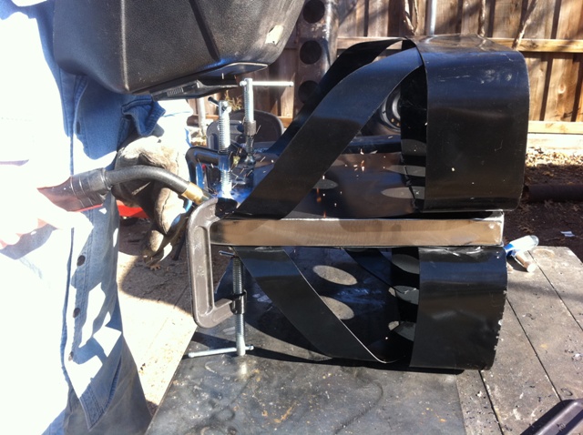

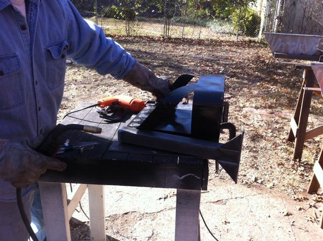

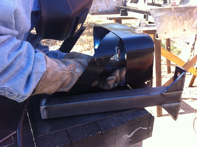

Small update.
Today we built some holders for the jerry cans and mounted it on the swing arm; we also did a little bit more welding in places that were only spot welded.
I will work on the bumper some more this weekend, hopefully I will have it finished on Sunday.

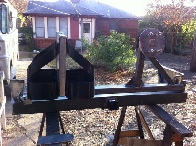

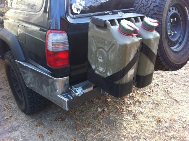

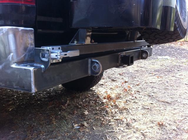

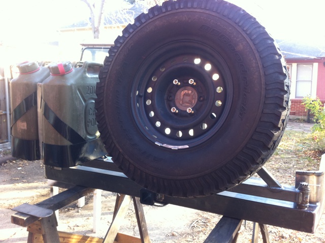

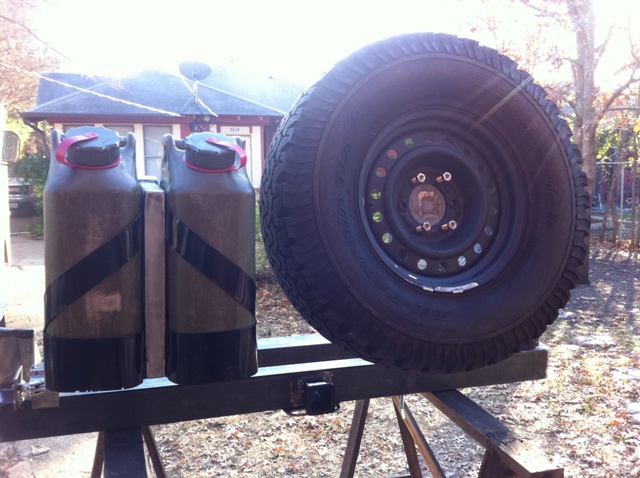

We got all the welding a fabricating done today! I ran out of daylight to get some primer on it, but I hope to get it all painted up this week. We got the shackle mounts on today, finished up with the latch, drilled and taped holes for the license plate and light, and finished the jerry can holders.
I will get some better pictures of everything once its painted and mounted on my truck. I will be painting it with the truck bed liner just like my front bumper.

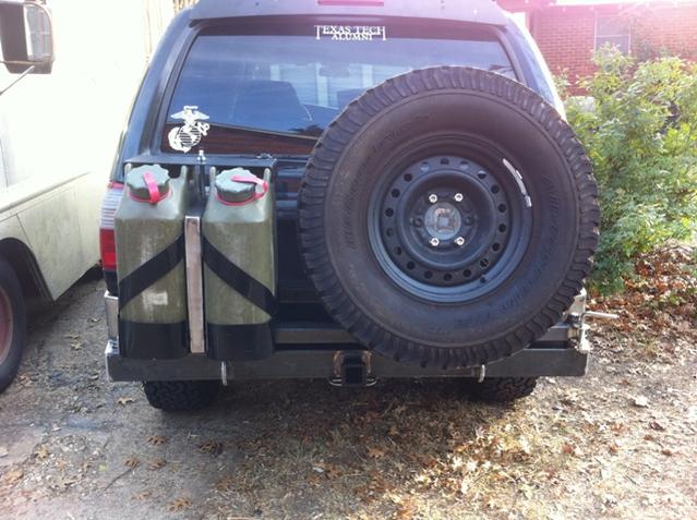

NICE!!
how heavy is that thing? are you sagging now under the weight of that?? or is that just the pic angles?
looks awesome, does it bolt to the frame or did you weld it on??
NICE!!
It bolts to the frame using the 8 bolts that were used with the receiver hitch. Plus two more I added, Its on there - not going anywhere!
Not sure of the weight, but we were conscious of that throughout the build and used thinner and lighter metal where we could (anything not load bearing). So with everything on the bumper, spare tire and jerry cans, (full) it sags a full 2 inches in the back. Not too bad since one full jerry can weighs about 40 lbs, (gas is roughly 8lbs per gallon) so its an additional 80 lbs with two of them. I may upgrade to the 891 coils when I redo the front suspension. Which will be pretty soon hopefully.

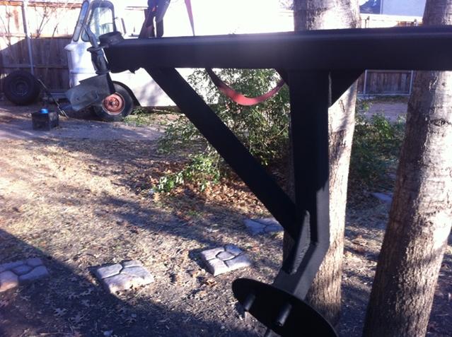

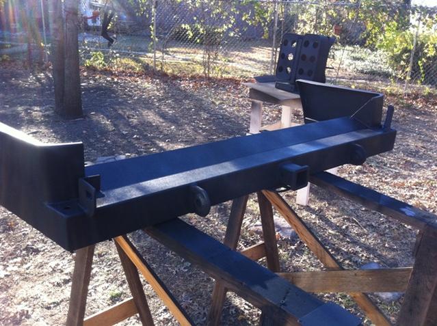

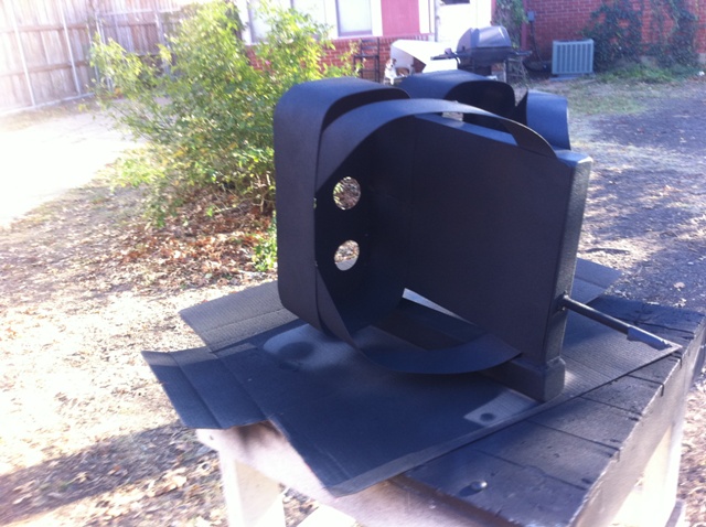

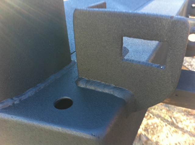

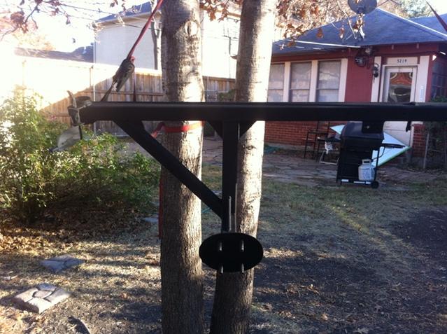

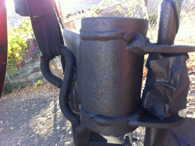

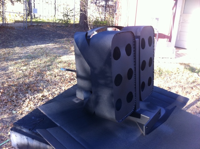

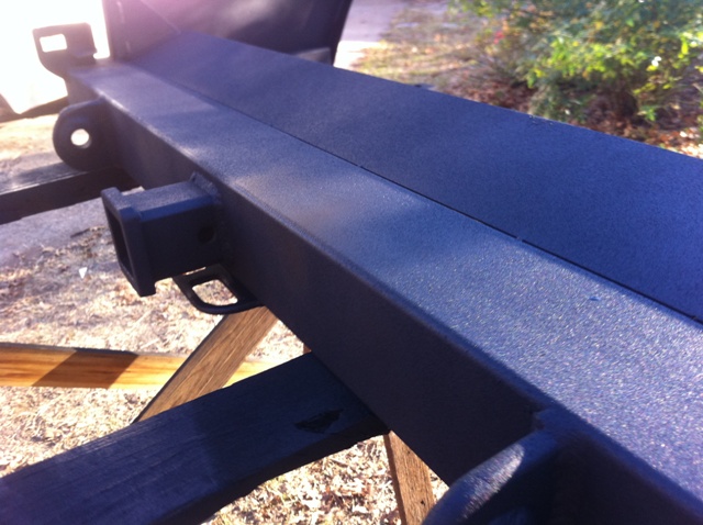

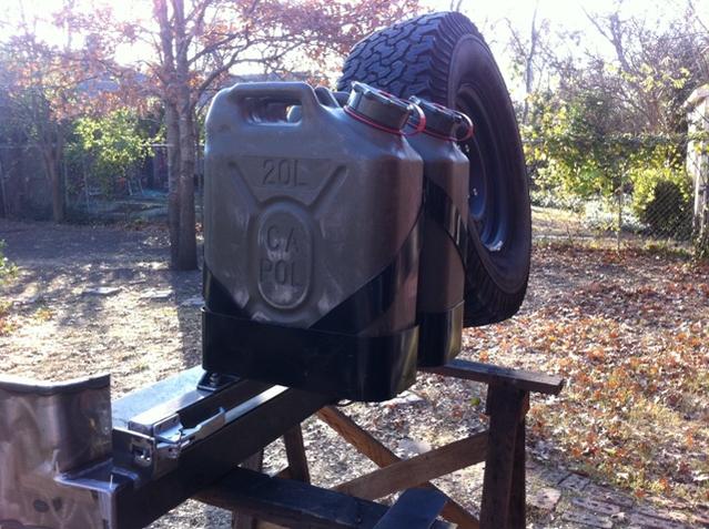

update: painted
left early from work today to take advantage of the nice weather, got the everything painted with the truck bed liner stuff, snapped a few pics with my iphone. I think the texture shows pretty well even with the crappy cell phone pics. Its drying now, and i probably wont mount it until Thursday due to work, but I will post those pics when I do.
All in all everything turned out pretty good, the finish is nice and Im happy with it.
