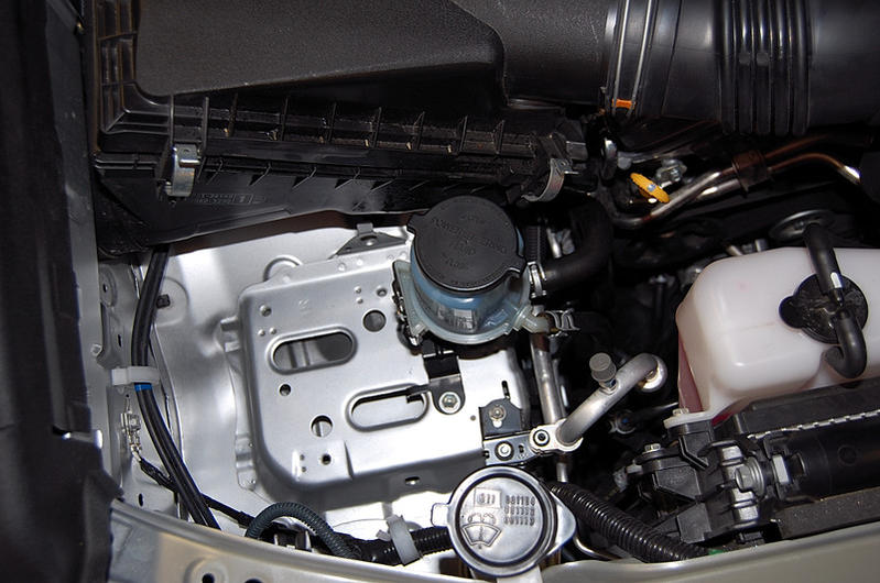

Definitely installing a second battery but it's already set up for one in front of the airbox on that side.Just need to relocate the Power steering res. inboard 2-3 inches with a fabbed ss bracket and shorten the hoses. Also a new bracket for the AC line hold down..
Has the bracket and hold down holes already.
Some European Prados come with a 2 battery option for extreme cold climates.I've been checking out the Prado forums lately. Funny , they have some of the same complaints/likes we have, as the 2010 Prados are a new Gen. like the 5th Gen. 4Runners.

I'd call it a blessing that we have so much more room under the hood. Real easy to relocate the power steering res.with new bracket.Earlier Gens had to put the 2nd battery where I have the compressor and tank.
They relocated the windshield washer bottle forward and down on the 5ths so it's going to be harder for the design of a aftermarket front bumper like ARB/Shrockworks though.

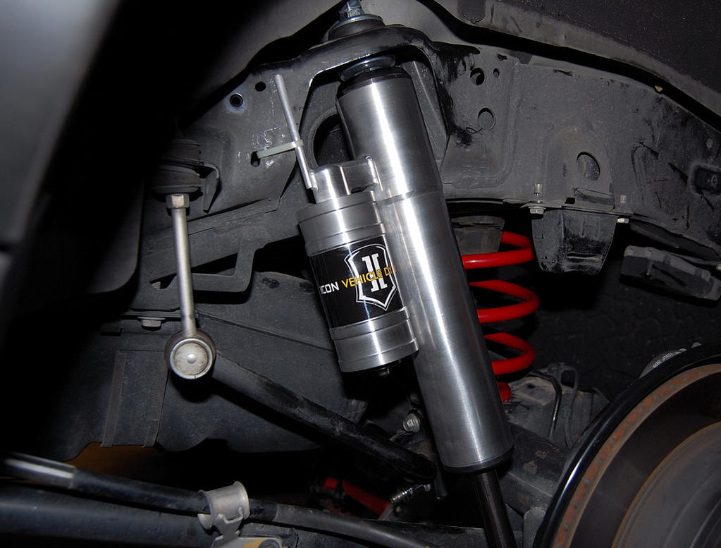

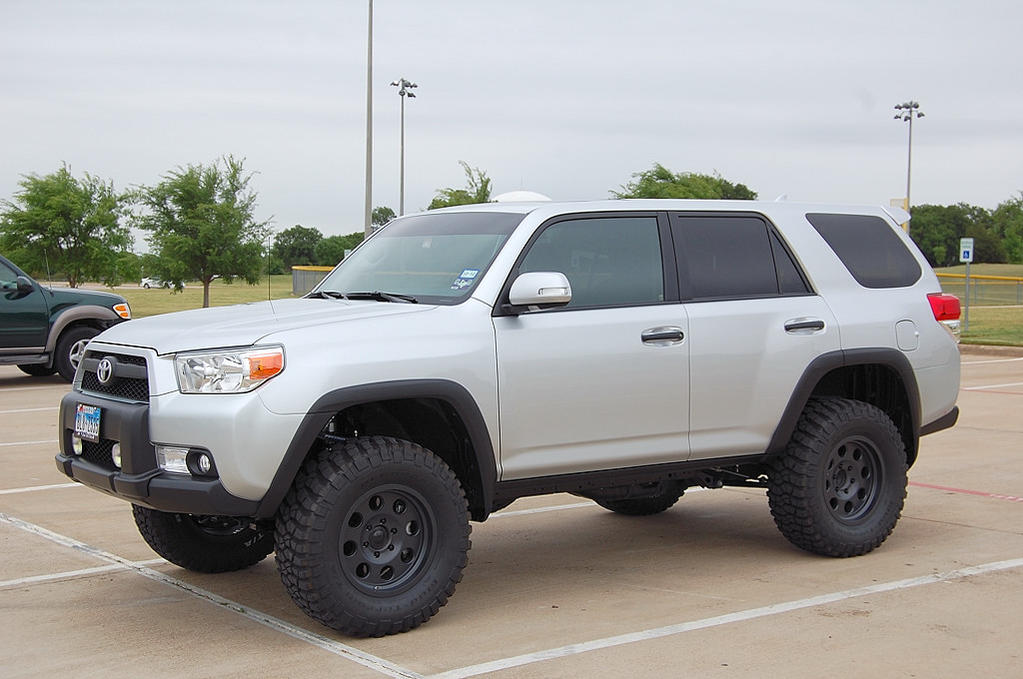

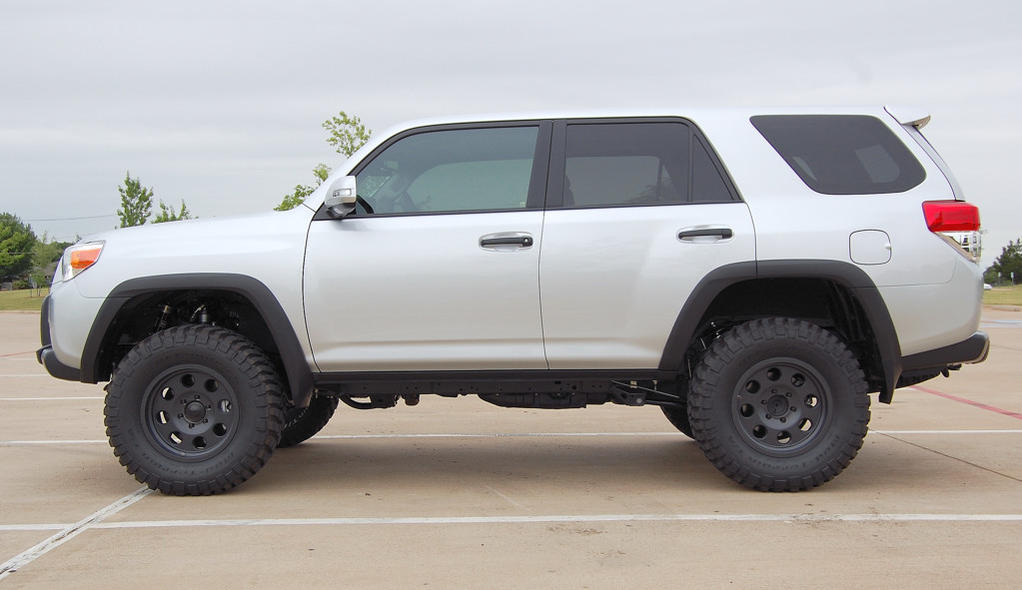

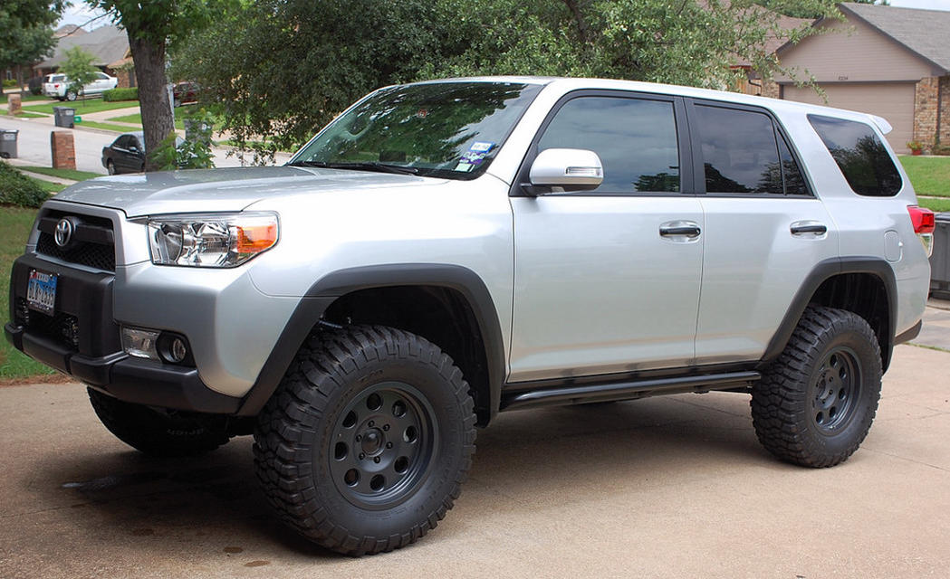

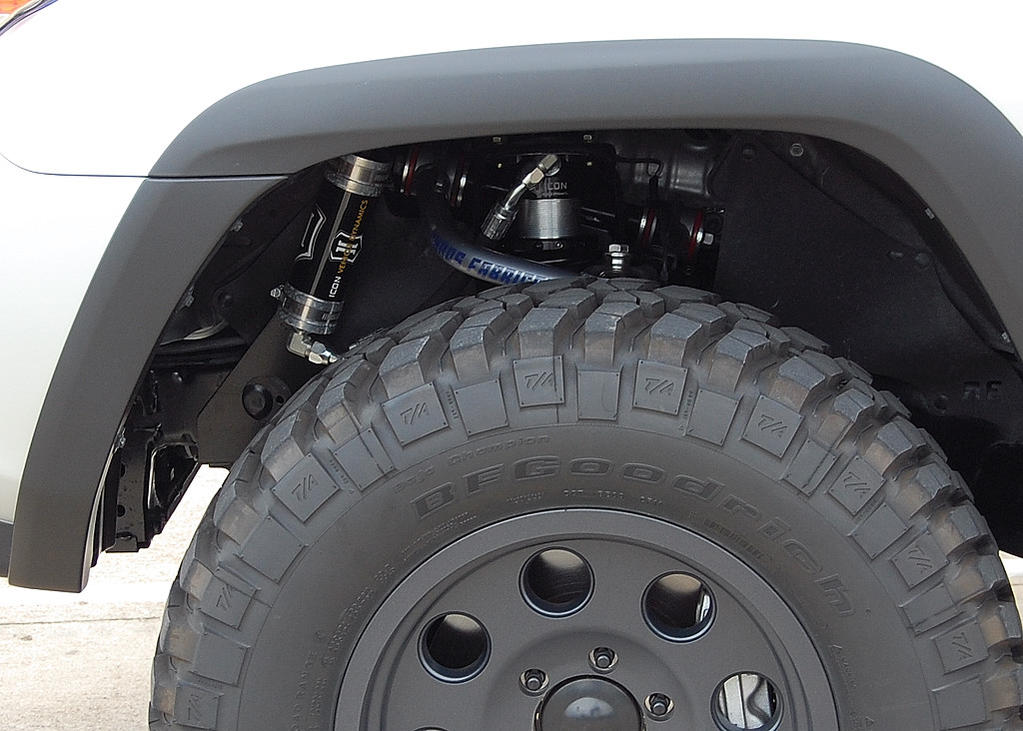

I finally installed my Icon suspension yesterday .Rides like a dream as I just drove it a couple of hundred miles today.I couldn't imagine it to feel any better.Hard to describe,it just floats thru bumps but is still firm on handling. No more brake dive or front end lifting up when flooring it from a standstill like before.
I have it set up for a 2.5 inch lift in the front and 1.5 inch lift in the rear with the Sway a Way coils for a 2.5/1.5 lift and a 1 inch rake front to back.
I had a couple of fitting issues with the bracket for the remote resevoir on the pass. side and the sway bar relocate blocks made it rub . Nothing that couldn't be over come ,just slowed me down. I'll call Icon with some pics tomorrow so they can make the adjustments as this is the first 5th Limited to get a CO lift and has different sways then the TE's.

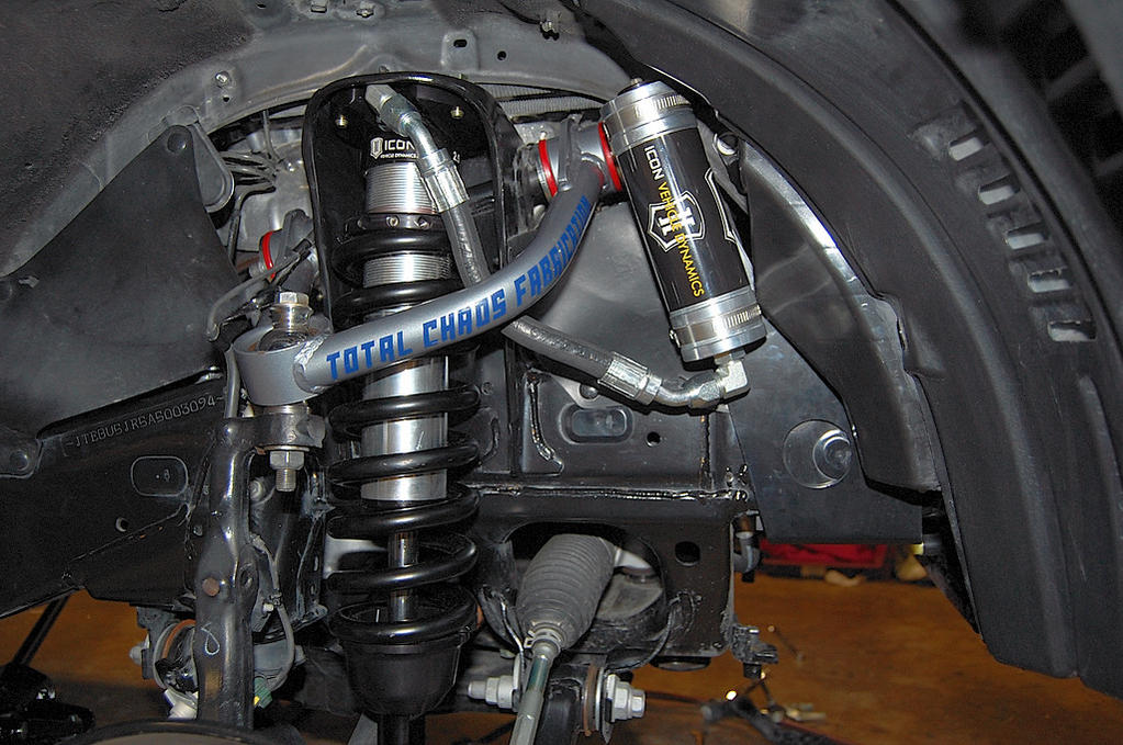

It took me a good 7-8 hours for the install but alot of that was taking off the stock X-Reas and all the hydraulic lines for it.I got them off without losing a drop of fluid as I know where the check valves for them are now.I had put on the Total Chaos Upper Control Arms a couple of weeks ago.

Here are some pics.These are the Icon long travel front coil overs with Remote Res. and the rears are the long travel Piggyback shocks with SAW coils.

Looks great Harper! I agree with your choice on the one inch rake, it keeps the lines flowing.

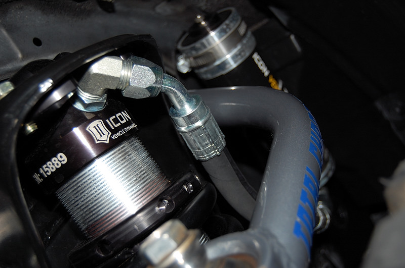

But in that first picture, the UCA looks like it is resting on the res line... any clearance problems there?
Thanks for all the comments! If anyone needs Suspension installed in the DFW area,pm me.
super sick... will you add a BL when one comes available to put 35's?
35's????lol Probabably need to change the gearing in the rear end with this engine.It will be awhile as I'm lovin the my 33's!
Just an optical illusion with the UCA's. They come way out and no clearance problems there at all. Here is a better pic I just shot.

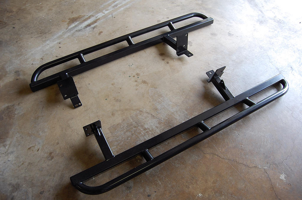

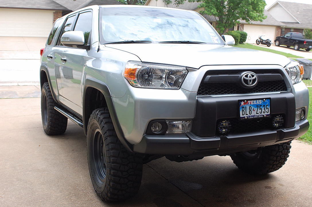

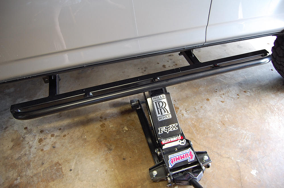

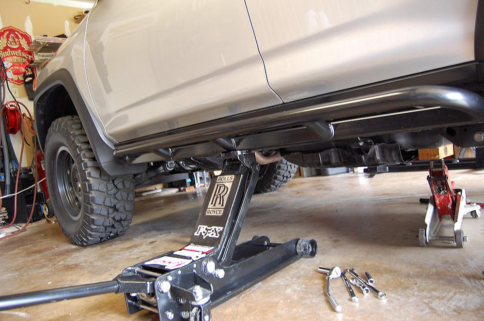

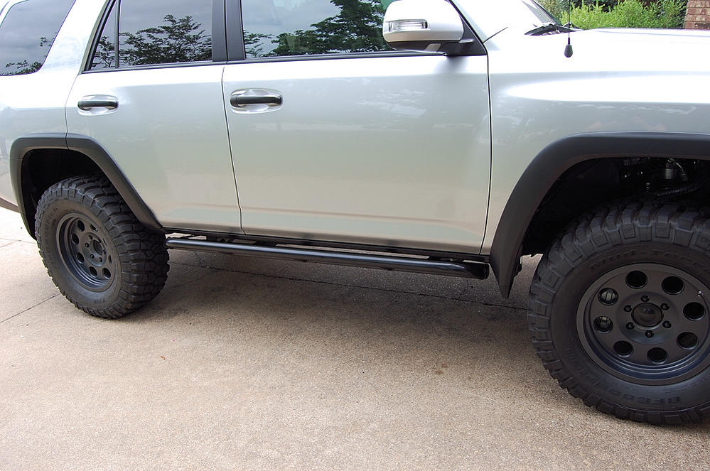

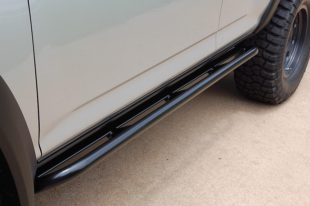

I finally recieved my Shrockworks Sliders this morning. Took awhile but as expected the quality is first rate! Love em!These will only fit TE's unless you remove or modify your rocker panels. The rockers are in the way on the Limited/SR5's.
They fit near perfect and was an easy install as they are bolt on.It took me less then 30 minutes. I carefully balanced and lifted them into place with my floor jack. Be very careful as these are heavy at over 50 lbs each and will take a toe or two if you let it fall on them!!
On the drivers side you have to take the outboard bolts loose for the gas tank skid plate and then the bolt for the gas tank strap.Support the gas tank as I noticed it start to drop as I backed off the bolt. The rear leg of the slider gets sandwiched in between the strap and the frame.
Pass. side bolts right up and is real easy.
Here are some pics.

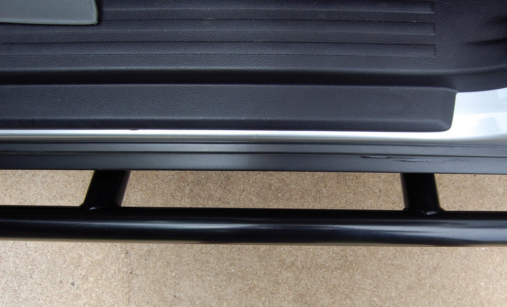

Well done my friend - It really finishes it off nicely! I definitely want them now - just don't know what I am going to do about my limited's rocker trim...
Harper, could you take a picture while standing adjacent to the rear tire and facing the front tire and with the front door about 6 inches open so that we can assess the functionality of the sliders as a step? I hope that made sense.
I know they're not meant as steps, but just curious...
Thanks and looks amazing!
