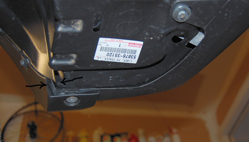

Again, Looking SWEET!!! Keep the posts coming and if you could explain how you moved the front liner again, it would be helpful. I'm gettng the tiniest bit of rubbing, and don't feel like cutting anything just yet. I think my coilovers should solve the problem.

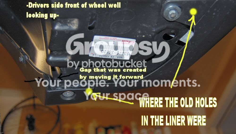

Rather then cut the liner off to prevent the rubbing. Do what's referred to as pulling the front part of the liner forward.
Elongate the 2 bottom holes,or maybe there's 3,in the liner by taking it loose,pushing it forward as far as possible and carefully making new holes just in the liner. I used an exacto knife but the abs plastic is kind of hard to work with. My suggestion is to put the new holes in with and Dremel with a small round ball or equivalent .Put the bolts back in and tighten. Wala.....You now have 1/2" -1" more clearance so your tire doesn't rub in the front.
Then when you have it aligned ,take it to a shop that knows what they are doing and have them align it so the wheel is forward(max caster).You may not get max caster with the stock UCA and one of the main reasons people use aftermarket ones . This will make it so it won't rub in the back ,on the mud flap in my case. Here is a pic I just took at the bottom front drivers side to try and give you an idea of what I'm talking about. See the gap I created where I moved it forward.That gets you an extra 1/2" or so of clearance and no rubbing. We need somebody to do a better write-up on this when/if they do it...hint sp8ball/antman!!!My bolts just look different because I used Aircraft stainless bolts/washer/nuts. I think it will make more sense when you get up under there and take the fasteners out and see that the liner can be pushed forward! It's a very simple mod.This is an old pic and of a TE liner. A SR5/Limited liner will be a little different to do, but the same principal to move the liner forward.

As far as fitting the 305's on aTE . It's all in the having the right rim size. With these,I am getting no rubbing at all with the mudflap removed.I have to do a mudflap mod on that bump on the inside of the mudflap for them to work. But I "pulled" the front inner fender liners forward 1/2-3/4 of an inch instead of cutting them.Basically ,I elongated the attach holes on the front liners about 3/4 " with an exacto knife,pushed them forward and then tightened the bolts. Can't even tell,no rubbing and looks factory.
