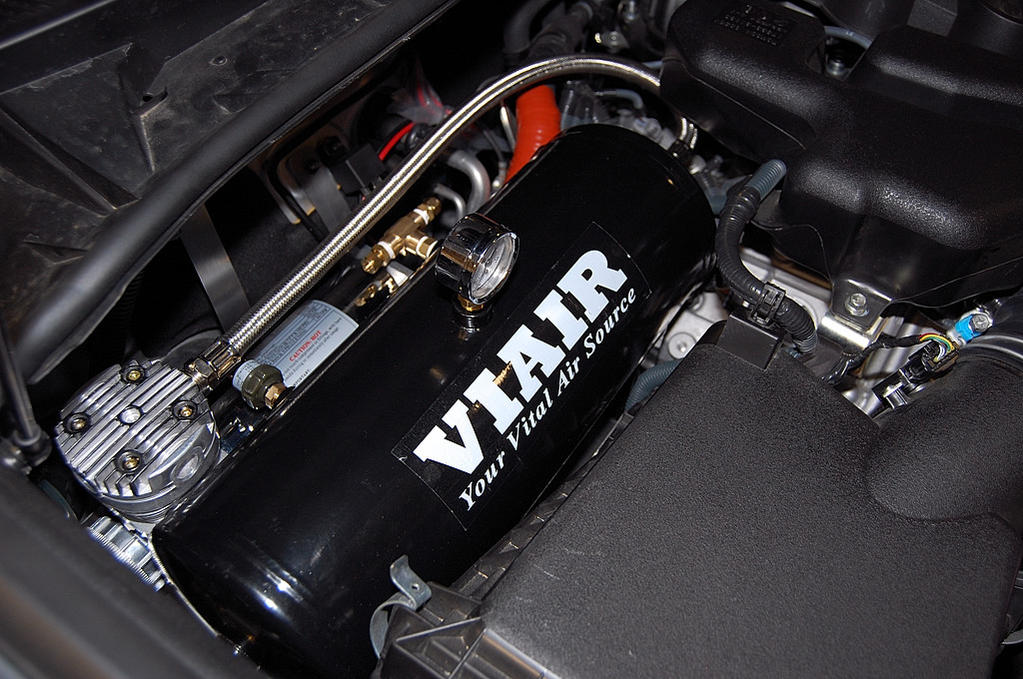

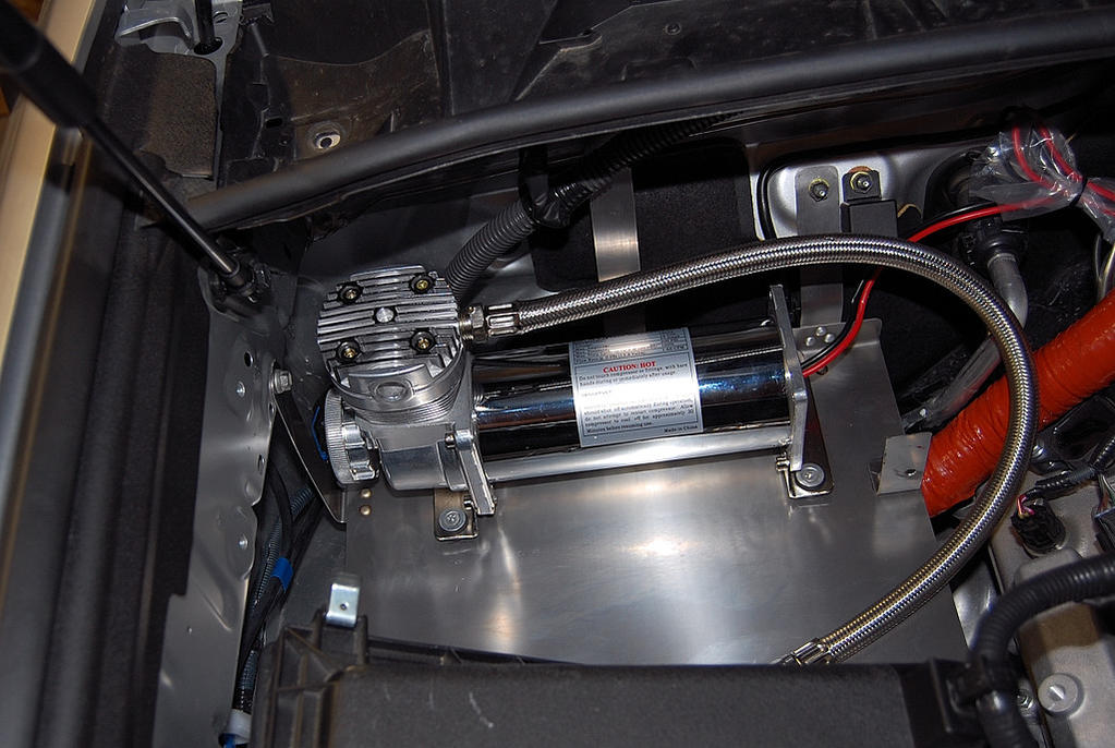

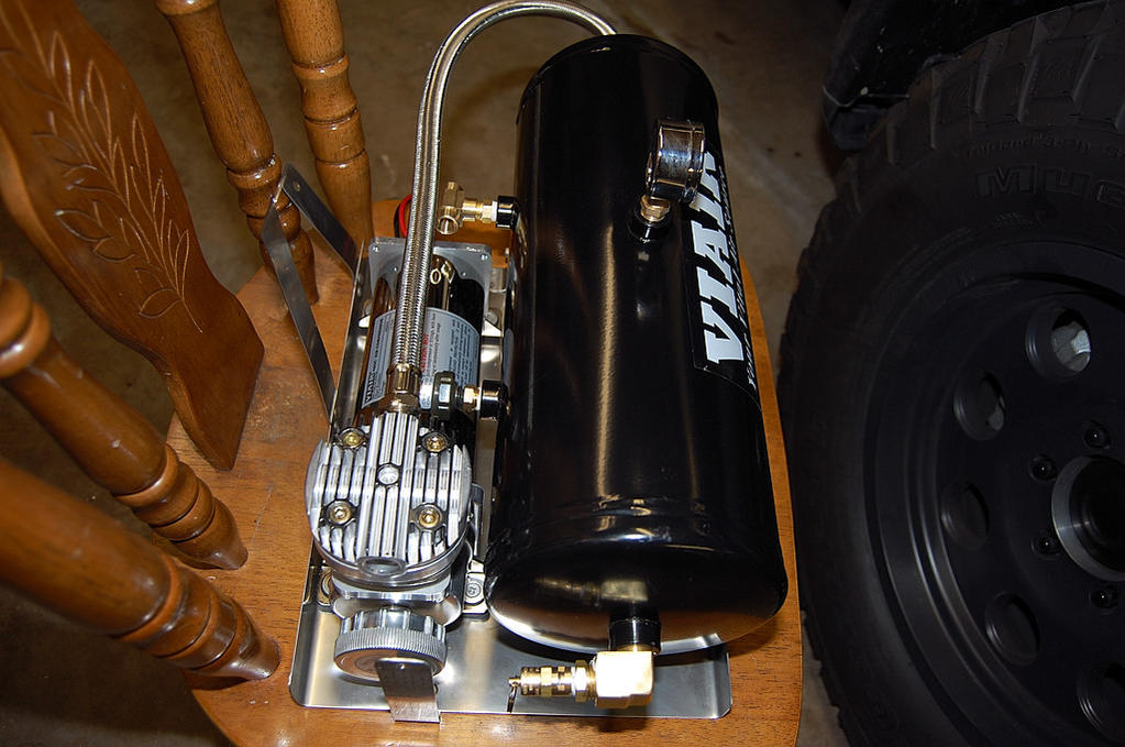

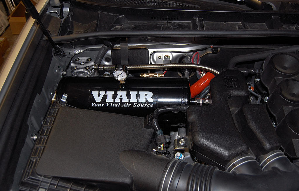

I did put my onboard air system in but did not plumb it or wire it up yet. It's a ViAir 480C compressor that is rated at 200psi continuous duty and a 2 gallon tank.
I have a splitter for air,one in the front for big rig air horns I bought and one going to the back with a female air coupler to air up the tires and run air tools and eventually a air locker.The 150db air horns were inspired by an idiot child ,texting with ear phones in, of course in the fast lane going 55mph blocking traffic.
I had to relocate some wiring harnesses that were on top of that fenderwell behind the airbox. That's why you see some red high temp rtv tape on the main wiring harness. I double wrapped them and made a bracket down lower then they were located, thus needed more heat protection.
I custom fabbed the tray and brackets out of 401 stainless steel and bent them to shape,riveted and attached them to the existing studs/holes.Aircraft sheetmetal experience in the past was the driving engine there.Still took a good 10 hours of work/fun.
The pics are working backward in time.

Harper - looks sweet. I helped a friend install a similar tank in his CJ7 about 2 months ago. We didn't install a compressor though. The sheetmetal bracket looks really slick.

Congrats on getting your account back. You put your compressor exactly where I plan on putting mine, but it's nice to see an air tank in there too. Are you going to wire up a pressure switch or a manual one?
