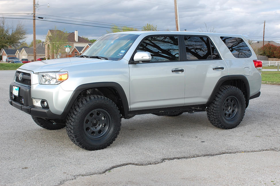

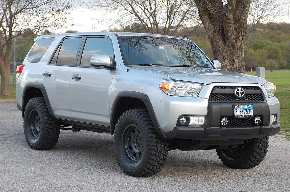

OK , here's a couple pics. I'm waiting on my Shrockworks sliders to come and be on any day to take/show pics.
