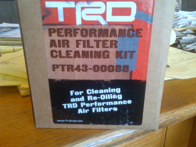

Eh, it's a rebranded K&N Filter; it even has the logos if I remember right. The funny thing is that I don't even know if most dealers have the cleaning/oiling kit or know how to use it. I know our dealer maybe has one or two on hand and I don't remember the last time we ever sold a TRD Air Filter service if ever...
Here you go! Every automotive forum has volumes of debate regarding these types of filters. Personally, I like the mean sound they give the engine. I really don't notice any increase in mileage. Stoichiometrically, I would think that more Oxygen, would mean more fuel used as well.
I went with the TRD filter due to the fact that it IS a Toyota product and, as long as its installed properly, Toyota will back it.
BTW, I have 2 TRD filters so I can change out while the other one's being cleaned and dried out a little bit. I also have the OEM on hand if I am going to be driving at a site with super fine dust.
.....just another person's take.
