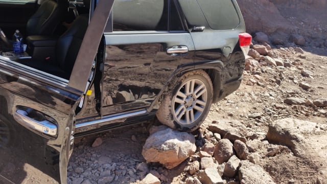

Not sure if this guy's on here but it was from instagram.
<a href="http://s235.photobucket.com/user/dcook2007/media/Mobile%20Uploads/image.jpeg.html" target="_blank"><img src="http://i235.photobucket.com/albums/ee155/dcook2007/Mobile%20Uploads/image.jpeg" border="0" alt=" photo image.jpeg"/></a>
Such Flex
Wow...
This was a year ago about 2 weeks after I bought it. Completely stock.
