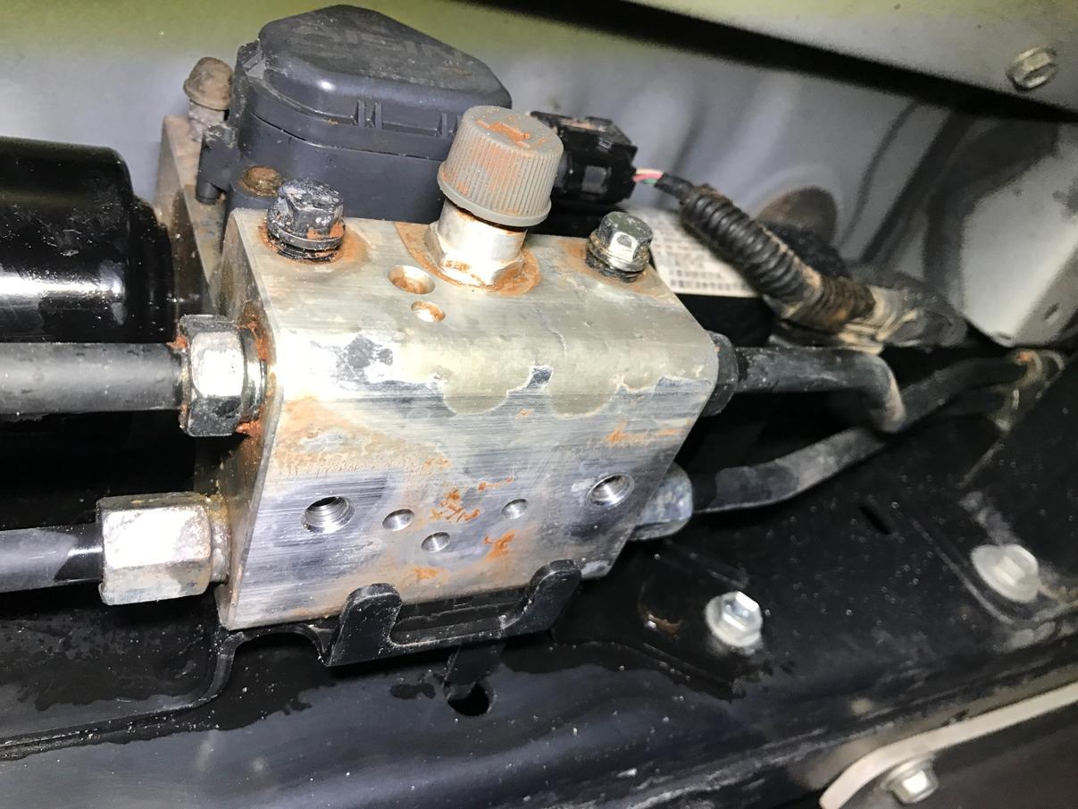

I am new to this forum. My KDSS light came on at 47,000 miles. Mine looks like the photo you posted. And the fluid is leaking also on the driver's left side.
I returned the vehicle to the dealer who said it had rusted through and the cost to replace it would be $2,800. The Toyota rep that I met with said it corroded through due to driving it on salted roads in the winter [I live in Maine]. He said it would have been covered before 36,000 but now I am out of luck.

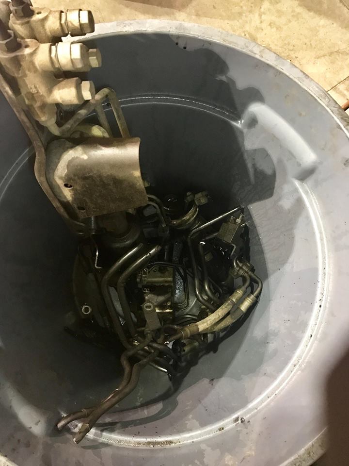

Here is a fix that some people are going with.... Getting real popular in the GX community... The 470s are at an age where people are starting to turn them into more extreme rigs. Really are a lot of those folks ripping it out.. so might start calling some Toyota focused shops like metal Tech... looking for take off parts. Will still cost you quite a bit to fix though since so many special tools... required In the end I would want a warranty on such an expensive repair.

I love my kdss....but if it fails and costs $2800 to fix it...it's goes away. I don't plan on it but I won't spend that kind of cash to keep it. I figure at that point this truck is a toy...and gets used more off-road than on. F it.
That is BS, serious design flaw, I guess they don't salt roads in Australia?
LOL Like your not supposed to drive an SUV on salted roads in the winter? WTF :frusty:

Checked under mine today (2016) and after cleaning mud away, noticed corrosion in the form of the upper part being discolored from the rests, and a distinct ridge where the border of the corrosion is. What could this be? Looks very similar in hue to the above picture, obviously not to that extent damage-wise.

Wow, that's bad (and the frame's not looking so hot, either). You're in Denver? That thing looks like it was submerged in salt water!
I'm in Denver, but I recently purchased it from a dealer in Milwaukee, WI (April 2017). The carfax indicate that it was was originally purchased in Grand Junction CO, but then spent 2013 to April 2017 in Milwaukee. Something like 60K miles were put on it in WI and they reportedly use cheese brine among other things to de-ice roads.
The body is perfect...beautiful actually. No signs of corrosion at all. Many people think it's brand new it looks so good. Looks and except for the KDSS issue, it runs like a dream. It has a 4 month/5K mile warrantee, but doubt the KDSS is covered on that.
However, as you all indicate, the underside shows considerable corrosion. I think got a great deal on it, but I'll be putting it up on a jack and taking a close look at it and I'll update with what I find out.
