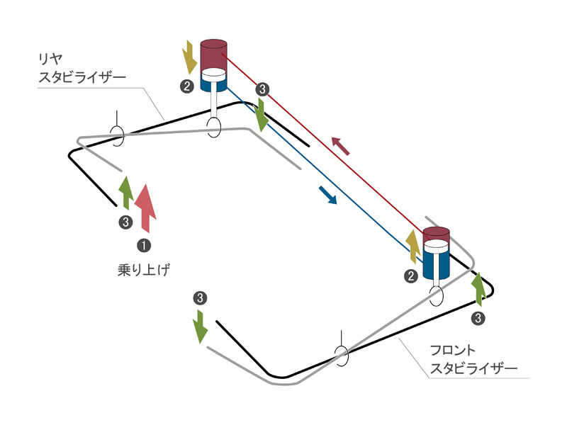

A simplified KDSS could work very will without accumulators. Yes they do build in some shock absorbing to the system, but that's not necessary for a very functional sway control system.
Yes. Snowplows in a single day of plowing cycle many many more times than a KDSS cylinder on a typical day. If you measured the flow of fluid in both systems, the snow plow would have orders of magnitude greater hydraulic fluid movement. Most of the time (over 12mph) KDSS doesn't cycle at all or extremely little. And the point is really that synthetic hydraulic fluid is unnecessary. Lots of hydraulic systems operate at -30* to 130* with regular dino based hydraulic fluids without issue.
The KDSS fluid doesn't get hot because it doesn't cycle very much. Next time you're on a bumpy road, stop and feel the cylinders. They won't warm up meaningfully because the whole idea of shock absorbing shown in the kdss video mostly nonsense. If it actually made a meaningful difference you'd need to use different shock absorbers for each side and probably different springs as well because the effect on left and right sides would be different due to the leverage differences.
Look, I'm not going to argue with you on a public forum about this. I will say the video is not nonsense, Nitrogen is needed in accumulators, snow plows use more oil but less cycles, no hydraulic system using an ISO68 dino fluid will operate the same at -30 to +130 and the guys who designed KDSS probably know a bit more than you about hydraulic systems. Let me know when you build one for $500 that can work like the OEM system.
