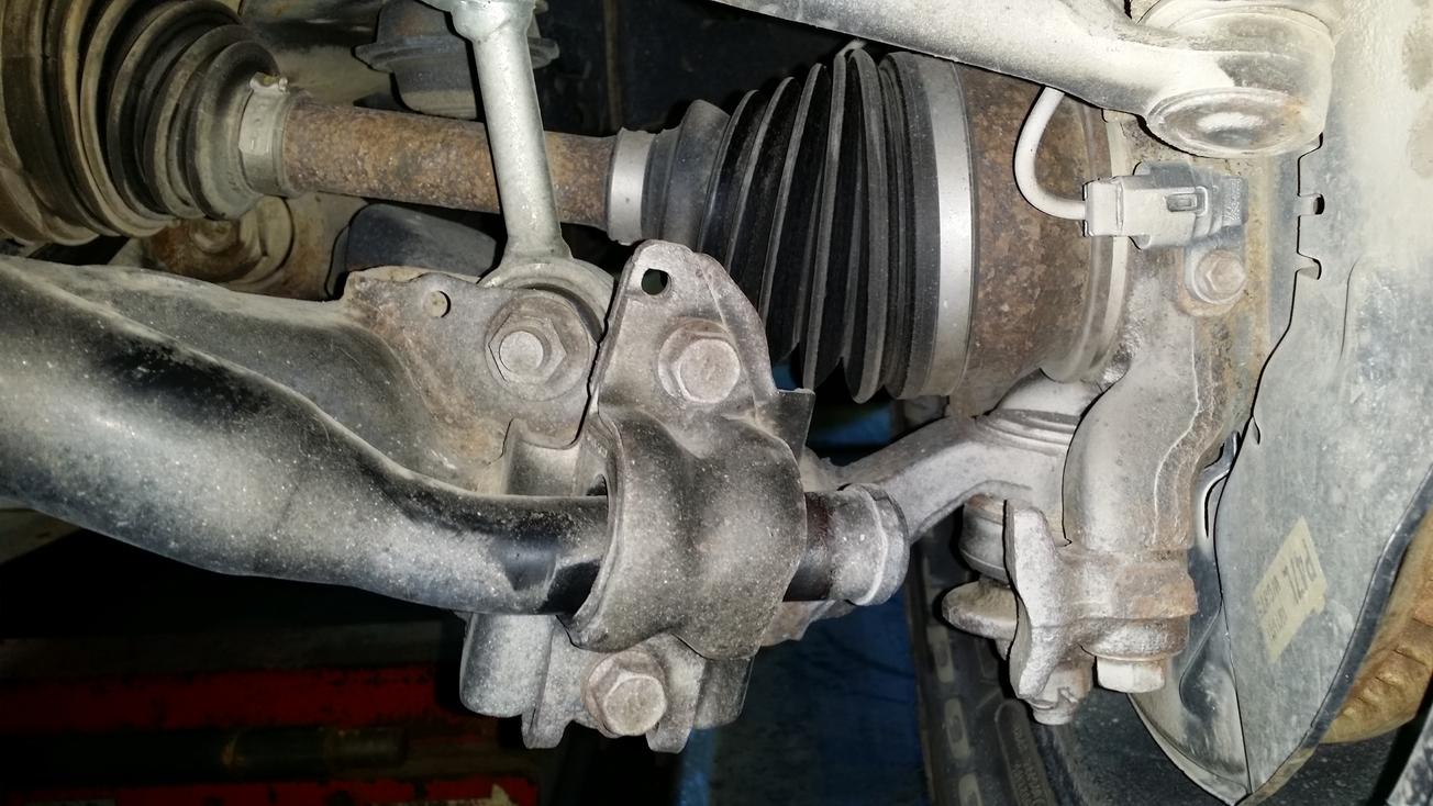

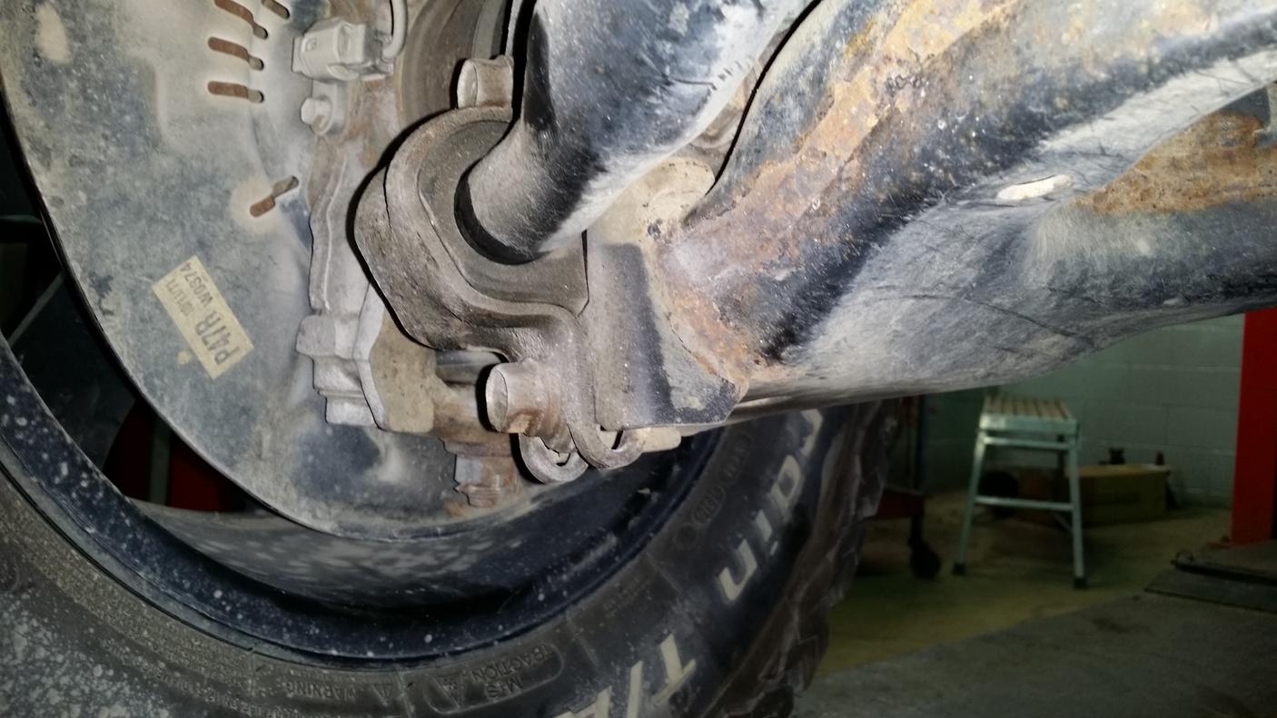

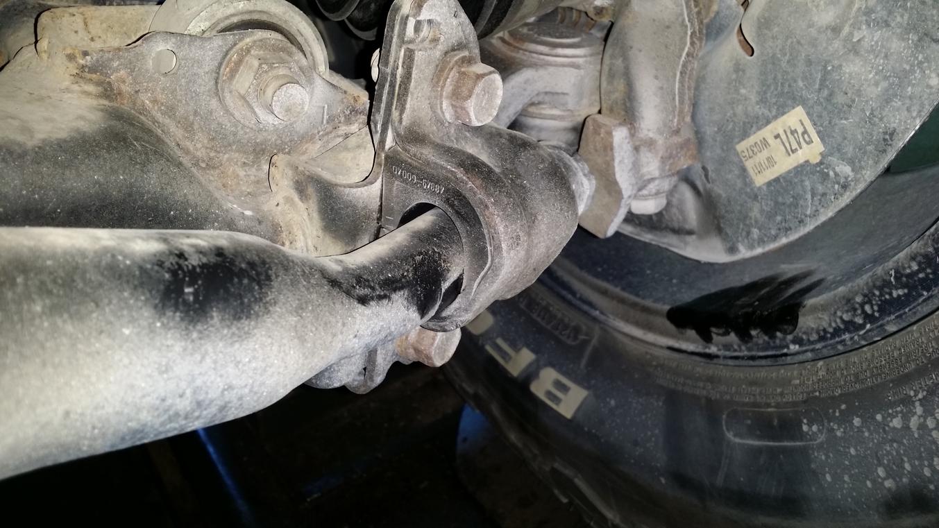

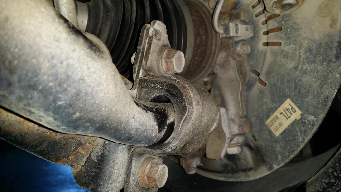

Hi. I went to the dealer today to check the KDSS system. There is a bushing that seems used. Here are some pics. I need help as to what might be the cause. The tech at the dealer shop admited he doesnt work with 4runners alot.
Any insight or info will be greatly appreciated.
The last picture is on passenger side you can see the bushing is not worn out at all.

What exactly are you asking? Do you mean the bushing looks worn? It is definitely used if you have a 2011 truck with original bushings. Are you having problems with your truck? Are you trying to find out what may be the cause of wearing out a bushing? One cause can be driving and using your truck. Those bushing definitely need to be replaced, my sway bar isn't floating in the bushing hole like yours is.
That first pic doesn't even look like it has the bushing. My 2010 with 81k has both bushing very snugly holding the KDSS sway bar in place. I switched my shocks to 5100's a few months ago and had the bar disconnected....yours looks extremely different...like if something is missing entirely.

Is my KDSS system broke ? Why do I have 3/4 of a inch lower of passenger. If you look at my sig. I have OME coils all over and Bilsteins all over.
