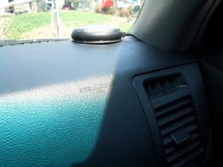

Correction made...wrong pic!
Dang that's a big antenna. It's too bad it has to be right on top of the dash like that. Could you mount it outside the truck...like back on top of the liftgate?
Just like any other xm radios out there. You can mount it anywhere you want. It comes with a metal flange mount also so you can literally screw that thing somewhere on your vehicle (I don't know why you would) or just mount that huge magnetic saucer of an antenna on the outside. You do need to purchase extra USB cable looking antenna cable though if you want to run it everywhere.
